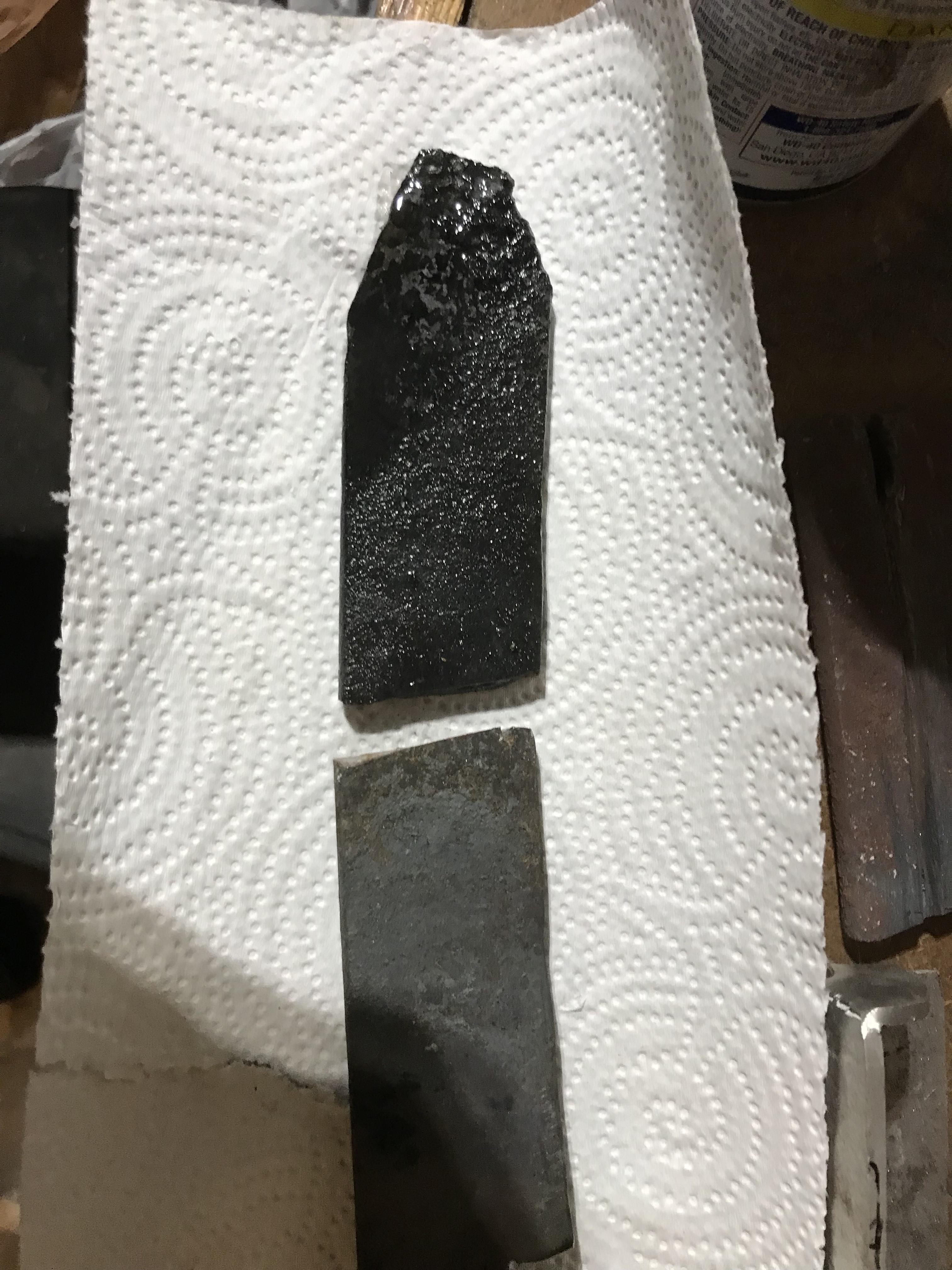

Chimaera Posted December 5, 2021 Share Posted December 5, 2021 My first heartbreak- my friend, who was supposed to be working on this seax (it was almost ready for hammering in the bevels!) got distracted and it burned. Second heartbreak- as we were getting ready to cut off the tip (try to salvage some of it) it fell and snapped.Third heartbreak- while working on the new replacement seax, he cooled it off in some water. This is 5160. It cracked immediately . I’m not sure where I put that one. This was mostly my fault, since I apparently didn’t stress enough the importance of not water quenching and not burning the steel. Thankfully, we did manage to pull off a couple of squirrel tails. Mine on the left, his on the right. This is just forged and rough ground. Still lots of refinement to blade shape and getting good bevels.hopefully these will turn out well and we’ll get to do that seax soon. Quote Link to comment Share on other sites More sharing options...

Irondragon Forge ClayWorks Posted December 5, 2021 Share Posted December 5, 2021 Bladesmith's don't make mistakes, they make smaller knives. Quote Link to comment Share on other sites More sharing options...

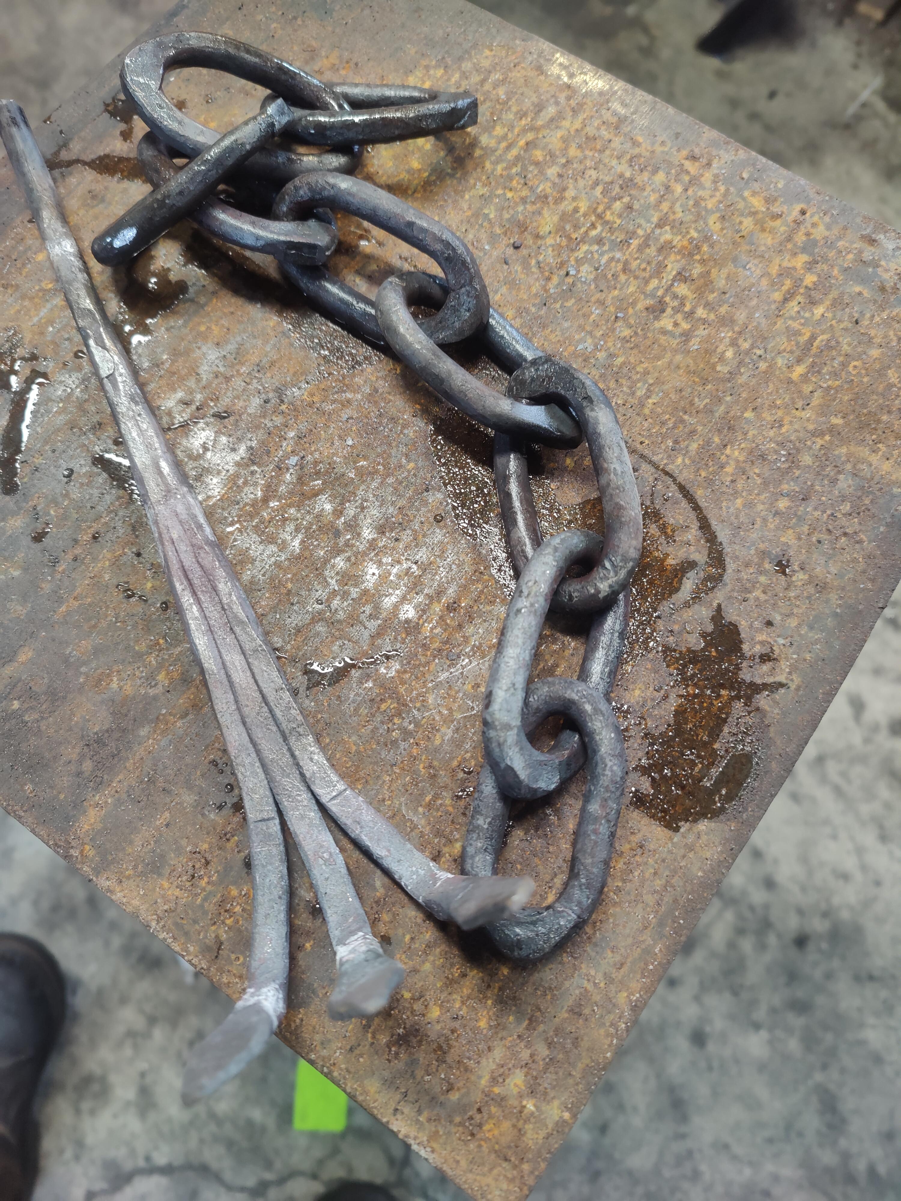

Donal Harris Posted December 6, 2021 Share Posted December 6, 2021 3 hours ago, BillyBones said: Made a couple more links to my chain. Not quite round, working on that, but they are thicker. The 2 on the bottom right.. I pity the SCABA member who drew my chain and hook at a meeting. This is my first, and so far, my last attempt. Yours look like factory made links in comparison. Quote Link to comment Share on other sites More sharing options...
Chimaera Posted December 6, 2021 Share Posted December 6, 2021 22 hours ago, Irondragon ForgeClay Works said: Bladesmith's don't make mistakes, they make smaller knives. Maybe it’s just me, but I think melting 3” of steel qualifies as a mistake Maybe I can forge it into a happy little tree? Quote Link to comment Share on other sites More sharing options...

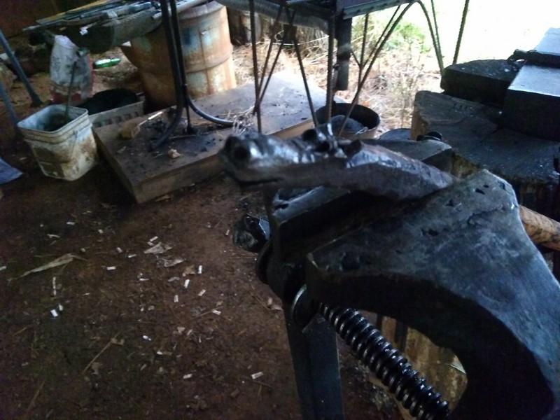

bluerooster Posted December 6, 2021 Share Posted December 6, 2021 Everyone is doing such fine work that I'm embarrassed to show what I've done today. But I'll show anyway. It seems my first dragon head came out passable: This is a gas key that I made back in august. It seems that all the others come out looking like hippos with whiskers: Or some cartoonish horse looking thing when the whiskers snap off: Anyway, I spent the afternoon, making a slitter, and a punch for the mouth, nose and eyes. Then working on more dragon heads. I'll get it down pat one day. Quote Link to comment Share on other sites More sharing options...
BillyBones Posted December 6, 2021 Share Posted December 6, 2021 4 hours ago, Purple Bullet said: what do you intend to chain? Well, if the wife dont settle down... she may use it on me. Congrats on the anniversary. DHarris, at least your first ones welded. Mine ended up a mashed up pile of scrap. Blue, i really like that dragon, pretty cool. Quote Link to comment Share on other sites More sharing options...

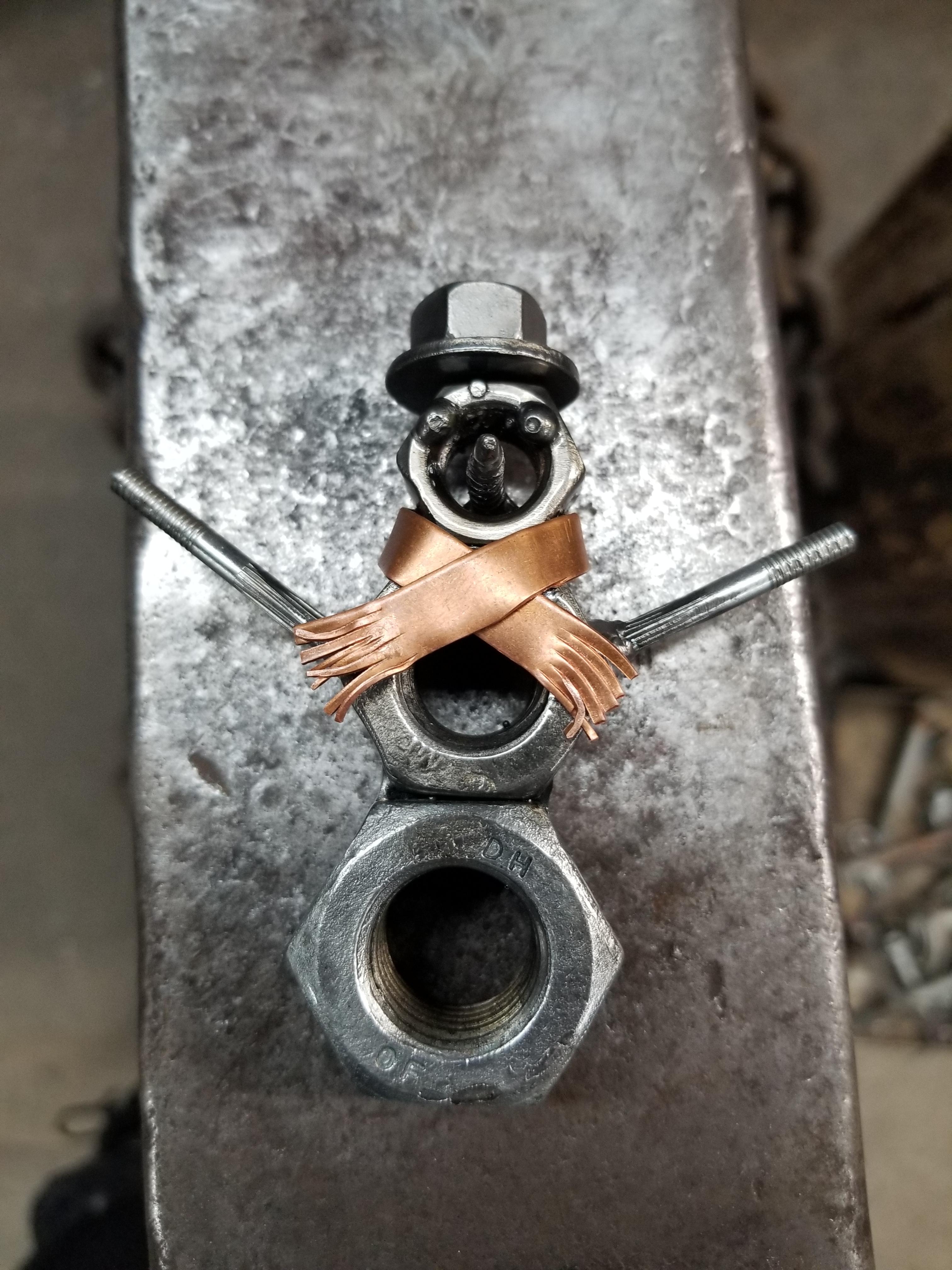

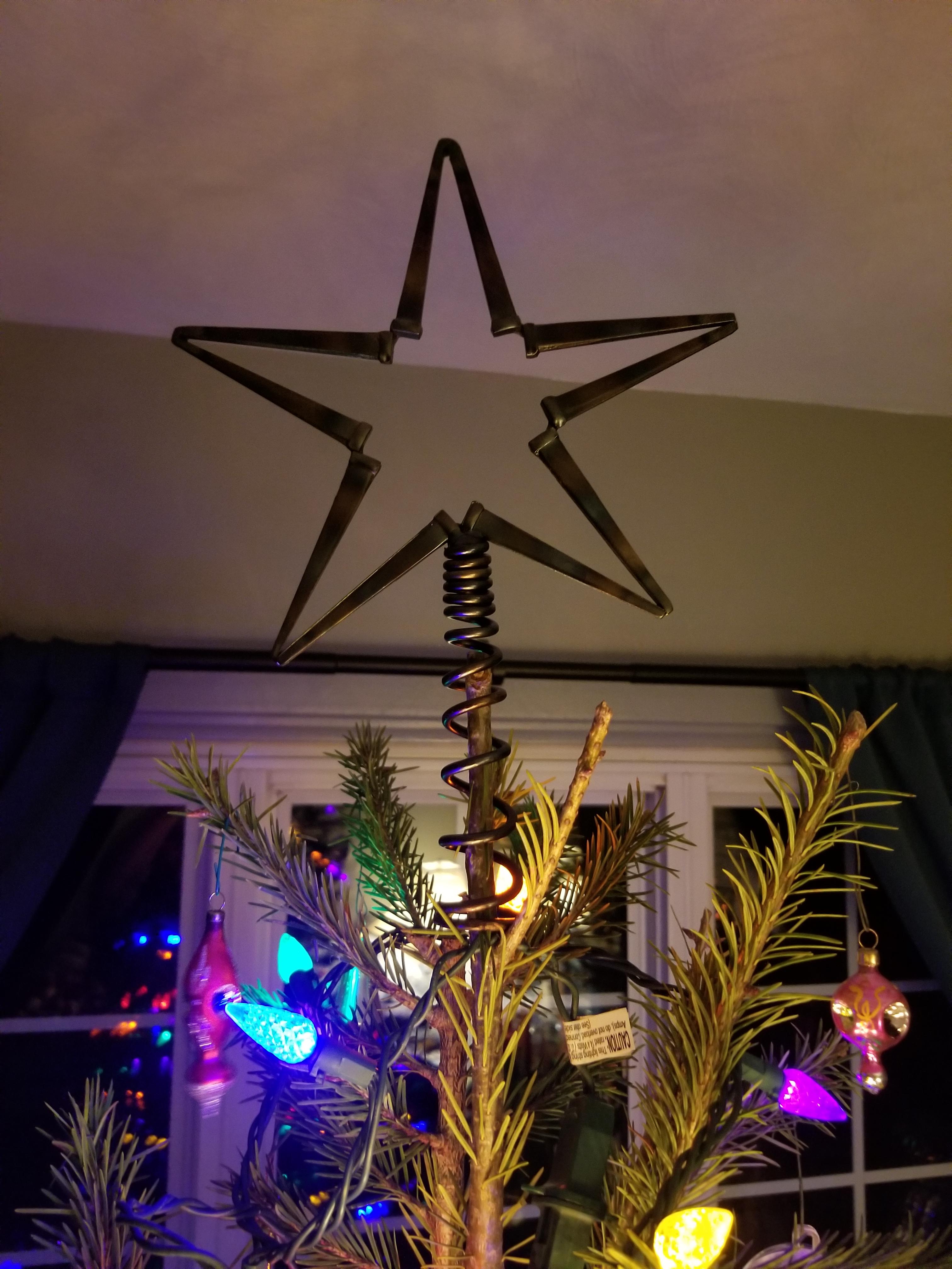

Daswulf Posted December 7, 2021 Share Posted December 7, 2021 Made 3 nut snowmen last night and another nail cross like the last I showed for my daughters preK teachers and helpers. I realized then that the two snowmen i made before that and for the last show I forgot their copper scarves. I sold one of them and it was honestly bugging me that I forgot the scarf. Got a message tonight from the lady that hosted that show asking for another snowman and a nail star she wanted to be turned into a tree topper. I asked her if she knew the woman that had bought that snowman and explained the missing scarf. I told her I had made an extra scarf in my last batch for that poor snowman if I could get it to her. She laughed and explained that the items were for that woman and she was with her right at the moment. They had a good laugh and we decided on how the topper would be. Round 1\8" steel sign wire cold coiled around a tapered punch in the vise. I welded the bottom end and welded the top to the star. Heat colored and clear coated. Quote Link to comment Share on other sites More sharing options...

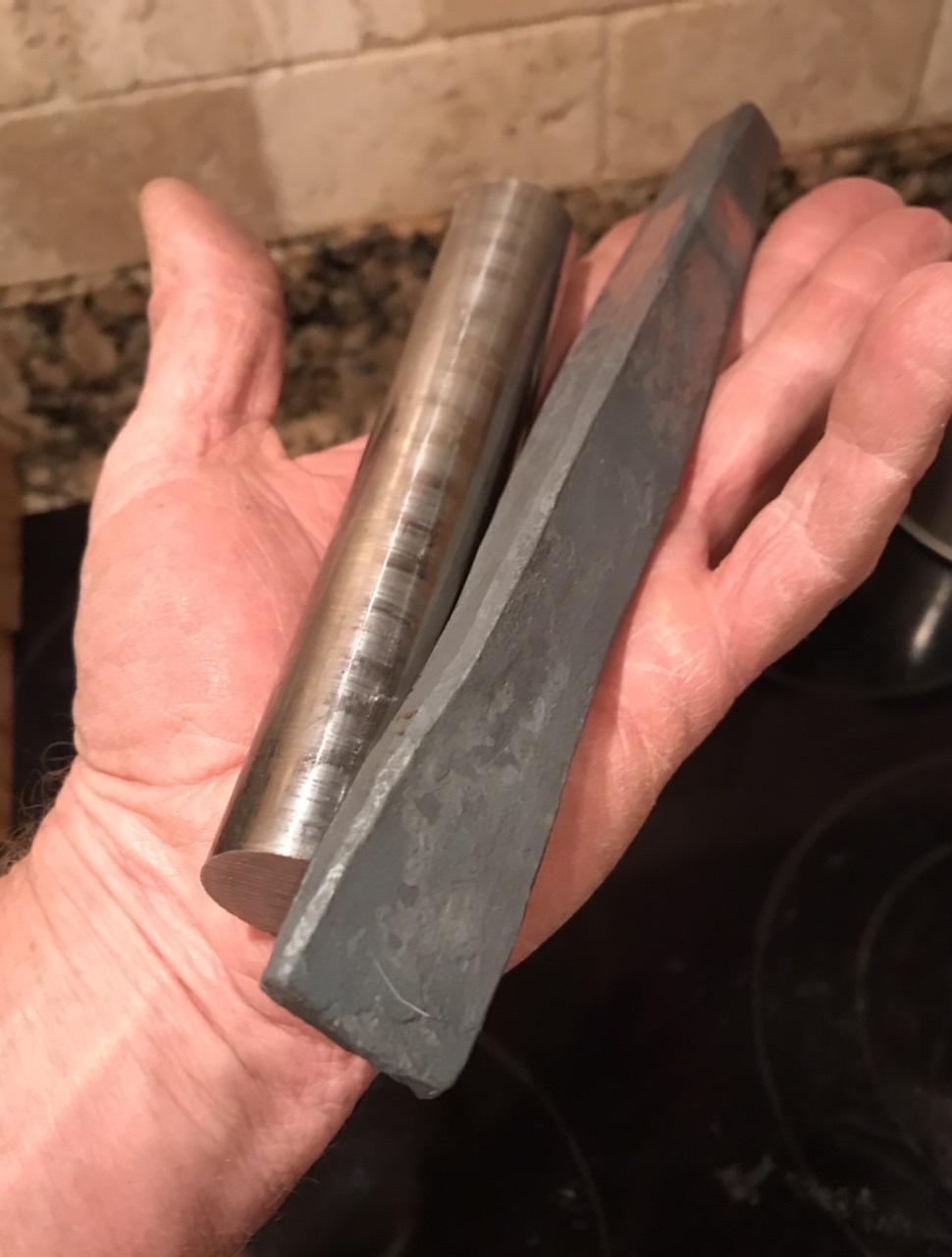

Rojo Pedro Posted December 7, 2021 Share Posted December 7, 2021 Good stuff everyone. DHarris that chain looks great to me. I hope mine will be as good. not a lot if time lately but was able to get a few hours in. I got 3 1”x8” H-13 rods from the ebaeys and holy cow! This is the hardest steel I have ever forged and I wore my arm out after using a 4 hammer, had to go back to my 2.5 favorite. Going to be a hot cut chisel. I need a power hammer Quote Link to comment Share on other sites More sharing options...
JHCC Posted December 7, 2021 Share Posted December 7, 2021 Or get someone to strike for you. That can be surprisingly effective. Regardless, that's looking good! Quote Link to comment Share on other sites More sharing options...
Frazer Posted December 7, 2021 Share Posted December 7, 2021 It is tough stuff. Work it hot (not too hot) and stop at orange. You'll feel it stiffen up and (if you listen real close) possibly start laughing at your hammer around that temperature. Once you're done forging, heat it up to bright orange and bury in vermiculite. After it's cool then do your grinding. Slowly reheat to ~1900F (bright orange) and air cool. I was surprised by how hot it's hardening temperature is, but even with the low tech blacksmith method it does work. Quote Link to comment Share on other sites More sharing options...
TWISTEDWILLOW Posted December 7, 2021 Share Posted December 7, 2021 Daswulf, I really like your star! Quote Link to comment Share on other sites More sharing options...
Daswulf Posted December 7, 2021 Share Posted December 7, 2021 Thanks TW. Its just some cut nails laid out and welded from the back side. I could have heated the spiral holder and fiddled with it a bit more but it looked ok to me and does the job. That was just testing it out on my tree. Elizabeth said she likes it so will probably be wanting one.... then will want me to put lights on it... then.... lol Quote Link to comment Share on other sites More sharing options...
