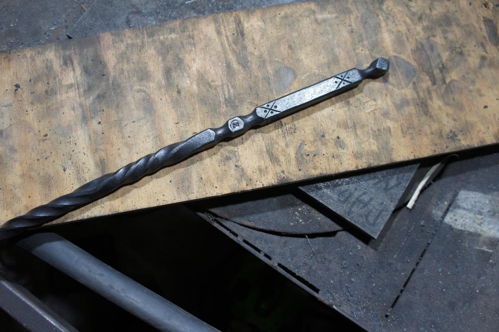

jlpservicesinc Posted December 15, 2021 Share Posted December 15, 2021 Thank guys.. It's 6, 3/16" square stock pieces.. Should be 7 to keep the twists even.. they are turned opposites to give them shine. (contrast) so it's best to have them always have the left and right twists be there vs left, left or right, right. The ideal is to keep the left to right bars from appearing next to each other.. Das, I like 3/8" square for shanks.. Keep this in mind when making handles, if the basket fits the hand well the shaft weight almost disappears. Just like all tools the difference between a good tool and a great tool is usually how it feels in the hand. So with this, I have a tendency to only taper small or short length tools that have funky handles. 3/8" is the smallest I will go on a long poker because people have a tendency to use them as pry bars.. The video on this topic on the YT channel covers the basics of how this was made. Quote Link to comment Share on other sites More sharing options...

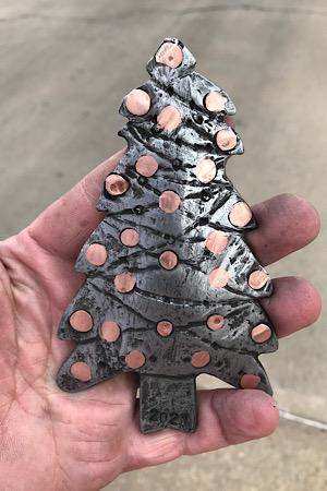

Donal Harris Posted December 15, 2021 Share Posted December 15, 2021 I’ve never seen a basket twist like that before. I can see it would be nice on a curtain rod too. Frazier, how did you get the fullering so even? Still not finished with it. The etching didn’t go well. I soaked it in muriatic acid for 26 minutes, then another 26 minutes, then another 26. Still not etched well. Added hydrogen peroxide and soaked it for 26 minutes, and then again. Much of the grain is really just scratches from the grinder and sand paper. Tonight I may take it down to 1000 grit and soak it for 2 hours. Looking at it I am reminded of the cups and plates my daughters would make me in preschool. Quote Link to comment Share on other sites More sharing options...
TWISTEDWILLOW Posted December 15, 2021 Share Posted December 15, 2021 I think it’s coming along nicely DHarris! Quote Link to comment Share on other sites More sharing options...
Frazer Posted December 15, 2021 Share Posted December 15, 2021 I used fullering dies in my guillotine tool, but a spring/gate fuller would do just as well. Depth controlled with heat and hammer control. It's easy enough to do by eye. I like the tree, very festive. Do you think ferric chloride would etch it any better? Quote Link to comment Share on other sites More sharing options...
Chad J. Posted December 15, 2021 Share Posted December 15, 2021 Did you vary the twist pattern on the pieces? Edit: This was meant for JLP on her basket handle Quote Link to comment Share on other sites More sharing options...
Donal Harris Posted December 15, 2021 Share Posted December 15, 2021 Not sure. I use either vinegar and H2O2 or muriatic acid or muriatic acid and H2O2 because that is what I have. I usually use vinegar and H2O2 because I don’t have to worry as much about the timing and it is easier to handle. My problem here is the copper. Vinegar and H2O2 eats copper rapidly. I wanted to use smaller wire, but snapped the bit. Then snapped the next bit and the next. I should have used the drill press instead of a hand drill. Quote Link to comment Share on other sites More sharing options...
jlpservicesinc Posted December 15, 2021 Share Posted December 15, 2021 Frazer, Excellent advice. Dharris.. Love the tree. Chad J. only variation is left hand and right hand turns.. The turns will change based on which way you twist the handle before the basket it opened.. In other words depending on CW vs CCW will make some of the bars tighter twisted and some will open a little. Ideally if someone want to figure out the exact ratio it might be worth it to make them look perfect.. For me, clean forge work is important.. I actually have a tendency to leave defects in now depending on where the product is going.. Quote Link to comment Share on other sites More sharing options...

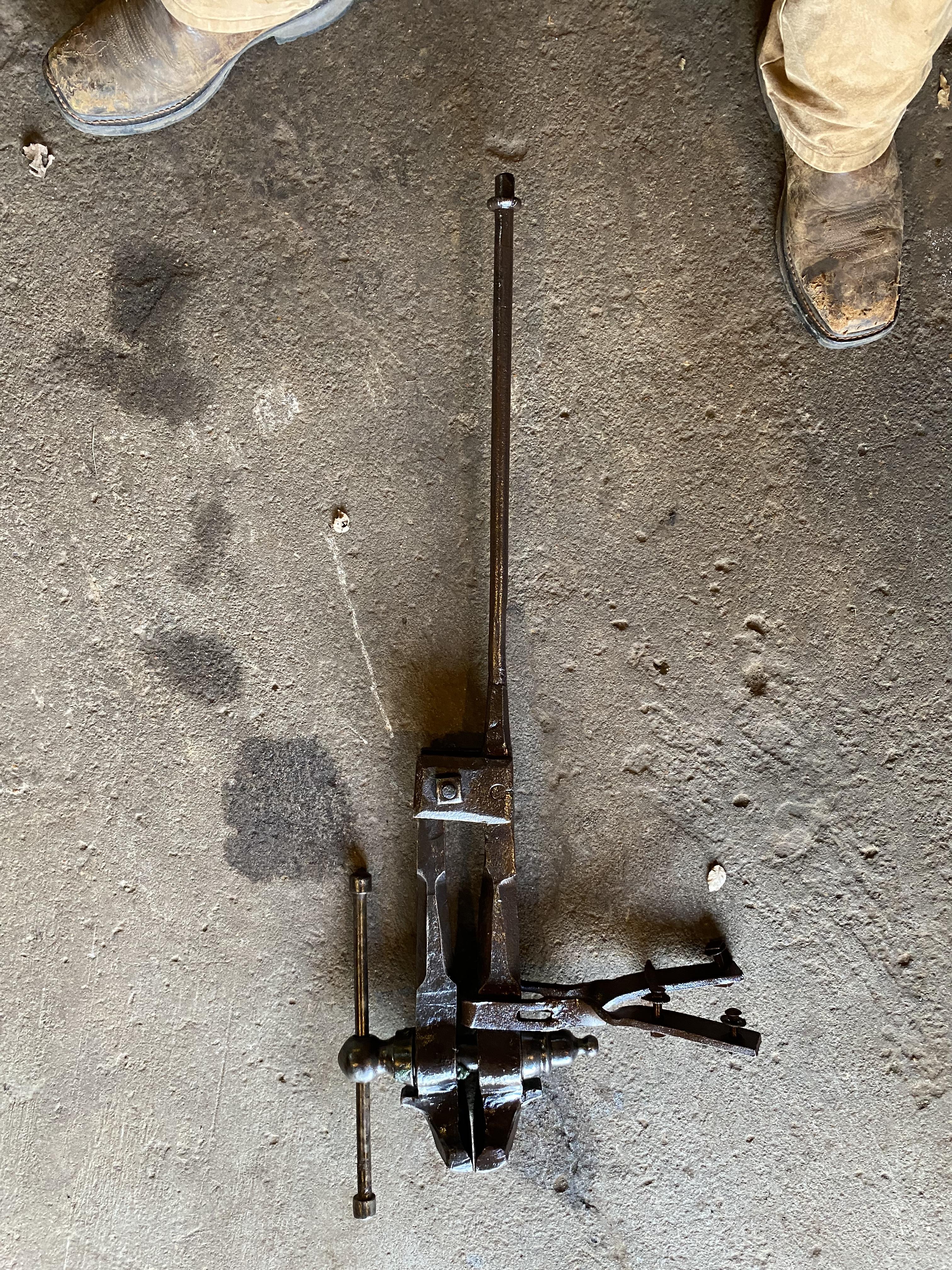

TWISTEDWILLOW Posted December 15, 2021 Share Posted December 15, 2021 Today I tore Down one of the post vises I picked up yesterday, i wire wheeled every part including inside the screw box cleaned everything up then oiled and greased it an put it back together I didn’t find any brand identification on this one just a weight stamp for 35 pounds and a serial number 1001 on the leg side, and a number 27 on the screw box, I think it’s a nice little vise, I’ve been hunting for a little and lighter one to make portable to go with my tiny Buffalo pancake forge, well that an because I’m to lazy to pack around my heavier ones lol, I still gotta make a spring and wedge for it but other then that it’s complete, then I’ll start looking at making a portable stand for it, Quote Link to comment Share on other sites More sharing options...

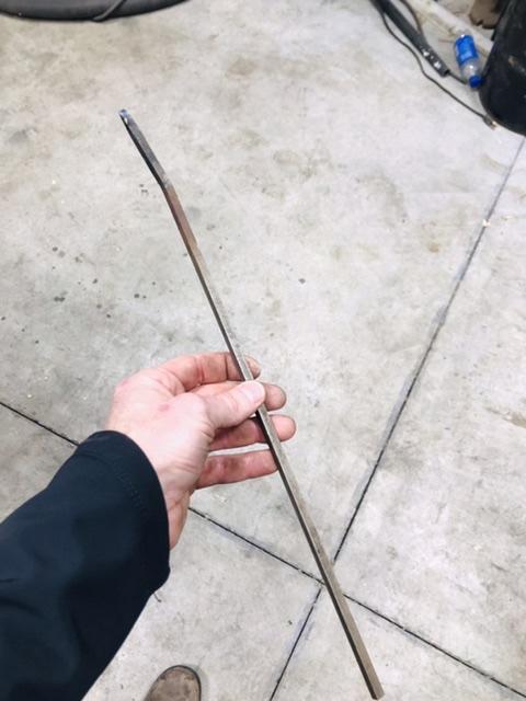

Goods Posted December 16, 2021 Share Posted December 16, 2021 Today, I truly appreciated having the forge at my disposal. Went the change the bulbs for the headlights on my wife’s van. Talk about a crowded. I could barely get my hand in to get to the bulbs let alone release the catch for the wire connector. The wire harness was so short couldn’t even get I into a good place with the bulb out but still connected. 5 minutes later with a piece of 1/4” square stock, ball peen hammer, a little grinding, and post vice for making a compound bend; I had an offset pry bar/screwdriver to easily pop the release tab. Never thought that would come out of my shop, but it saved many hours of cursing. (Ok, it never left the building…) David Quote Link to comment Share on other sites More sharing options...

George N. M. Posted December 16, 2021 Share Posted December 16, 2021 Goods, that is the first step on your journey of thinking like a blacksmith. The next is when you think nothing of making a tool to make the tool you need. Being able to do things like this just makes life easier. "By hammer and hand all arts do stand" Quote Link to comment Share on other sites More sharing options...
