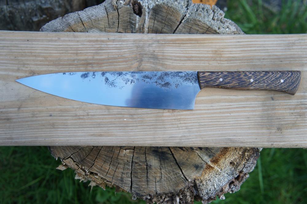

  17. Very nice! Another tool in the toolbox. It looks like the less refined wrought you found is working well for you. Have you tried canister damascus for the bit yet?

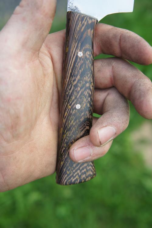

  22. Thanks Jennifer. MJ, Stabilized wenge. Over time the cactus juice has taken on some color from the different woods I've stabilized (padauk seems to dye it the most). Now when I cure it all the grains that get filled in have that coppery-amber look.

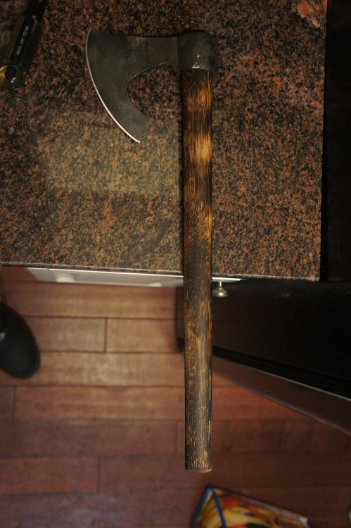

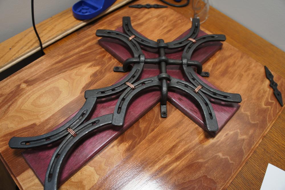

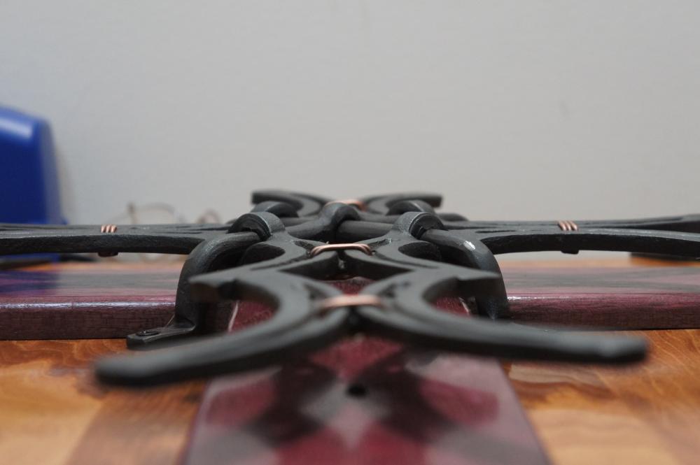

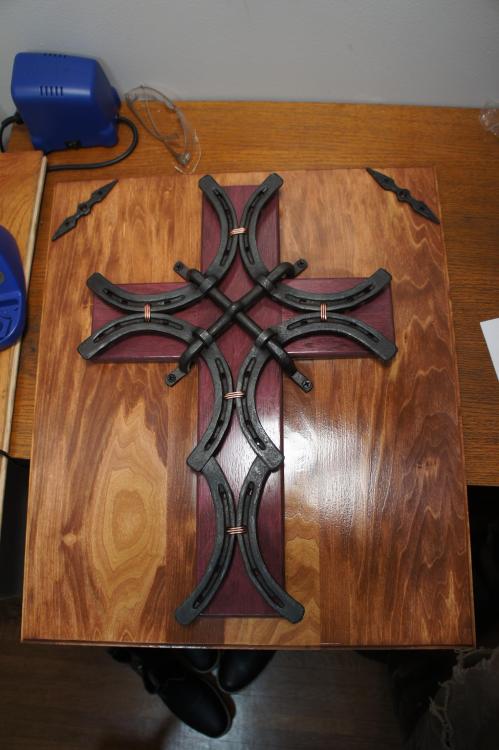

  24. It's been a little while since I popped in here.. Updating with a few projects I've finished recently that are worth sharing.. Horseshoe cross, purple heart cross & stained poplar mounting board. 1095 8" chef knife 19" (handle) bearded tomahawk from Niagara region demo.
