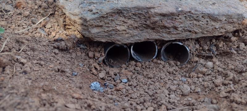

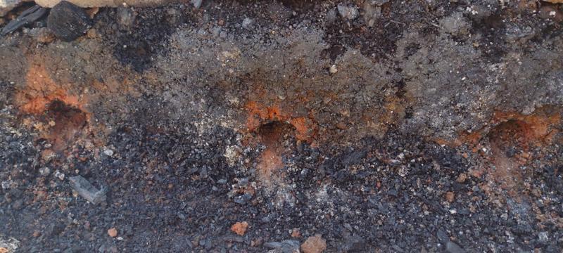

  4. I cleaned out the "fire box" to get a picture of the tyure. You can see the three openings in the bottom of the "fire box". And here is what is under the rock. I found that I could turn the hairdrier left, right, center, to control the blast over the length of the fire. and could move it closer, or farther to control the amount of air. Nothing fancy, and works very well.

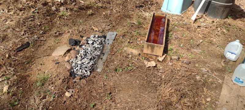

  5. You all have heard of the JABOD forge, Well for those without the "B" in JABOD. There is an alternative. JAHIG (Just A Hole in Ground) forge. Today, I had a need for a forge that could heat the length of a 20" blade. Evenly, without having to slide it back and forth through the fire. So, I dug a trench in the ground long enough to accommodate the blade. I used a three legged tuyre to allow even airflow over the length of the fire. 3 pieces of 11/4" tubing about 14" long, installed like chicken toes, in a side blast. Fired it with charcoal, and air was a hair drier. Worked very well. Forge on left, quench tank on right. The large flat rock to left of forge is where the three air pipes meet together. Hair drier rested on the chunk of charcoal to the far left, pointing toward the flat stone. Heated the blade to non magnetic in about 15 minutes, with a very low blast. Quench tank is wood box, with water, and an inch of oil on top.

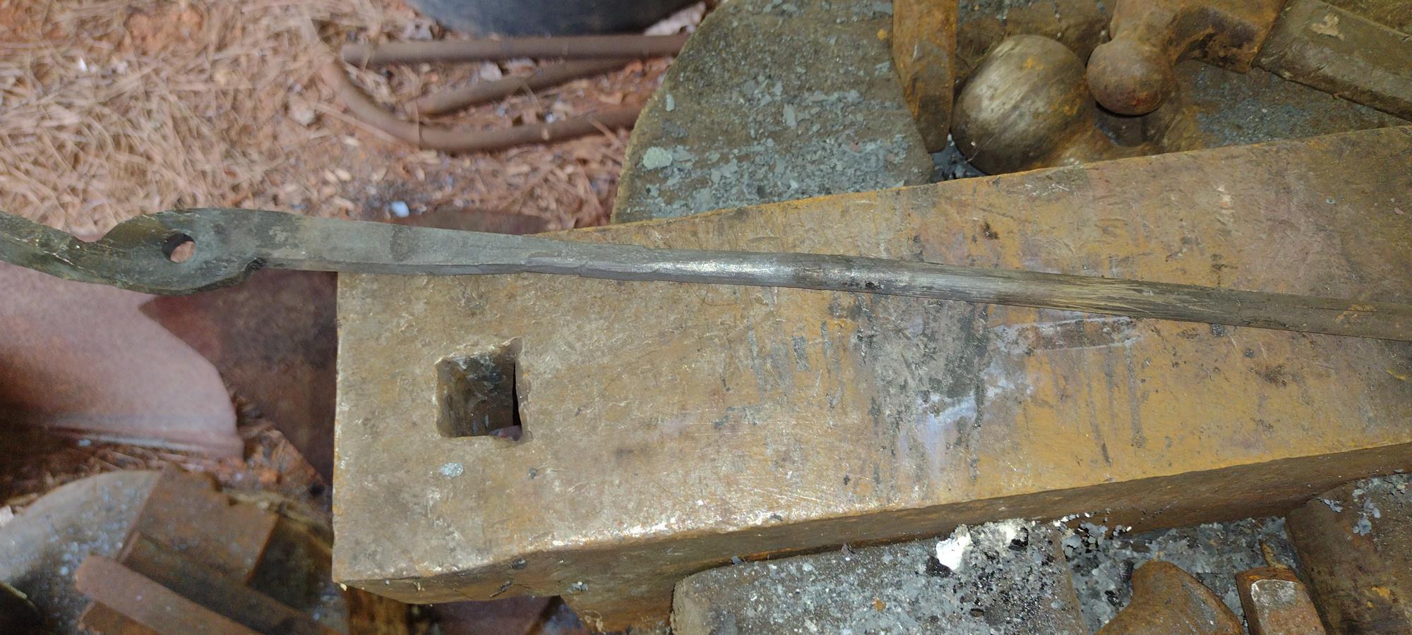

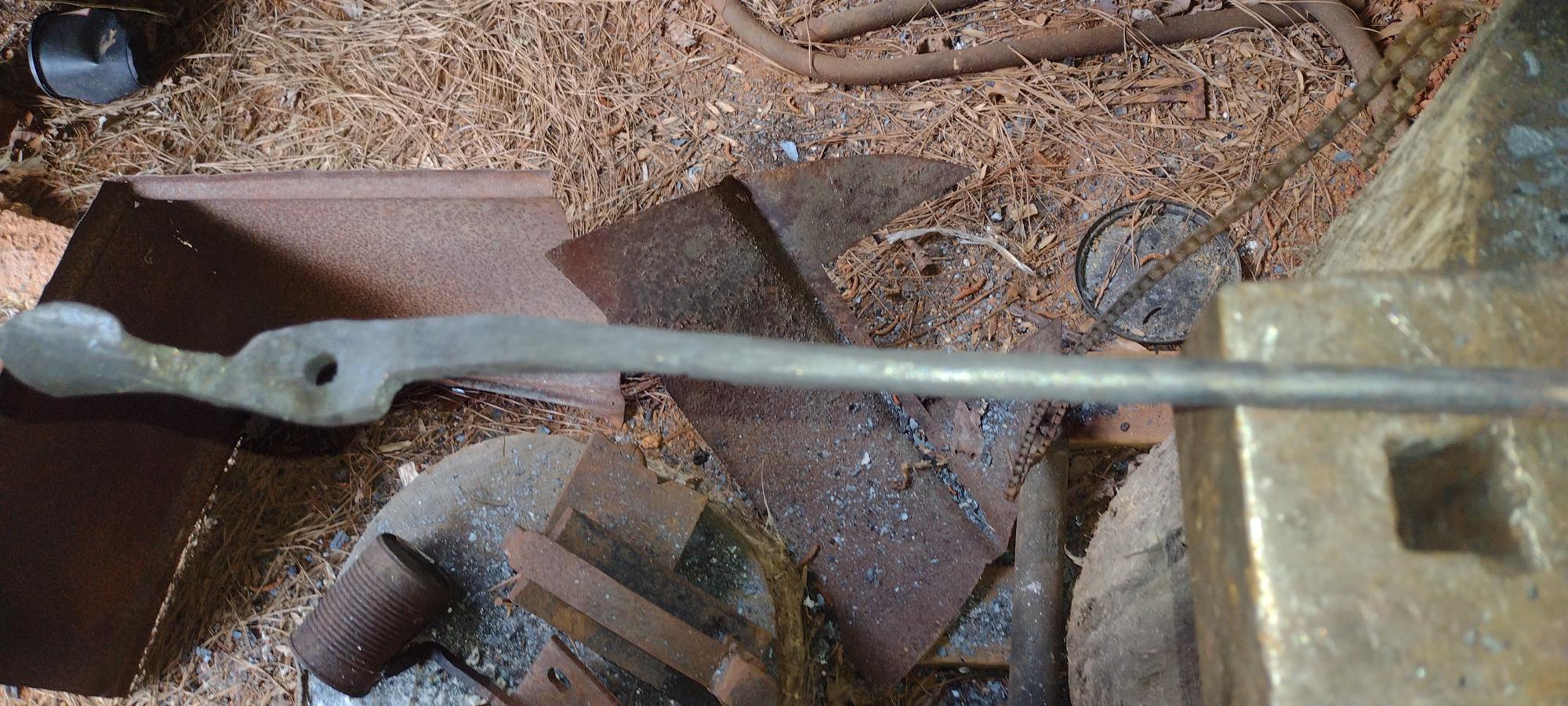

  10. Spent a couple of hours out to the forge. Cut off a chunk of coil spring, straightened it out, drew it down to about 5/16" thick, and about an inch wide, for a future project. Then worked on a wheat twist for a handle. Got one end welded with the help of my spring swage, Got it started on the taper for a curl, then set about the weld on the other end. For some reason the weld won't take. It acts like it set nicely, then when I go about finishing it , it blows apart. Now it's been squished down to a point where I've got to upset it before I can try again. Or just add it to the "wall of shame".

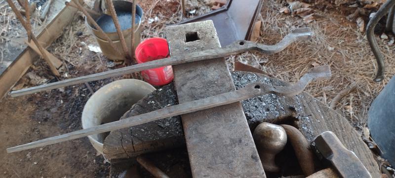

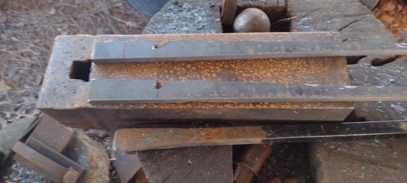

  13. Got some forge time in today. got a start on V bit tongs. I cut blanks out of some 3/8" flat stock yesterday. The notch cut in was due to the plan for twisted slot jaws. But i changed my mind, and found that it caused me problems later on. That problem really stands out in this pic: I'll weld that spot together and see how it works out. As it stands its a weak spot, and I'm afraid it will snap off when I go to adjust the jaws. And I may draw the reins a bit more.

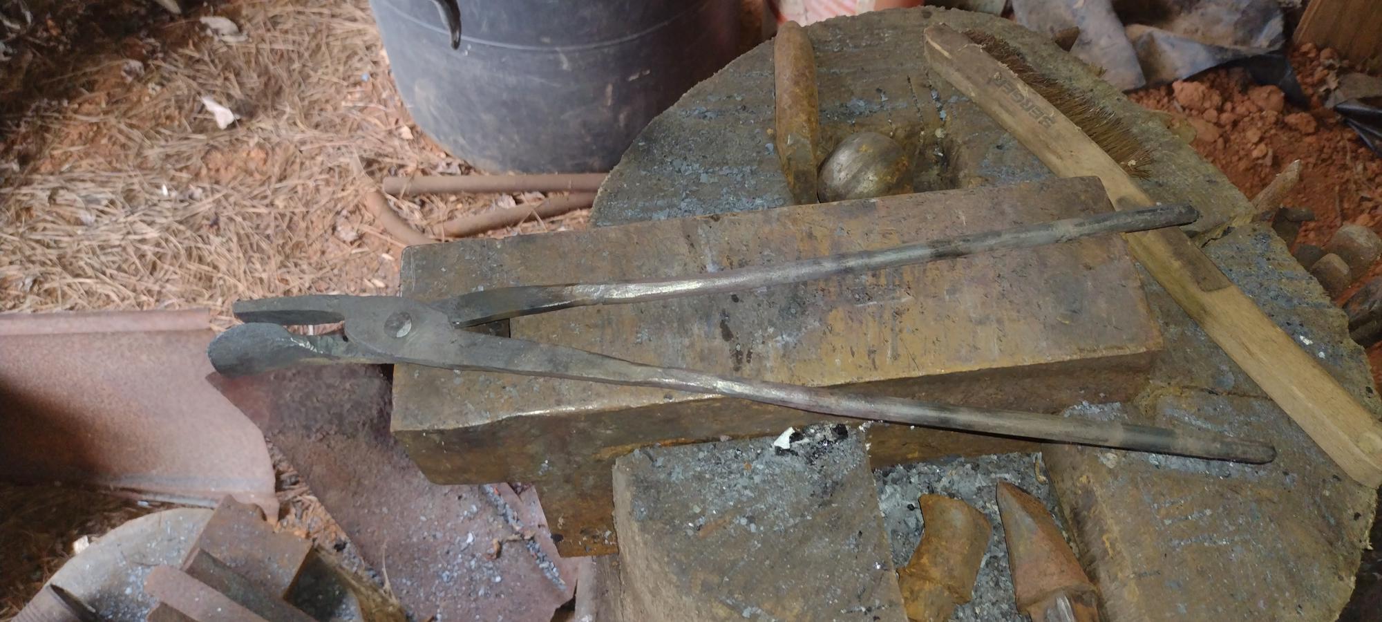

  23. Alexandr, Fantastic work as usual. That Chandelier is being shipped to Georgia, U.S.A. right? I have the perfect spot in my living room for it, or one like it.
