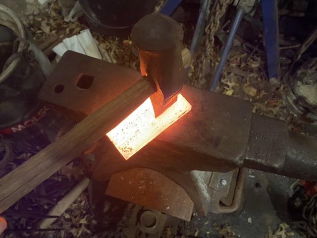

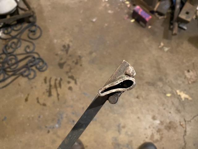

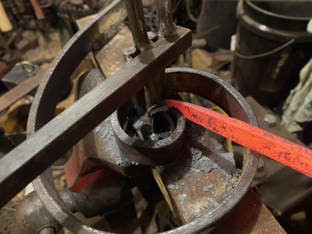

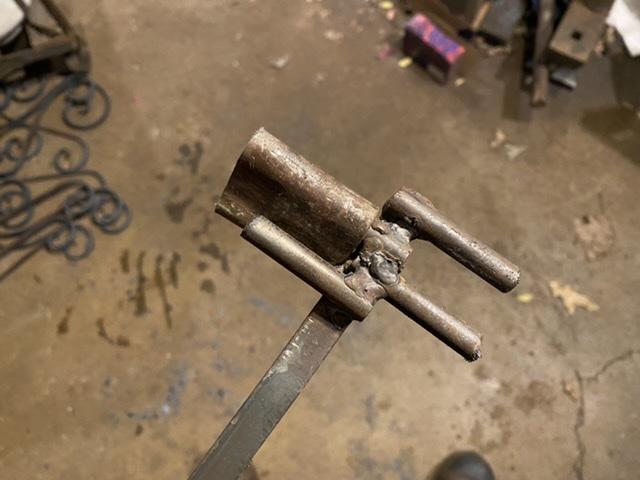

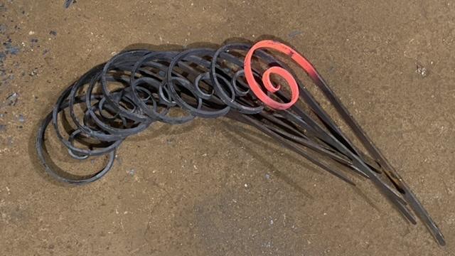

JHCC Posted December 10, 2021 Share Posted December 10, 2021 Lots of scroll making for another commission: Which got a lot easier when I converted one side of my smallest scrolling wrench into a cam that I could use to wedge the tip of the scroll in place: Also split one of my chunks of S7 into three strips that I’ll make into punches or something eventually. Man, I love that treadle hammer. Quote Link to comment Share on other sites More sharing options...

JHCC Posted December 10, 2021 Share Posted December 10, 2021 This one was already in progress, actually. However, since it’s not going to be needed until June, I had no compunction about shelving it while the sign bracket was in progress. Quote Link to comment Share on other sites More sharing options...

BillyBones Posted December 10, 2021 Share Posted December 10, 2021 JHCC, that is quite the idea for the wrench there. I did a pile of scrolls over the summer and wish i would have thought of that. Hondo, wish you were closer i would tell you to come over and get some of this pile of tubing i acquired. Tore apart a couple porch swings square and round tubing. Jobtiel, nice hatchet. I like that shape. Quote Link to comment Share on other sites More sharing options...
JHCC Posted December 10, 2021 Share Posted December 10, 2021 Thanks, BillyBones. I think I'm going to weld that bit of pipe permanently in place, as it currently only works counterclockwise. Quote Link to comment Share on other sites More sharing options...
ThomasPowers Posted December 10, 2021 Share Posted December 10, 2021 Widdershins! Perhaps you should make another with a fixture on either side, one for deosil and the other for widdershins. Marking them to make it easy to use the correct side "is left as an exercise for the student"... Quote Link to comment Share on other sites More sharing options...

JHCC Posted December 10, 2021 Share Posted December 10, 2021 Speaking of which, I still have the Kevlar glove you left behind a few sessions ago, as well as the block plane and the chunks of S7 you wanted to buy. Also, it's kind of amazing how quiet the treadle hammer can be: Quote Link to comment Share on other sites More sharing options...

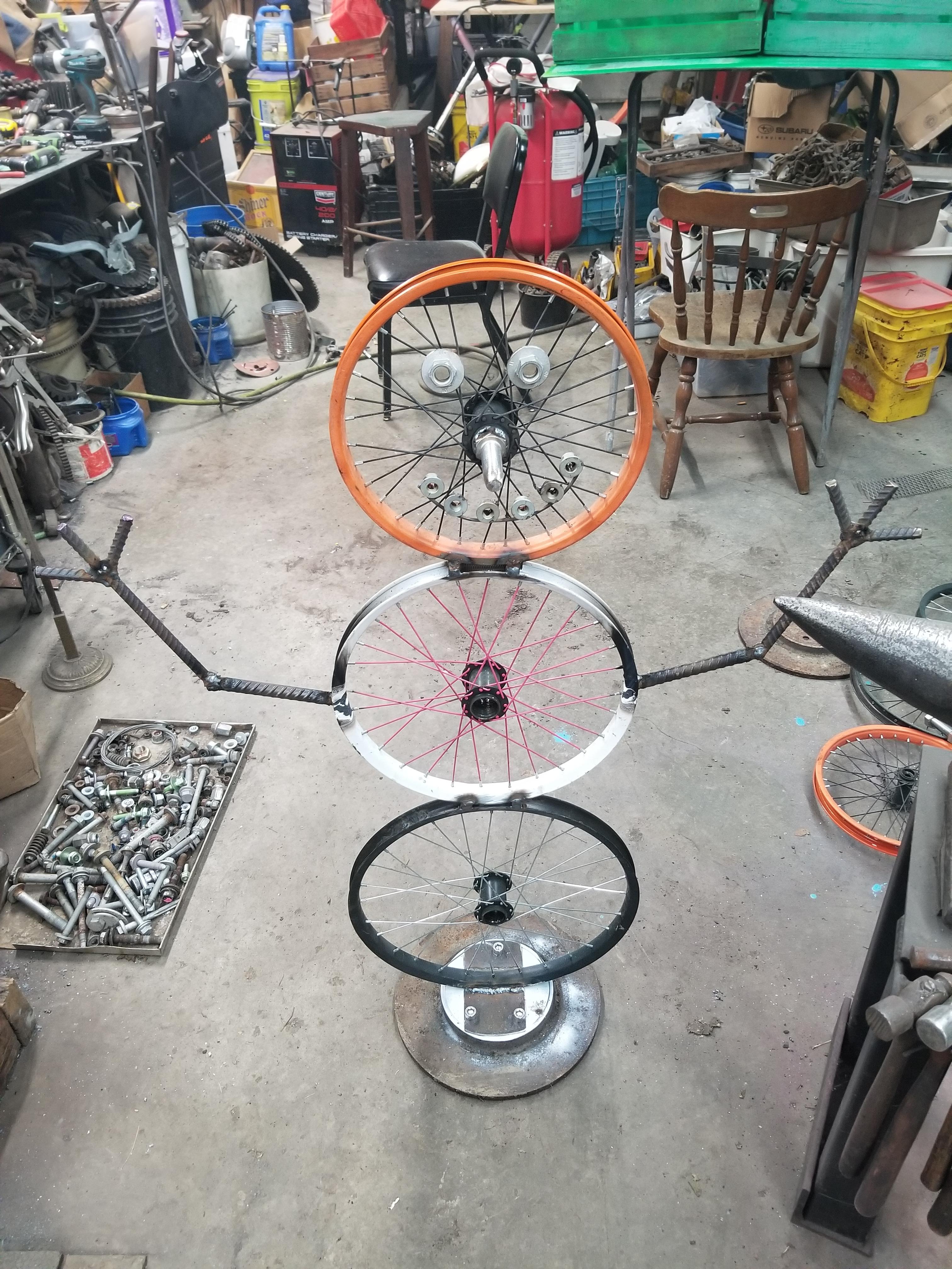

Daswulf Posted December 11, 2021 Share Posted December 11, 2021 Working on a snowman from bicycle wheels and some rebar. Brake rotor for the base. This is a concept piece so its a little rough right now. Trying to think of a better sellable pose with his arms. Wheels are bigger bottom to top but the perspective makes it look different. Also, it will get painted. Quote Link to comment Share on other sites More sharing options...
Frosty Posted December 11, 2021 Share Posted December 11, 2021 One arm could be holding a pipe as if ready to take a draw. Or holding a broom or snow shovel. Tongs in one hand and hammer in the other is maybe a limited market. Frosty The Lucky Quote Link to comment Share on other sites More sharing options...

Daswulf Posted December 11, 2021 Share Posted December 11, 2021 I like the shovel or broom idea Frosty. Quote Link to comment Share on other sites More sharing options...

Frosty Posted December 11, 2021 Share Posted December 11, 2021 4 hours ago, Daswulf said: I like the shovel or broom idea Frosty. How about tipping his top nut? A snowwoman would have two acorn nuts below the head. no? Frosty The Lucky Quote Link to comment Share on other sites More sharing options...

lary Posted December 12, 2021 Share Posted December 12, 2021 Daswulf I can see using a front rim from a little girls bike for the head. That's a little tricky welding bushings and nuts on to those spokes. I like the concept. Quote Link to comment Share on other sites More sharing options...
