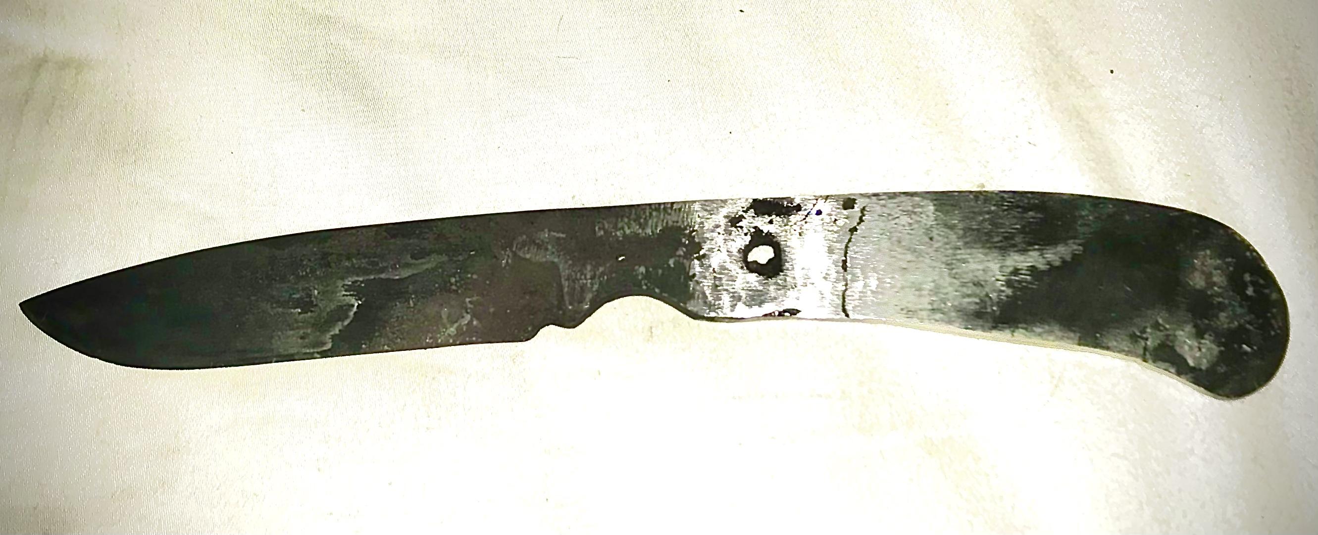

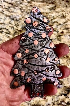

Looking at it I am reminded of the cups and plates  my daughters would make me in preschool.
Haha, I think it looks good. Its your first one so you are leaning what works and what doesn't. Being a bit heavy for the tree, maybe make it free standing to go on a table or shelf. I like the copper for the ornaments.
  • Replies 30.4k
  • Views 2.8m
Still have to put a hook on it for a hanger,  it it is what it is. Rather crude. I coated it with bees wax and BLO. Later I buy some clear coat so my daughter will not have to oil it.
The next one will be better.
That is a win DHarris. Don't feel bad about it. It isn't crude, it is perfect.
If you clearcoat it I recomend cleaning off the wax with heat and water, then once cool degrease it thoroughly and I prefer engine or exhaust spray can clearcoat. They hold up better in my experience.  They make gloss and matte.
Thanks. I will take them as I can.

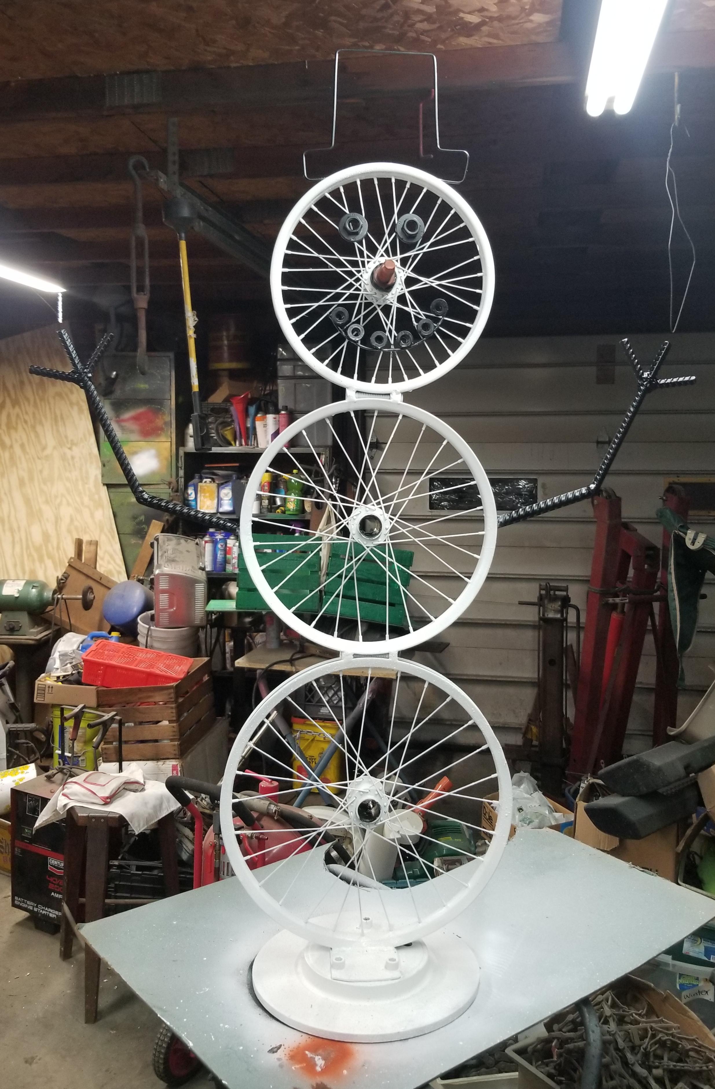

Got that frosty done last night. Now i just need an old scarf and hat. I gave him a wire top hat, but that can be used to hold up a real hat.

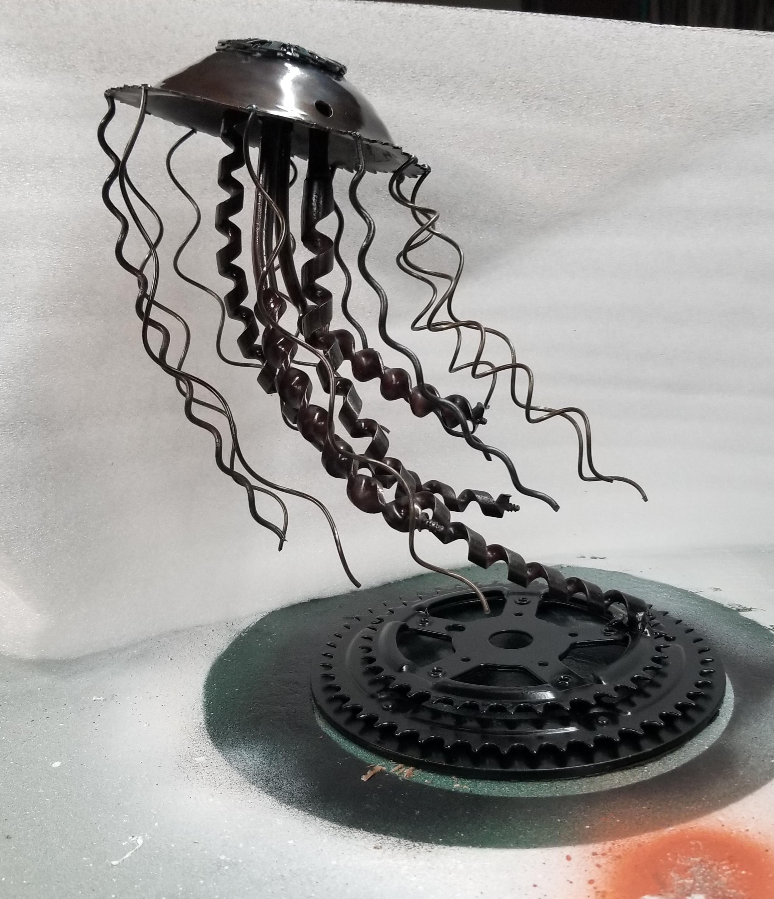

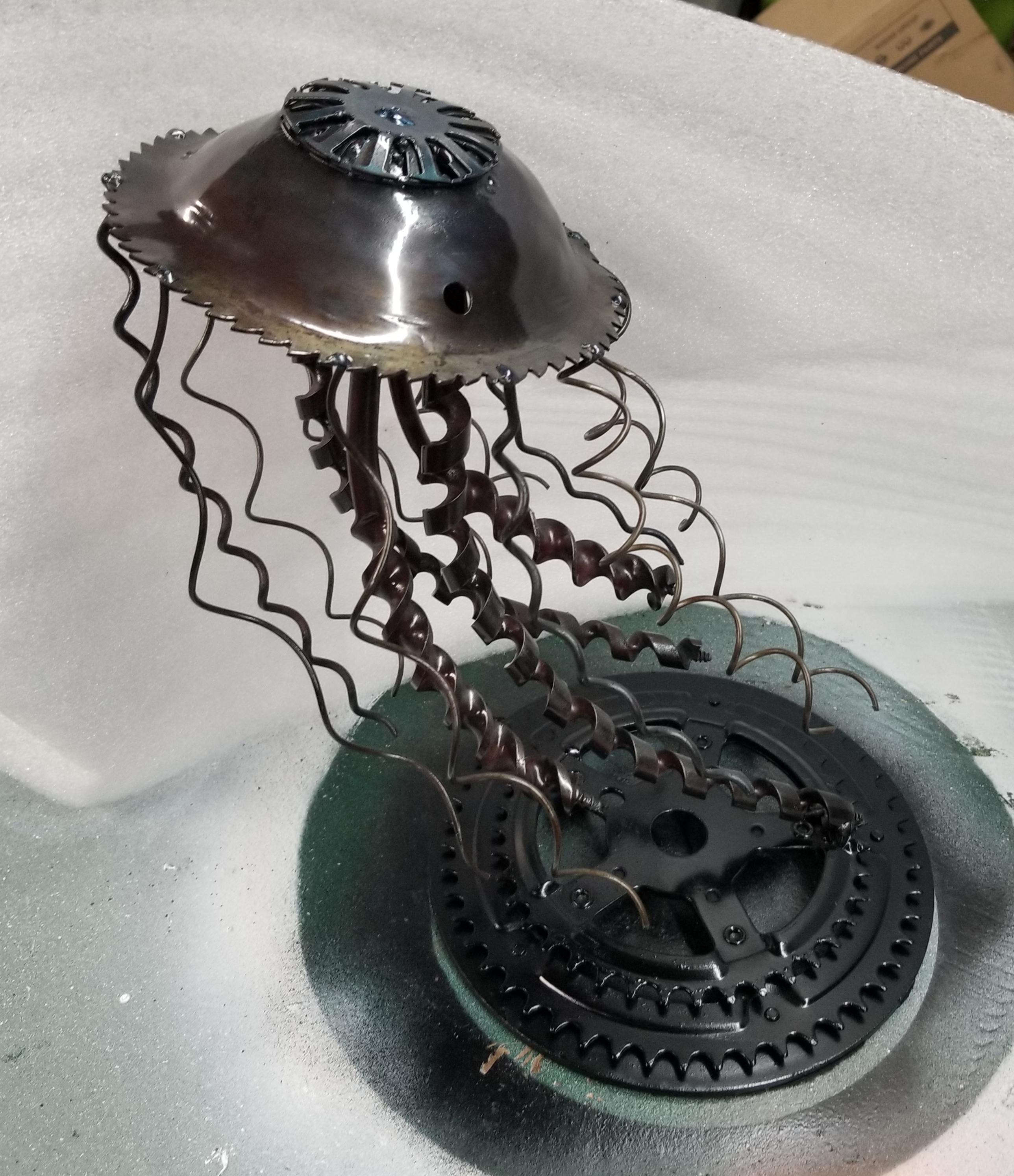

Also had a jellyfish laying around unfinished so I finished it.  I started this one after a commission of one I finished and mailed off a while ago. Years ago? Haha I dunno.
I remember liking the earlier one, Das. This one looks great, too -- terrific sense of movement.
Thanks John, TW.
The old brace bits and stretched out spring work great for the tentacle look. I was going to call them tendrils. Just now looked up the anatomical names and I guess the outers are tentacles and the inner are called oral arms. Always learning something new. We called all those parts "stingers" for obvious reasons lol.
Hey, I've got a bunch of big old auger bits that I have no use for, like this one:
Greenlee Nail eater 7/8-in Flex Auger Bit
Want me to pop them in the mail?
Dharris, the tree and knife look great. Das, your imagination never ceases to amaze me.

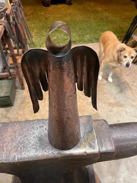

Made my wife a figurine to add to her decorations yesterday.

Les, Thanks.  Love the angel. Is it steel or copper?

Das, thanks it’s steel with a copper sulfate finish

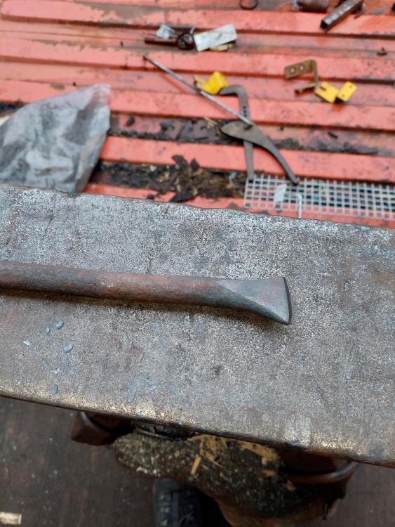

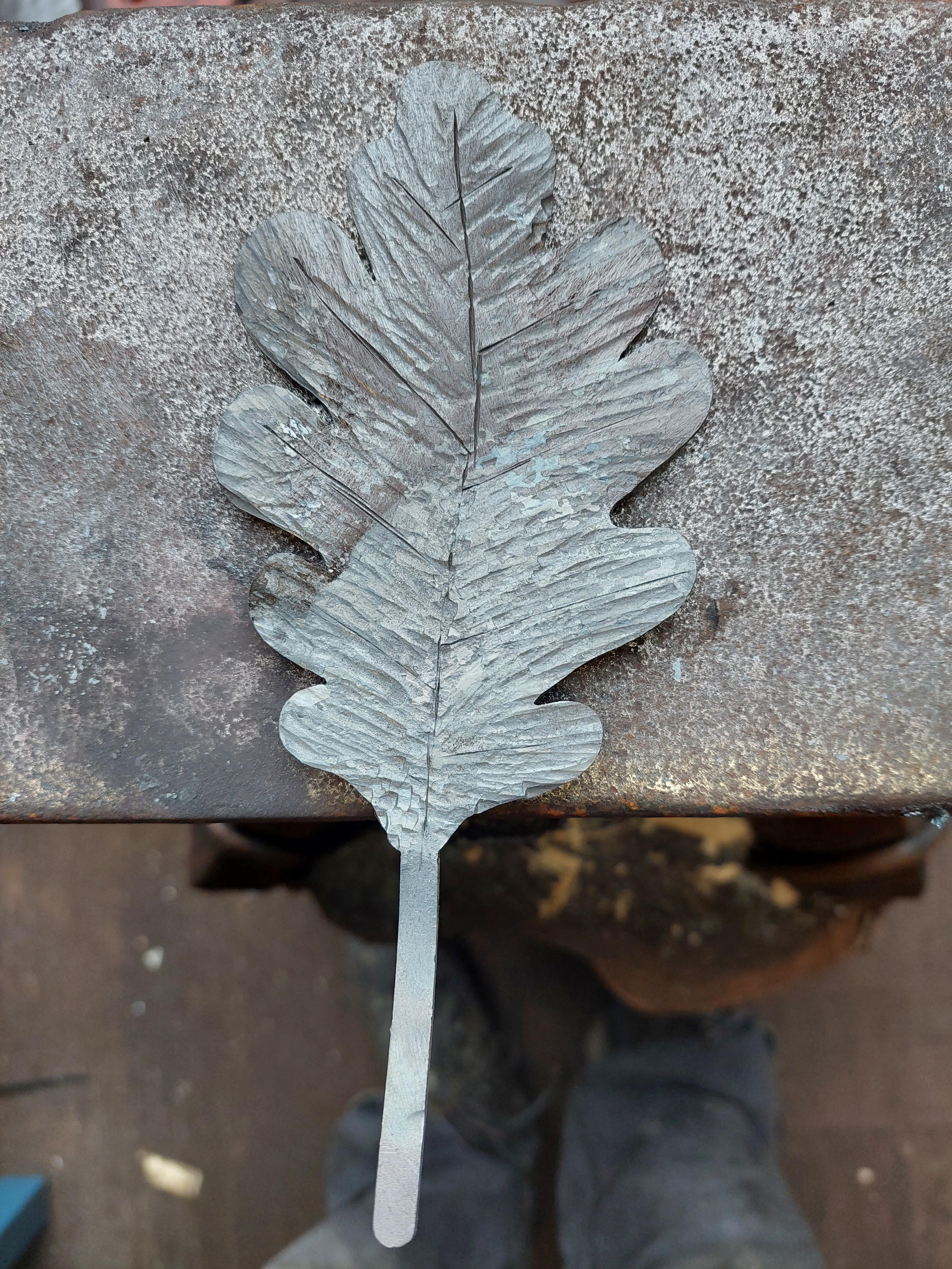

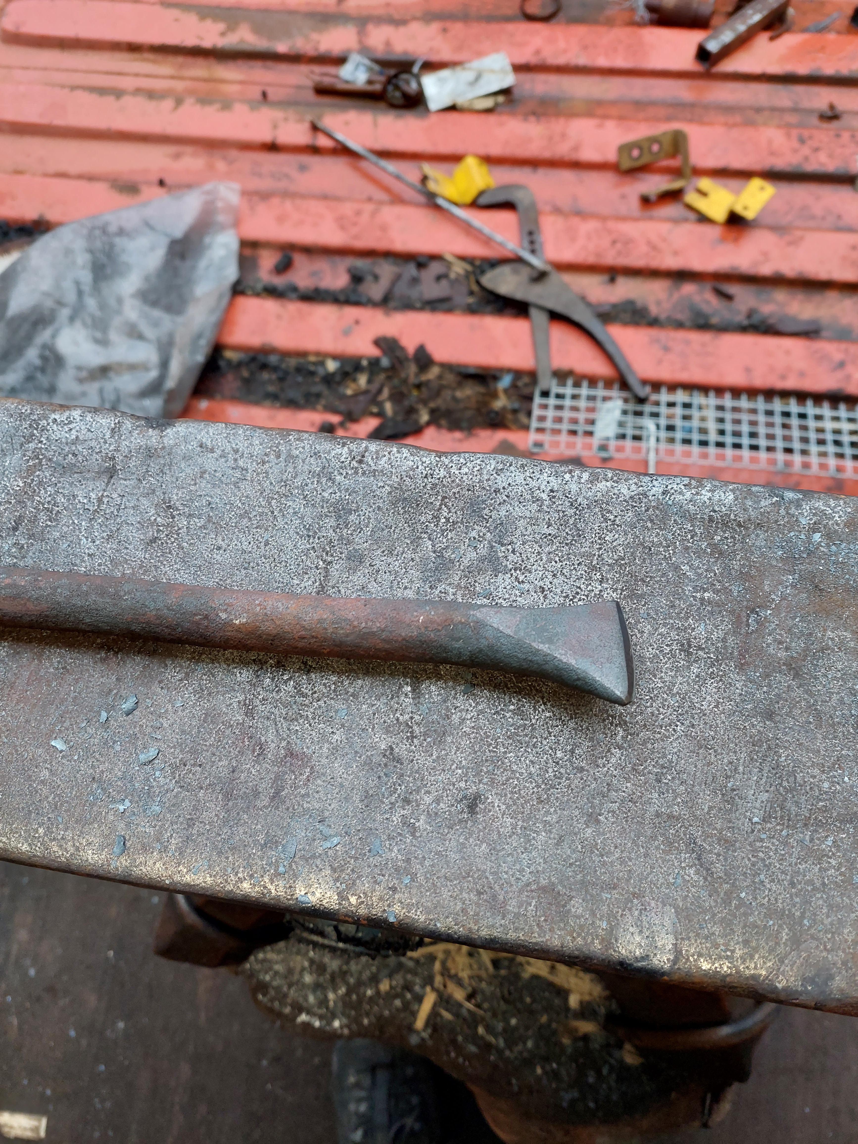

I had a productive morning, first I made a chisel from an old 4x4 anti sway bar. 20211218_134316.thumb.jpg.6a21357ac3cbbcad7a2d1c9d507f6da7.jpg

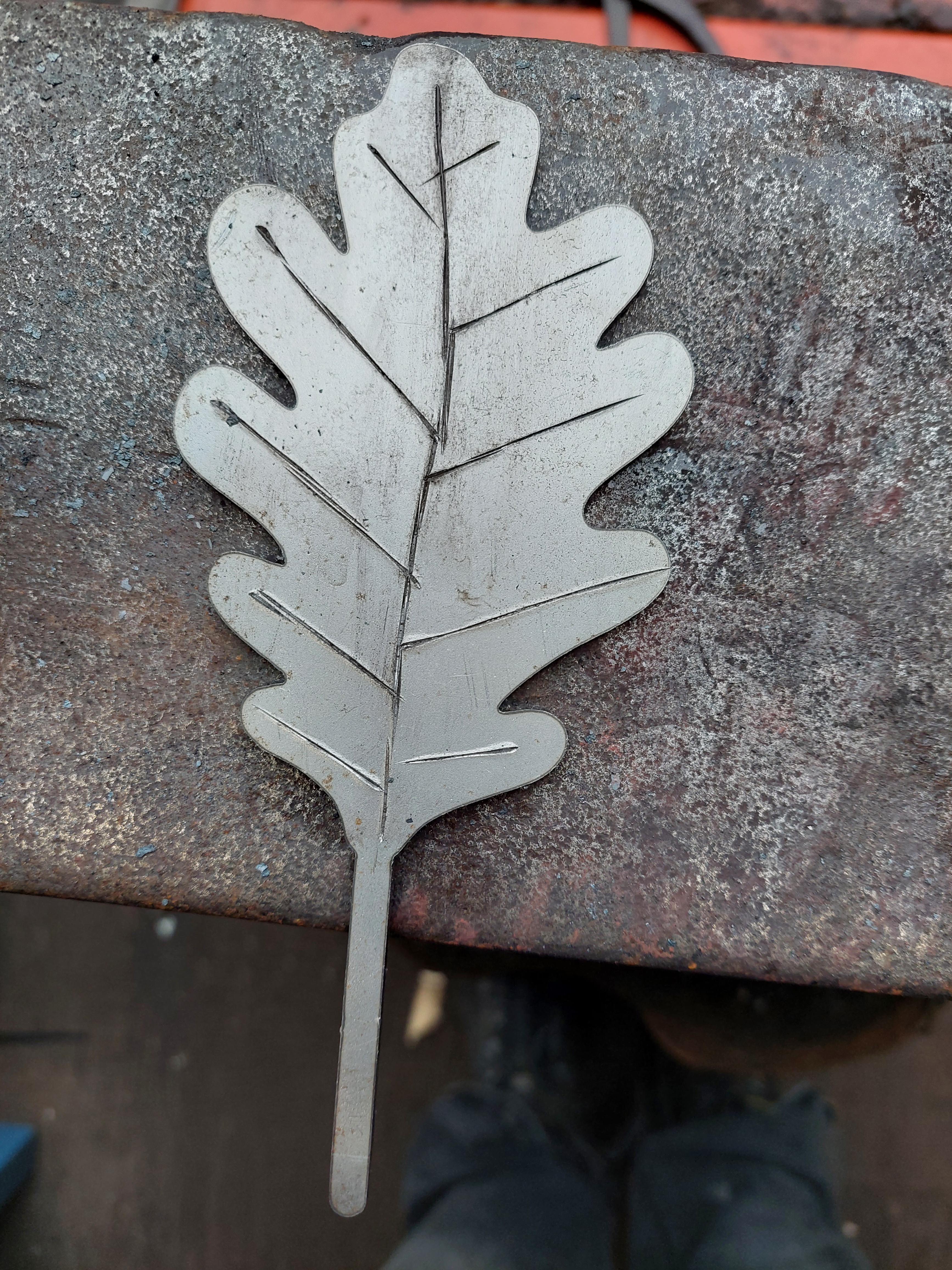

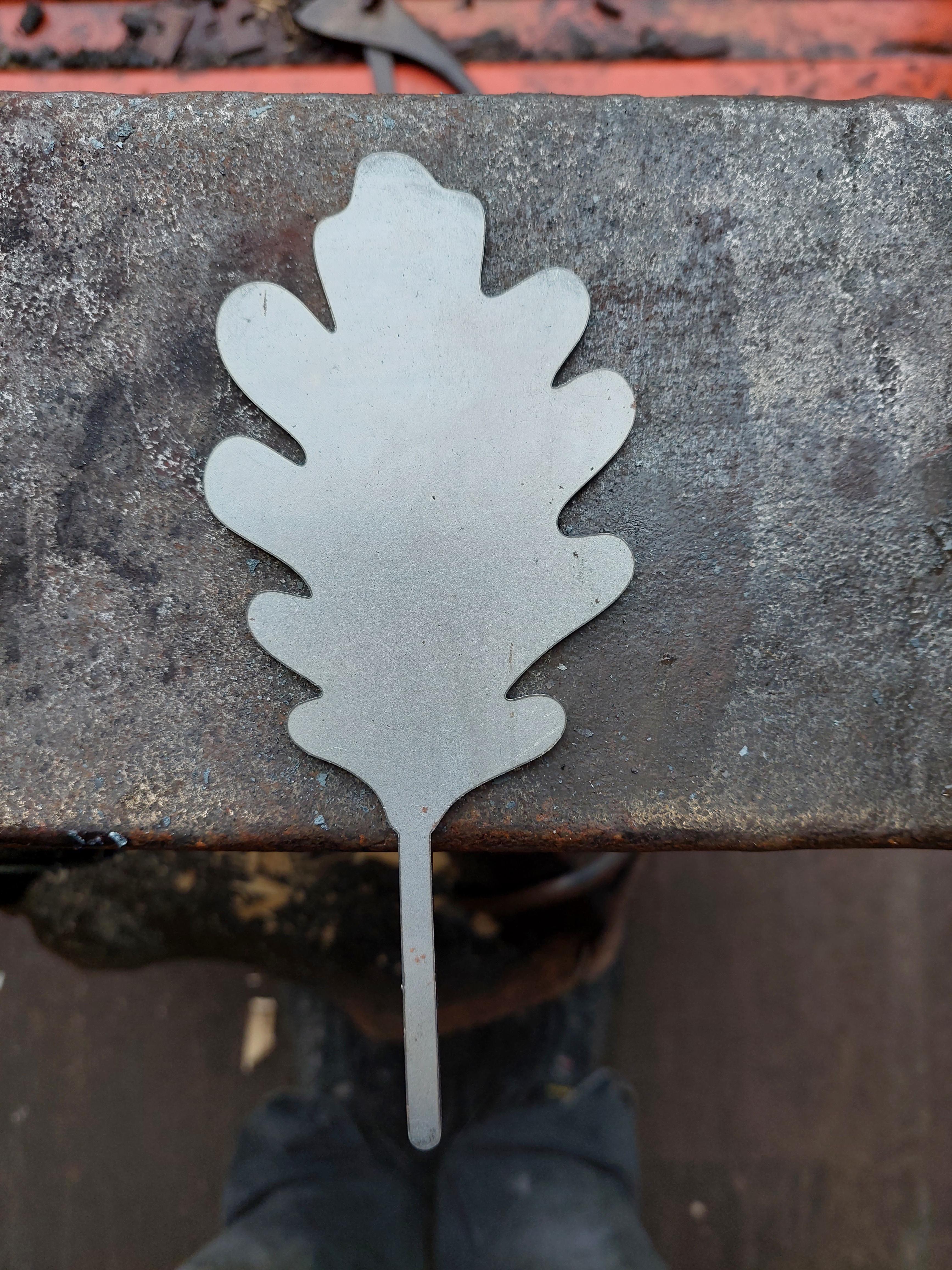

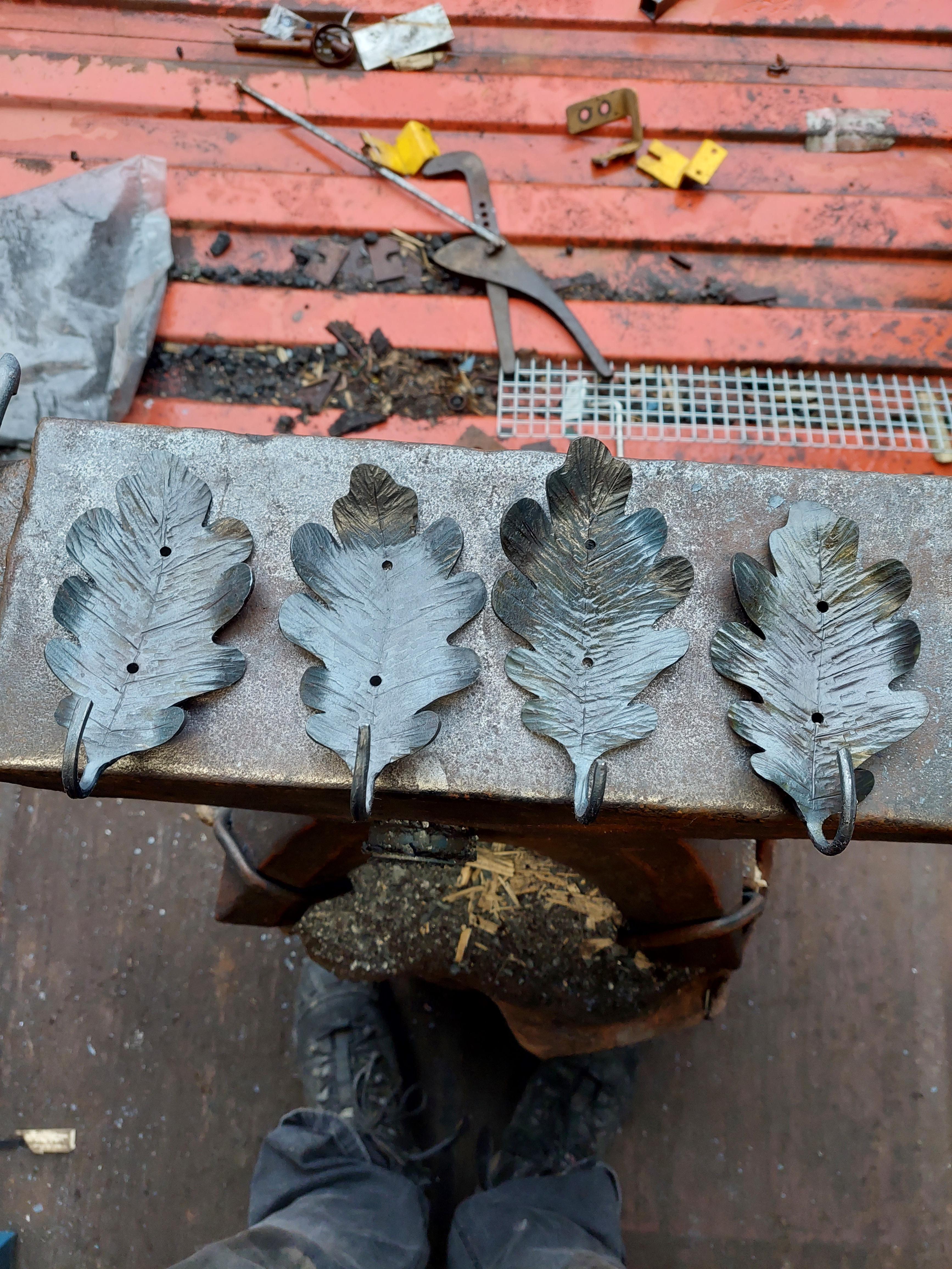

Then I took 4 of my oak leaf blanks and added veins with said chisel
20211218_110438.thumb.jpg.b7b33030facd46a824dee29256fb6889.jpga
Added some texture

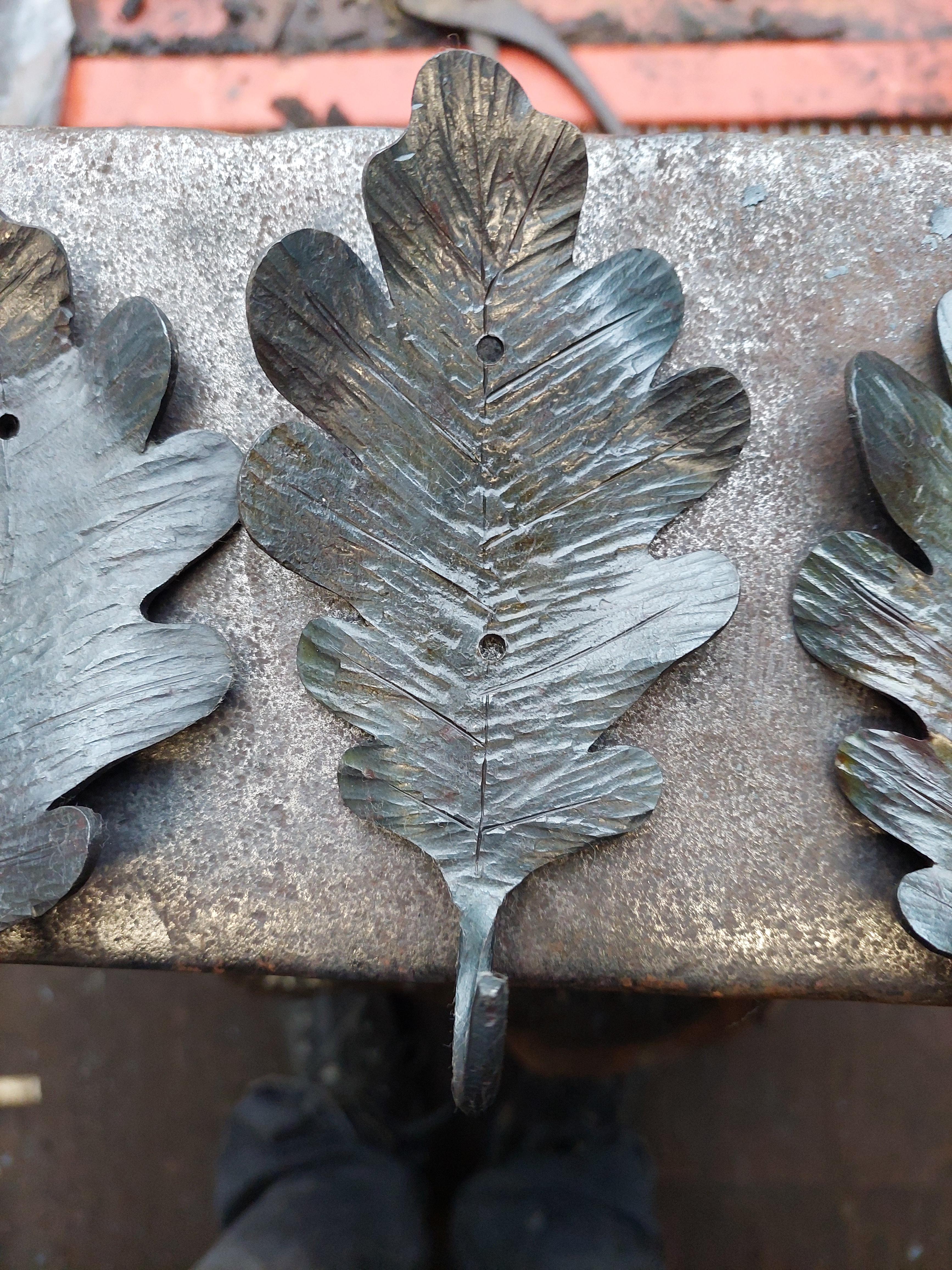

Finally curled the stems, bent them a bit round the edges and added mounting holes. 20211218_131328.thumb.jpg.6e82cfaa8ea922c0ff3b3ba59b43c8d4.jpg
Next part is to get some wood tomorrow and mount them to it and get them to my mum in time for Christmas.
Thanks Dax!
Those leaves look great.
I like a little duller chisel for veining leaves.  Good job making the tool you needed for the job.
Agreed. Having the edge be somewhat rounded rather than straight across will also help you follow the curves more smoothly without dinging up their edges.
You might also consider putting in the veins after adding the texture to make them stand out more.
Otherwise, looks great!
Thanks for the advice guys.  You can't tell from the photo but it is a very round chisel and I will dull it a bit for the next lot, I have 20 blanks because I knew it would be a learning curve.
Would you advise putting the veins in hot or cold? I did these cold with a sharp chisel.
I prefer to vein them hot. You'll want to watch how hard you hit while it is good and hot vs. as it starts to cool on you.

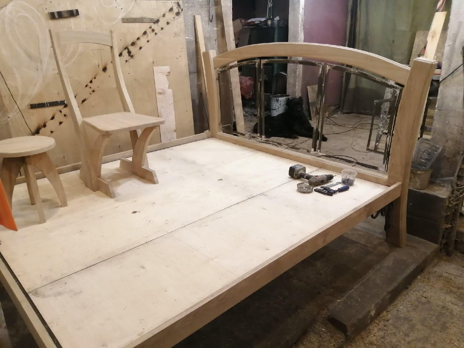

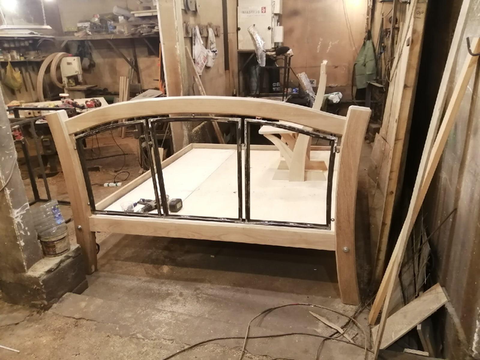

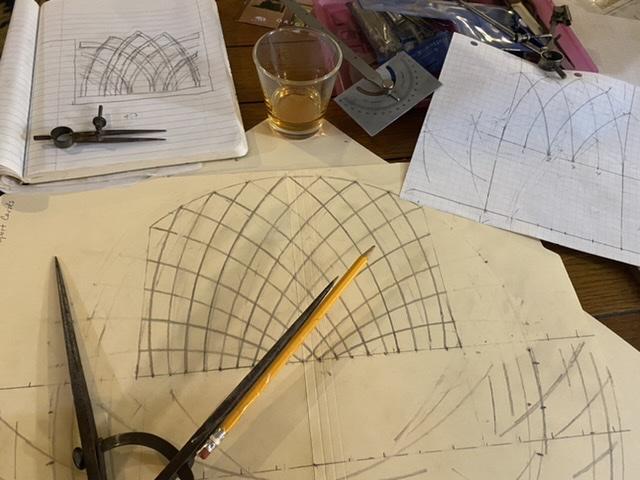

Design work:
Whatcha designing JHCC?
It kinda looks like a gate? or one of them things you plant grapes or vine plants around
Bingo. I will give it a go with a blunt chisel and whilst hot It will be a good excuse to make another chisel because I don't have the heart to blunt my first one ;)
Again thanks for the advice.
This is the latest concept for a gate between the family room and the kitchen.
Dax, think of it less as a blunt chisel, and more as a narrow fuller.
