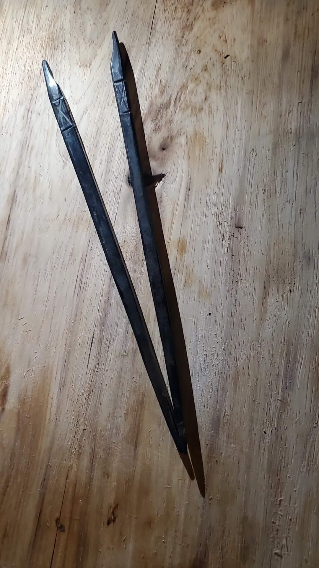

Chad J. Posted December 19, 2021 Share Posted December 19, 2021 Last couple of days I made a set of chopsticks, a couple s hooks, parts of a new set of fire pit tongs, a spoon for a utensil set I've wanted to make, started on the fork, the first of several dishing forms from old bearings, a chef's knife I just need to clean up some hammer marks, and cleaned up the hot shop a bit. I don't have ADD and focus issues at all... Anyway here are some pictures. I still haven't managed a forge weld, so the baskets are chisel cut. Quote Link to comment Share on other sites More sharing options...

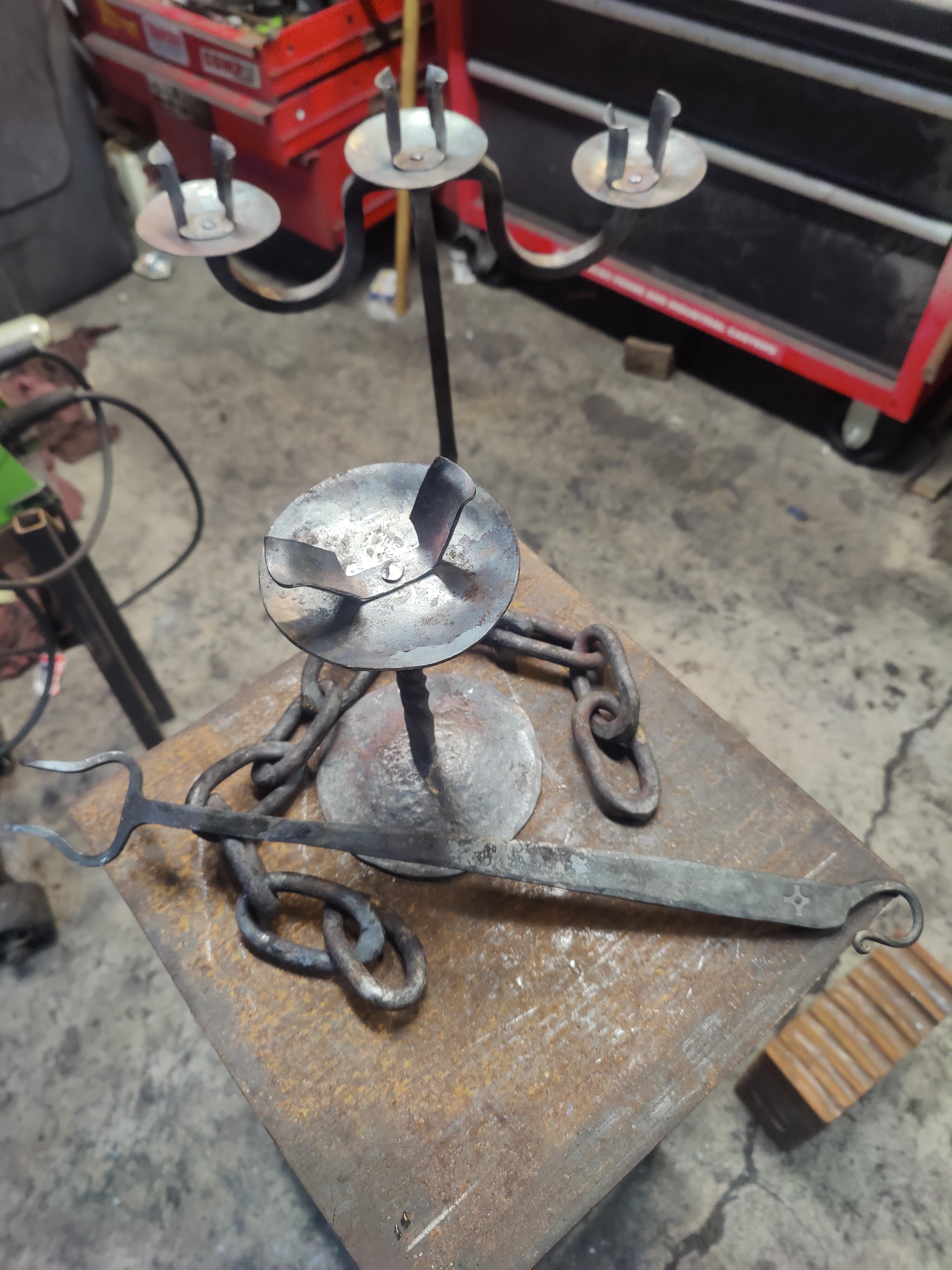

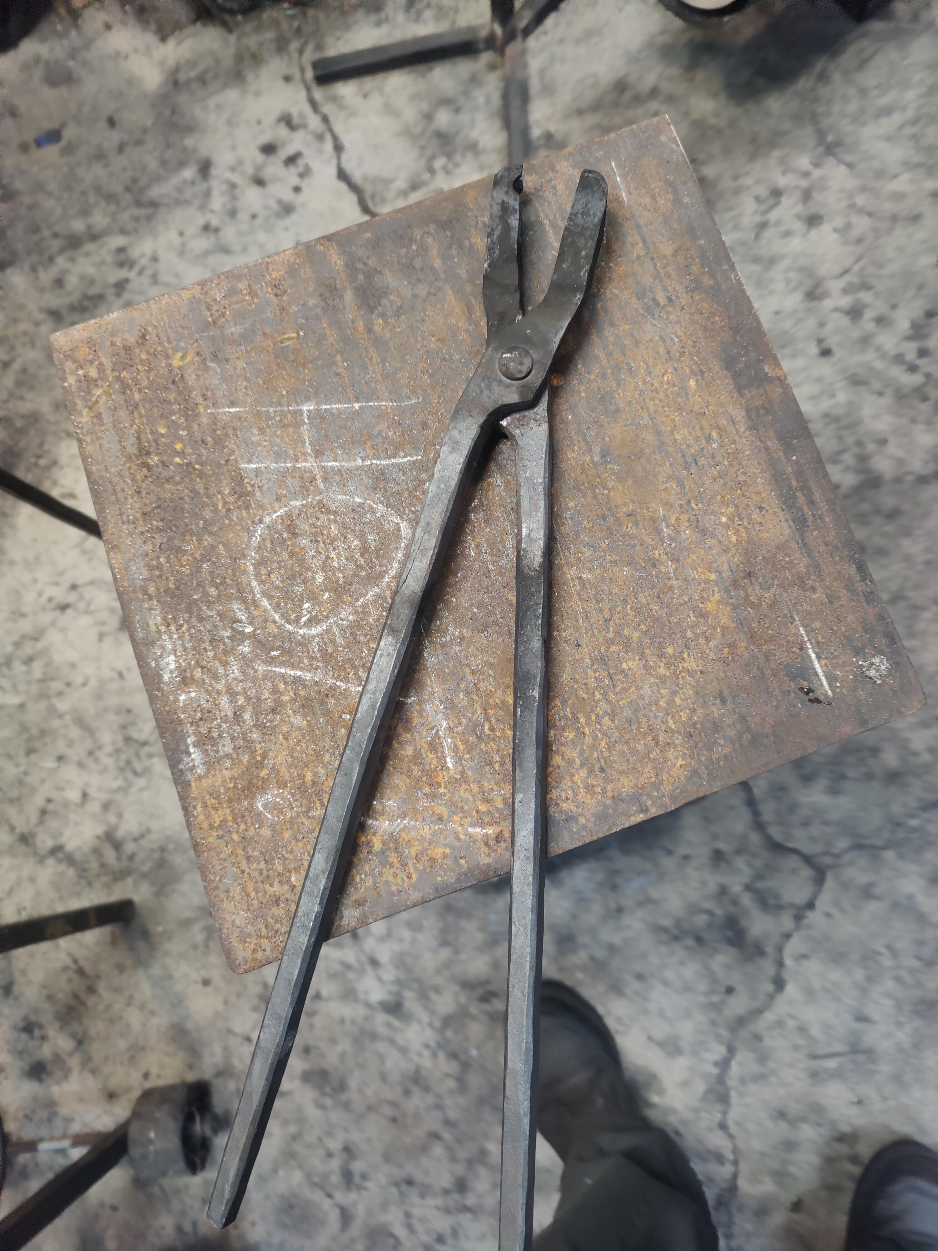

BillyBones Posted December 19, 2021 Share Posted December 19, 2021 Made some more chain this weekend, 11 links on this one add it to my other and it will be 27. Another candle holder for my daughter, and a BBQ fork for a co-worker. Been making chain with a set of wompy jaw tongs and rivet tongs. Kind of a pain to hold onto so i also made me a set of togs that hold the links better. There is a 3/8" groove running long wise also. Wow, what i difference when you can hold so much better. Quote Link to comment Share on other sites More sharing options...

swedefiddle Posted December 20, 2021 Share Posted December 20, 2021 Billy, Made some more chain this weekend, 11 links on this one add it to my other and it will be 27. You must understand Chain math by now. 1+1=3, 3+3=7, 7+7=15, 15+15=31. Just basic arithmetic. If your fire is correct, you don't need Flux. Some people think Flux is glue, more is gooder. Merry Almost, Neil Quote Link to comment Share on other sites More sharing options...

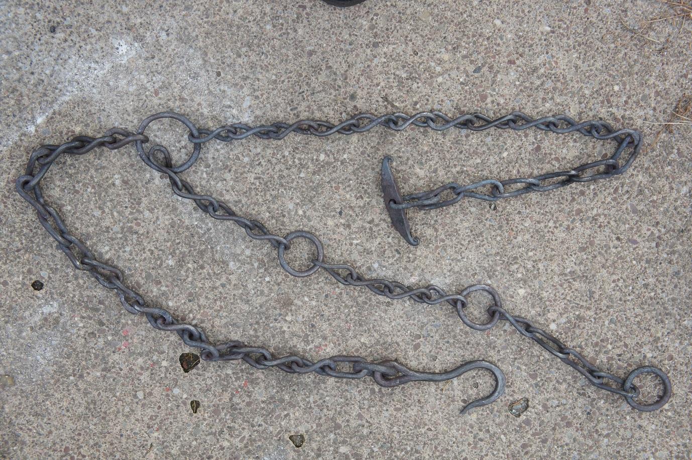

Frazer Posted December 20, 2021 Share Posted December 20, 2021 Dax, that will happen sometimes. Heat them up, put the boss in a vise, grab a twisting wrench and twist the jaw back where it's supposed to be. EZPZ. Nice chain billy! I finished my first chain project recently. I might have gotten a little carried away. I ended up with 47 links, 5 rings, a hook and a toggle. Your welds look much nicer than some of mine. Those are also some very nice tongs. As it gets longer and longer it becomes quite unwieldy so being able to hold a link firmly (and keep the others out of the way) becomes more and more important. It quickly got to the point were I had my anvil between me and the forge so I could work on a link while the rest of the chain was laying on the forge pan. What size stock are you using? Quote Link to comment Share on other sites More sharing options...

BillyBones Posted December 20, 2021 Share Posted December 20, 2021 Swedefiddle, my other has 15, so 11+15=27. Just a small sprinkling of flux is all. As far as welding those tongs may be my best welding job yet. If you look close you can see the scarf on the reign on the left but i got it blended purty good if i say so myself. Frazer, 3/8". I got a couple miles of it in 20' sticks that i found in my barn when i moved in. It is galvinzed so i have to cut it, soak it, then use it after the coating is stripped. I need to find me a larger container so i can strip longer pieces. As of right now 6" is about as long as i can do. Dax, i have a few sets that the boss is not offset on. I will make a goose neck then bend them into alignment along with the reigns. My problem with making the boss is to thin or not uniform and straight. Sindoc, my first hammer, the one i use everyday, started as a piece of 4140 1 1/2" square by 8" long. Cut to the length i wanted, cut a diagonal for the pien, punched the eye hole and heat treat was the only forging. I started by drilling a hole for the eye, that way i knew it would stay straight and i aint going to lie, i got lucky with heat treating. It is just a couple ounces shy of 3#. Quote Link to comment Share on other sites More sharing options...

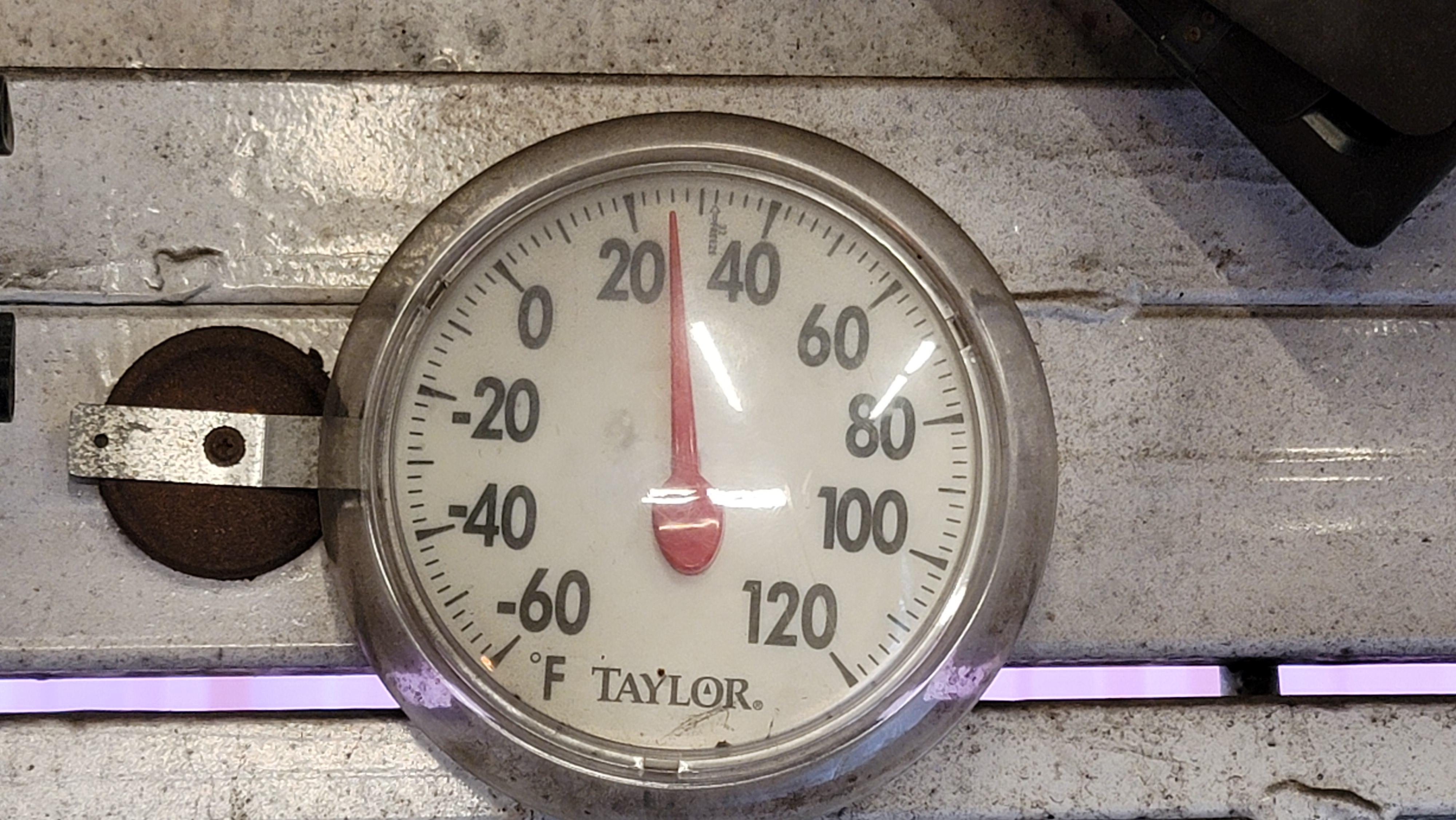

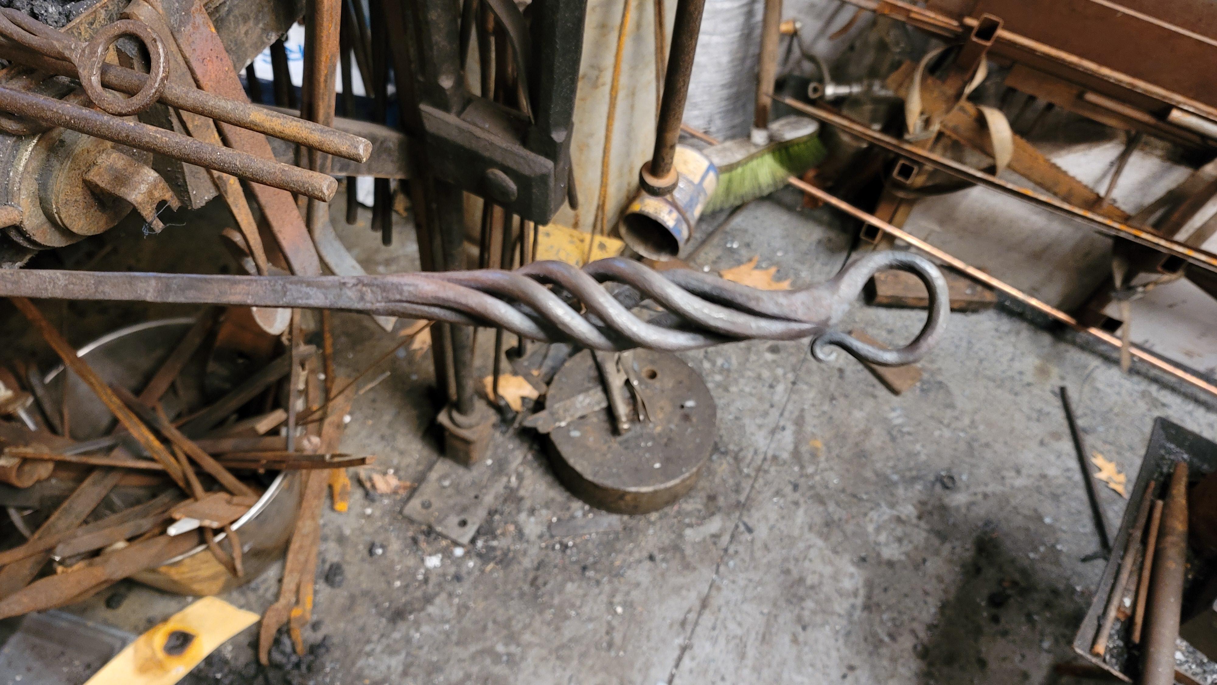

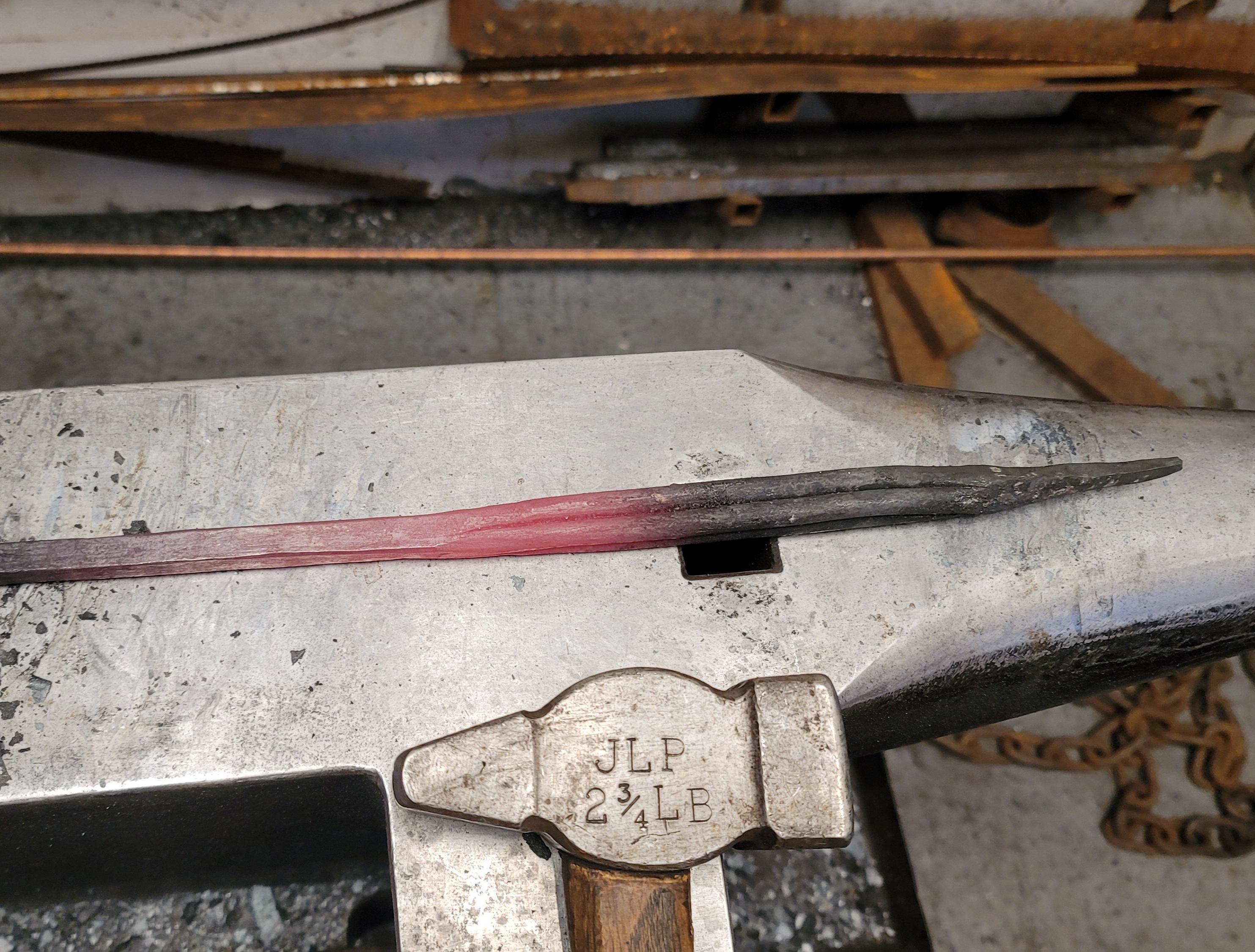

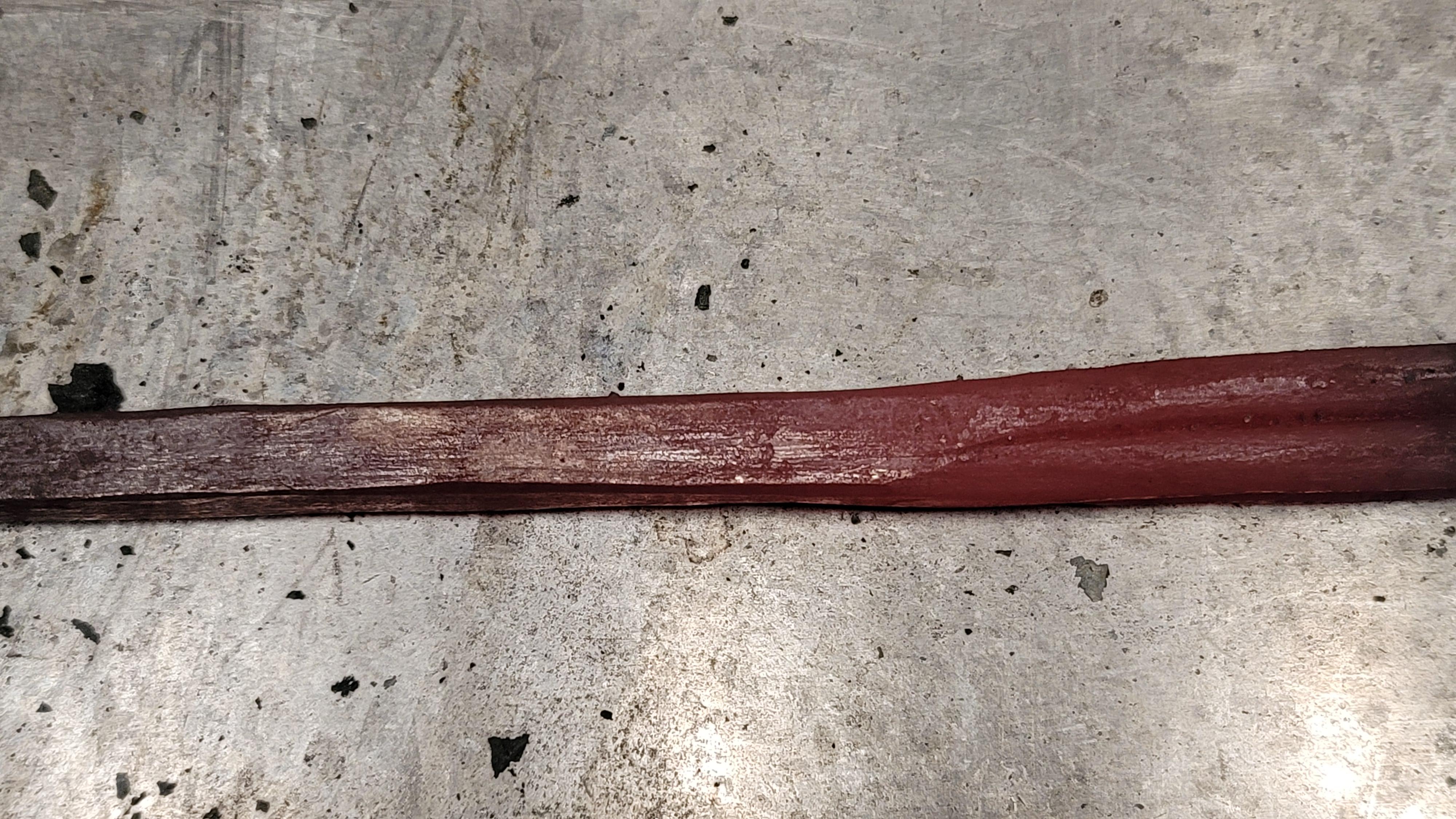

jlpservicesinc Posted December 20, 2021 Share Posted December 20, 2021 Not my nicest handle but beefy. 5/16" round and 3/8" sq for shaft. Mighty cold in the trailer. Wanted to make this poker as a Christmas present for the neighbor for when they are out at the firepit. Quote Link to comment Share on other sites More sharing options...

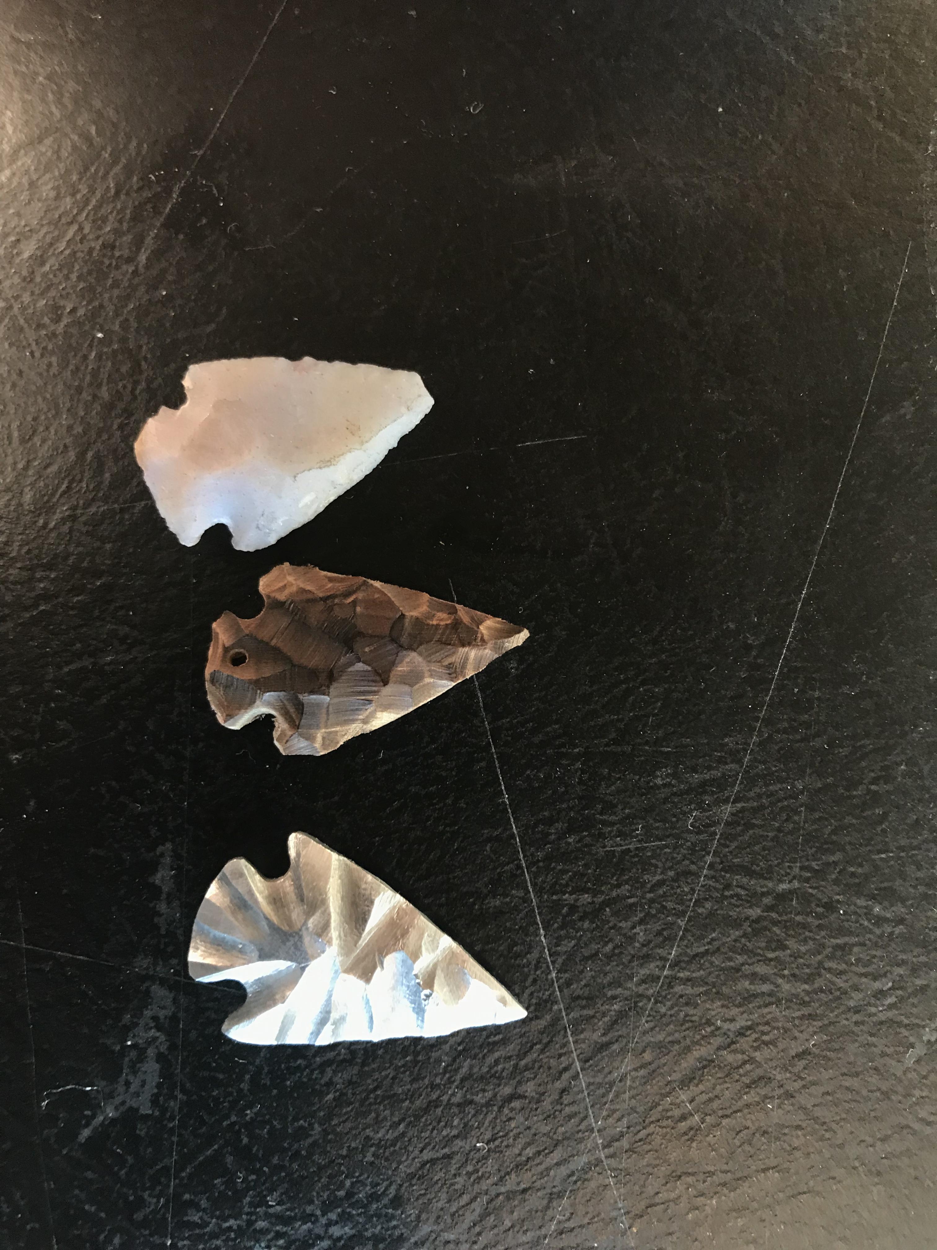

Chimaera Posted December 20, 2021 Share Posted December 20, 2021 While no forging recently, I made a few arrowheads- one stone, one wood, and one aluminum. I need to make another aluminum one, since this one did not turn out. They are proofs of concept for a Damascus or mokume necklace. I also managed to screw up the whole wiring on my workbench- there’s a short circuit somewhere, so I’m currently running an extension cord from the house. I’ve started to tear it apart to find the short and fix it, but I’m a little low on time at the moment. Quote Link to comment Share on other sites More sharing options...
