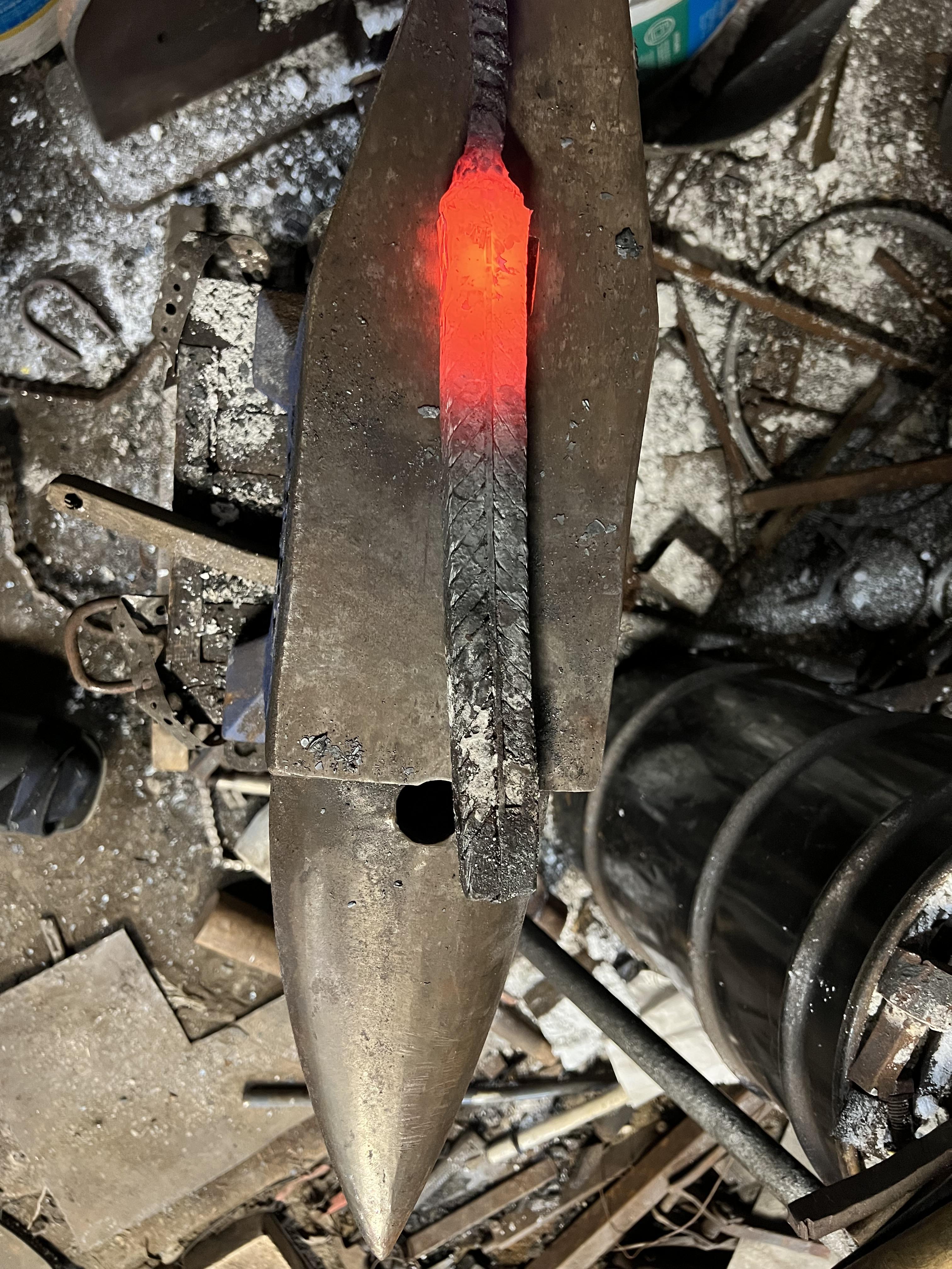

Buzzkill - Make sure you budget a TIG cooler to go with it. My first forge I built a cooler and it worked (until I outsmarted myself and added copper sulfate to eliminate algae - I didn't realized there were aluminum components inside the case - copper sulfate protects copper, but eats right through aluminum) but prices have dropped to where I bought a forge AND cooler for what I originally paid for just the forge. If you do FB check out https://www.facebook.com/groups/758762180850373 Frosty - I probably wasn't clear on the problem with consolidating cable. It isn't that the threads overheat. The cable just refuses to come up to anywhere close to welding temperature. My understanding of eddy currents and how they work is limited, but a few possibilities: a. the geometry of the individual strands spreads the energy too far for the size machine I have. b. The response of each fiber causes interference in the neighboring fibers. I suppose I could test this by trying a really small cable, but my gas forge does fine to consolidate the fibers. Then I shut it down and switch on the induction. -

Yes indeed. EJ of the Anvil has examples of induction forge welding on YouTube. Like I said, I can't forge weld cable together because the individual strands are too small relative to the coil (I think) but once I use the gas or coal forge to weld the cable into a billet I then use the induction forge to weld the two billets together with a strip of high nickel alloy (that makes the center line of the "feather"). I go up and down the billet at least twice every two to three inches, trying to stagger the centers of those individual heats. I think I've mentioned it before, but induction (at least the 15kw China versions that are available so cheep) is not the answer to everything, but in terms of speed, convenience, cleanliness, visibility and comfort (not adding as much heat to an already sweltering shop) it is hard to beat. I'm just a hobby blacksmith, but I wouldn't want to have to do without it. -

My ankle is progressing. I can stand and walk in my boot without crutch or cane and shop sessions are longer. I finished welding two consolidated cable billets together with a strip of high nickel alloy between them with my induction forge. This is going to be a billhook with a chopping edge. I’m not sure my TIG cooler is working as it should. It took two sessions to make the weld-2 to 3 inches at a time. About half way done the machine overheated and shut down. Then again, ambient started at around 90 deg F. -

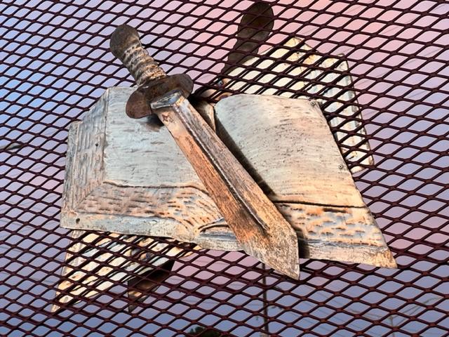

Just to try out the process, its easier to start with stake repousse. All you need for that is a good size log stood on end. Don't get me wrong, John is doing it right. I don't know if I will ever get set up like he is, but this is something done with just a log, rounded chisel, a rounded drift and a ball peen. Admittedly, it doesn't have the fine lines and detail of John's work, but its meant to be seen from the road. -

John - nice work. Clean lines and great depth. I've only worked stainless so far, but seeing your work makes me think I should try other materials.
