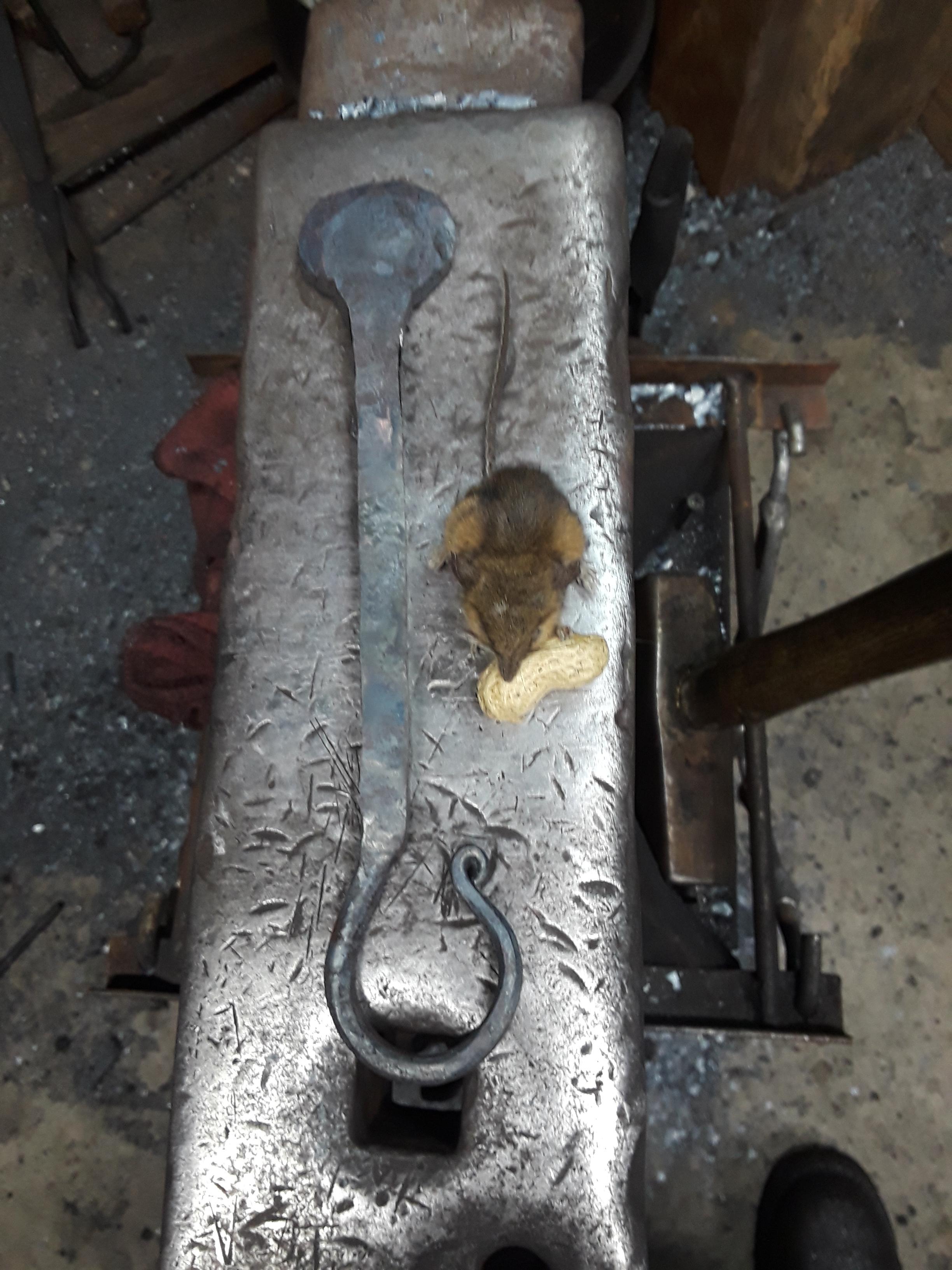

BillyBones Posted February 16, 2020 Share Posted February 16, 2020 Tried my hand at making a nail header. Did not have time to get the hole punched and finished. But hey that gives me something to do tomorrow. Started life as a RR spike. Made a few more nails also, about the same so no pic. As a side note i was reading today that HUD estimates that in a house there is aprox. 40,000 nails. If a smith can make 1 nail a minute it would take almost 3 months of 10 hour days to make enough nails for 1 house. When you think about the old days the lumber was cut and hewn on site, smiths making nails and the like, stone masons making a foundation and fireplace, that is a really impressive amount of work going into 1 single home. Quote Link to comment Share on other sites More sharing options...

KYCATS Posted February 16, 2020 Share Posted February 16, 2020 31 minutes ago, pnut said: I always say two heads are better than one. Especially if one of the heads is mine Maybe both our heads together would equal one then. Love the nail header Billybones and good to see the mouse is still around to approve your work. Quote Link to comment Share on other sites More sharing options...
