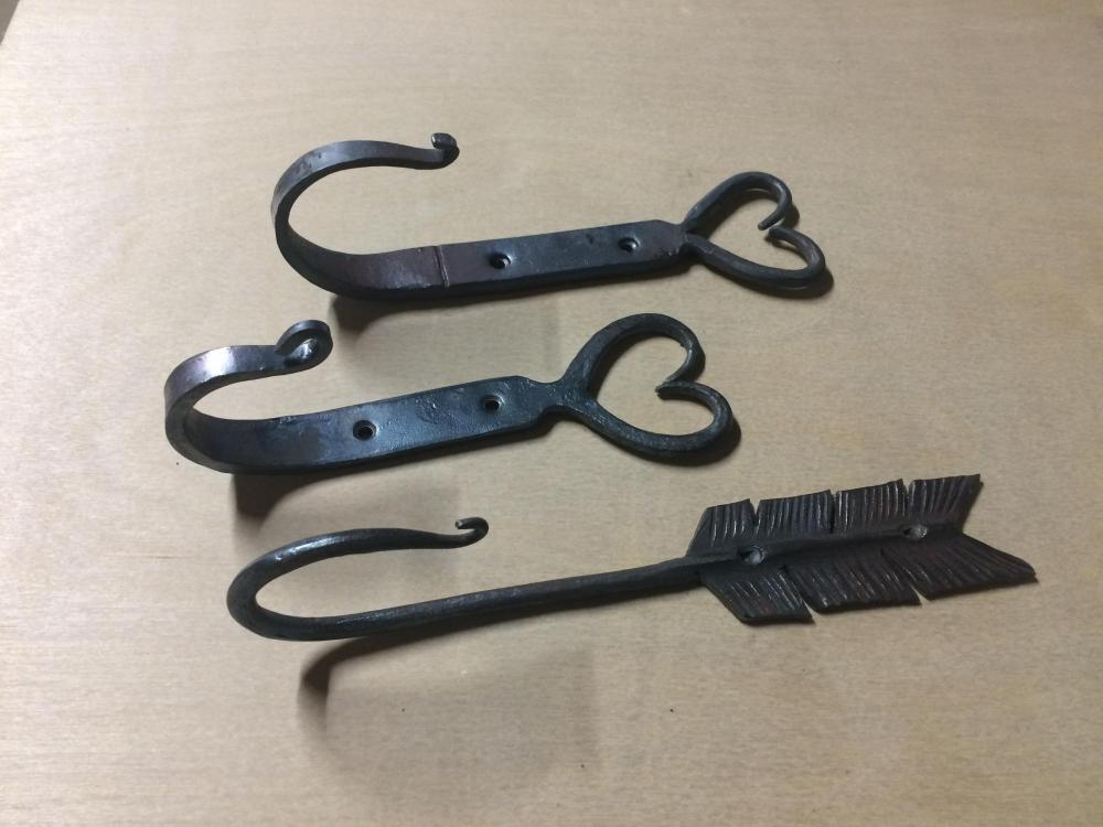

Fowllife Posted February 14, 2020 Share Posted February 14, 2020 I agree with the others, very nice roses KYCATS. What was the thickness of the material you used to get that much texture on the peddles? The only thing I would add would be a couple thorns on the stems. To me it just adds a whole nother level that really makes them pop. I finally lit the forge for the first time since Christmas, and the second time since about November. The old arm lost a little condition in the time off. The wife and I don’t usually do much for Valentine’s Day, but I lucked out to land a pretty amazing woman so I needed to make her something. I made a couple heart wall hooks and my first feather. They didn’t turn out as good as i’d hoped but not bad for being rusty. Quote Link to comment Share on other sites More sharing options...
CtG Posted February 14, 2020 Share Posted February 14, 2020 I think they look plenty good Quote Link to comment Share on other sites More sharing options...
jlpservicesinc Posted February 14, 2020 Share Posted February 14, 2020 Nice work Fowllife, I really like the lines and design elements.. Nice job necking down just below the heart, really bought the lines in super nice.. My only critique is the hook ends.. You did a super great job on the finials or main elements but rookied out of the rats tails. It's my own thing but getting some softer corners on those I feel would have topped off the project but it's just my opinion and it's cheap, free and really not worth much. Just a little softening of the corners.. Quote Link to comment Share on other sites More sharing options...
JHCC Posted February 14, 2020 Share Posted February 14, 2020 Getting the two sides of the heart to match can be a bit tricky. Nice job. Quote Link to comment Share on other sites More sharing options...
KYCATS Posted February 14, 2020 Share Posted February 14, 2020 Fowllife thanks and love those hooks. Really like the feather one, might have to attempt one myself. I believe the petals were around 18 gauge. Then I used a welding/chipping hammer to do the texturing. Quote Link to comment Share on other sites More sharing options...
Fowllife Posted February 14, 2020 Share Posted February 14, 2020 Rookied out the ends she says, yup I resemble that. Do you happen to have any pictures of what the ends should look like? I still have't found my groove yet on scrolls and hook ends. I had to trim the heart ends a couple times, and I still wasn't very happy with how they turned out. I should have spent some more time drawing the tips out to a point. Quote Link to comment Share on other sites More sharing options...
jlpservicesinc Posted February 14, 2020 Share Posted February 14, 2020 Just forge the sharp corners in some make it a really loose 8 sided taper.. just hit them with the hammer to soften or round off the corner some.. Not crazy just a little bit.. could even soften them with a file some.. When you do the taper, just hit the corners a little bit with the hammer when you finish the taper.. Making a fork and a heart are exactly the same forging operation just pushing the tines in for a heart.. check out the fork video if you haven't all ready. I think all of them including the hearts look great.. Was just a refining point.. Mild steel has a tendency to keep a sharp edge.. so if you forge it square that sharp edge will stay.. Unless the sharp edge is part of the design element just removing it some softens the look, the feel and the damage it can do if rubbed against it. As for picture.. You have one with the feather hook.. You rounded that one out very nicely.. Just don't go as round for the taper.. Again, just soften the corners. Quote Link to comment Share on other sites More sharing options...

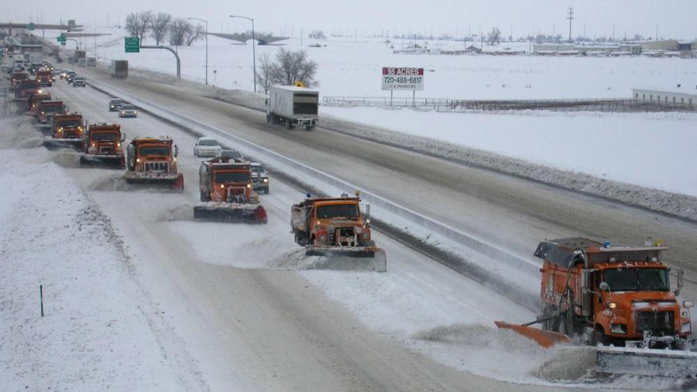

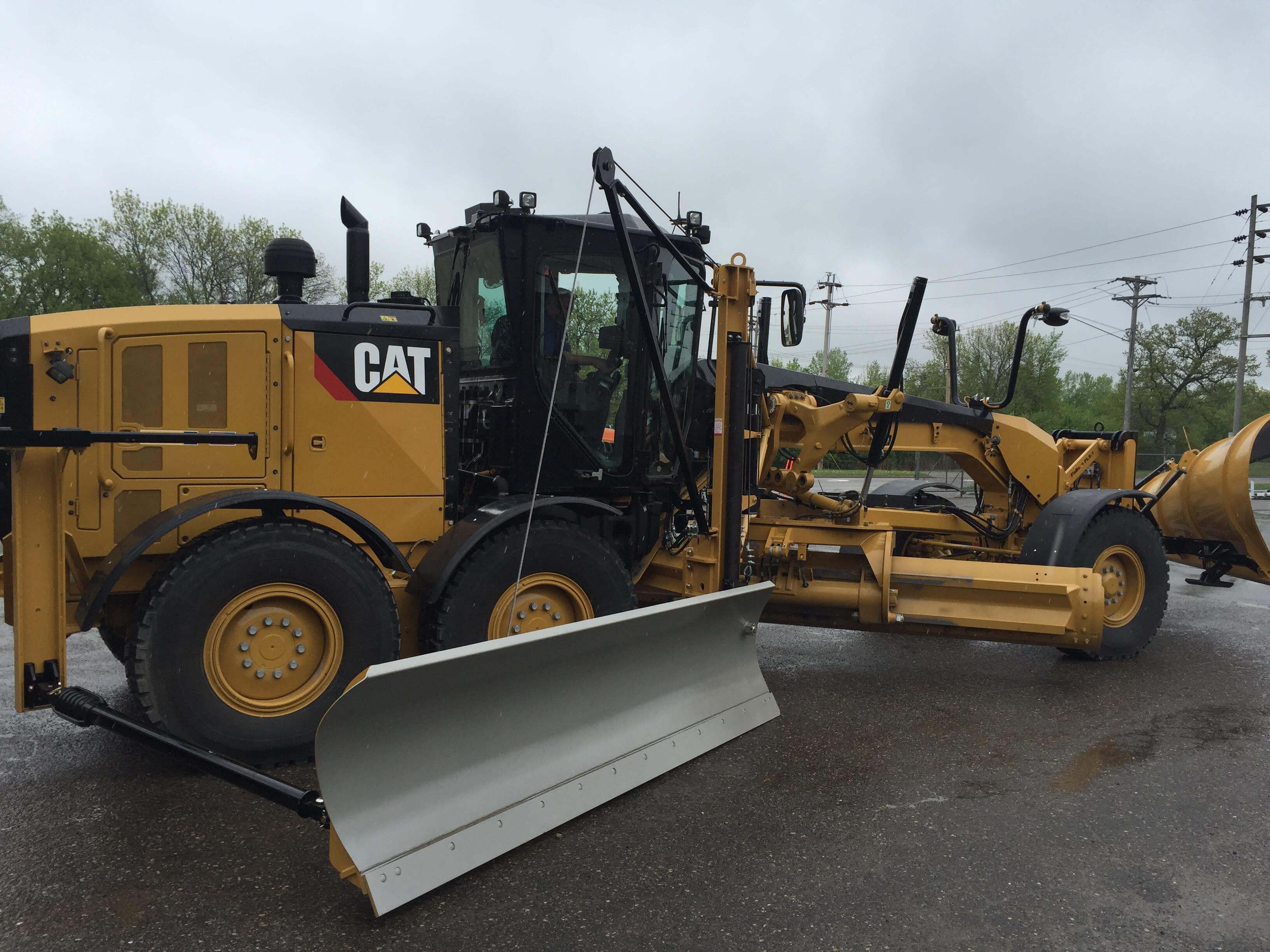

CtG Posted February 14, 2020 Share Posted February 14, 2020 That one looks a lot like a manure spreader bed. Here's some fairly common sights in winter where I grew up. All images from Google Quote Link to comment Share on other sites More sharing options...

Frosty Posted February 14, 2020 Share Posted February 14, 2020 Same job as a manure spreader smells better though. The tow plows are new on the scene here, long after I retired. Ours have Magnesium chloride tanks on them, we have plenty of sanders. I don't see any belly blades in the pics. Guess I'll have to find a pic. Here's a belly blade sander. Ours were on 8 yrd trucks on tandem axles. The spreader is visible on this one and it has a nose plow frame. Wish I'd found this pic first. Oh well. Frosty The Lucky. Quote Link to comment Share on other sites More sharing options...

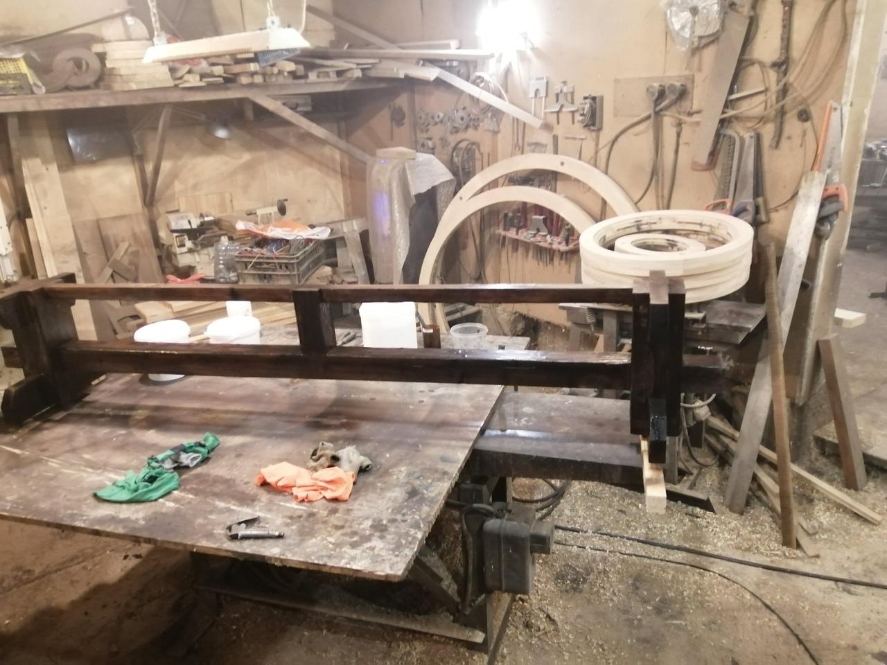

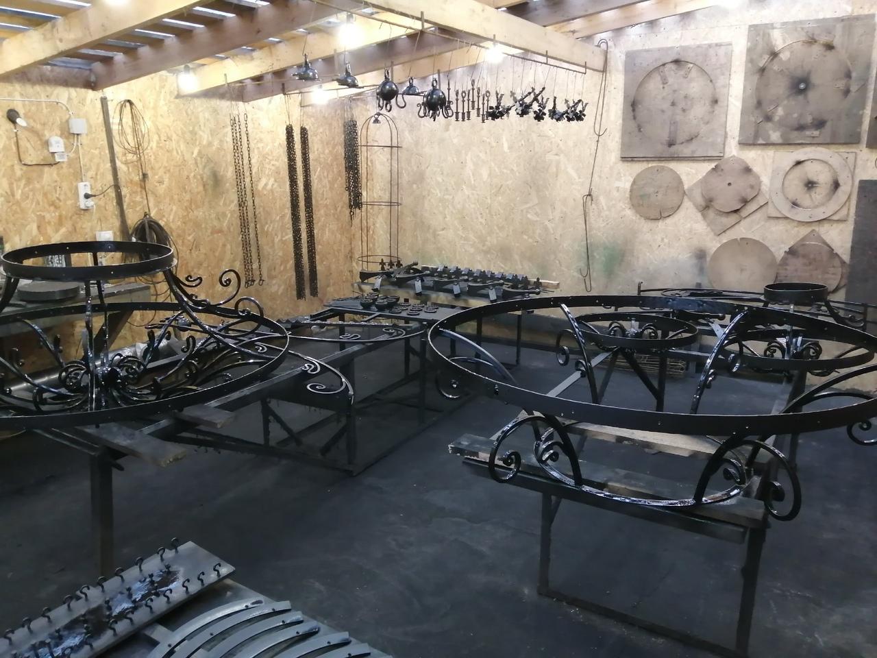

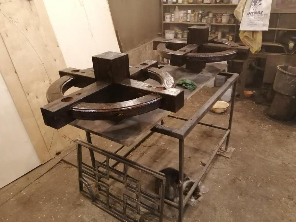

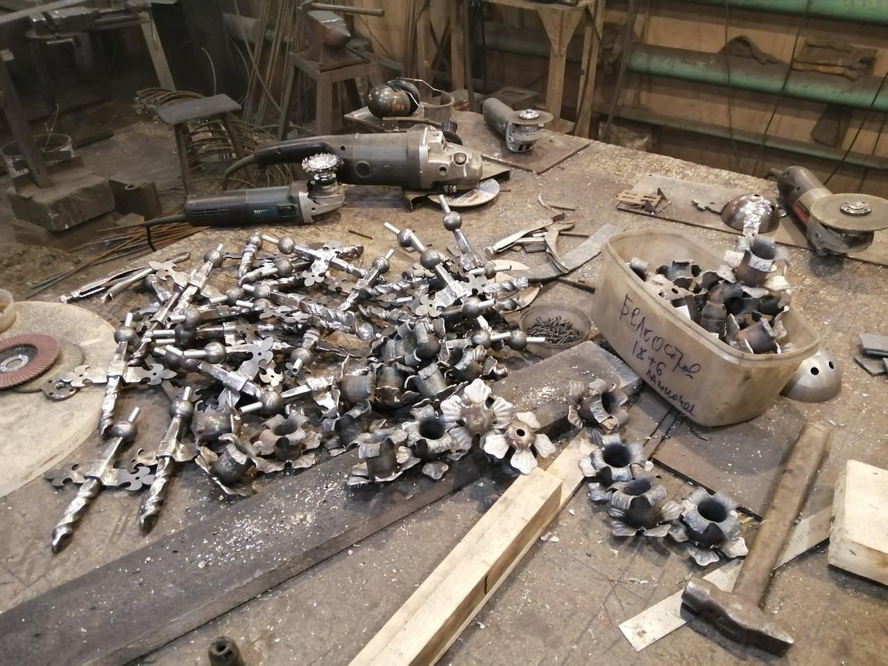

alexandr Posted February 14, 2020 Share Posted February 14, 2020 I make 5 chandeliers at the same time. There is not enough space as always. Quote Link to comment Share on other sites More sharing options...
Savage11 Posted February 14, 2020 Share Posted February 14, 2020 Alexandr, Your chandeliers are amazing and your shop is awesome. I've always been a fan of Russian ingenuity and resourcefulness. Making more from less seems to be a Russian trademark. Im a huge fan of Avtomat Kalashnikova 7.62x39 and 5.45x39. Awesome work!! Quote Link to comment Share on other sites More sharing options...

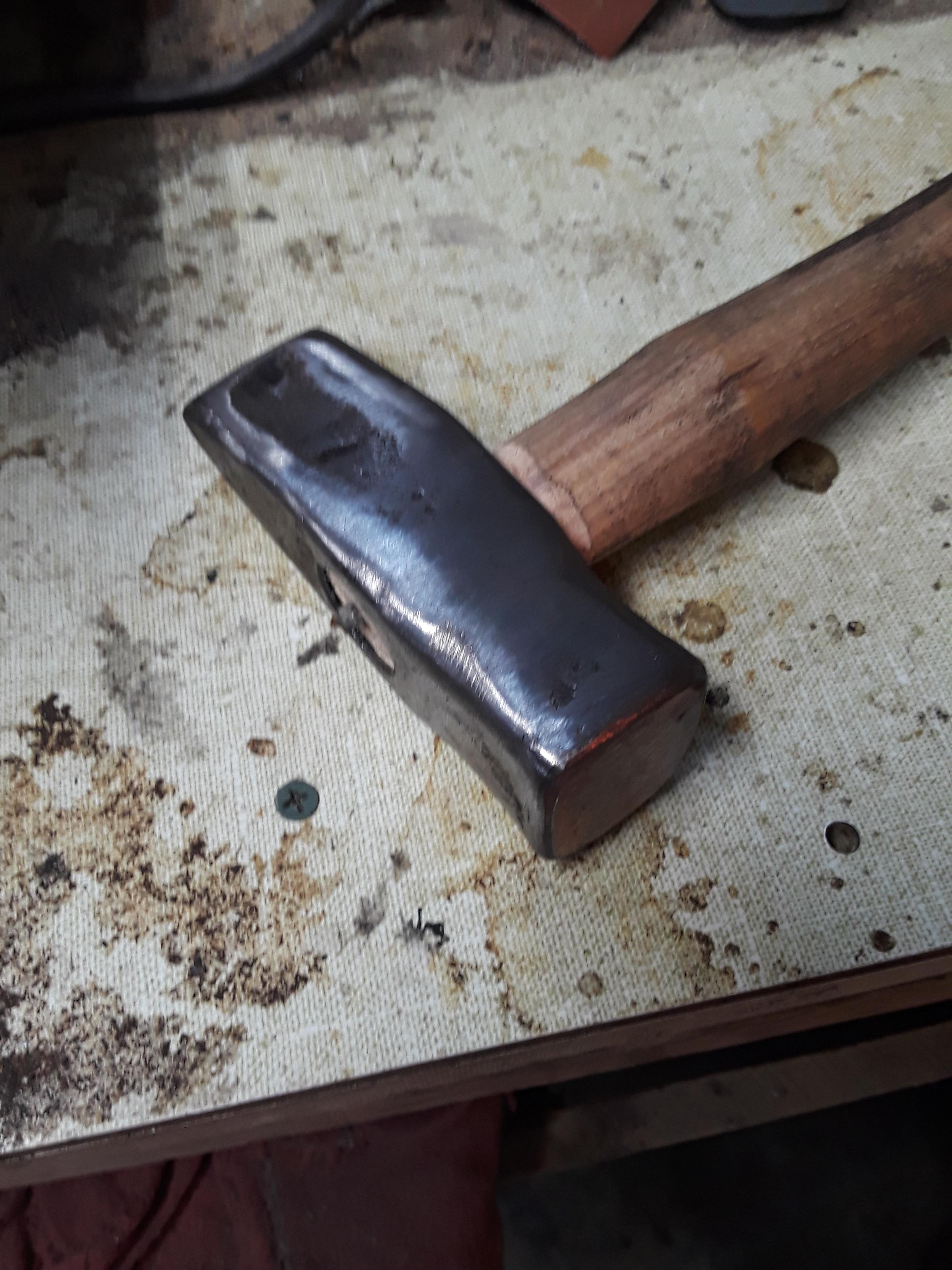

BillyBones Posted February 14, 2020 Share Posted February 14, 2020 Alexander, as always beautiful work. Even if you add 10,000 square feet you still wont have enough shop, at least from my experience you will always find a way to fill. Kind of like a clean work bench dont stay that way long. Practiced some nails today. Mine always turned out funky looking and off to one side. A big thanks to Glenn for getting me on the right track. Anyway they aint great but much much better than what i would usually end up with. Put a handle on the hammer i made a week or so ago. so it is finished, now to move some metal with it. And made me a bottom flat hardy thingy. Quote Link to comment Share on other sites More sharing options...
