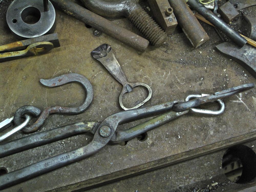

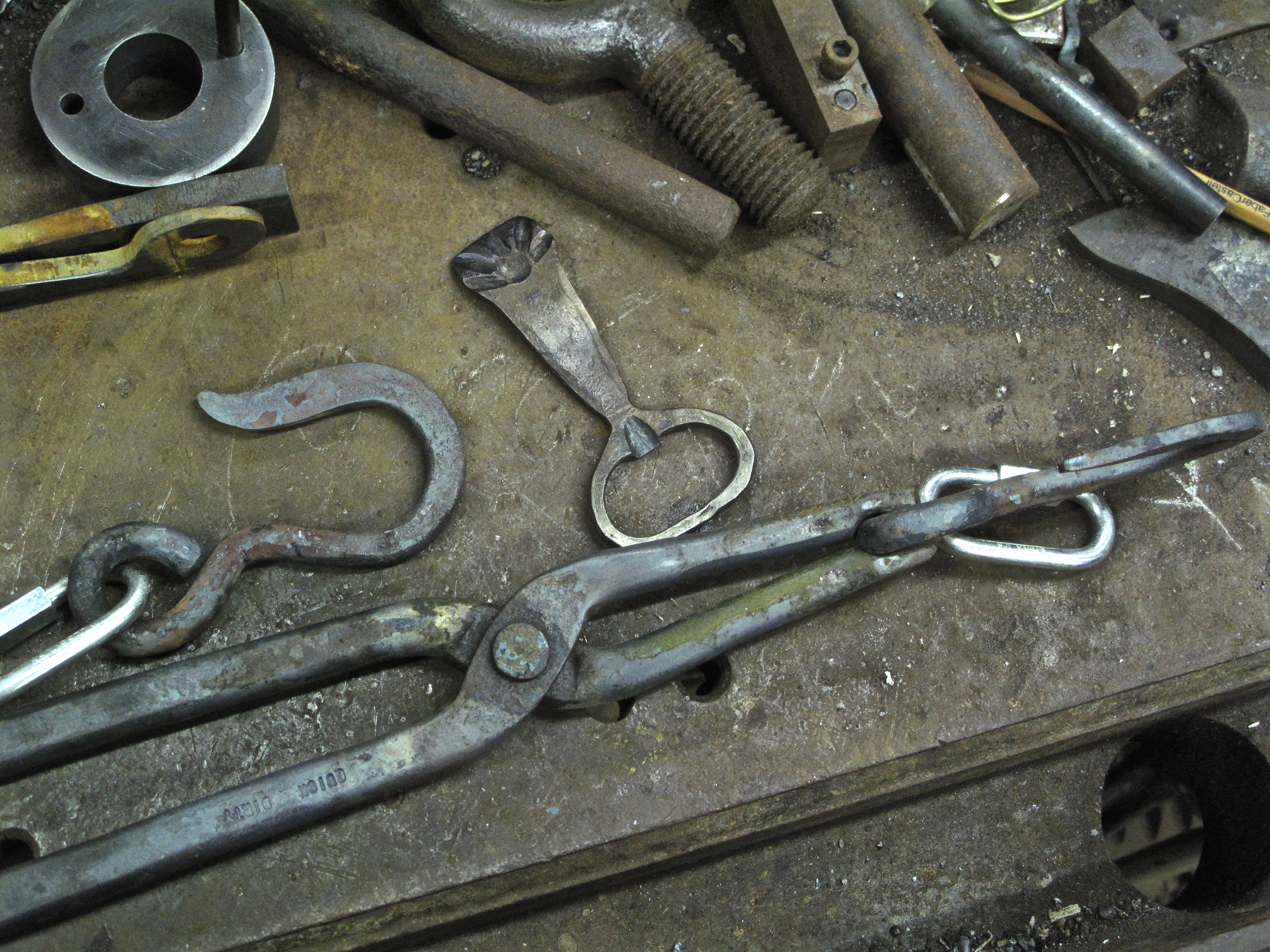

  12. Had a little 3" piece of 1/4x3/4 mild that needed something done with it..... And since I was already working on some trailer hooks and a pair of ring tongs, it seemed like a good time to make another bottle opener. The ring tongs started out as one of those 80% tong kits from Quick-n-Dirty Tools, and I couldn't be happier with how they turned out.
