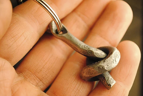

  9. Everyone seems to get a kick out of knots, no precise forging techniques needed, just bending some metal. This is a video I made a few years ago in my old workshop of making a knot from 6mm (1/4") round bar and attached is a picture of how I used to turn them into keyrings. Enjoyable for kids.

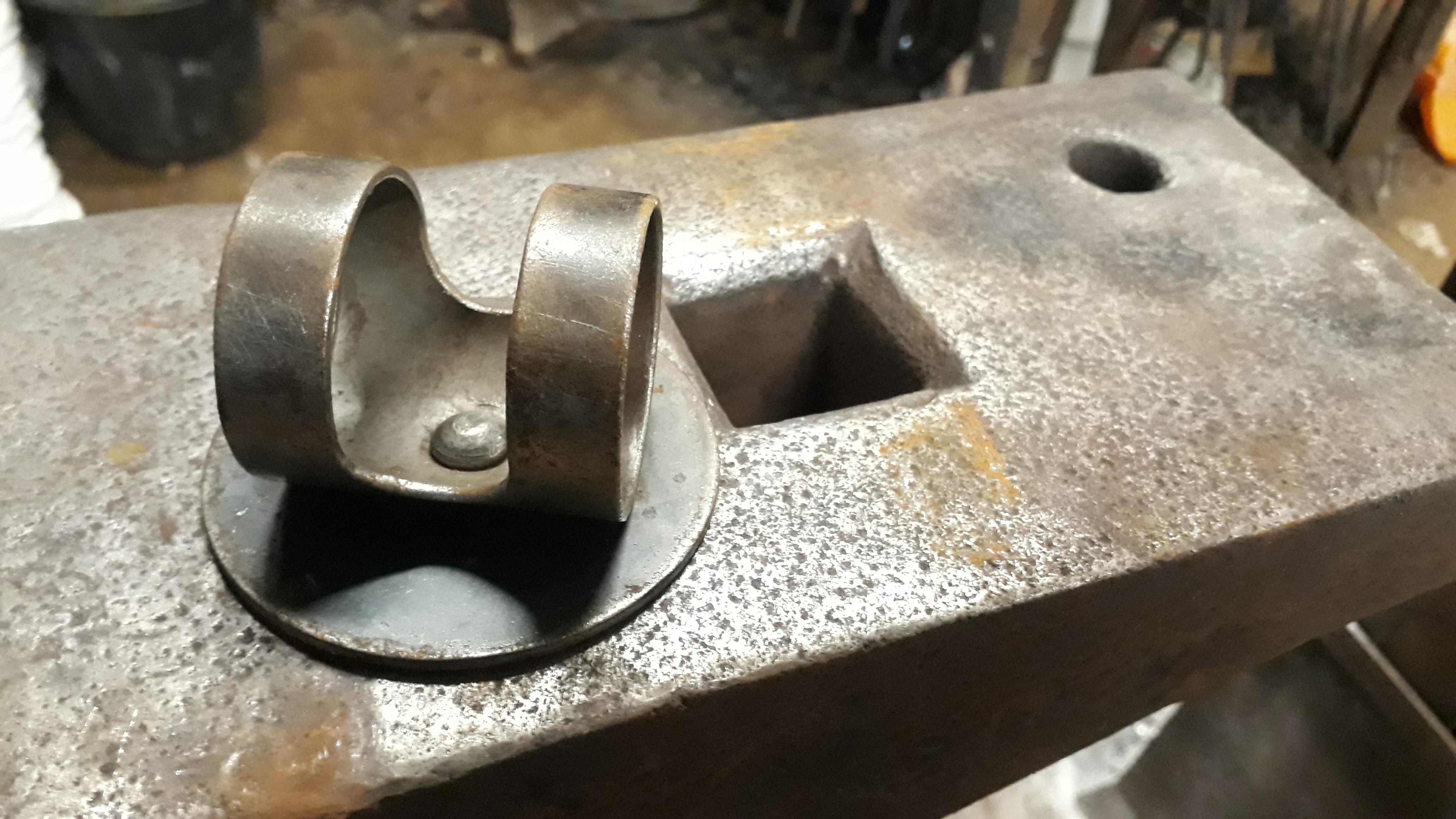

  10. As mentioned by Thomas, with hollow poles my preferred method is to forge a tenon on the finial so the shoulder sits hard up against the end of the pole for as seamless transition as possible. Drill and thread a hole in the pole to accept a grub screw that will stop the finial from rotating but allows the finials to be removed if the clients to add/remove curtain rings. I've attached an old sketch of how I make the brackets. (Ignore the bottom sketch). The black circle on the top is another threaded hole to take a grub screw which prevents the pole from rotating or moving side to side.
