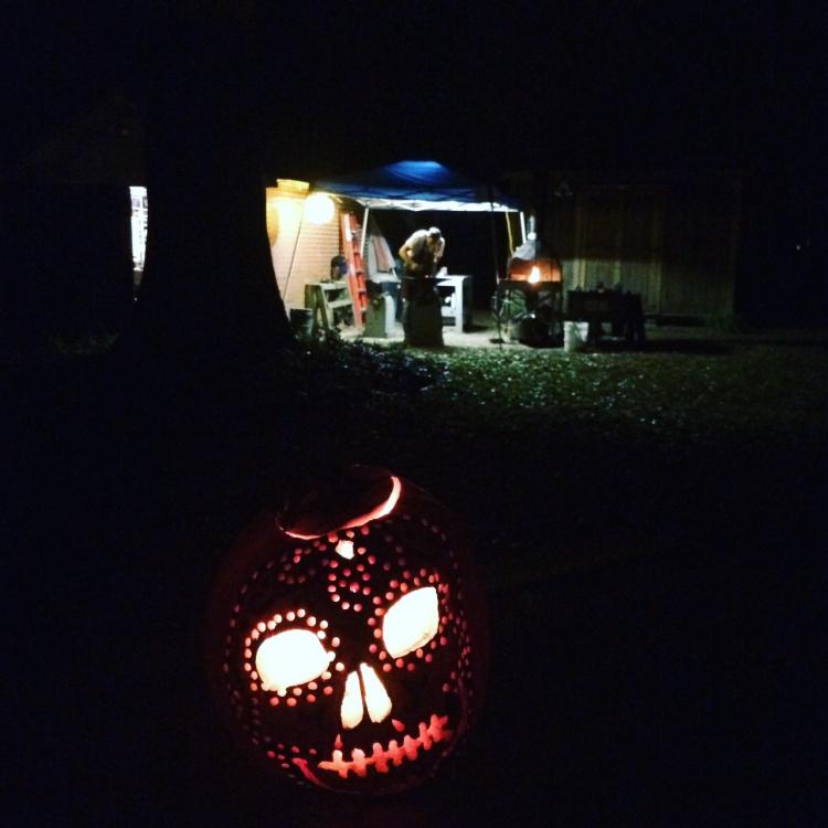

  2. Thanks everyone for your input. Thought I'd follow up with a post event report for you. Last Friday night I did my demo event and learned a few things about lighting I want to pass on. Most important lesson- TIME, give an equal time allowance to light set up as you do to equipment set up ! Second lesson- TIME, the event I worked had a completely different ambient light quality as my home space where I rehearsed event lighting. This required adjustment of lighting at event that cost TIME. Would I do a night event again, no, unless the money talks loud enough. Attached is event lighting pic. Ed

  6. Hi all, I have a night demo coming up soon and have been experimenting with my under canopy lighting system. This event is semi sodium lit for the onlookers but under canopy lights must function for me to actively forge.My regular light source is shaded daylight which makes it even harder.. A florescent light hung up high in the canopy was terrible, all went flat, and the anvils faces shone too bright. Incandescent light cans down lit is a bit better but having trouble getting directional shadow on the pieces I'm forging..Two anvils and a vise table need to be functional. My set up is three sides of a square facing front of forge. Any suggestions ? Thanks Ed
