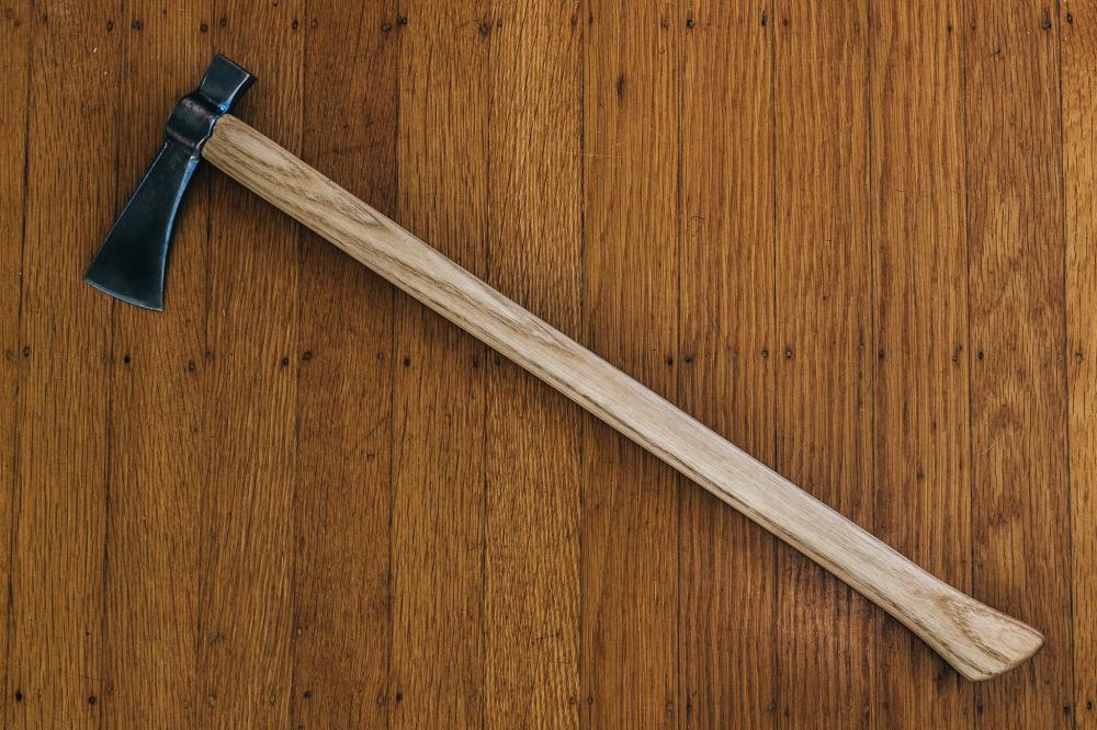

navasky Posted November 12, 2015 Share Posted November 12, 2015 I finished this one up this weekend. Forged out of a piece of railroad anchor, the handle is made from an old baseball bat. It ended up kinda plain Jane but feels nice in the hand. Quote Link to comment Share on other sites More sharing options...
TwistedCustoms Posted November 12, 2015 Share Posted November 12, 2015 Nice lines all around, I like it. What is the handle length? Quote Link to comment Share on other sites More sharing options...
David R. Posted November 13, 2015 Share Posted November 13, 2015 What is railroad anchor? How did you harden and temper? Symmetry is excellent. Did you use swage or die? Quote Link to comment Share on other sites More sharing options...
781 Posted November 13, 2015 Share Posted November 13, 2015 Railroad anchor is a piece of spring steel hammered onto the bottom of the rails. It is to keep the rail from sliding as it hits the railroad tie. Quote Link to comment Share on other sites More sharing options...
ThomasPowers Posted November 13, 2015 Share Posted November 13, 2015 sort of 3 looking things here in the USA, usually about 1050 to 1060 steel (so about double the carbon content of a RR spike and I see them at the scrap yards with the spikes) Quote Link to comment Share on other sites More sharing options...
mitch4ging Posted November 13, 2015 Share Posted November 13, 2015 looks great, nice shape. good choice for the haft...all repurposed! my only concern would be the eye is round, would it be prone to turn on the haft when you start to use it. Great looking photos by the way! Quote Link to comment Share on other sites More sharing options...
ThomasPowers Posted November 13, 2015 Share Posted November 13, 2015 Be easy enough to squish the eye a bit on the next one... Quote Link to comment Share on other sites More sharing options...
Stormcrow Posted November 13, 2015 Share Posted November 13, 2015 That came out pretty darn sweet! Love all of it except for that round eye. Much better choice than using a railroad spike, in my opinion. Quote Link to comment Share on other sites More sharing options...
JHCC Posted November 13, 2015 Share Posted November 13, 2015 There are two different types of rail anchors on the right hand side of this photo: the squiggly "3" shape and the fat "J" shape. Quote Link to comment Share on other sites More sharing options...
navasky Posted November 13, 2015 Author Share Posted November 13, 2015 20 hours ago, TwistedCustoms said: What is the handle length? The handle is about 20 inches. 19 hours ago, David R. said: What is railroad anchor? How did you harden and temper? Symmetry is excellent. Did you use swage or die? As others have said rail anchors range from about 1040-1060 depending on the manufacturer. This one was triple normalized, hardened in canola oil, and triple tempered at 425. The body was drawn back to spring temper with a propane torch. No dies or swages used, just some grinding in between forging steps. In defense of round eyes, viking axes were commonly made with round eyes, so were trade axes. They won't turn on the haft if you hang them right and they're strong and easy to rehang in the field. They're not great for splitting though. Quote Link to comment Share on other sites More sharing options...

eggwelder Posted March 2, 2016 Share Posted March 2, 2016 On November 13, 2015 at 4:36 PM, navasky said: The handle is about 20 inches. As others have said rail anchors range from about 1040-1060 depending on the manufacturer. This one was triple normalized, hardened in canola oil, and triple tempered at 425. The body was drawn back to spring temper with a propane torch. No dies or swages used, just some grinding in between forging steps. In defense of round eyes, viking axes were commonly made with round eyes, so were trade axes. They won't turn on the haft if you hang them right and they're strong and easy to rehang in the field. They're not great for splitting though. I make round eye all the time, they don`t spin or turn as you might expect. i have lots of these, I`ll be trying them, i love the simplicity Quote Link to comment Share on other sites More sharing options...
