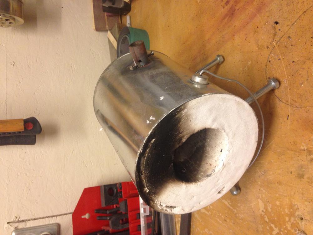

I have a paintcan forge I built for heat treating knives. I have had very mediocre success with getting it hot enough. I started with a bernzomatic torch and propane, upgraded to mapp gas and went to an oxy/map gas setup. The oxy/mapp gas set up has reached adequate heat treat temps, but I am going broke buying small cylinders to keep it operating (one 1.4oz oxy tank will heat treat two knives). I want to install one of frosty's T-burners in this but, I am considering building a whole new forge so I can get to welding heats to eventually start doing some Damascus work.
To make a long story even longer, I am working in a small shop (12'x24') so size is a factor. I have very quickly come to appreciate the vast amount of experience and wisdom contained on this forum so before I start to construct another forge I would see if this one could work.
No it's not the simplest or  cheapest; you have already spent several times the cost of a kaowool liner trying to get it up to heat not to mention all the different burners/fuels you have already worked with.  Stop throwing good money after bad. Trashcan that liner *NOW*; put in 2 inches of kaowool and get to forging!

On November 1, 2015 at 8:35:57 PM, BHein said:
It is plaster of paris and sand. It was the simplest/cheapest starting point, I definitely want to upgrade to kaowool in my next one tho.
As Thomas mentioned, you're really screwing yourself over with that kind of junk in the forge.  Some imbecile puts a video on youtube and next thing you know, everyone wants to believe sand and plaster makes a decent insulation instead of actually thinking things through for a minute.
If sand and plaster was good stuff, you'd see every professional out there using it.  If it was cheaper and did the same job as Kaowool, nobody would be buying kaowool.  There'd be no talk of kaowool, Satanite, refractory cement, plistix, etc.  All of the kiln and oven manufacturers would be using sand and plaster in the products they sell rather than the "more expensive" stuff they're currently using.
Then you cancel your savings on the insulation by buying can after can of fuel, trying to get a decent heat.  Why?  Because the insulation isn't insulating. It's just a heat sink.
Get with Wayne for some proper supplies and build a proper forge.  You'll be very happy that you did.
As I mentioned in another post on this forum the same thickness of high temperature glass fiber blanket is around 10 times better insulating material than a plaster/sand mix from what I could find regarding these materials.  Even though there are certainly some losses due to radiation out the open door and convection of the heated combustion byproduct gasses, this is a rather significant difference.  This is not even taking into account the thermal mass of the plaster/sand mix which will take a lot of time to heat up every time you fire the forge up.
As Vaughn correctly states, using this material for a gas forge liner is a false economy, unless you get free fuel...
