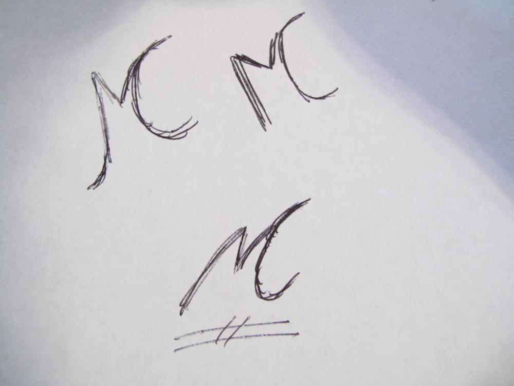

  8. M, I was thinking something more along the lines of something like these..... Obviously, there is a lot of room for improvement in my oh-so-artistic renderings, but they kind of give you an idea. I like the one on the bottom the best. You'd be surprised how many fonts there are that actually look different from the norm, and in a good way. That's where I got the idea for combining the initials into one glyph.
  9. Mountains over a lake? I can see that now that you mention it, but it certainly wasn't obvious. Whenever you consider a mark, try to think of it in terms of the overall impression of the universe you need to create around your products. If you tell the story of how you came up with the mark, mentioning that lakes and mountains are your favorite places and inspired the design, folks can see it. If you don't, folks see a sleeping C similar to what is used on ranch brands. Also, consider how the mark will look when stamped into crusty metal. What looks great with pen and paper looks absolutely wretched sometimes once stamped into anything other than highly polished steel. Similarly, a design that looks good gets ugly quick when scaled down to the size appropriate for a small knife. I highly recommend you peruse some of the free font generators on the internet and check out various combinations of the letters. Straight lines like you drew can be nice, but a bit of flair certainly can't hurt. I was really surprised at how many fonts are out there in the wide web of the internet. Some will work, some won't. But they all give you a tremendous variety to choose from. You can scale them up or down to see how they work. Move them around to see how nice they can look in various orientations. And when you hit on an idea, you can tell the maker that's it's XYZ font, something that they can easily look up and render into their computers. And don't fret. You're not the only one struggling with a design! I've been pondering the issue for well over a year and might just be suffering paralysis by analysis.

  18. I wouldn't use an 8" shaft on the touch mark. That's mighty long and most companies I've seen are only offering a 5" punch for hand-held use. Also, the more massive the punch, the more energy will be needed to break it loose. A body at rest tends to stay at rest, after all, and getting a pound of steel to move is far more difficult than getting a quarter-pound of steel to move. As for size of the actual mark, think about the types of things you do. While you want your mark to be visible, you don't want it to stand out like a squished bug. A small mark can be used on items big and small, but a big mark only looks good if the piece it's on is proportionate in size. Also, pay attention to line thickness and the open spaces between and inside the characters. If you're putting a mark on cruddy steel, covered in scale and hammer marks like so many customers prefer, you'll lose a lot of the detail in your mark. Heavy, thick lines, as has been mentioned, require a ton of force to sink into the metal. The more there are, the more force it takes. The cartouche surrounding your initials can afford to be thin because it's only there to draw the eye to the initials. If it's too thick, you're adding to the work needed to drive the stamp into the metal. Of course, a lot depends on how you plan on stamping the metal. A lot of pros recommend using a press whenever possible because it allows you to get precise placement and depth. If you go that route, you don't have to worry too much about the rest.

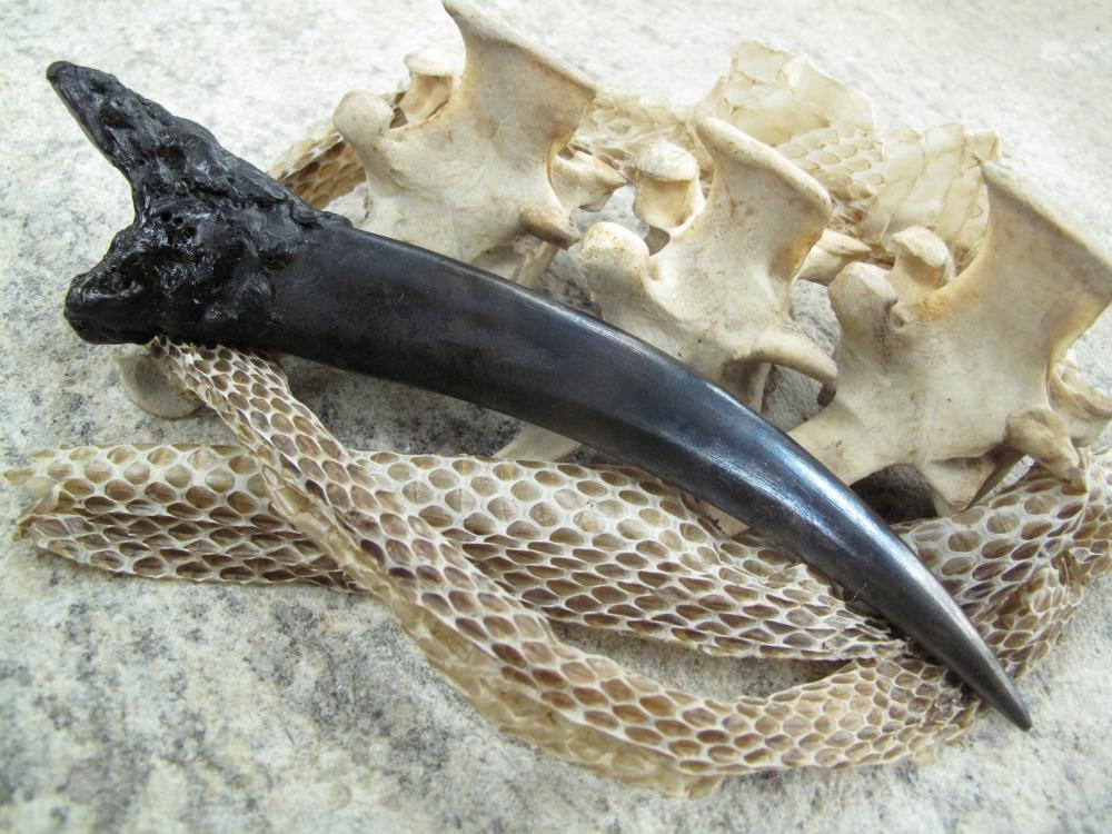

  20. How big does the head need to be? For a cooking grill, I'm thinking the noggin would be at least a foot long just to keep to scale, but.... I'd start with a wire frame made from cold-bent 1/4" round stock to get the shape set. Then fill it in with what you can. I make dragon fangs from bar stock that would work for a head that size....

  24. To give you an example of what you might run into with larger and more complicated designs, I just mailed out a small leaf-style blade to a fellow. The whole thing was only 1.25" wide, at best, and was covered with hammer texture to give it that primitive look. There was no place to put a large maker's mark and the uneven texture precluded using anything complicated or detailed. On a blade that's not very big, even if it's polished to a mirror shine, a large maker's mark really detracts from the look of the piece. I've seen folks that cover most of the cheek with their full name, the 'blade smith' title, and their city/state. The idea is that they want people to be able to find them and buy knives from them.... but they do it at the expense of the appearance of their work, and limit themselves to just blades that are highly finished and large enough to fit their billboard mark.
  25. I'd go with out the helmet. Remember, what looks good as a sketch on paper can really get sucky fast when you scale it down to something appropriately sized for a maker's mark. Also, you have to take into account the type of surface the stamp will be going on. Nicely polished knife blades can show a lot of detail. Rougher finished like you see on a lot of forged work.... well, the detail is lost in all the muck and mire of the surface. The 2 F's are good. Play around with different fonts to see what looks good. Shrink the size down so you don't have something that would completely overwhelm a smaller piece. Keep it simple and clean instead of gimmicky. Professionalism is about the quality of the work and you don't want to get "typecast" as it were because people see your logo and think you're all about making armor and not candle stands or other household wares.
