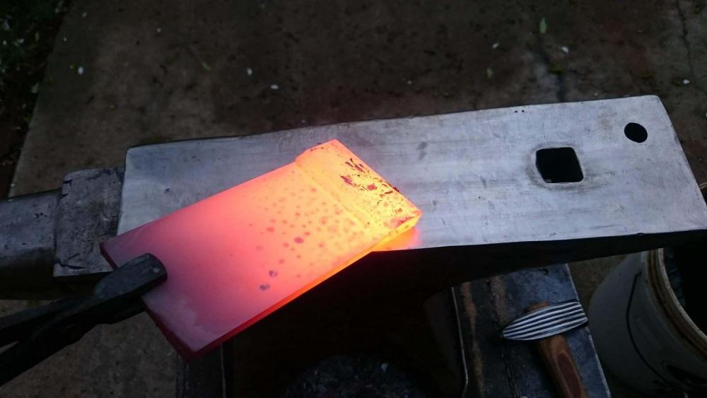

bobasaurus Posted May 7, 2019 Share Posted May 7, 2019 I made three glowing rectangles yesterday. They are going to become tapered extra-wide laminated hand plane blades for an upcoming competition (kezurou-kai colorado). Starrett O1 cutting edge, 1018 body, ~3x6x1/4". I mig welded all the way around to keep oxygen off the forge weld. Quote Link to comment Share on other sites More sharing options...

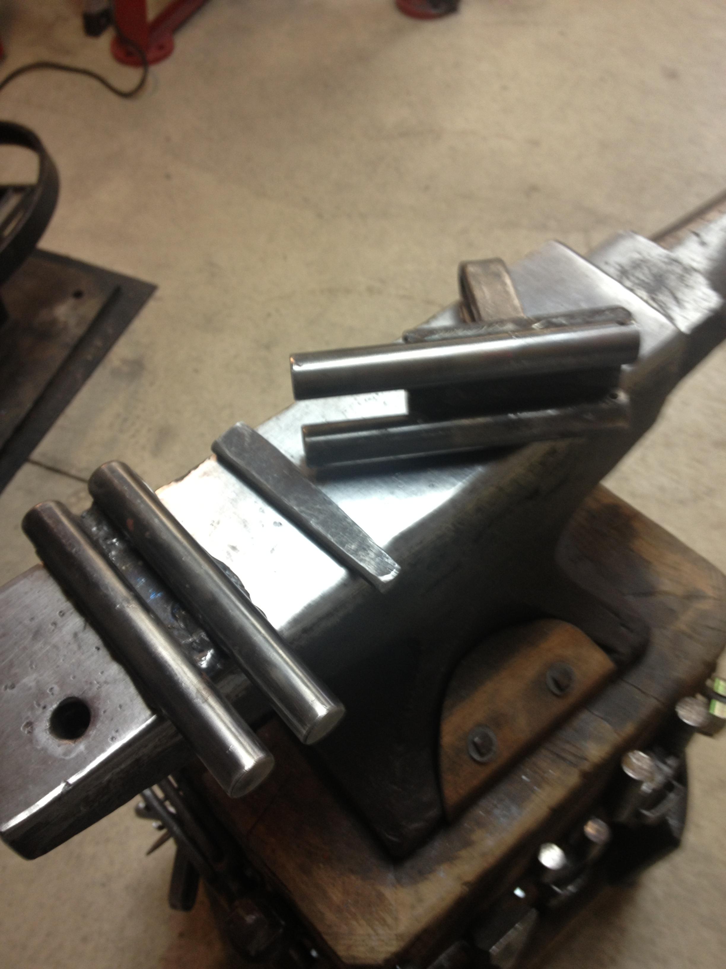

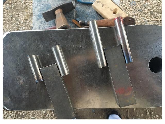

Rojo Pedro Posted May 8, 2019 Share Posted May 8, 2019 Cut some stock to turn into bending jigs. Rectangle stock fits diagonal in my hardy hole. Not very good at cutting or welding so I will post pics of finished product in a couple days Quote Link to comment Share on other sites More sharing options...
Frosty Posted May 8, 2019 Share Posted May 8, 2019 Nice Rojo. We call those "Bending Forks." Jigs are a whole different thing. I suggest you chamfer off the tops of the rounds, even round them. The fewer sharp edges and corners you have the less often you'll be putting on bandages. Frosty The Lucky. Quote Link to comment Share on other sites More sharing options...
JHCC Posted May 8, 2019 Share Posted May 8, 2019 And — more importantly — the fewer nicks and dings you’ll be putting in your workpiece. Quote Link to comment Share on other sites More sharing options...

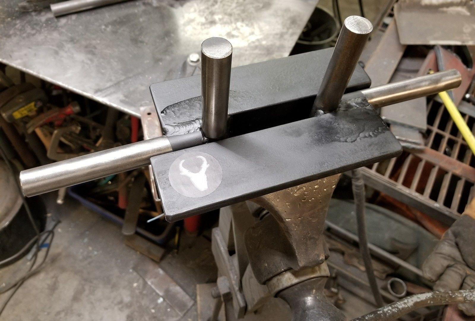

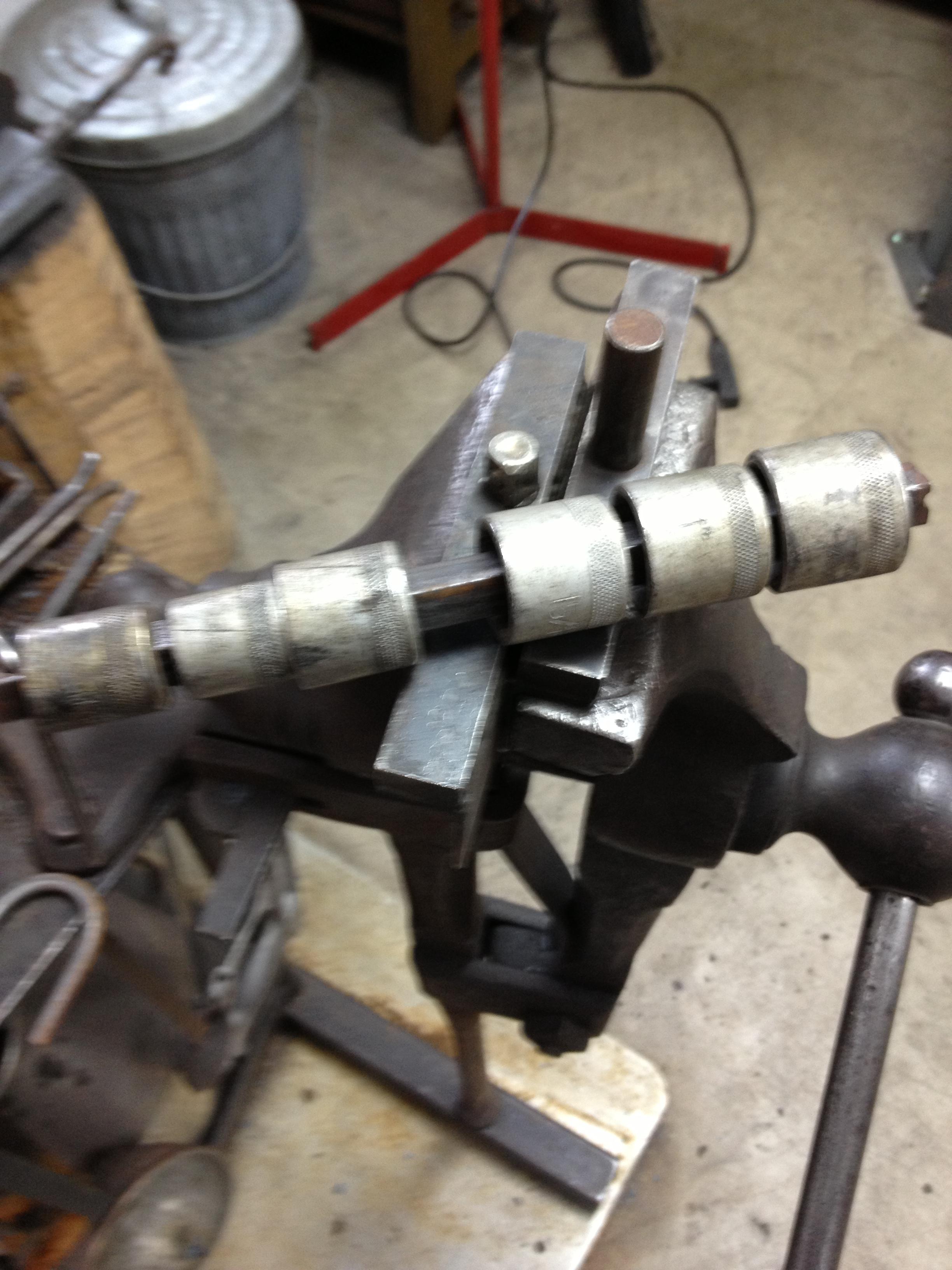

swedefiddle Posted May 8, 2019 Share Posted May 8, 2019 Good Morning Rojo, Yes, that will make good bending forks. I prefer to weld a salvage tie-rod 5/8" diameter to a surplus piece of angle bar, welded toward one end. Make two of them and you can make an adjustable bending forks that you can hold in your Vice. Drop a bushing over one of the tie-rod rounds sticking up and you can make the ultimate in a versatile Bending Forks. Any spacing, any size diameter. maximum to the size of your Vice. No I don't have a picture, use your imagination. It is too simple, drops into your bag of Tricks, the two pieces can be fastened together with one bolt and nut. Space required is minimal. Neil Quote Link to comment Share on other sites More sharing options...
jlpservicesinc Posted May 8, 2019 Share Posted May 8, 2019 Neil, while I understand fully what you talk about. A picture would be way more helpful for those not in the know. Or a sketch. Quote Link to comment Share on other sites More sharing options...
Dave51B Posted May 8, 2019 Share Posted May 8, 2019 Neil, that is what I use. Only thing different is I used 1/2" stock for the jig. That lets me use 1/2" drive sockets for the various size bushings. I think I got the idea from here somewhere. I surely didn't come up with it on my own...... Life is good Dave Quote Link to comment Share on other sites More sharing options...
Rojo Pedro Posted May 8, 2019 Share Posted May 8, 2019 Good idea Neil. Will try that next and i like Daves socket idea. Quote Link to comment Share on other sites More sharing options...
Irondragon Forge ClayWorks Posted May 8, 2019 Share Posted May 8, 2019 6 hours ago, jlpservicesinc said: A picture would be way more helpful I believe these are the adjustable bending forks. Quote Link to comment Share on other sites More sharing options...

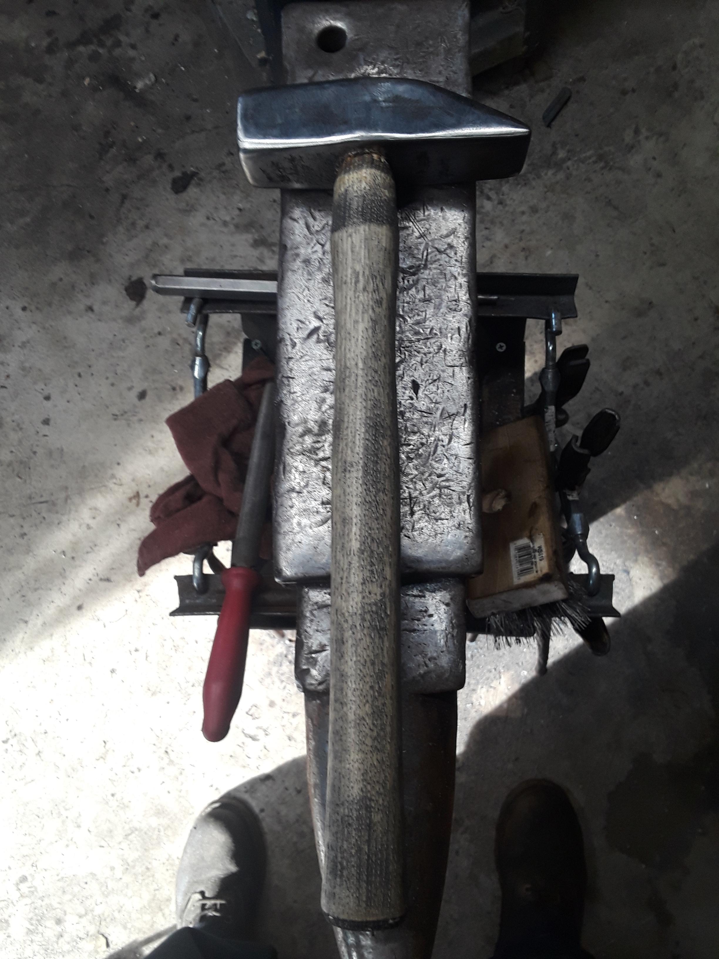

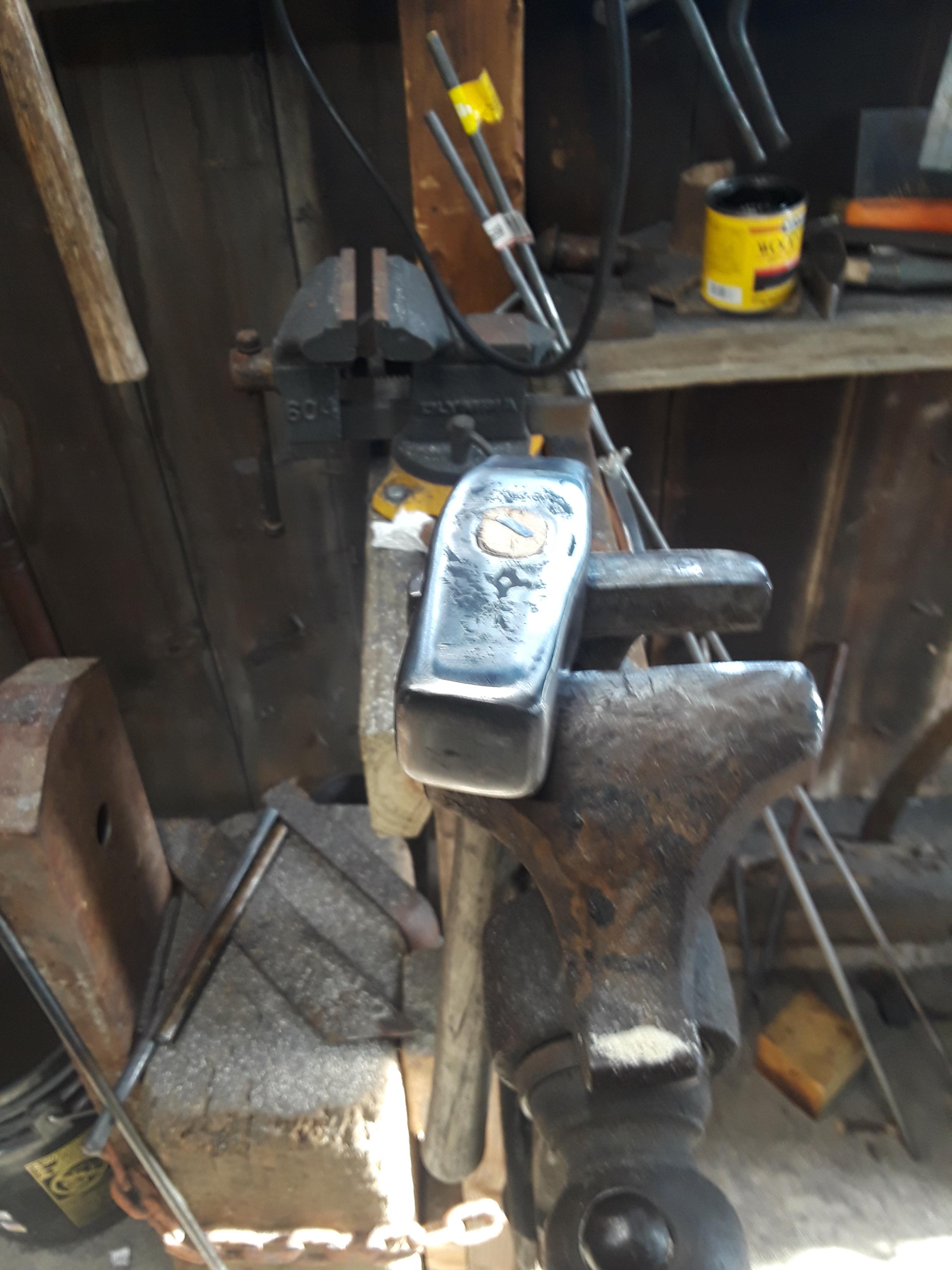

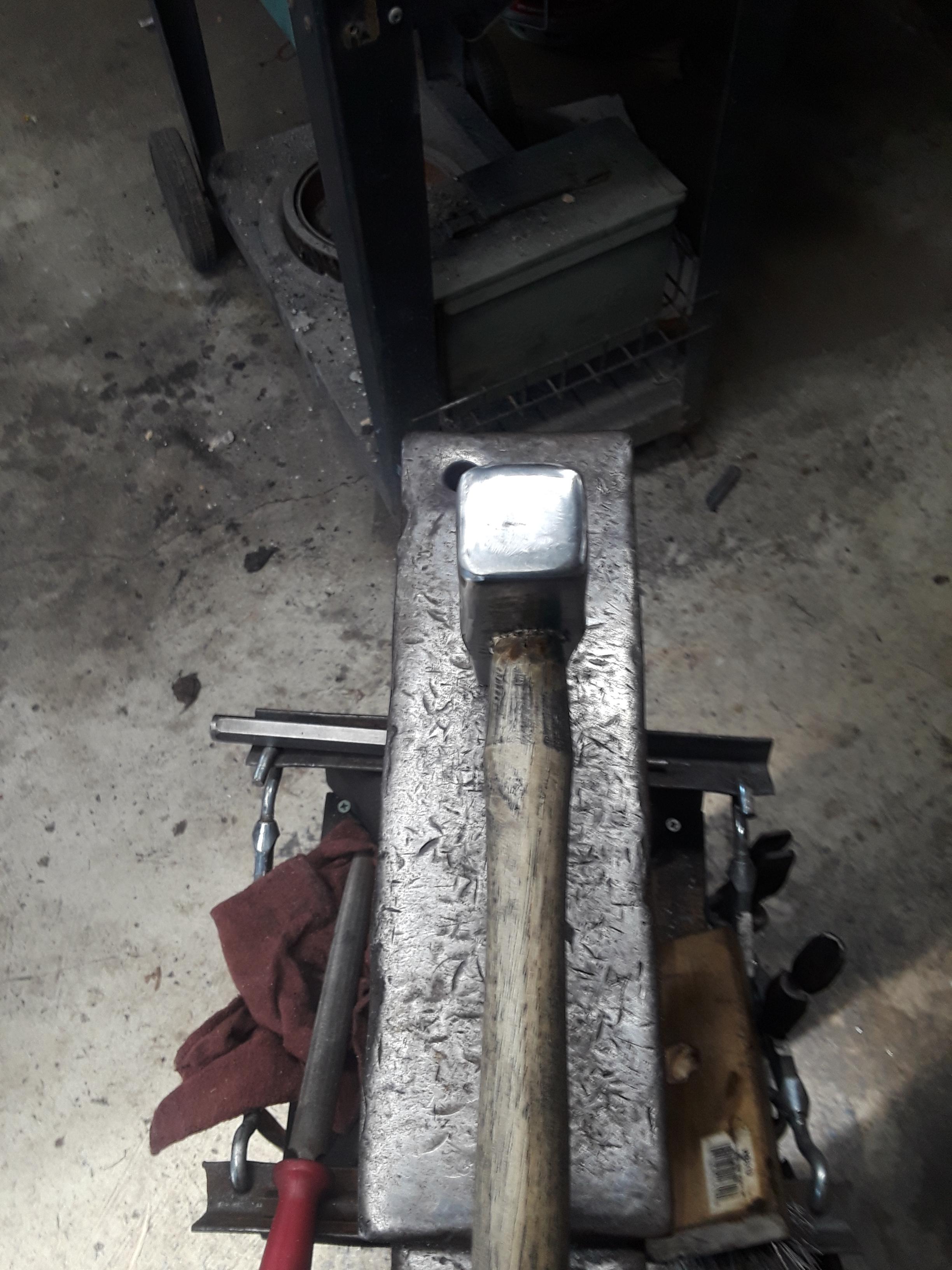

BillyBones Posted May 9, 2019 Share Posted May 9, 2019 Small bass, heck i would fillet that thing. Oh, wait it may be a little hard on the teeth So i finished my hammer today. While tempering i dropped it on a rug. Man that rubber stuff they make them out of now is hard to get off. keeps clogging the grinder. (dont ask, the old lady wanted to see the "pretty colours") Anyway, like i said 4140 steel, hardened very nice. came out at just a couple ounces under 3#. i can not beleive the difference in using a good hammer. I just used it t taper out a couple pieces of steel. 5/16, 3/8, then 1/2. moved the meta real nice. It is a little crooked, but that is because my rasp skills need some work. And yeah i know it should go all the way to the split but when i did my last fitting i could not get it back off. I will just wait for it to break then re-do the handle. Put a little ebony stain on him. feels good and most importantly i like it. Quote Link to comment Share on other sites More sharing options...

Daswulf Posted May 9, 2019 Share Posted May 9, 2019 Awesome job C-1 Nice hammer Billy. Hah, it'll hold up for a long time since you said that. Quote Link to comment Share on other sites More sharing options...

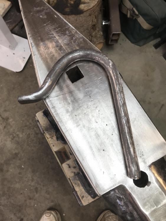

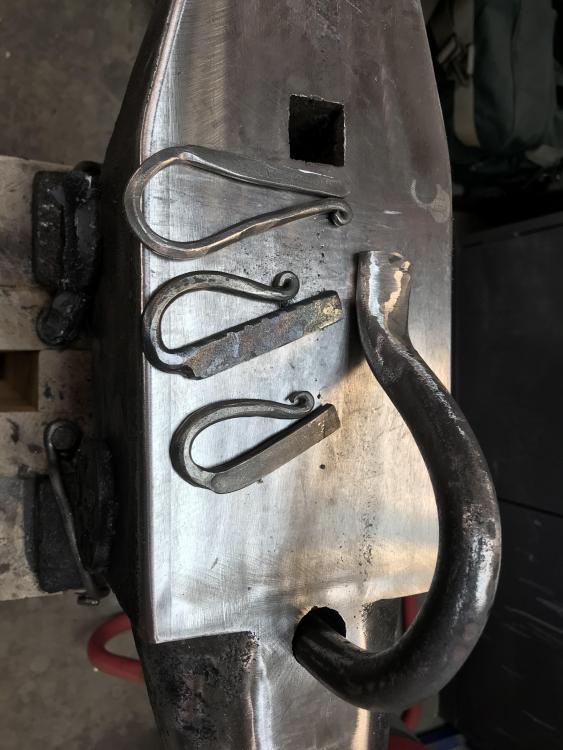

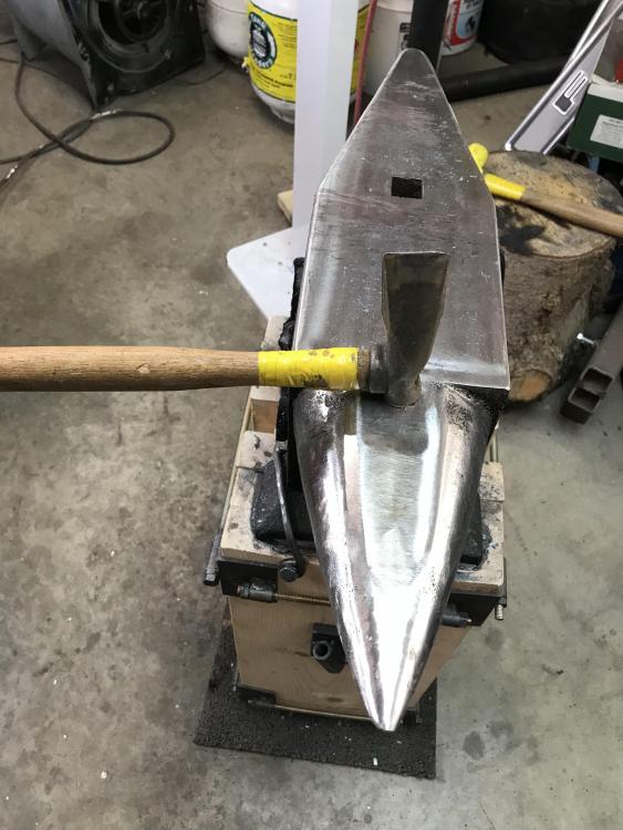

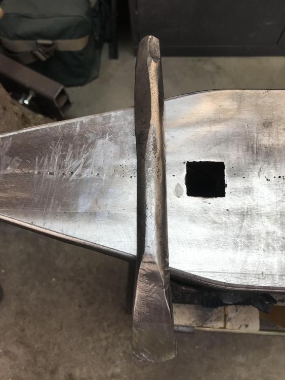

Chris J Dixon Posted May 9, 2019 Share Posted May 9, 2019 Processed some coil spring. Made myself a holdfast and a chisel. The holdfast works great but I got my marks all wrong on the chisel. But, I hardened and tempered it anyway and, in the words of Doug Marcaida, “It will cut.” Or rather chisel. Then I made a few strikers from garage door spring. It pays to draw it out in pencil first but they spark after hardening so.....success. Also found that my chipping hammer doubles as a useful hotcut in the pritchell hole. Quote Link to comment Share on other sites More sharing options...

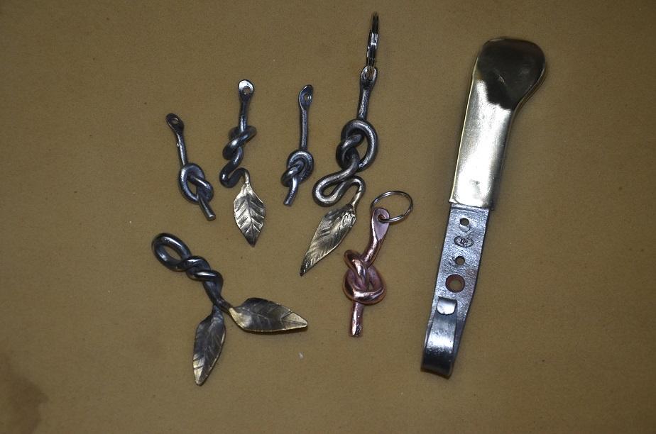

ausfire Posted May 9, 2019 Share Posted May 9, 2019 A bit sore in the hammer elbow today, so the demo was limited to light stuff. Made a few knot keyholders. The copper one was a bit of a challenge. It likes to melt and is fragile when tightening the knot. Got there on the second try. Also made a wall hook from an old piano pedal. It could sit nicely with the treble clef hooks that musical people like. Quote Link to comment Share on other sites More sharing options...

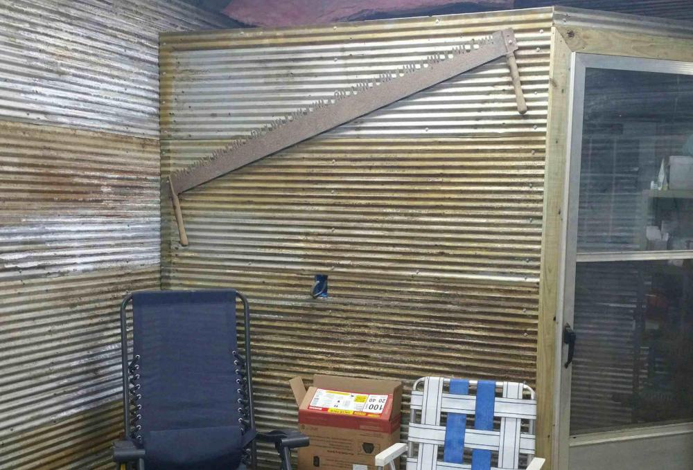

materman Posted May 9, 2019 Share Posted May 9, 2019 Though I am far from being done with the inside work in my shed, I was finally able to put up me first wall decoration. Can remember my dad having this saw hanging on various shed walls for forty years, and now it has found a home in mine. He actually bought it new and to this day it has never been used. I have tried many things at least once in my life to at least say I have did that, but never a crosscut saw. Quote Link to comment Share on other sites More sharing options...
Jim Coke Posted May 9, 2019 Share Posted May 9, 2019 Greetings Rojo and Dave, i think you got the idea for old socket adjustable bending forks from me long ago. I also make forks that extend over the side of the anvil that are secured by a wedge in the hardy hole. All work great for different applications. Have fun Forge on and make beautiful things Jim Quote Link to comment Share on other sites More sharing options...
Dave51B Posted May 9, 2019 Share Posted May 9, 2019 I think yer right Jim, makes good use of those flee market sockets......works a treat..... thanks Dave Quote Link to comment Share on other sites More sharing options...
