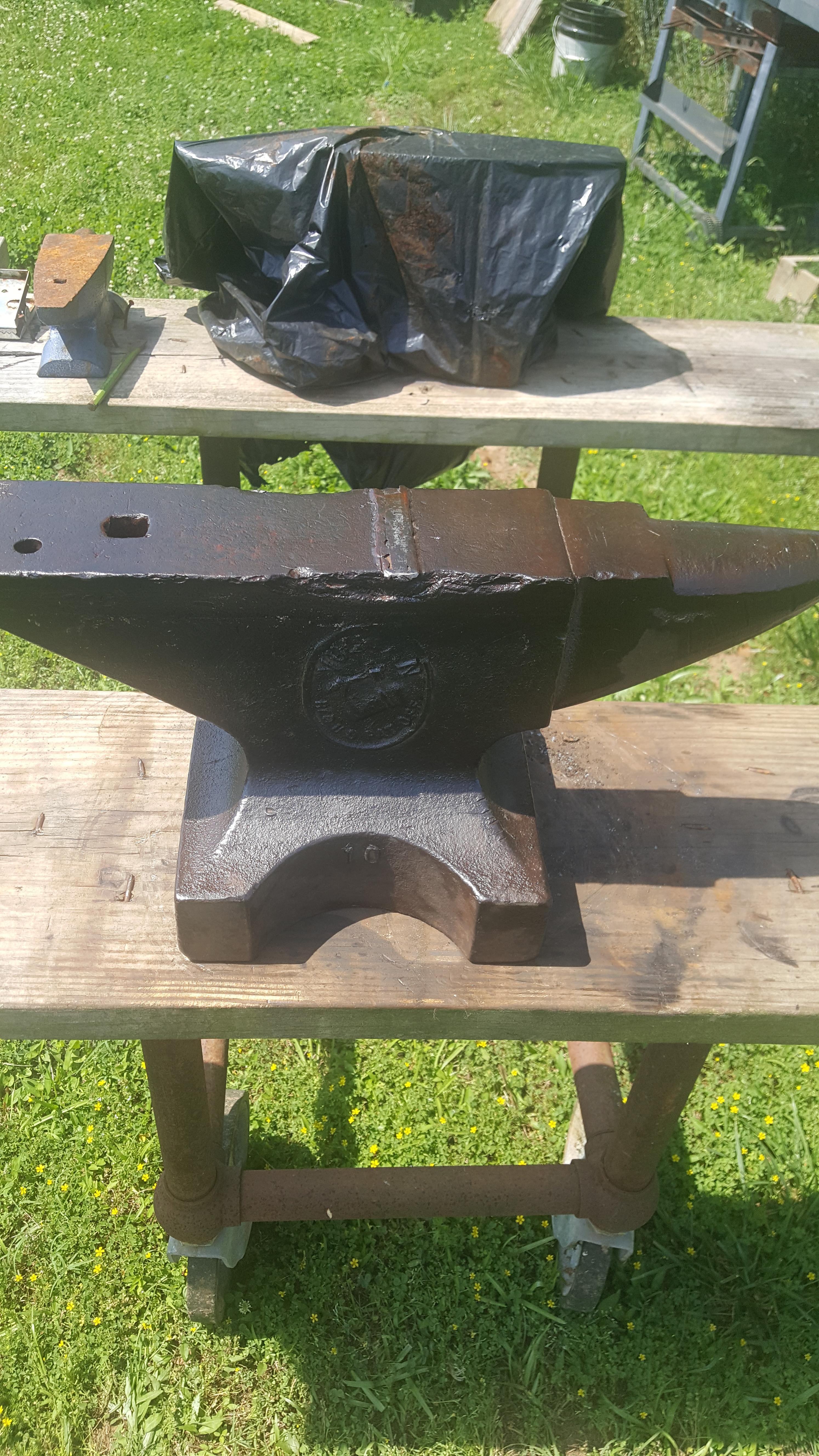

Ben Hoover Posted May 19, 2019 Share Posted May 19, 2019 Today I fought the rust monster with a wire wheel and boiled linseed oil. I think I did okay. Quote Link to comment Share on other sites More sharing options...

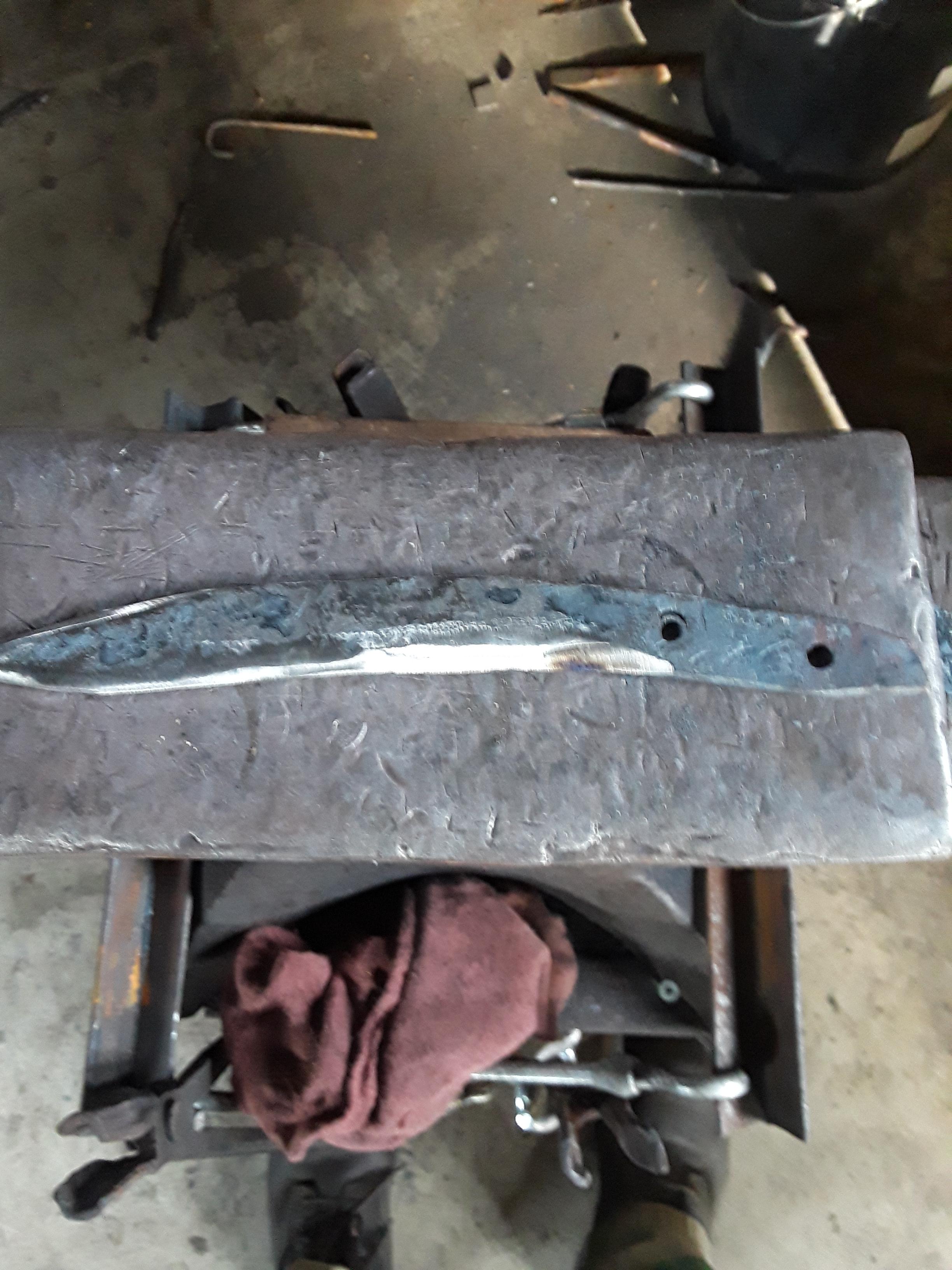

BillyBones Posted May 20, 2019 Share Posted May 20, 2019 I think there is something in the Bible about the glove. I aint no Bible scholar but i seem to remember: "To every thing there is a time a time to be gloved and a time to be bare. " Seriously though, my neighbor came over today and asked if i could show him how to make a knife. To which i said i am not a bladesmith but i will show you what i know. I gave him a piece of coil spring, a set of tongs, a hammer, and said here ya go. The only real problem i saw, besides hammer control, was not standing straight. I showed him how to punch a hole also (4 tries and he got the hole through) but for never putting hot metal to an anvil i think he did pretty well. The plunge is not as deep as it looks and can be easily corrected. There is also going to be a weak spot on his hole obviously. But all in all not bad in my opinion. His old lady come and took him home so we will finish the grind and heat treat later. Quote Link to comment Share on other sites More sharing options...

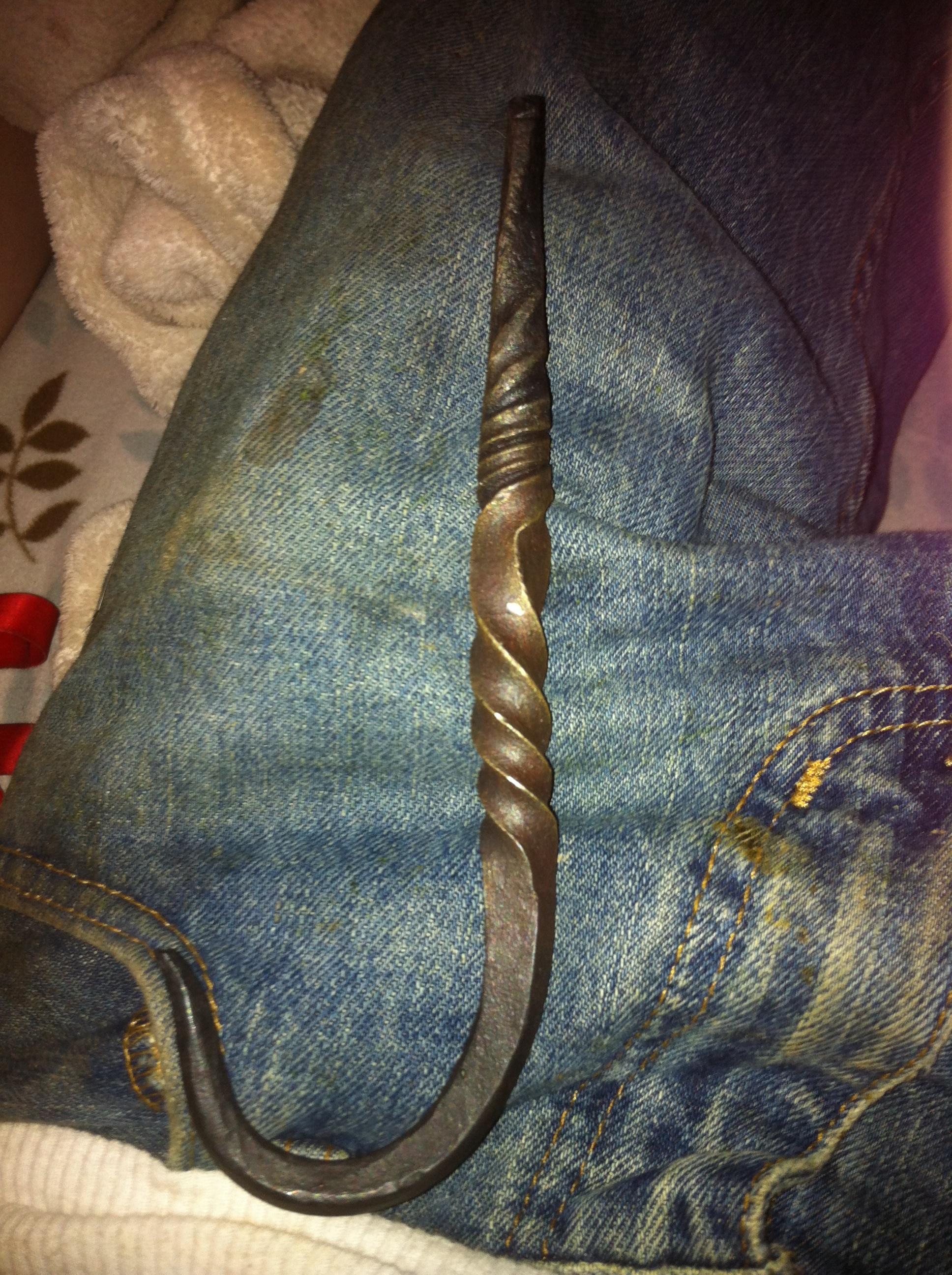

Pr3ssure Posted May 20, 2019 Share Posted May 20, 2019 Forged a wall hook today. The top twist went a little tight. I brass brushed it also. Quote Link to comment Share on other sites More sharing options...
Cannon Cocker Posted May 20, 2019 Share Posted May 20, 2019 How are you planning on attaching that hook to the wall? Quote Link to comment Share on other sites More sharing options...

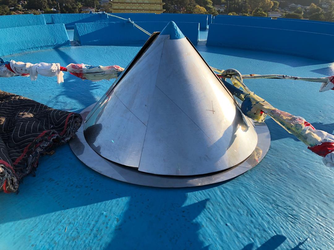

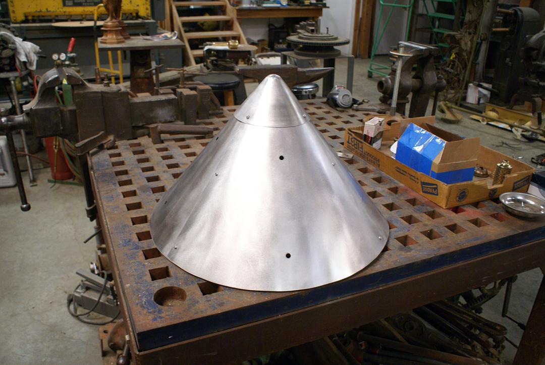

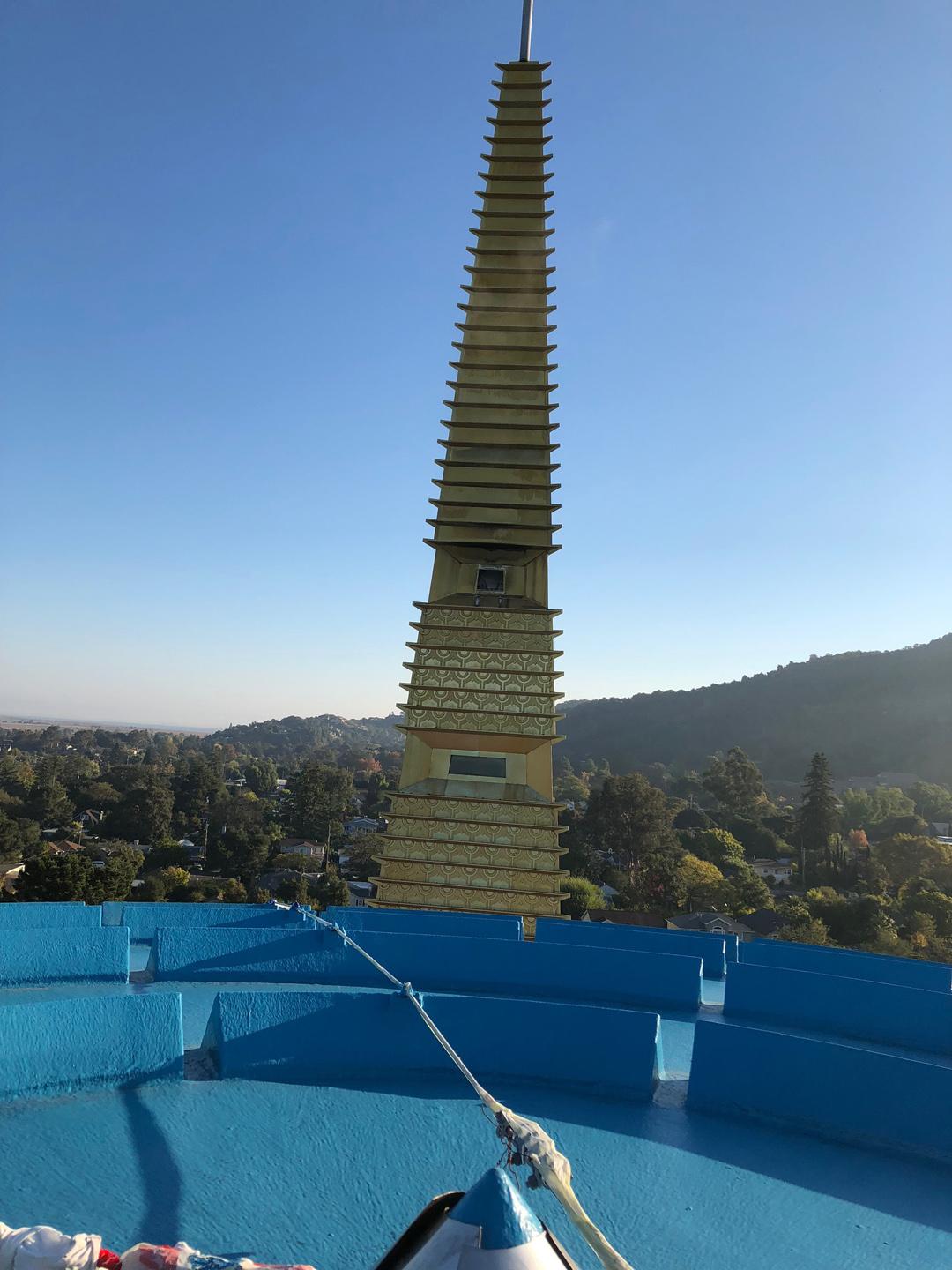

gaswizard Posted May 20, 2019 Share Posted May 20, 2019 Finished making a witches hat out of 304 stainless steel for the Marin Civic Center dome. This was made to protect the new rubberized roof coating from safety cable/ropes from rubbing through at the top of the dome. Install later this week. Quote Link to comment Share on other sites More sharing options...

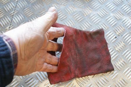

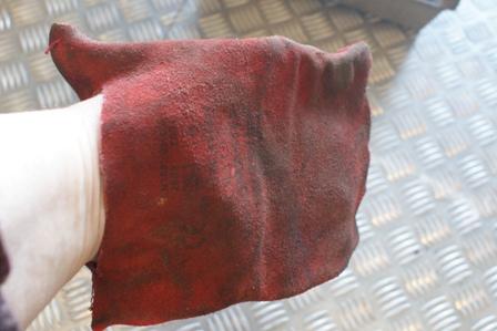

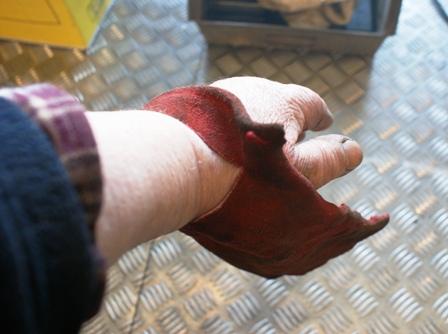

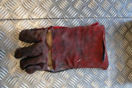

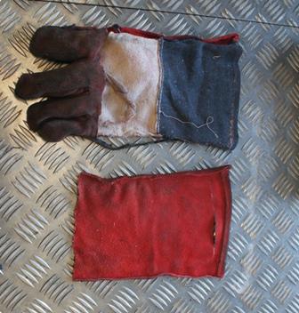

John B Posted May 20, 2019 Share Posted May 20, 2019 38 minutes ago, ThomasPowers said: Recycling is a good thing. I don't like gloves, so I use a leather palm protector Cut off (fillet) the wrist protector portion and put a slit in it for your hand to pass through. Left or Right Hand Quote Link to comment Share on other sites More sharing options...
