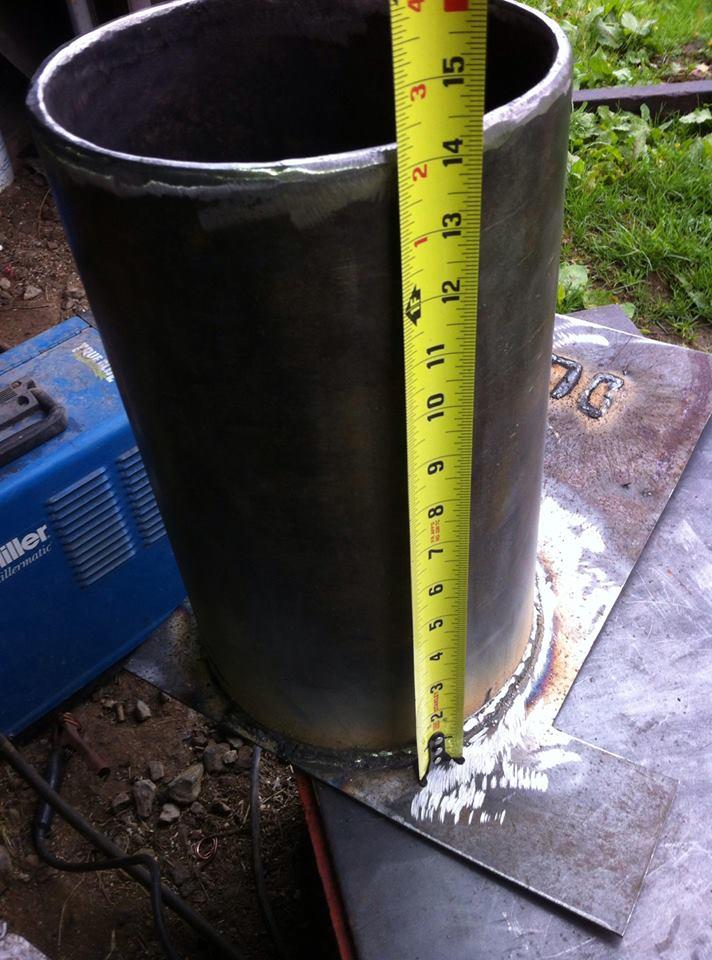

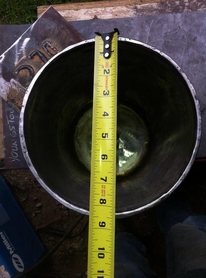

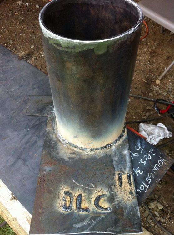

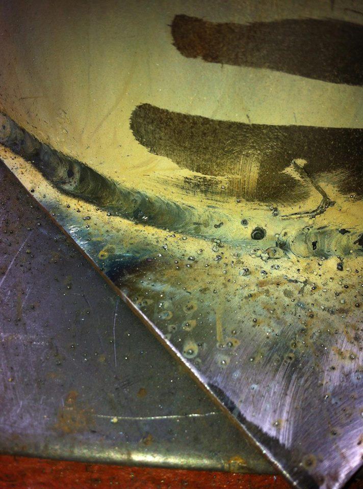

Welded up a quench tank today. I got the mig welder in the shop up and running yesterday and used it today for my first time not stick welding. I think I can run a better bead with the mig than a stick and I've been able to stick weld for almost 10 years (well enough to call it a weld at least).
Does it leak? Bear this one fact of welding life in mind. Mig welders make better LOOKING beads, NOT better welds. Migs are famous for "cold lapping" welds, that means lay a beautiful bead that's only stuck to the surface with virtually no penetration.
Not saying you've laid bad welds, just saying to keep your eye open for the possibility of cold laps under beautiful bead till you get used to GMAW. They are NOT point and weld, you still have to make a puddle and fill it.

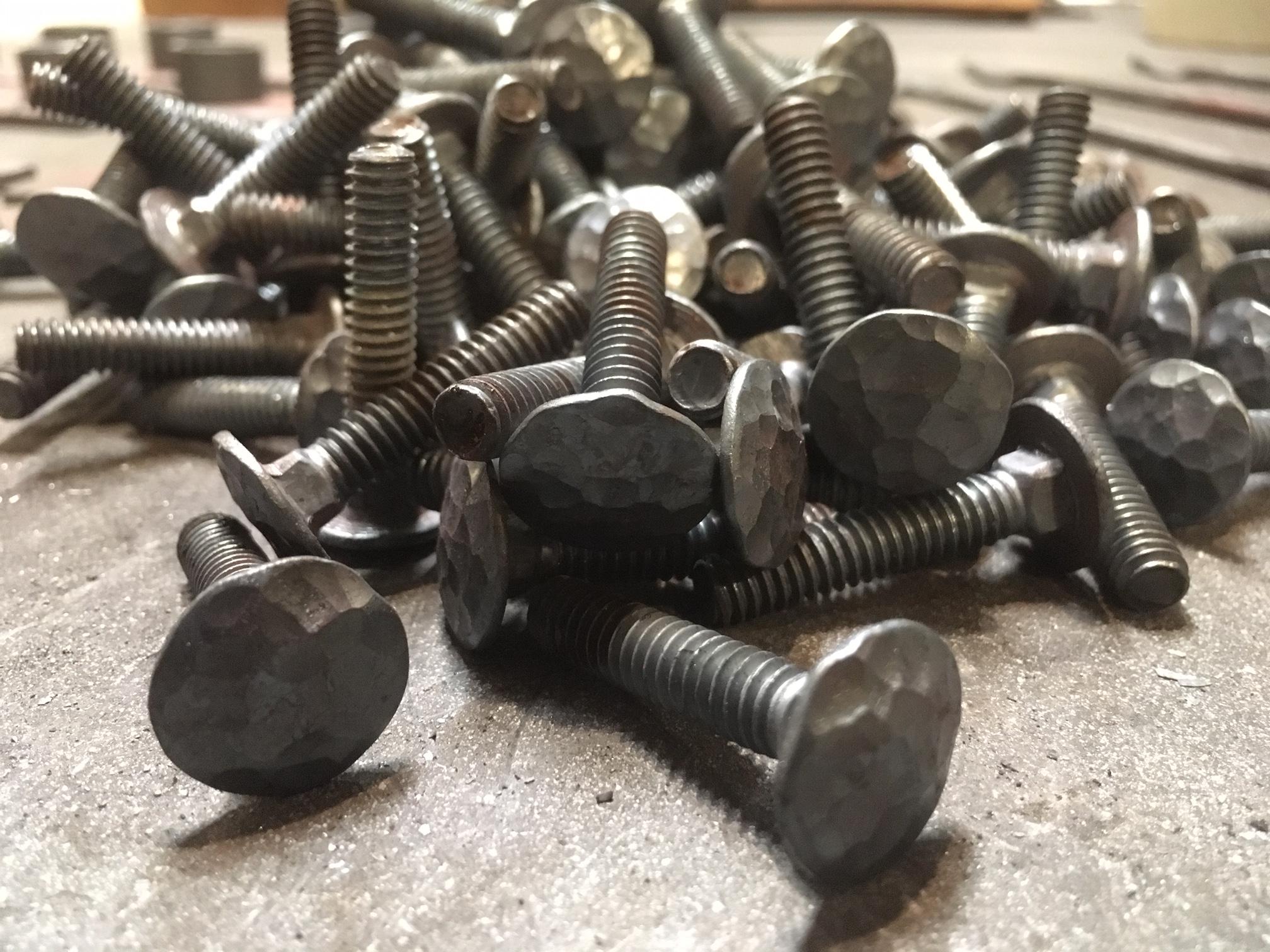

Here's what I did in the shop today.  Mostly texturing, felt like about a thousand pieces but it was only 150.  Plus some forge welding of hinges, fabricating barn door roller hardware, forged a half dozen small pulls.  Cut and chamfered track standoffs.
Nice work Judson,  also, I can match you, and raise one pants on fire.

Yeah, I was making sure to get decent penetration. I haven't tried filling it yet, gonna do that tomorrow. I also ran a weld on the inside for more stability and did a second weld over the first one on the outside.
Test it with water. Yes? It's a LOT easier to clean up if there's a leak and won't cause porosity when you try patching it. If you fill it with oil and it leaks we ARE GOING TO LAUGH AT YOU! :lol:
That many beads is just beginner overkill, no sweat. ;)
A quench tank or similar weld isn't structural so you don't need or actually want to make that many passes. For now you'll learn a LOT faster making single beads and finding out what's not right about them. Make sense? Lighter stock is better to learn on, you can see what's happening from the far side.
Once you start getting proficient, practice on 1/4" stock coupons and test the welds. Say cut a bunch of 1/4" x 2" strap stock in 2" lengths and butt weld pairs. Put it in a vise about 1/2" below the bead and bend it over with a hammer.

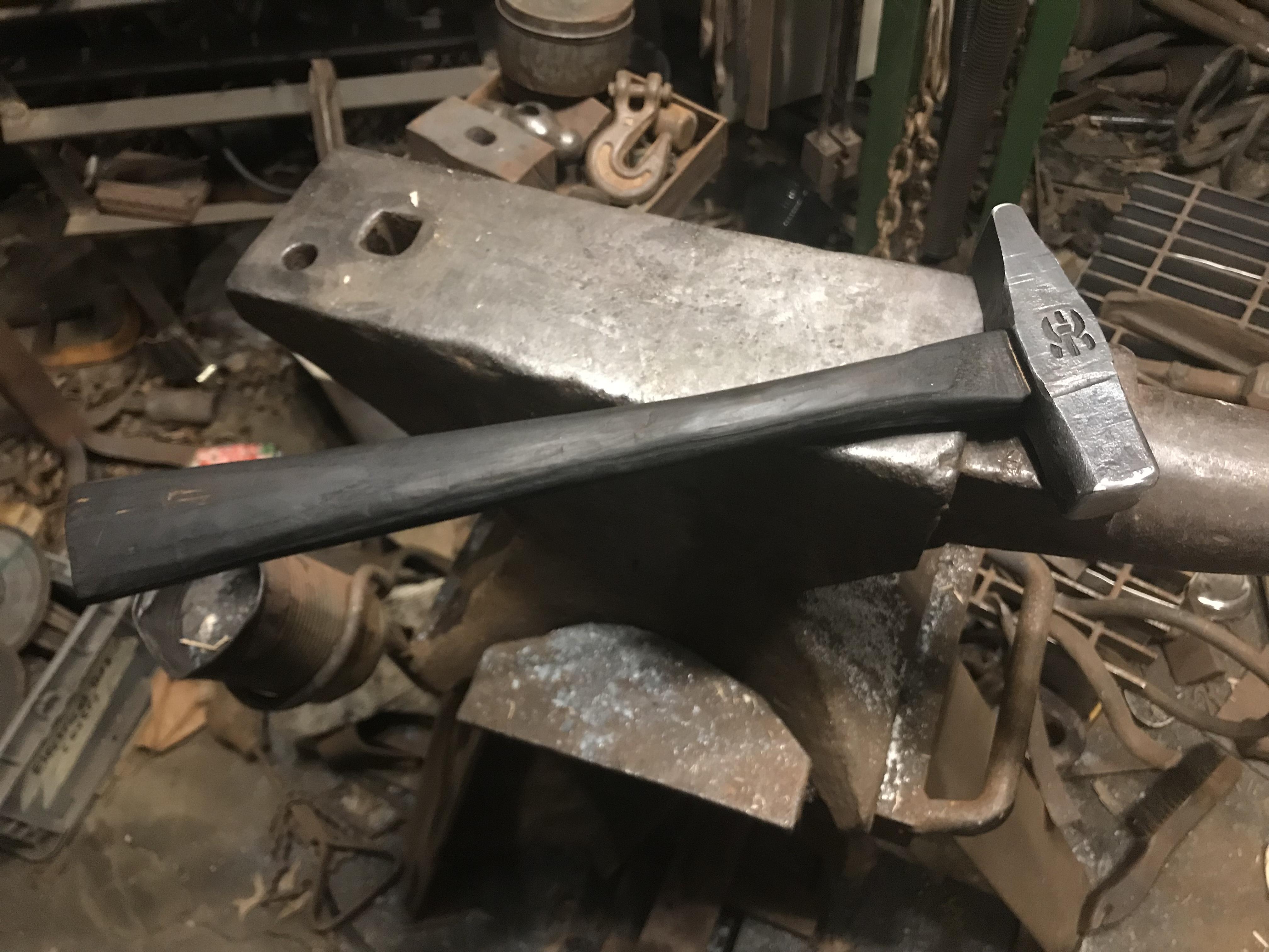

Finished a light (~2lb-ish) cross peen I’d been working on. Sweet little thing; I’m looking forward to trying it out.
(This was from a piece of shafting from the industrial surplus warehouse. Sparks like 4140, as best I can tell.)
Nice work John.

Thanks das, I just watched some videos yesterday and luckily the wire in the welder was flux core. I didn't even know you used gas with mig until last night. It's just a little Miller running on a 120 v plug. But it seems to do alright for smaller stuff. The plate I used for the quench tank was like 3.something mm, I think that's 1/8th inch. The cylinder was half inch though so I'm glad it worked. My last few welding rods are all broken up.
Im definitely down to plan something out though this summer. Would also love to get someone to help me make a hammer. I've also gotta keep myself occupied in a productive way for 2 years due to some, well err, legal reasons. So I'm gonna be doing a lot this summer.
Also, I have yet to fill it with water.  Will do that tomorrow.

Flux core is harder than GMAW but a decent welder with practice. If you can get some time with someone with experience you'll get better fast. Take Das up on it it'll be like going to college. Oh sure a weird, spider, roboctopus, etc. critter filled college but advanced learning for sure.

JHCC Love the hammer.  Looks like it will be a metal mover for sure.
