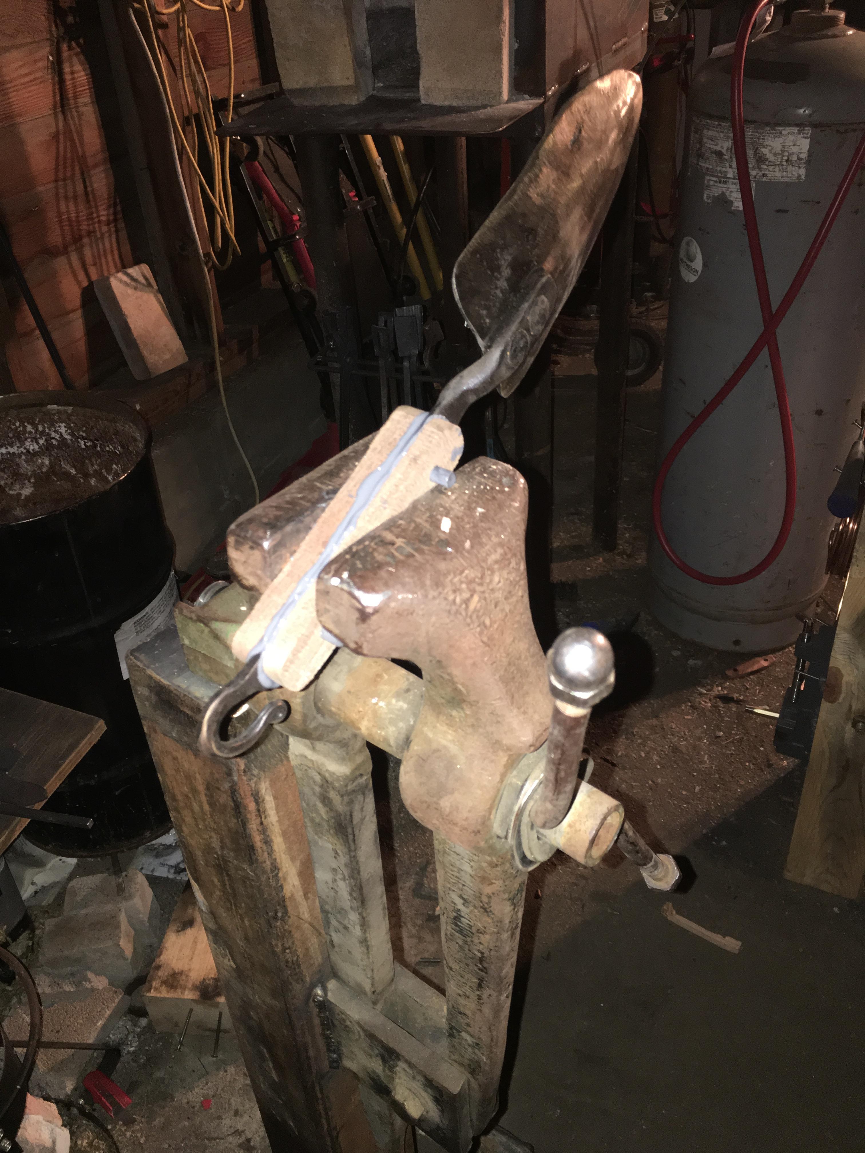

Cannon Cocker Posted May 4, 2019 Share Posted May 4, 2019 I got the scales glued on with the rivets in place last night. But I had to fly down to Saint Louis for the week. So I'll be finishing it next week when I get back home. Quote Link to comment Share on other sites More sharing options...

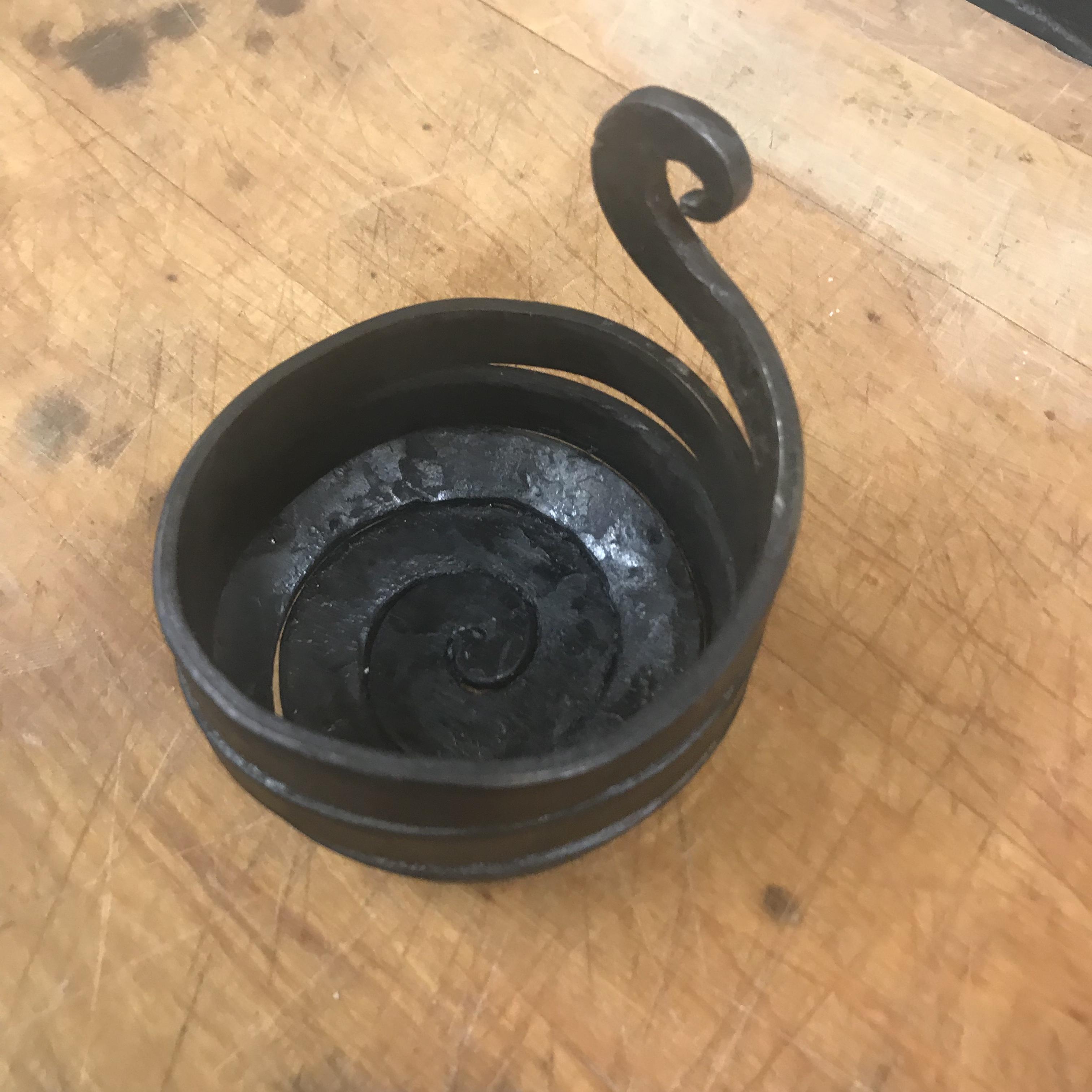

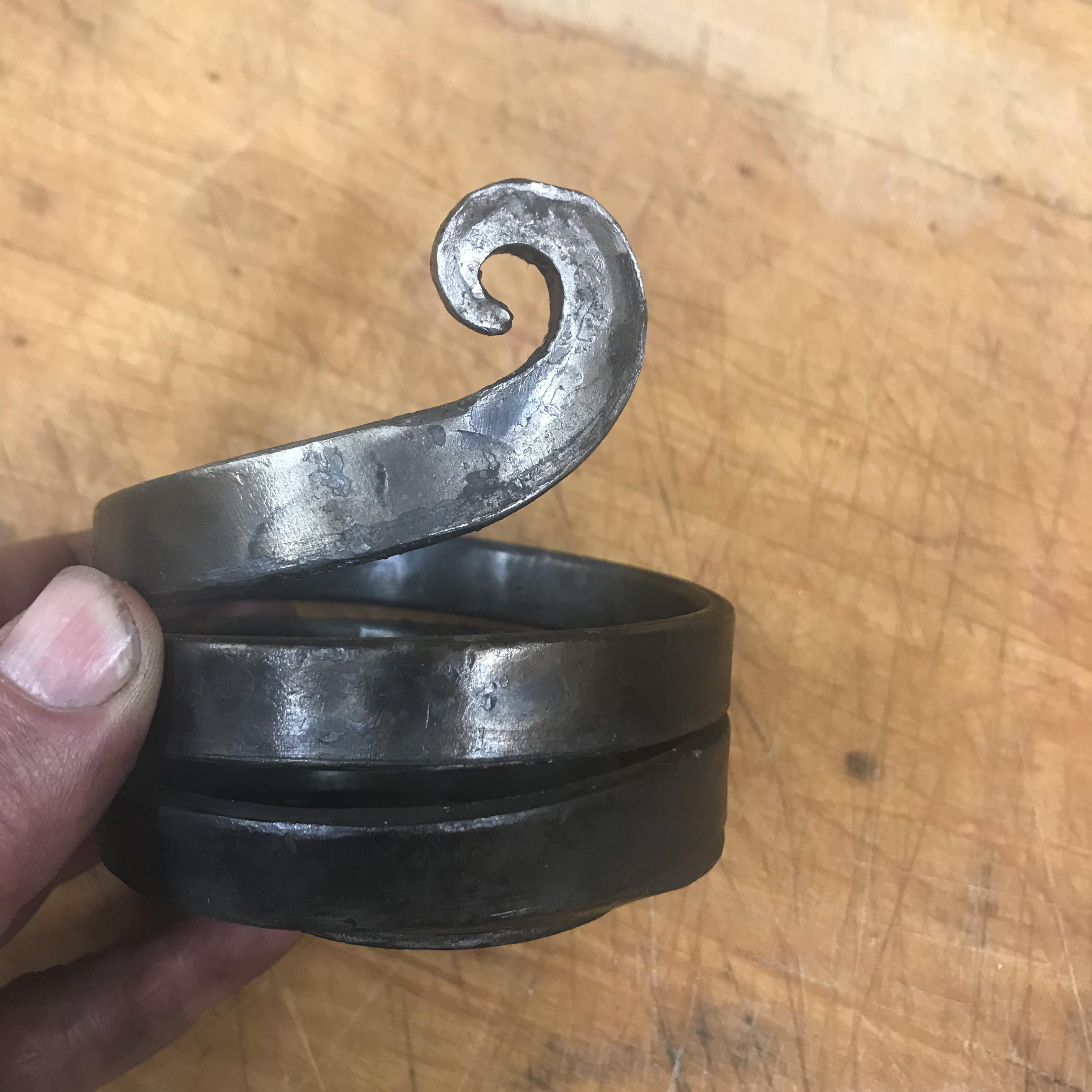

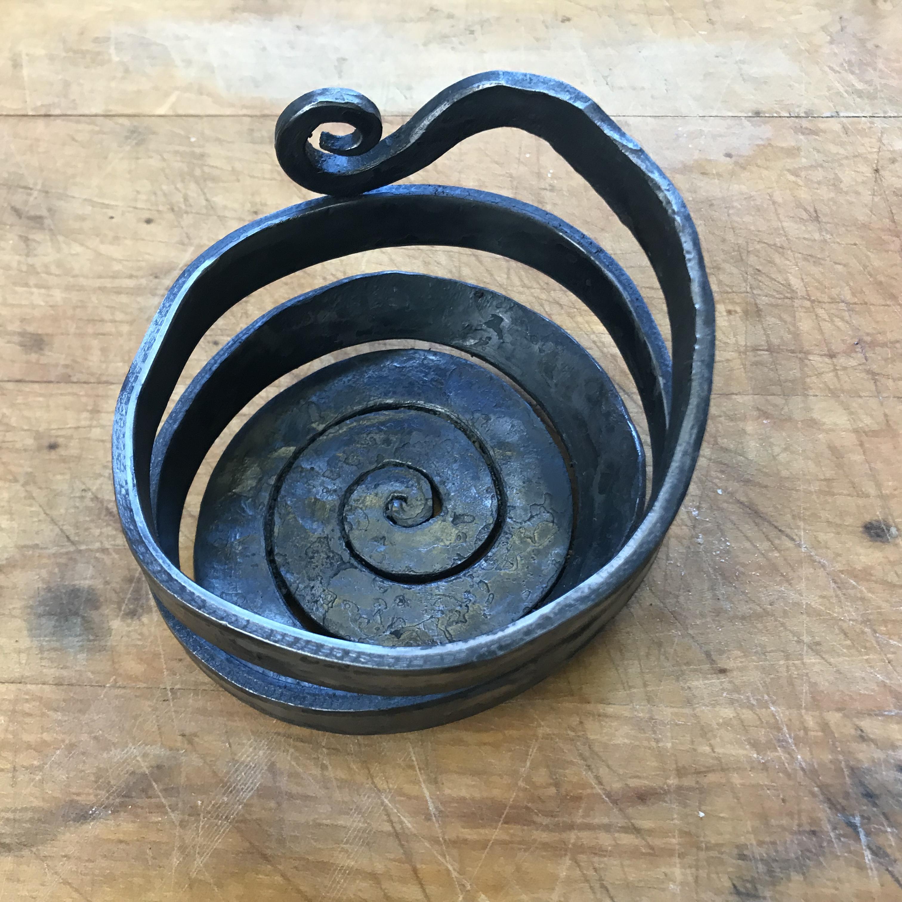

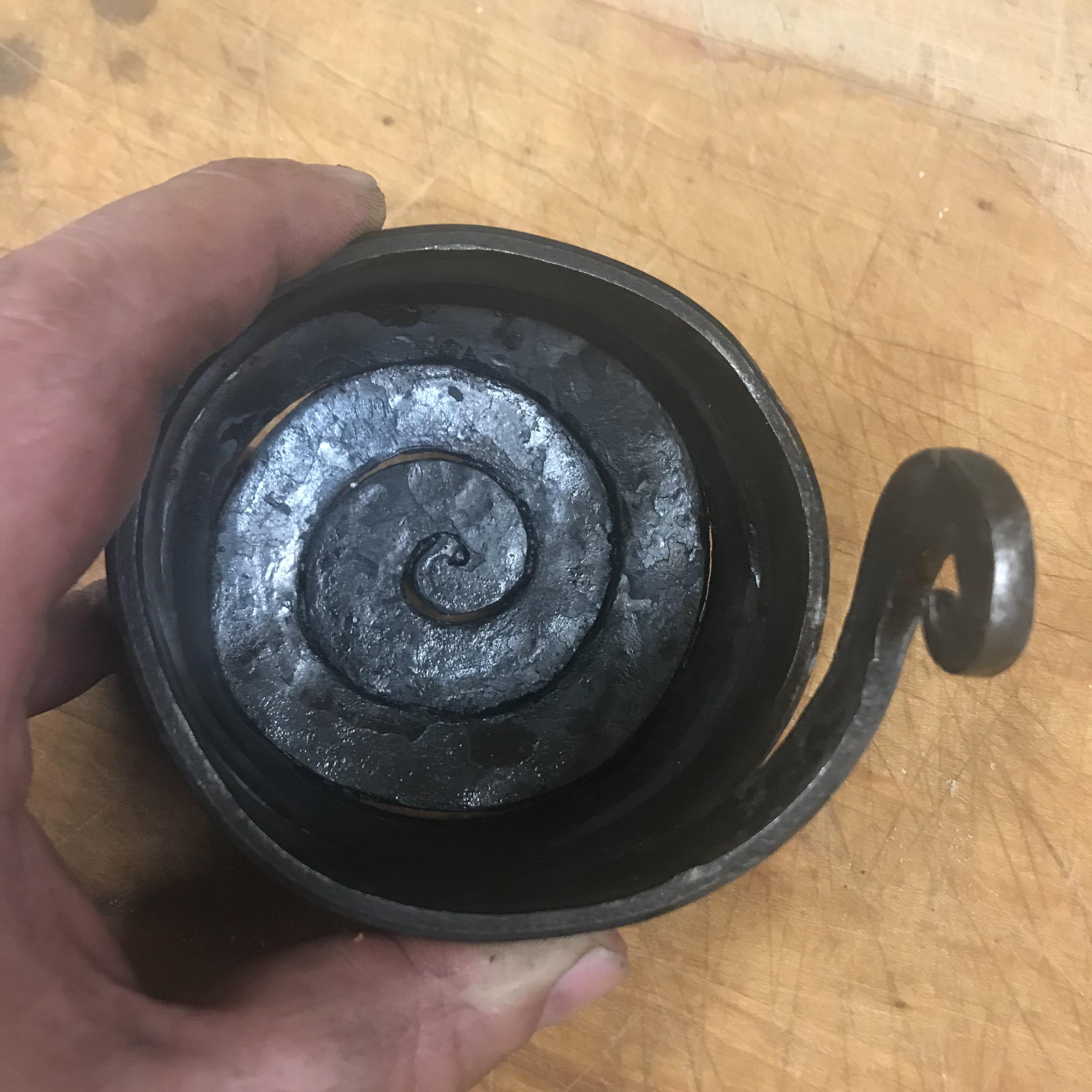

JHCC Posted May 5, 2019 Share Posted May 5, 2019 Another yarn bowl, this smaller one made from a spiral of flat bar that starts out bent the hard way and transitions to the easy way. Kind of a proof-of-concept; Lisa says she loves it, but I only see the flaws. Quote Link to comment Share on other sites More sharing options...
Ted Ewert Posted May 5, 2019 Share Posted May 5, 2019 Thanks Frosty! It tends to appeal more to the males I've shown it to. JHCC: I like it, it's a functional and visually appealing piece. Nice idea, I may borrow the concept (with your blessing) since I know a spinner who would appreciate it. What's the diameter? Quote Link to comment Share on other sites More sharing options...

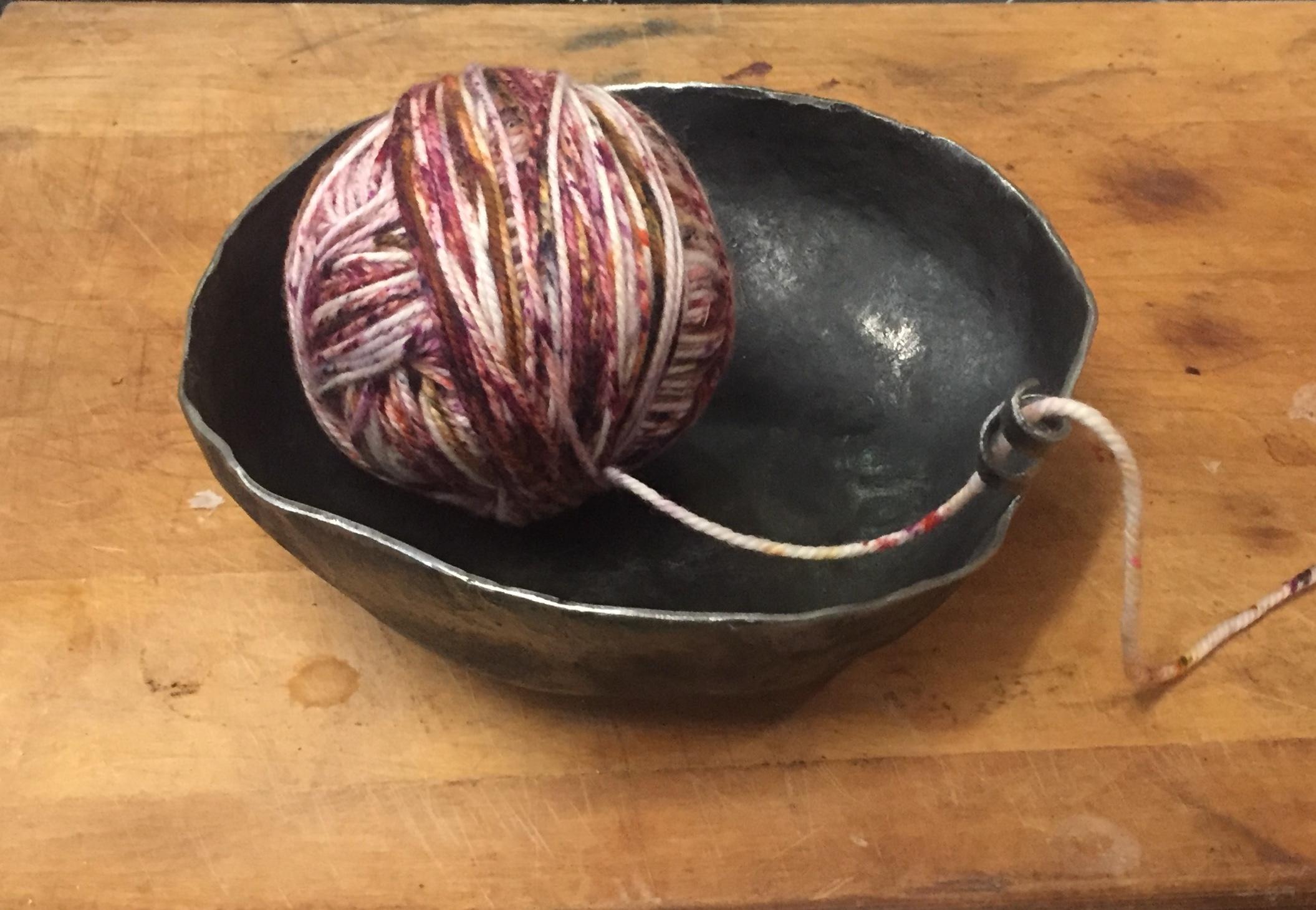

JHCC Posted May 5, 2019 Share Posted May 5, 2019 It’s about 4” in diameter and 4” tall. It’s a bit small, but I couldn’t make it much bigger and still be able to fit it through the opening of my gas forge. Here’s another I made, a more conventionally raised bowl with a pigtail on the edge to hold the yarn: Quote Link to comment Share on other sites More sharing options...
Frosty Posted May 5, 2019 Share Posted May 5, 2019 I like your latest yarn bowl John. I assume the finial scroll is the yarn guide, holder . . . like the pigtail on the other one. Nice, marketably attractive. Frosty The Lucky. Quote Link to comment Share on other sites More sharing options...
jlpservicesinc Posted May 5, 2019 Share Posted May 5, 2019 John, nice work. the transition point is well hidden making it look seamless. Well done. Ted, that is a neat door knocker. Nice clean work. Quote Link to comment Share on other sites More sharing options...
BillyBones Posted May 5, 2019 Share Posted May 5, 2019 Pretty darned cool door knocker there Ted. JHCC, thanks for the pic of what a yarn bowls purpose is, i had no clue and was going to ask how it was used. Now i know what to make mom for mothers day. She is more into quilting but i know she will figure some use for it. Quote Link to comment Share on other sites More sharing options...
Cannon Cocker Posted May 5, 2019 Share Posted May 5, 2019 I'm a big fan of that door knocker. I've been wanting to make one, but haven't picture what I want it to look like....... So now I've got another idea to play with! 18 hours ago, Ted Ewert said: The wife informed me halfway through that it's not going on her front door. No worries, I just wanted to build it anyway. No worries. It would look cool in the door to your shop, or even just on the wall in there. It really is a great piece. 18 hours ago, Ted Ewert said: Nice trowel CC! Thanks. The hook on the end grabs onto a belt loop very easily so it should be a tool that is easily at hand for her when she's gardening. Quote Link to comment Share on other sites More sharing options...
BillyBones Posted May 5, 2019 Share Posted May 5, 2019 CC, completely missed the trowel. That is looking great. What kind of wood? Quote Link to comment Share on other sites More sharing options...
Cannon Cocker Posted May 5, 2019 Share Posted May 5, 2019 Black walnut Quote Link to comment Share on other sites More sharing options...

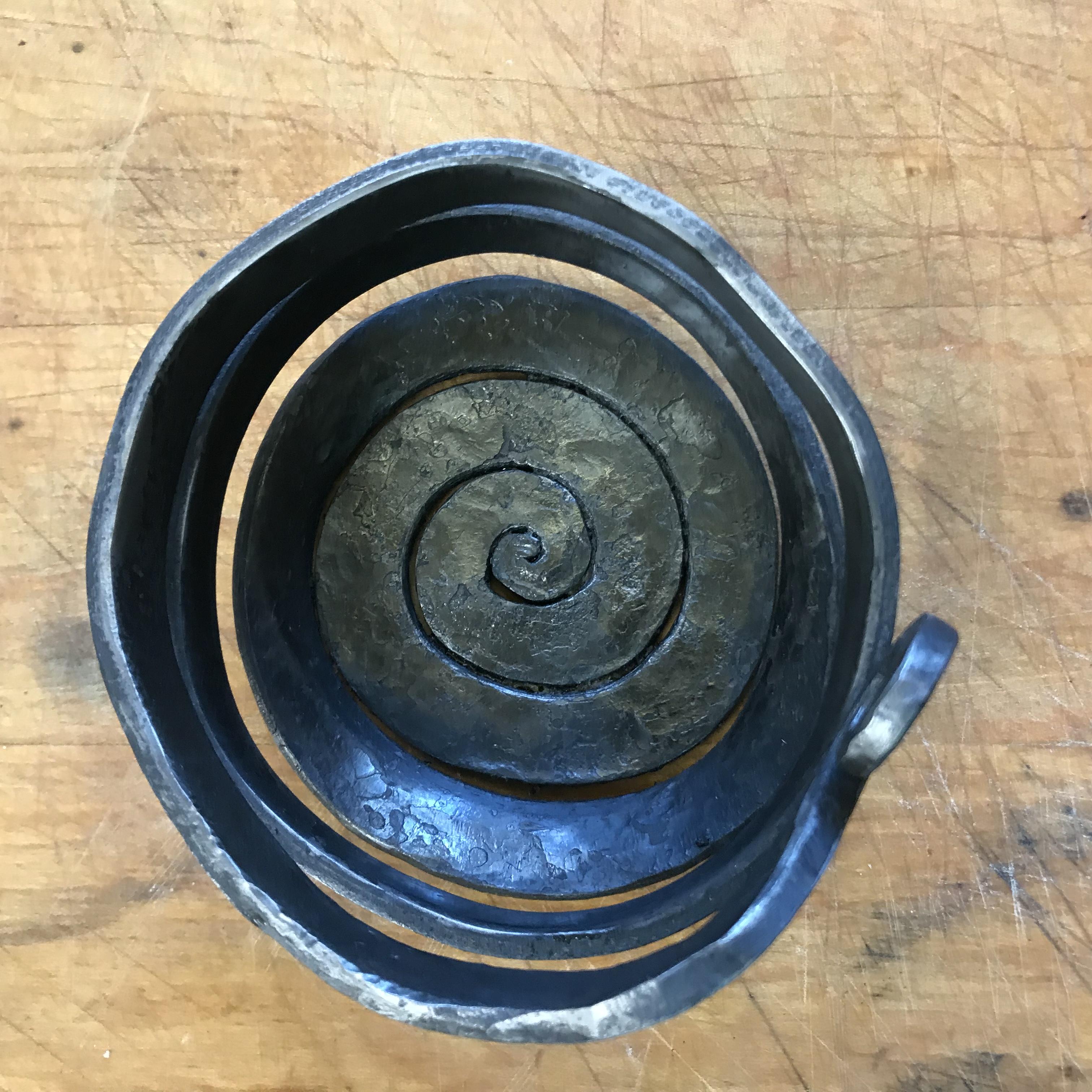

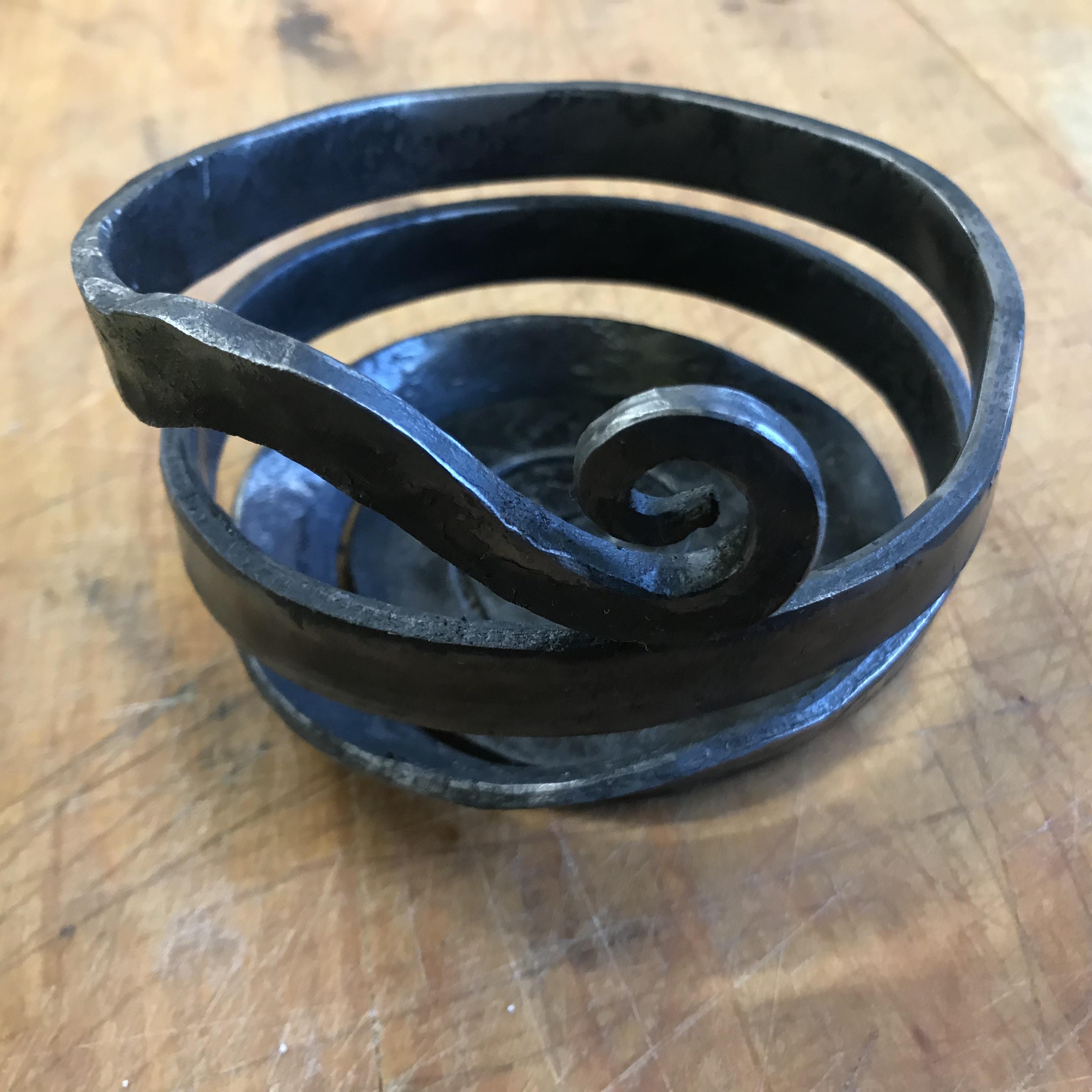

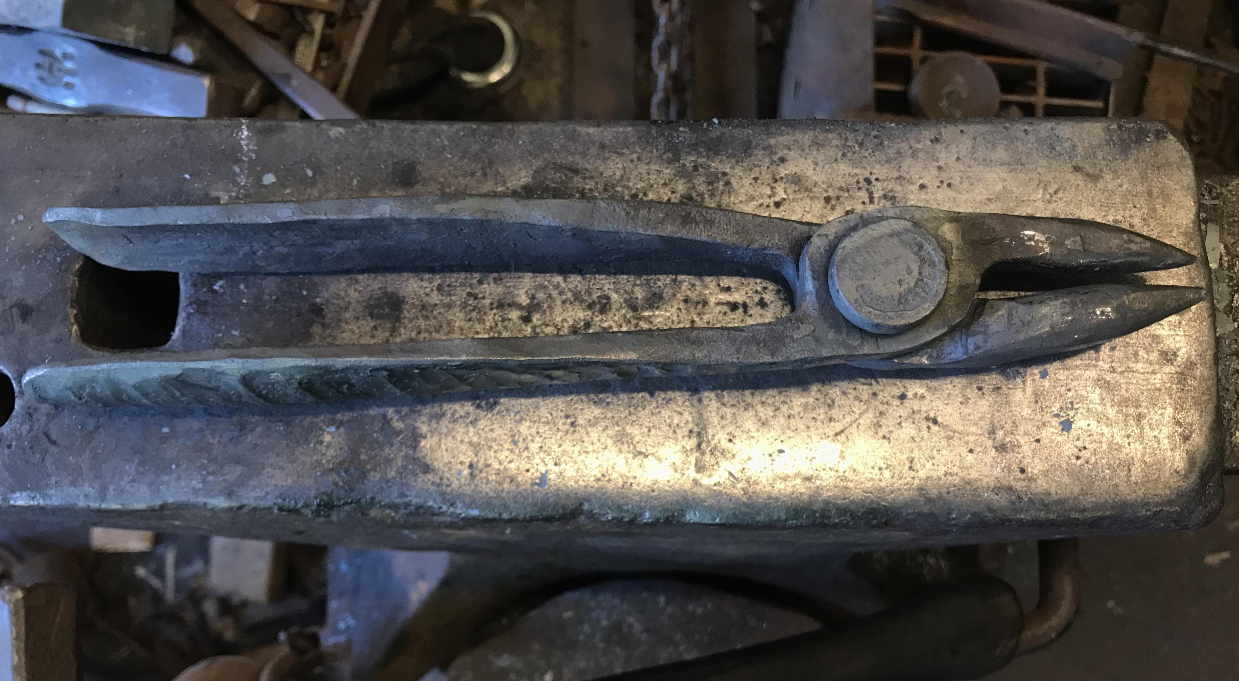

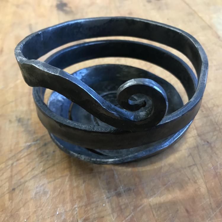

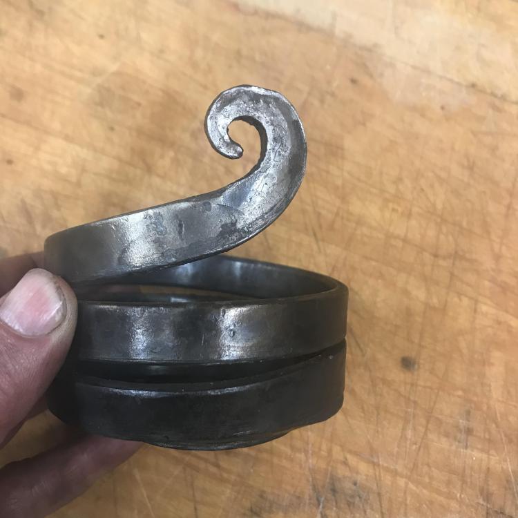

JHCC Posted May 5, 2019 Share Posted May 5, 2019 Drew out the handles on the scrolling pliers a bit longer: And made another yarn bowl, which I like more than yesterday’s (but still am not quite satisfied with): I must say, I’m learning a lot about working flat bar the hard way. Quote Link to comment Share on other sites More sharing options...
Cannon Cocker Posted May 5, 2019 Share Posted May 5, 2019 I really like your design. I think both of those yarn bowls look awesome. What about them do you want to change/clean up? I'm looking forward to seeing those yarn bowls when you get them cleaned up to your liking. Quote Link to comment Share on other sites More sharing options...
JHCC Posted May 5, 2019 Share Posted May 5, 2019 It’s a matter of form and line. The second is better than the first, but it has some irregularities and the curves aren’t as smooth as I want. Quote Link to comment Share on other sites More sharing options...

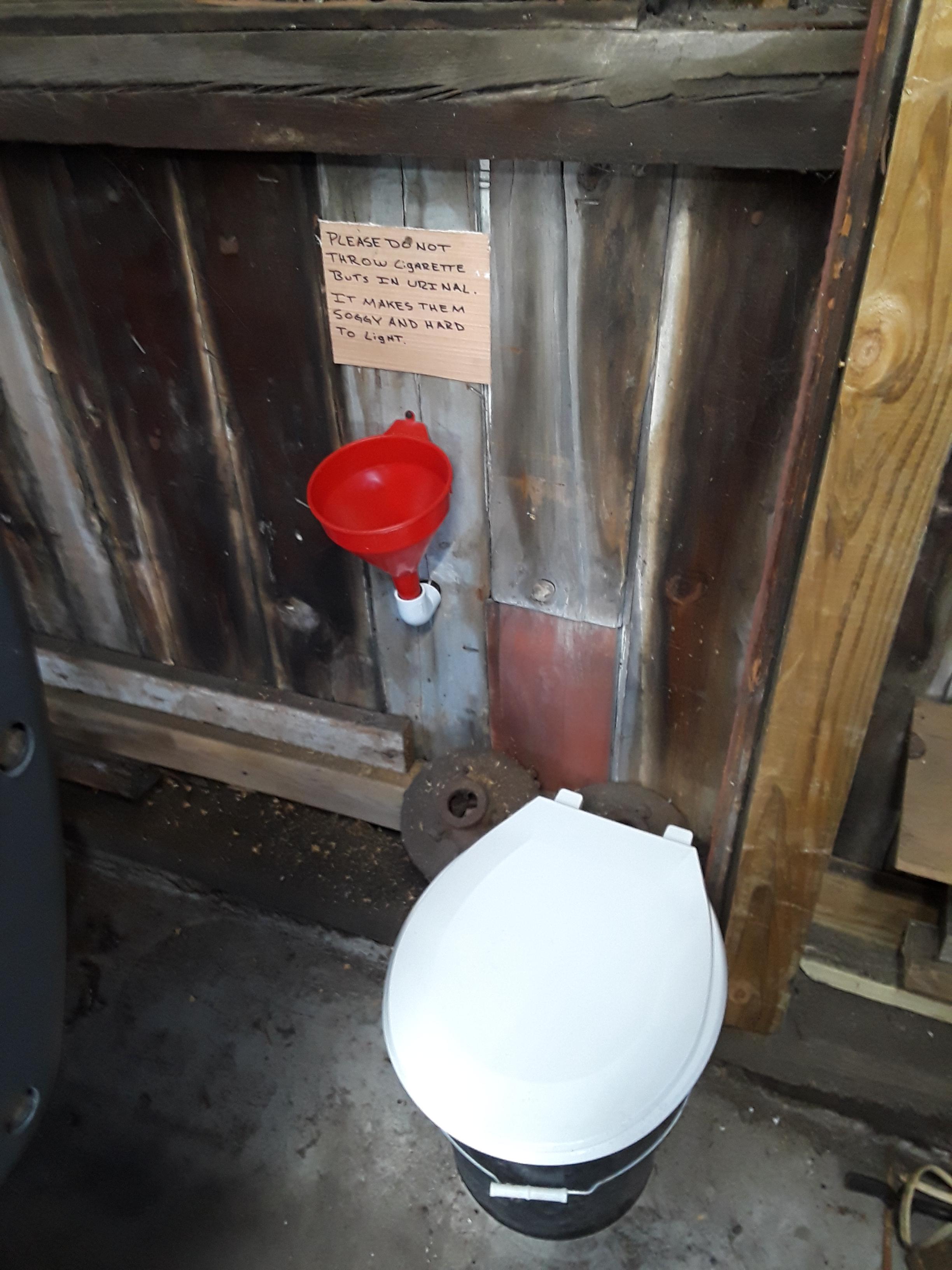

BillyBones Posted May 5, 2019 Share Posted May 5, 2019 Built a "bathroom" in the shop today, for some reason the old lady wont use it. Quote Link to comment Share on other sites More sharing options...
ausfire Posted May 5, 2019 Share Posted May 5, 2019 Ha ha. That's good. Sort of thing I would expect from an Australian!! Except we would call it a dunny, not a bathroom. I shudder to think what the resident IFI punsters will do with this one. Quote Link to comment Share on other sites More sharing options...
ThomasPowers Posted May 5, 2019 Share Posted May 5, 2019 Yarn Bowl: my wife advises to "excessively round the edges". She uses similar things when plying singles. Door Knocker: You mean nutcracker---just put it on the end table with a bowl of pecans! Quote Link to comment Share on other sites More sharing options...

Frosty Posted May 6, 2019 Share Posted May 6, 2019 Excessively round edges and no closing spaces came to my mind at first glance. Deb will be home tonight I'll show her and get the opinion of the family spinner. Being a little wavy doesn't take away from the bowl at all, spinning and knitting aren't perfect crafts a little wobble in the flow is a good thing. Ted: The only thing I'd do different with the hammer knocker is to make the entire back plate an anvil. Aim the peep through the hardy hole. I REALLY like the nutcracker idea Thomas! Needs a couple itsy bitsy pairs of tongs to hold the nuts while cracking and maybe fire tools to pick the meat out of shells. That idea has a LOT of potential. Frosty The Lucky. Quote Link to comment Share on other sites More sharing options...

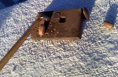

ThomasPowers Posted May 6, 2019 Share Posted May 6, 2019 My nutcracker down here at the casita: That's a Champion ball peen hammer with a US quarter about 2 oclock and a pecan at 6 oclock. I have a Champion #1 hammer for Black Walnuts. (sun going down sorry about the lighting.) Quote Link to comment Share on other sites More sharing options...

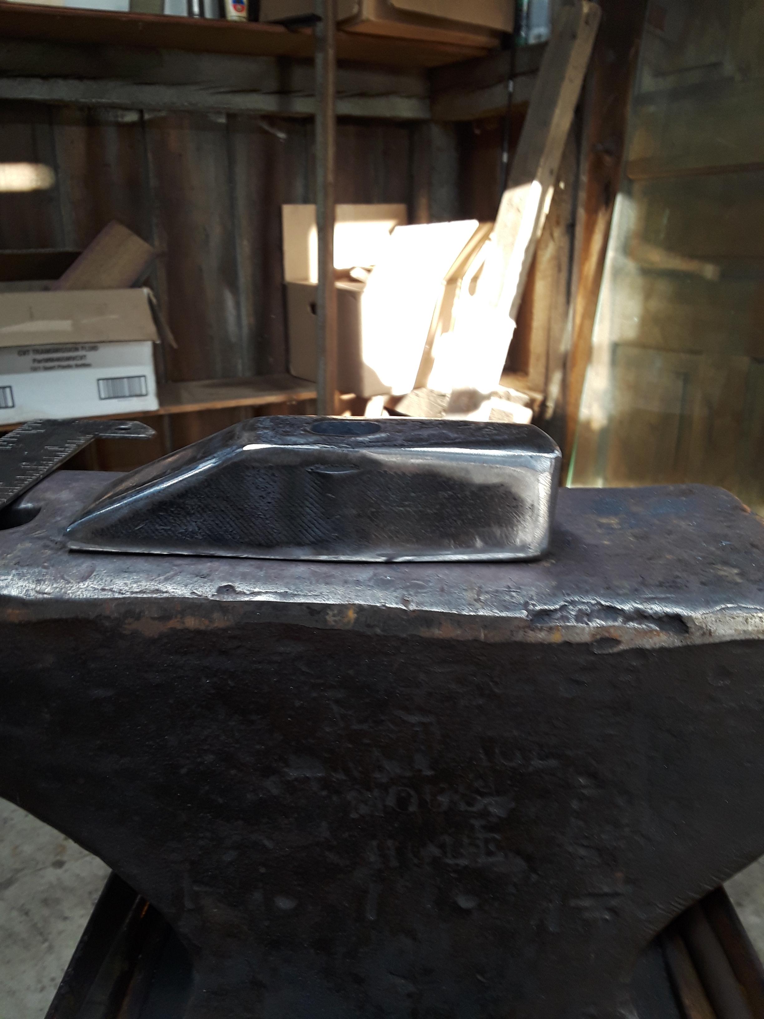

LeMarechal Posted May 6, 2019 Share Posted May 6, 2019 Making two leafinghammers, some clover-leafes and my first hardyfuller Leafinghammers are inspired from Mark Asperey´s books and the fuller has been made using the headingtool in the same books.... Yes I´m a great fan of Mark Quote Link to comment Share on other sites More sharing options...
jlpservicesinc Posted May 6, 2019 Share Posted May 6, 2019 Very nice work. Mark has some great info, books, videos, demonstrations. No reason not to use his info to your advantage. Besides that, he is a nice guy to boot. Quote Link to comment Share on other sites More sharing options...

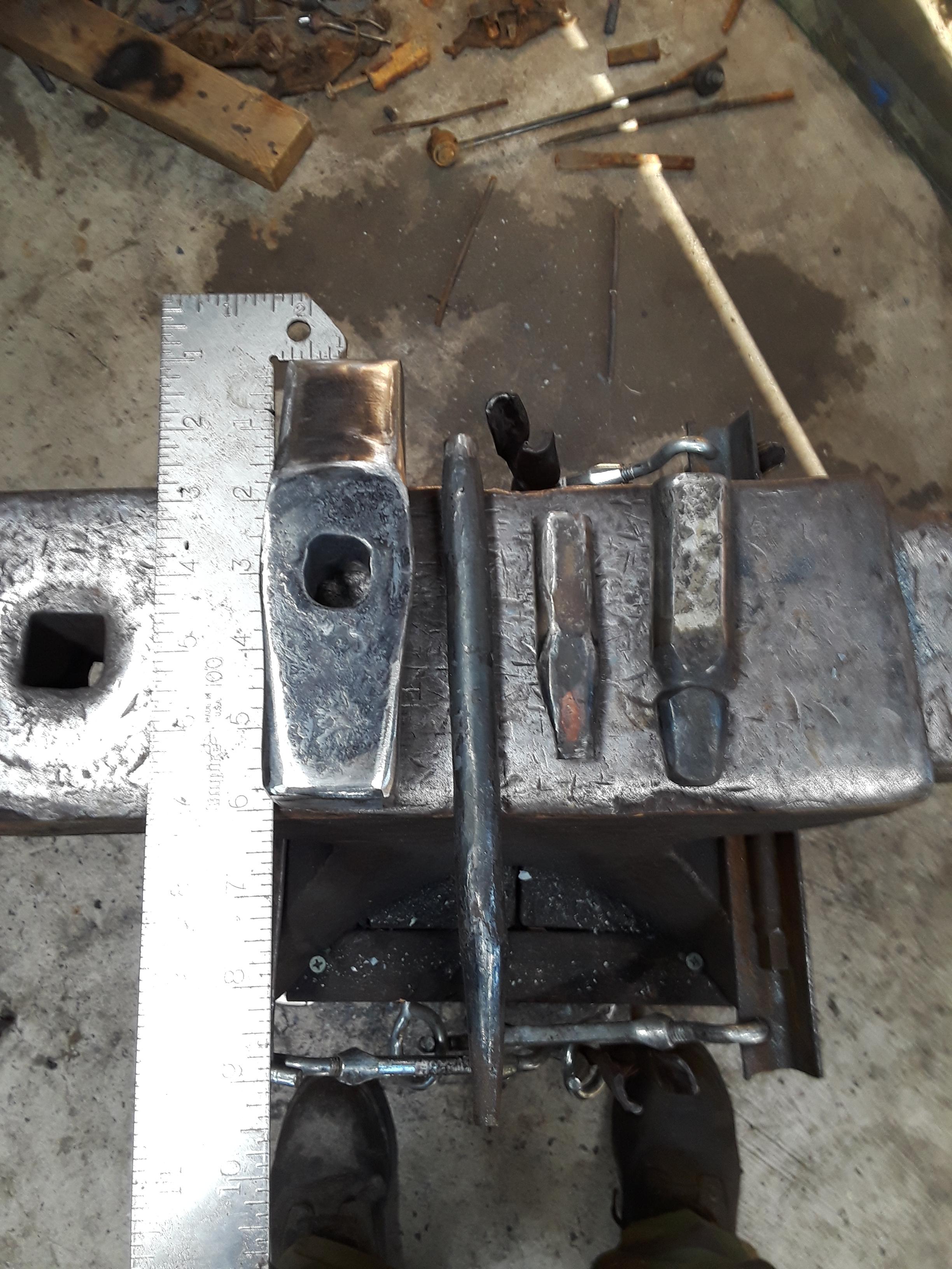

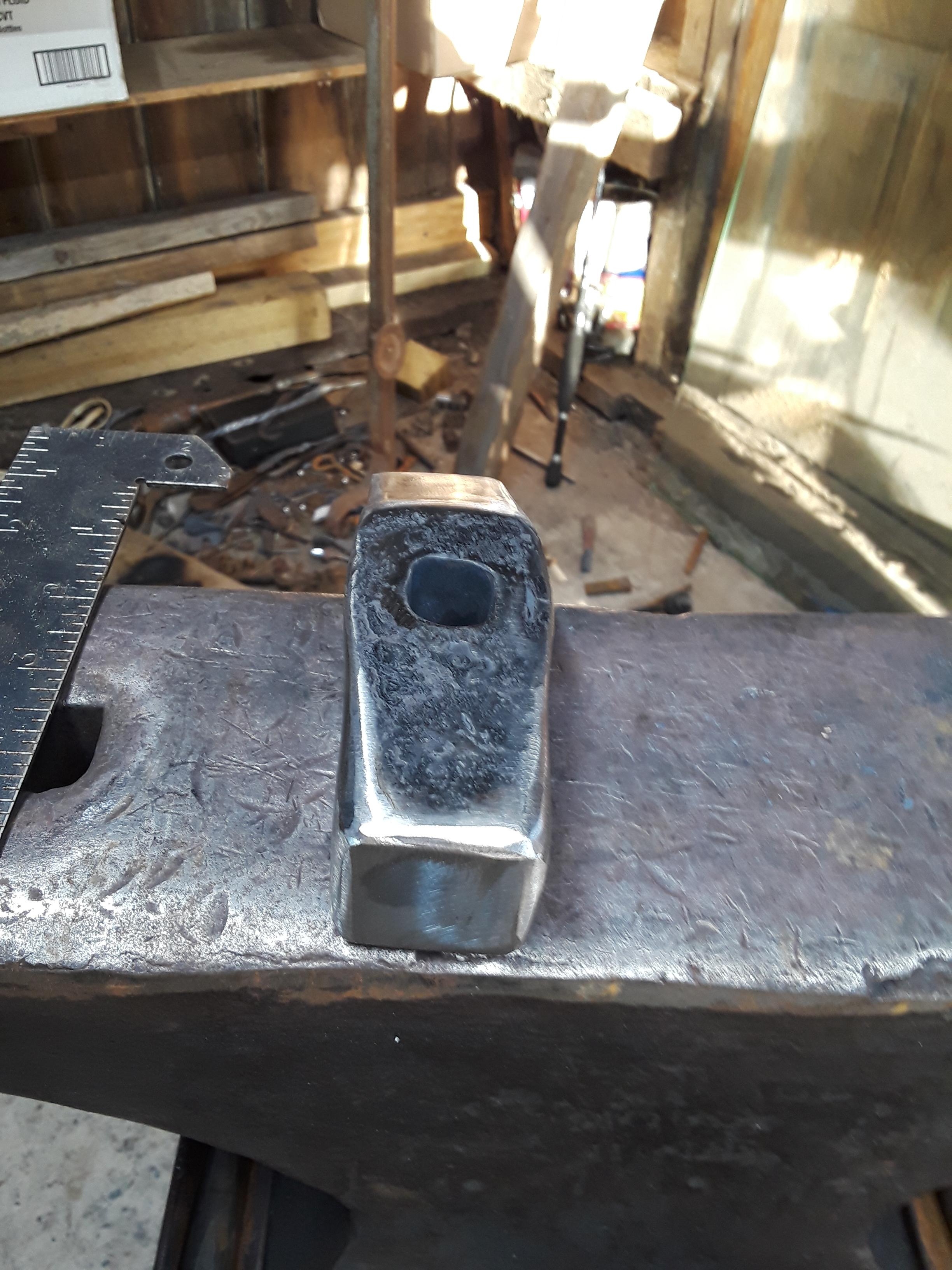

BillyBones Posted May 7, 2019 Share Posted May 7, 2019 Ted, nah just into the weeds behind the shop. So i made my first hammer today. Started with a block of 4140, 1 1/2 x 1 1/2 x 6. Of course i had no drifts for such a critter so them had to be made also. One is the pin from a Jeep rear end, well a piece of it. The rear end blew up and i rebuilt it about 2 months ago. One is a 1" ball punch from harbor freight that came in a set, quite good steel i was not expecting. then a piece of spring steel at 5/8 round. I first cut off a piece to make the peen end, then drilled a 1/2" hole in the middle. I would have had it crooked as all get out it i just tried to punch. Got him good and hot and drifted the holes. So here it is, the punches are ordered spring steel, diff pin, ball punch. The ball punch made the hole hourglass shaped for me. Ran out of time to finish dressing. But over all including making the punches, 5 hours. A little more clean up then to heat treat. Any suggestions on heat treating 4140? Oh i almost forgot as it sits 3# on the nose. So after dressing just a touch under. Quote Link to comment Share on other sites More sharing options...
