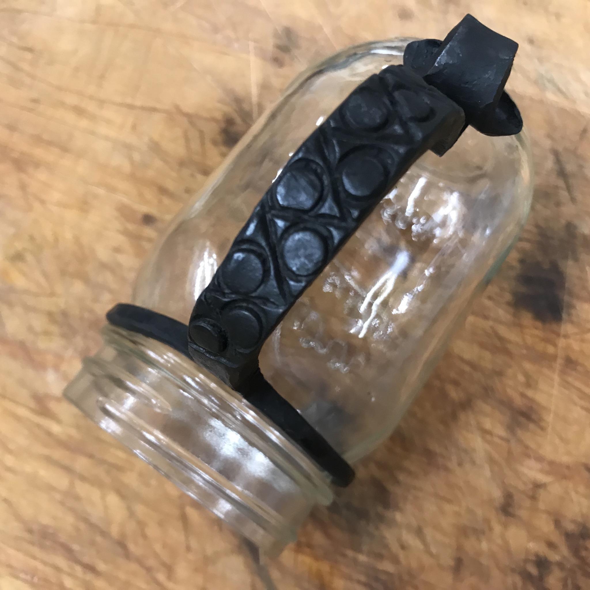

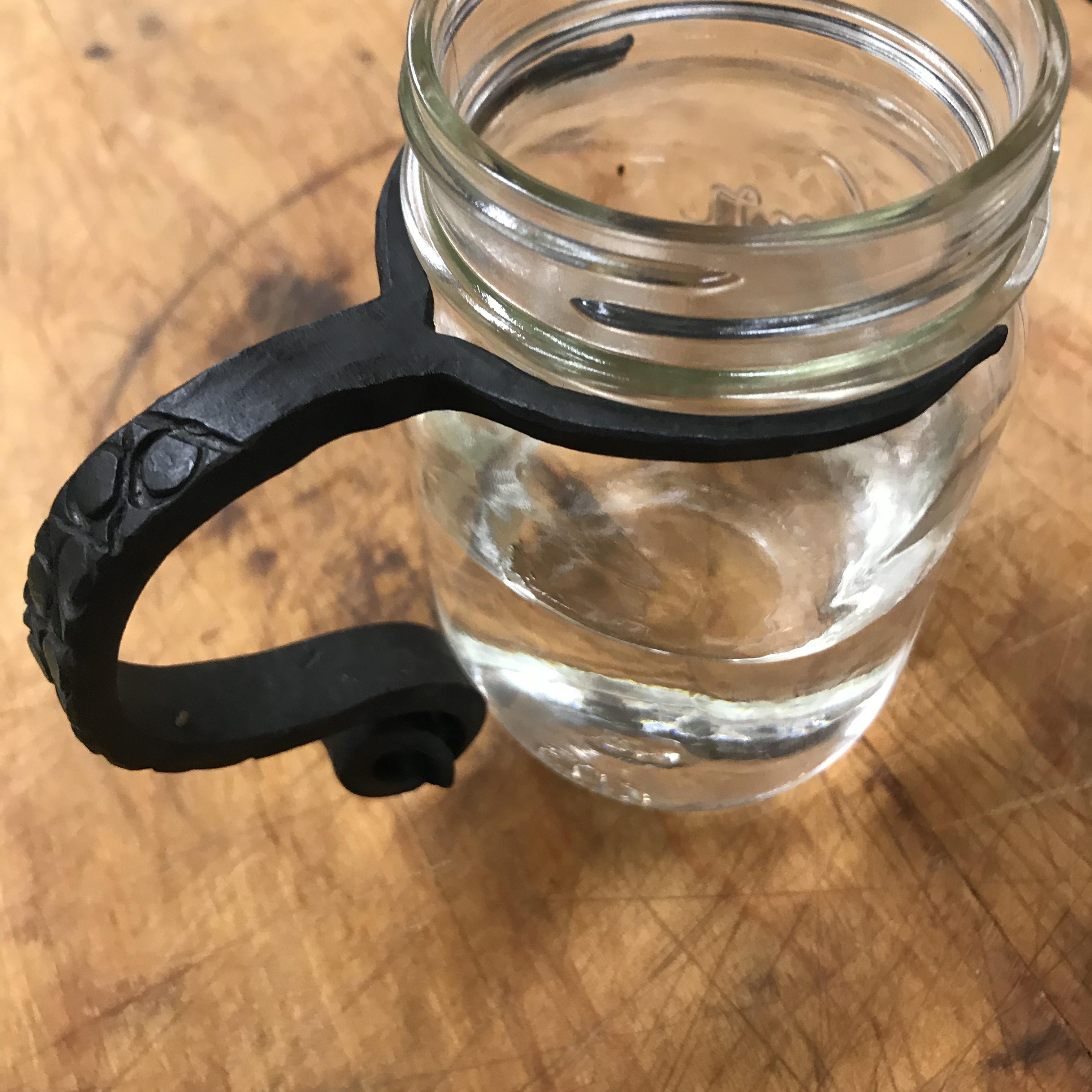

10 hours ago, Laynne said:
JHCC, more pics of the Mason jar handle please. I've not seen those.

Jhcc,
That's so cool. I might have to give that a try. Folk round here would love that.

JHCC, thanks for the additional pictures. That's what I envisioned, also did a web search and looked at the images. Thanks again.

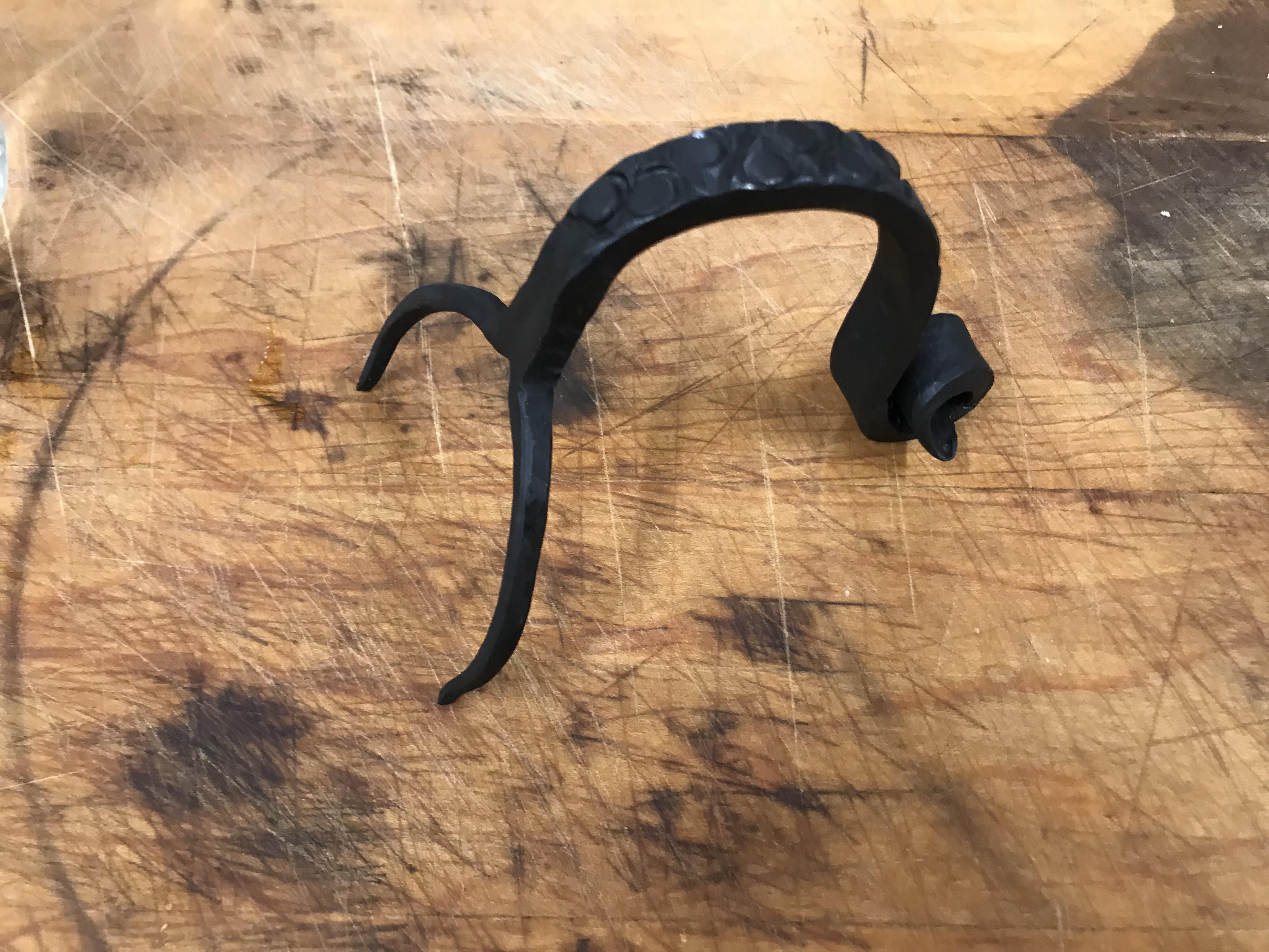

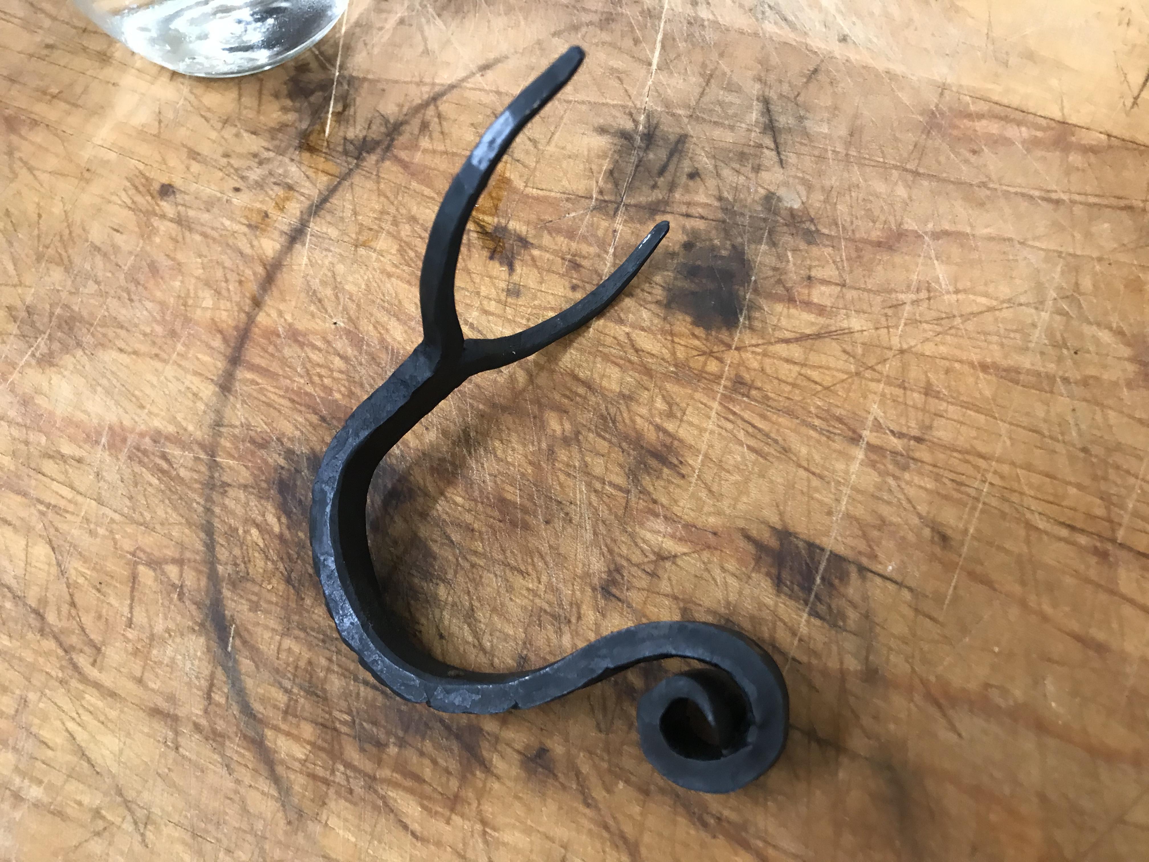

Made my first real hook and then tried my hand at a couple of horseshoe hoof picks. Built a spring fuller to isolate the end for drawing out. Need to work on symmetry when drawing out but it’s coming.

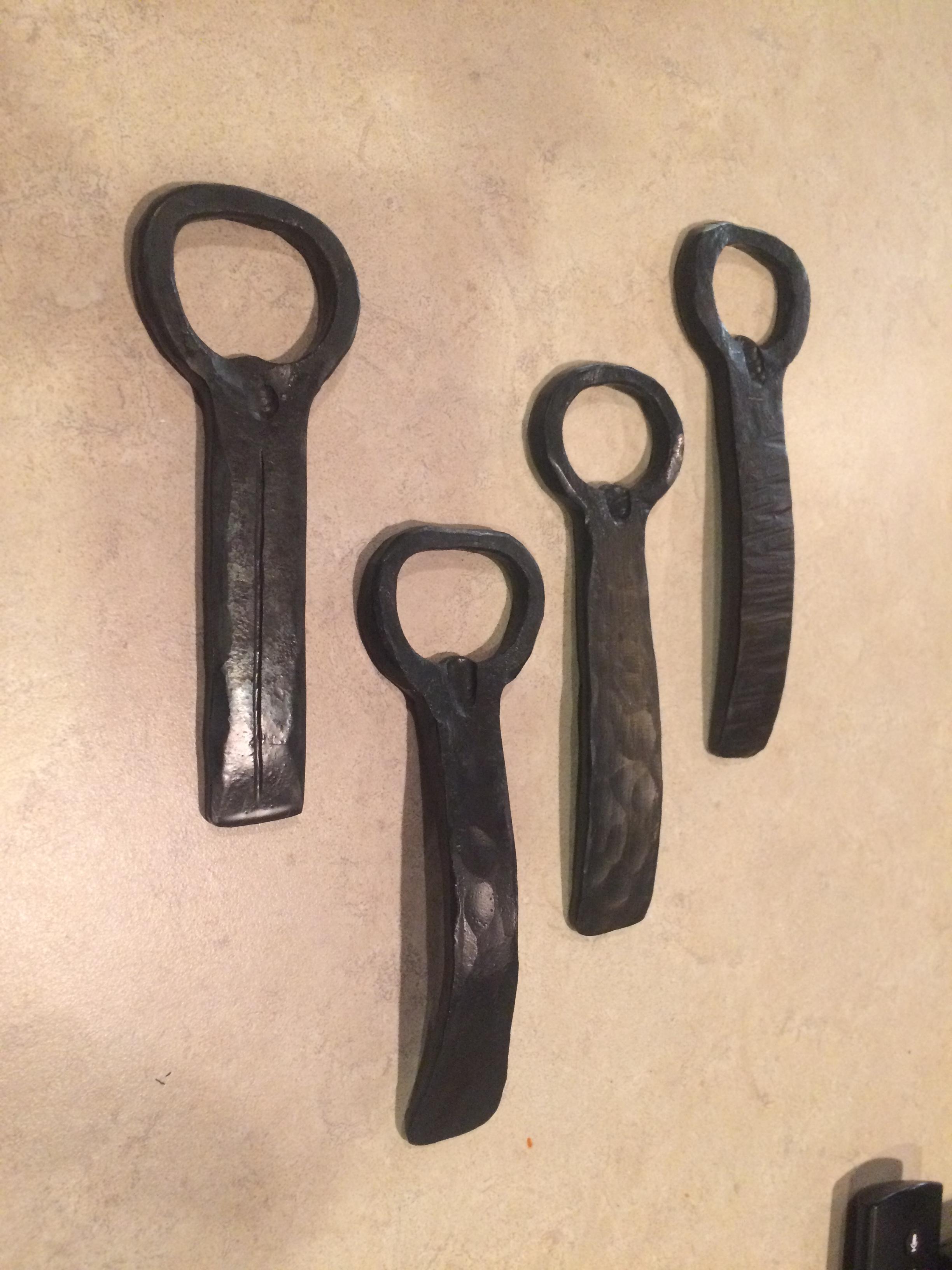

I finally had a few minutes to fire the forge up today. I’m ashamed to admit it’s the first time in probably 3 months or more, just been too busy with other stuff. After my second failed attempt at forge welding I decided to switch gears and make a second go at some bottle openers. Making some progress, but need a little more refining.
Progress, not perfection. I had an almost thirty YEAR drought once, so three months is no big deal.

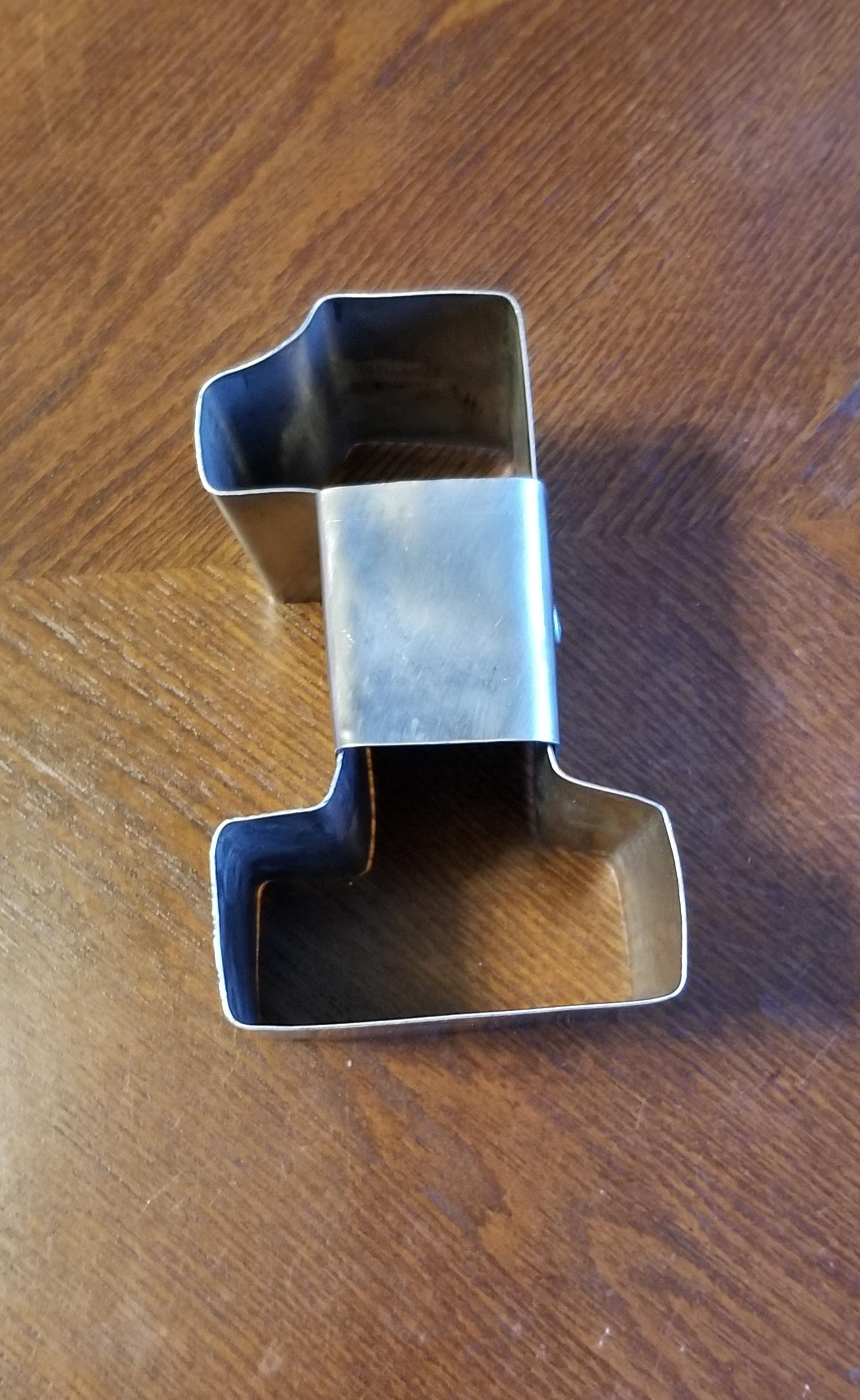

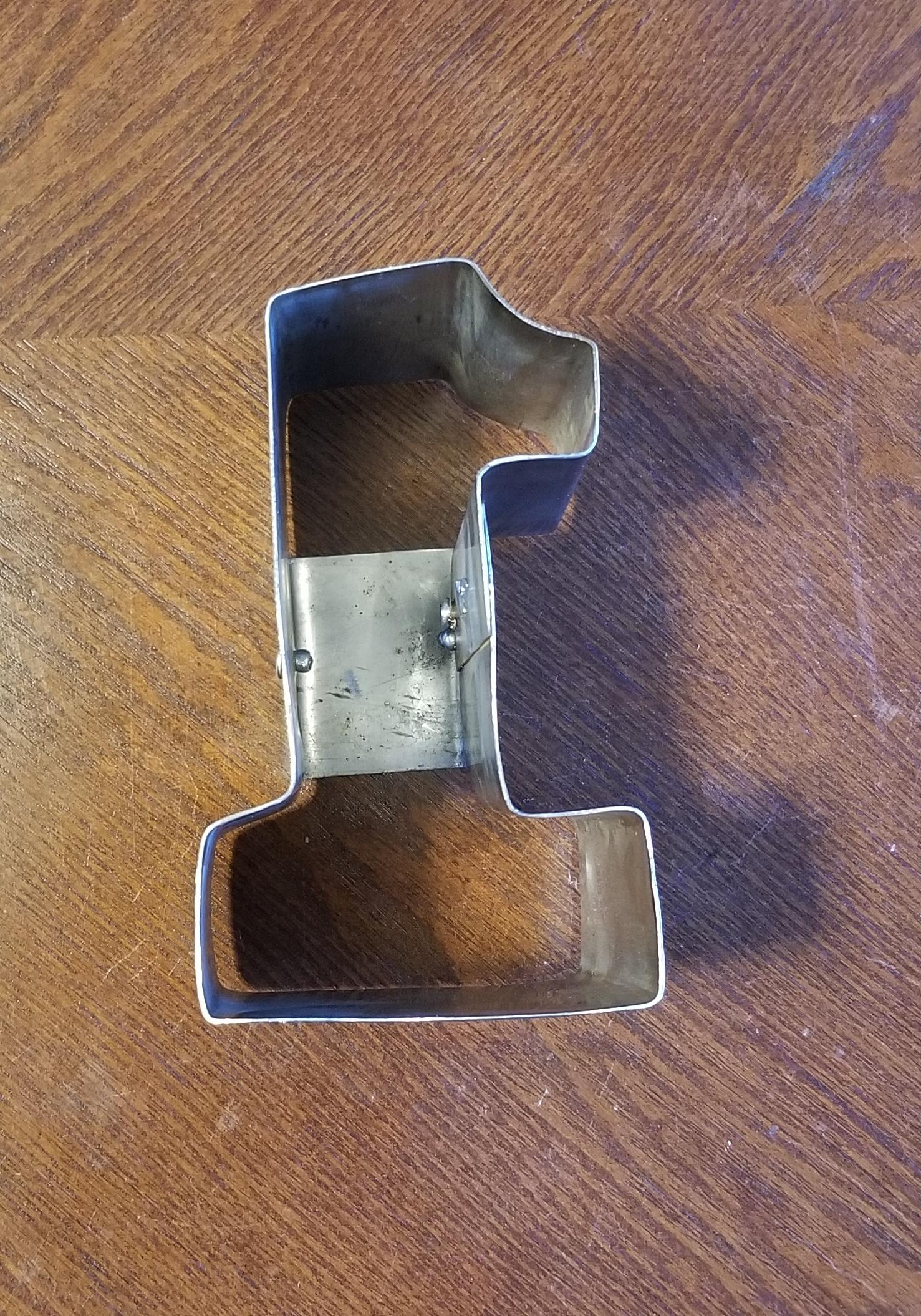

Something a bit different. Made a "1" ricecrispie treat cutter for Elizabeth to make favours for my daughters party this weekend. Also my first cookie cutter. Made in stainless steel. Certainly learned some things. A little more cleanup and its ready for trial.

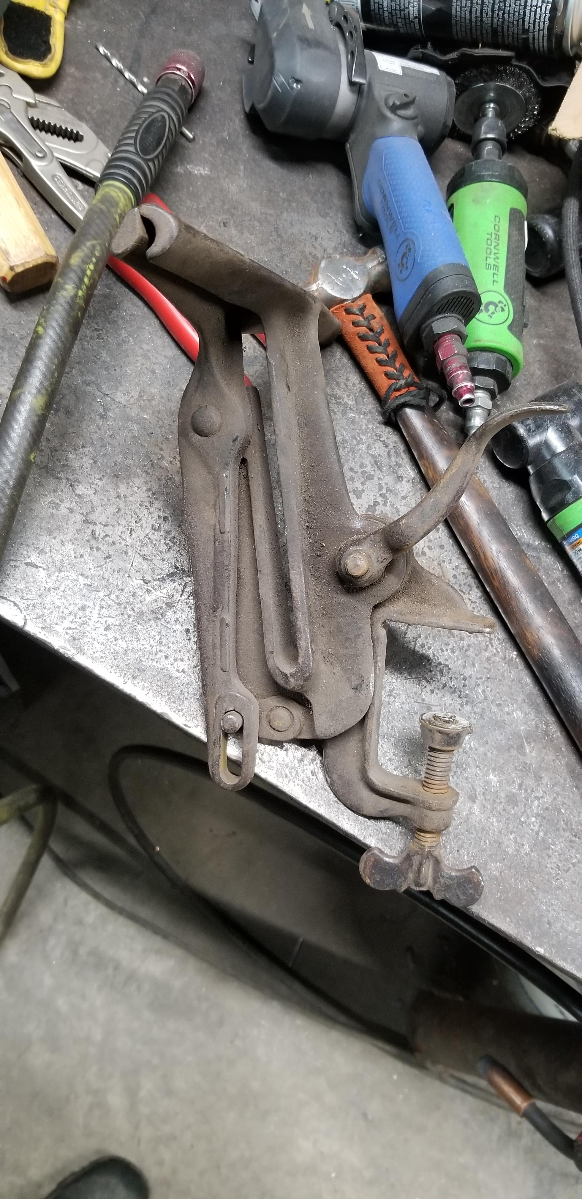

Took forever to find my old saw blade sharpening vise that I knew I had to do the main bending. Lol, it was right in front of me a few times looking. Time to get this place organized tor the thousanth time.
Nice work.  It's great you have a saw sharpeners vise to even pull out to use.  Most don't have a clue what this tools is even used for.
How do you like the portable belt grinder?
It's a cool vise, and it worked out bending this stainless sheet around.  I absolutely love the little belt grinder. I got one for work to grind welds, and liked it so much that I just had to get one for home as well.

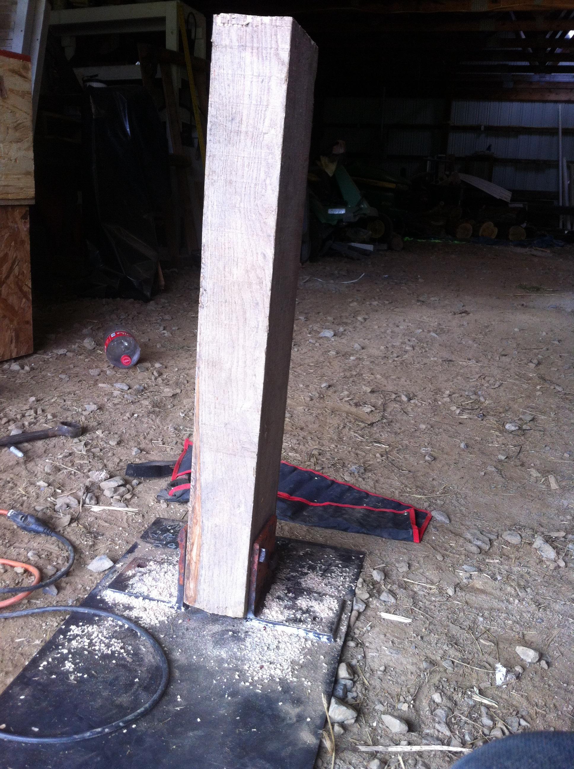

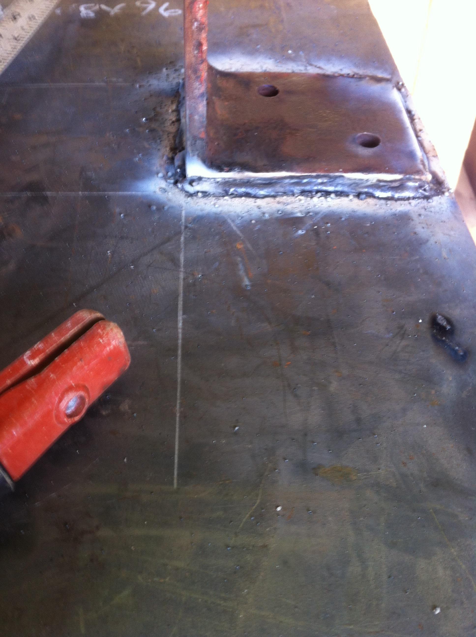

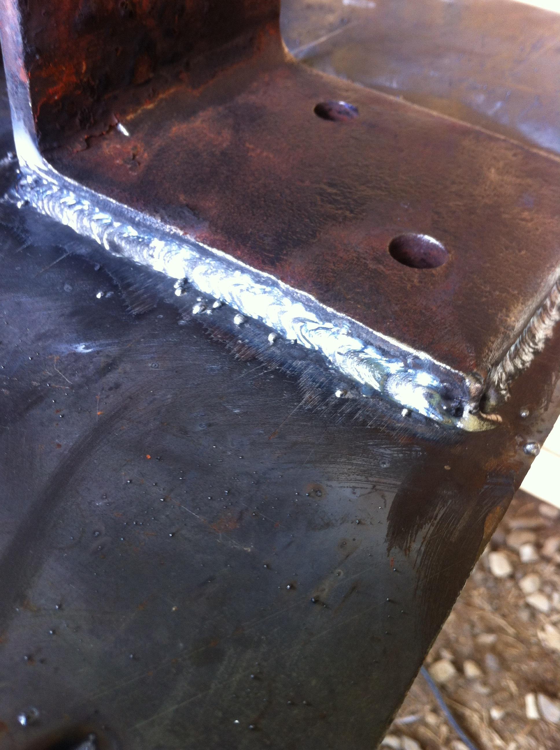

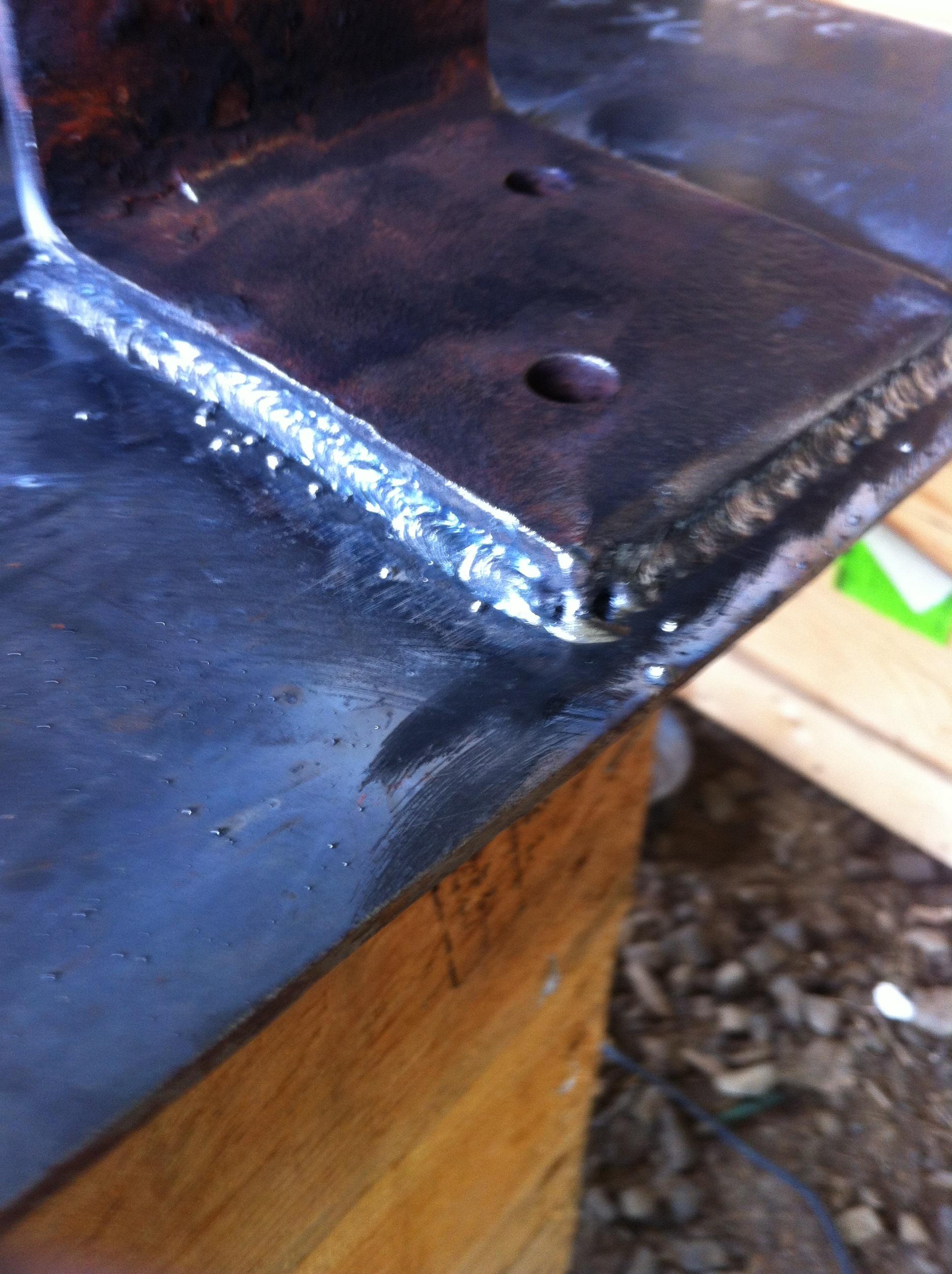

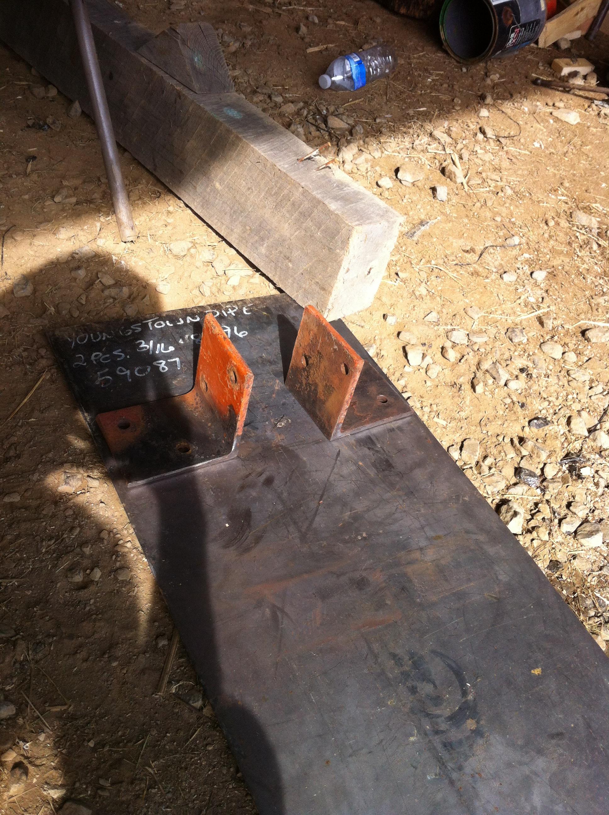

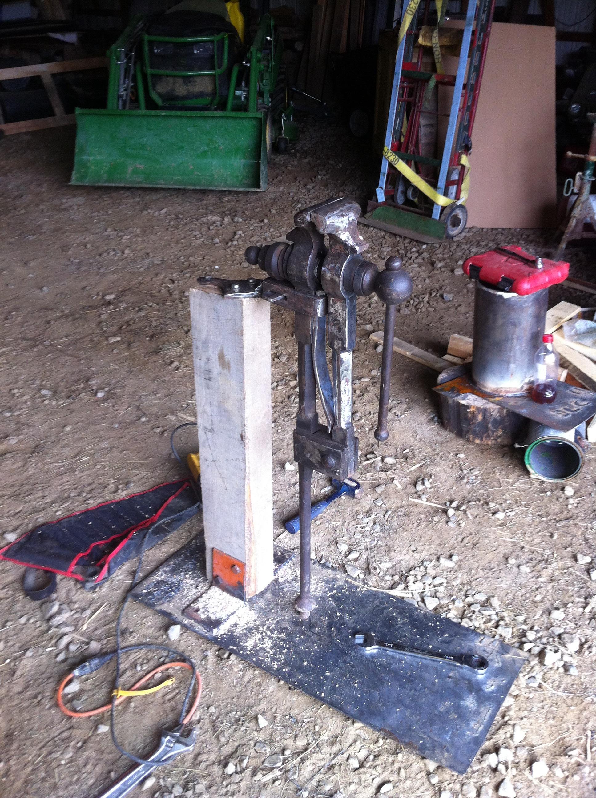

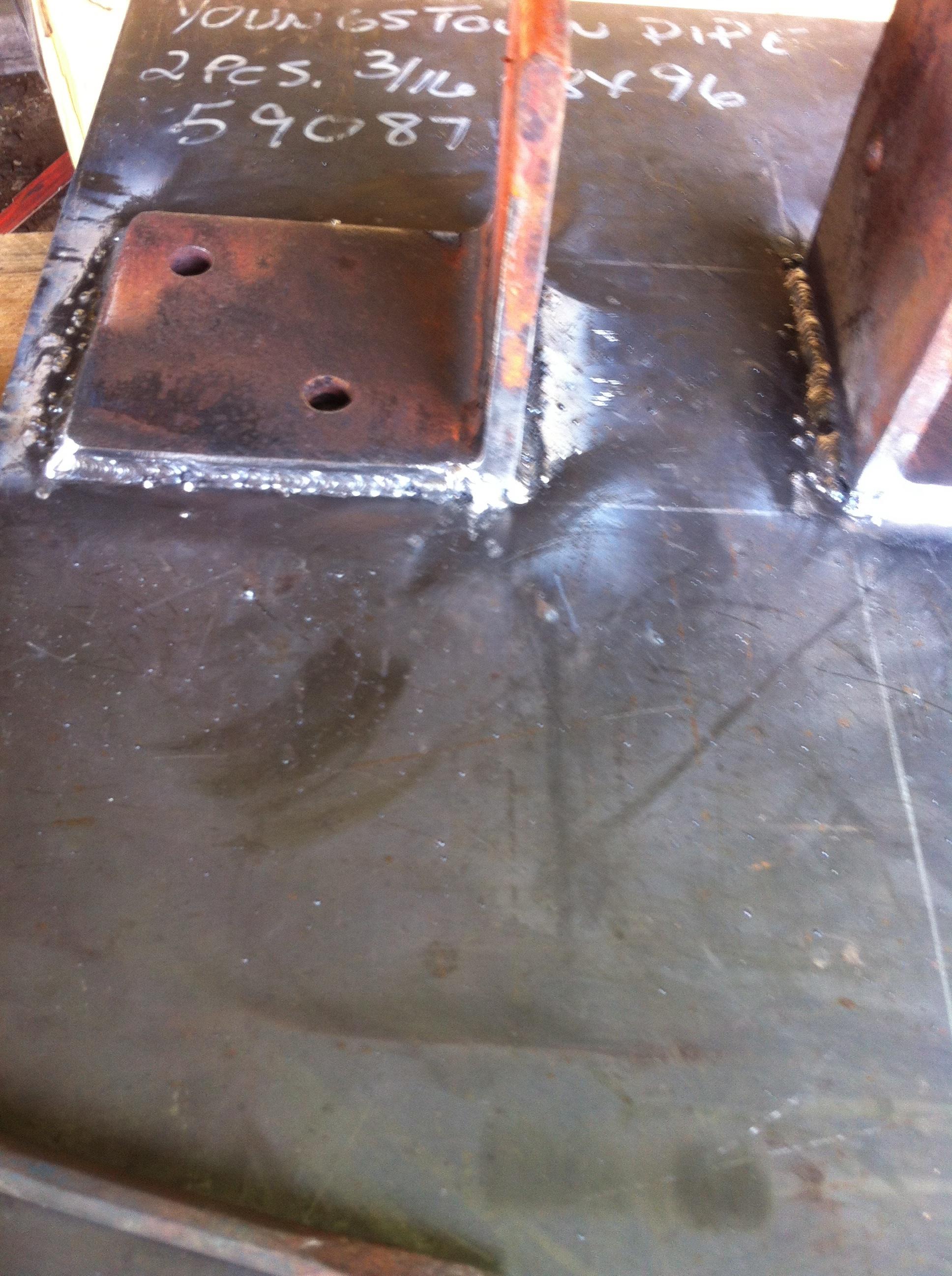

In the process of making the stand for my leg vise finally. I've got these two big brackets I'm welding to some 3/16" steel and I'm gonna bolt the beam to them. Thinking about using something to run from the beam to the brackets to tighten them up for extra security. I can never remember what they are called. The things that you turn the middle piece to tighten the screws on either end.
That's it
Idk why I can never remember what they are called. Just ran some nice beads on this with the stick welder if I do say so my self.
They look like they will hold up. :) interested to see the finished stand. Are you going to weld on something to set the bottom of the leg into?
And I'm gonna set the leg in something. Not sure what yet. Looking for stuff with the right size hole already in it.
Now I've gotta cut my piece of wood to the right length and I'm almost finished.
When I made my stand, I didn't have the right piece of pipe to fit the end in. However, I realized that it was the flat plate the bottom of the foot was resting on that was absorbing the force of the blows; the pipe was just to keep it from sliding around. I therefore welded three little blocks around where the foot rests, which do a perfectly fine job. I've since acquired the right piece of pipe, but it hasn't been worth the bother to make the change.
For my travel vise I once used  a hand tamper without the handle for the acorn to fit into.  Then just held that in place with some tent stakes.
Alright. Other than securing the bottom of the leg I finished it. I think I might go back here in a bit but I've been at it since like 9. Should I leave the base as is or should I take a little length off. I think it's good since I can stand on it though.
Leave it long so you can stand on it while working. It'll be more stable.
Definitely leave it long, it's kind of narrow so you'll need all the stability you can get. Just wrap a piece of rod around the pin on the end of the leg and weld it(the RING!) to the plate. The vise can hold it in place while you tack it. Just be careful NOT to weld the vise to the stand too. hmmmm? ;)
