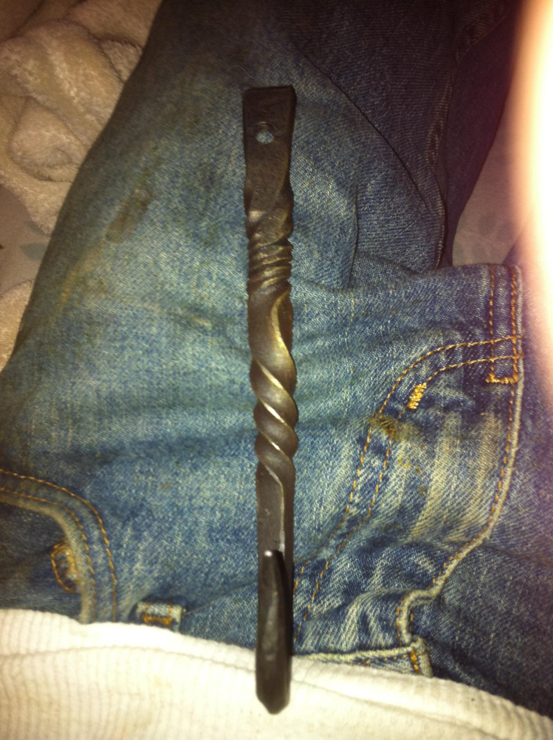

Pr3ssure Posted May 20, 2019 Share Posted May 20, 2019 24 minutes ago, Cannon Cocker said: How are you planning on attaching that hook to the wall? Via the hole I drilled. I'm not that great at this style yet, I prefer making them with the build in nail. Although it's the best I've done like this. Quote Link to comment Share on other sites More sharing options...
Daswulf Posted May 21, 2019 Share Posted May 21, 2019 Time to practice hot punching holes. Don't forget to make a counter sink punch. Quote Link to comment Share on other sites More sharing options...
Frosty Posted May 21, 2019 Share Posted May 21, 2019 4 hours ago, Pr3ssure said: I'm not that great at this style yet, You're getting there, it's a decent looking hook, nice finish. It's harder to get twists concentric than it looks. Use the counter punch first then punch the hole, it's much easier order to get right. Your hook could use a finial on the end of the hook to prevent it poking holes in clothes. Something wide enough it isn't pokey. It can be any number of attractive finial treatments: scroll, (of course) a ball, fish tale, etc. Frosty The Lucky. Quote Link to comment Share on other sites More sharing options...
Pr3ssure Posted May 21, 2019 Share Posted May 21, 2019 Yeah, I need scroll tongs or to make some scroll pliers. I got it over a little on the anvil but it just wasn't wanting to curl for me. I need to make some good tongs for small stuff like that, the v bits I have are old and need a new rivet. They hold half inch or bigger stock. Quote Link to comment Share on other sites More sharing options...
Glenn Posted May 21, 2019 Share Posted May 21, 2019 Learn to make pig tails and scrolls on the anvil with a hammer. Practice is the key to getting it right. Remove the rivet from your V bit tongs and replace it with a new rivet. It should be a simple fix. Quote Link to comment Share on other sites More sharing options...
pnut Posted May 21, 2019 Share Posted May 21, 2019 8 hours ago, Frosty said: Use the counter punch first then punch the hole, it's much easier order to get right. Thanks Frosty I was going to ask about the order. Punch or countersink first. Pnut (Mike) Quote Link to comment Share on other sites More sharing options...
Cannon Cocker Posted May 21, 2019 Share Posted May 21, 2019 Sorry if my question seemed rude. It looked to me like a round taper at the top in your first picture. A uniform twist on a taper is a hard thing to do. Keep working on it and you'll be knocking out cool hooks in no time! Quote Link to comment Share on other sites More sharing options...
Frosty Posted May 21, 2019 Share Posted May 21, 2019 Finial scrolls are NOT the place for scroll tongs, you're just turning 1/4"-1/2" and rolling it tight. That's over the edge to start and finish on the face, takes seconds. Twisting a taper isn't easy to get right. Practice practice practice. Frosty The Lucky. Quote Link to comment Share on other sites More sharing options...

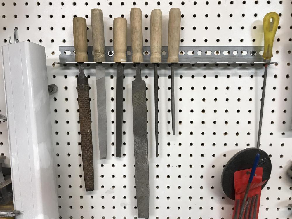

Chris J Dixon Posted May 22, 2019 Share Posted May 22, 2019 Formed some handles for my files and got them hung up, finally. Fitted my bed rail tongs to a piece of 5/8” rebar and beat out a heavy hook. Forming around the horn is getting better every time. Quote Link to comment Share on other sites More sharing options...
swedefiddle Posted May 22, 2019 Share Posted May 22, 2019 Good Morning Chris, Next time when you turn some handles, cut some 3/8" pieces of 3/4 copper tubing for ferrules at the file end of the handles. It stops the wood from splitting, as well as can be buffed. Neil Quote Link to comment Share on other sites More sharing options...
Chris J Dixon Posted May 22, 2019 Share Posted May 22, 2019 Will definitely do that when these eventually break. They are just a broken broom handle shaped with a rasp and sandpaper on the drill press. Thanks for the tip! Quote Link to comment Share on other sites More sharing options...
SLAG Posted May 22, 2019 Share Posted May 22, 2019 Mr. S. Fiddle, (a.k.a. Neil), Your copper ferrule idea is an excellent one A slight variation on that theme is to purchase plumber, copper end caps for pipes. I drill a proper sized hole, through the end cap to accommodate the tang of the respective file. They are not expensive. Certainly cheaper than the ferrules that specialty wood stores sell. (which are not really that expensive). But the end caps are thicker and more robust. Cheers everyone, Bedtime for the, SLAG. Quote Link to comment Share on other sites More sharing options...

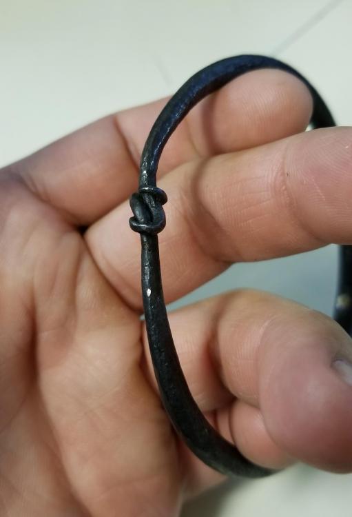

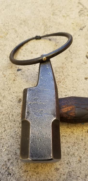

Mudman Posted May 22, 2019 Share Posted May 22, 2019 Made my first bangle(?) Up until a week ago, I had no idea what one was. Quote Link to comment Share on other sites More sharing options...
Frosty Posted May 22, 2019 Share Posted May 22, 2019 25 minutes ago, Mudman said: Made my first bangle(?) Not bad at all. Both tapers look pretty even and fairly matched, well done. Next time you take pics of a product like this how about turning it around so we can get a look at the knot? Frosty The Lucky. Quote Link to comment Share on other sites More sharing options...
Mudman Posted May 22, 2019 Share Posted May 22, 2019 Thanks Frosty. I had a heck of a time working on that wrapped area, in fact, I spent more time on that, than I did the entire thing. Quote Link to comment Share on other sites More sharing options...
Rojo Pedro Posted May 22, 2019 Share Posted May 22, 2019 Super cool Mudman! Is that a brass rivet? Quote Link to comment Share on other sites More sharing options...
Steven NY Posted May 22, 2019 Share Posted May 22, 2019 Mudman, Love the knot detail very nice, I may have to steal that one! W Quote Link to comment Share on other sites More sharing options...
