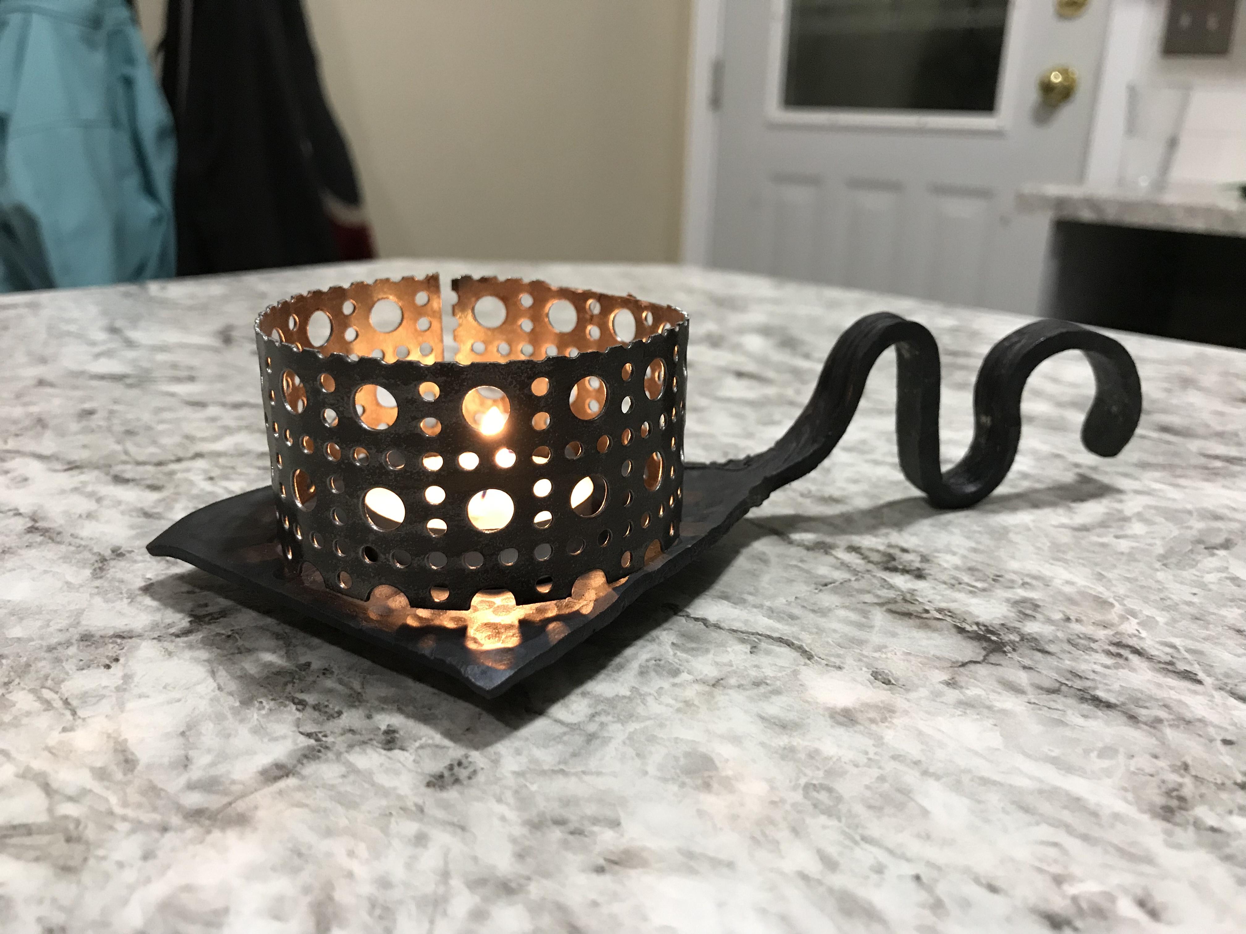

  22. Didn’t get much shop time today. Finished the bedrail tongs, fitted to a railroad spike, and added a little something to the candle holder.
