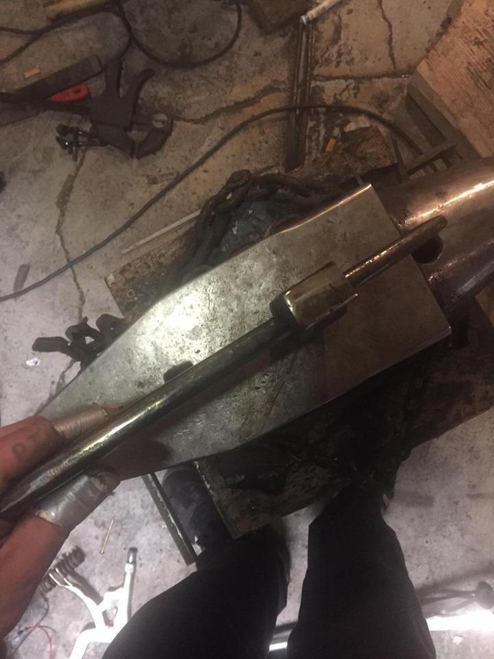

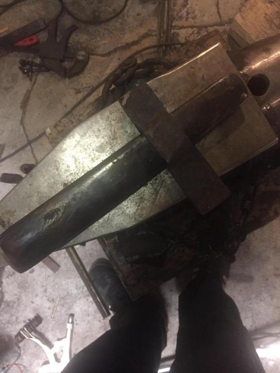

CheechWizard Posted April 26, 2020 Share Posted April 26, 2020 this is how far i managed to drift it before i made a janky drill bit from a flat head screw driver and further burrow and burn my way deeper into the stump beneath my drifting plate. just normalized the drift and gave it a fair amount of abuse with my 5 pound fyatte r plumb big boy hammer. no bending as far as i can tell. and aside from my own poor alignment i feel i like an ok job was achieved. however my judgement is based on my whimsically ignorant biased opinion. what do YOU guys think. am i disillusioned into believing my work is better then it is?? or have i maded a lengthy bit of hard steel to widen tight slits for months to come? Quote Link to comment Share on other sites More sharing options...

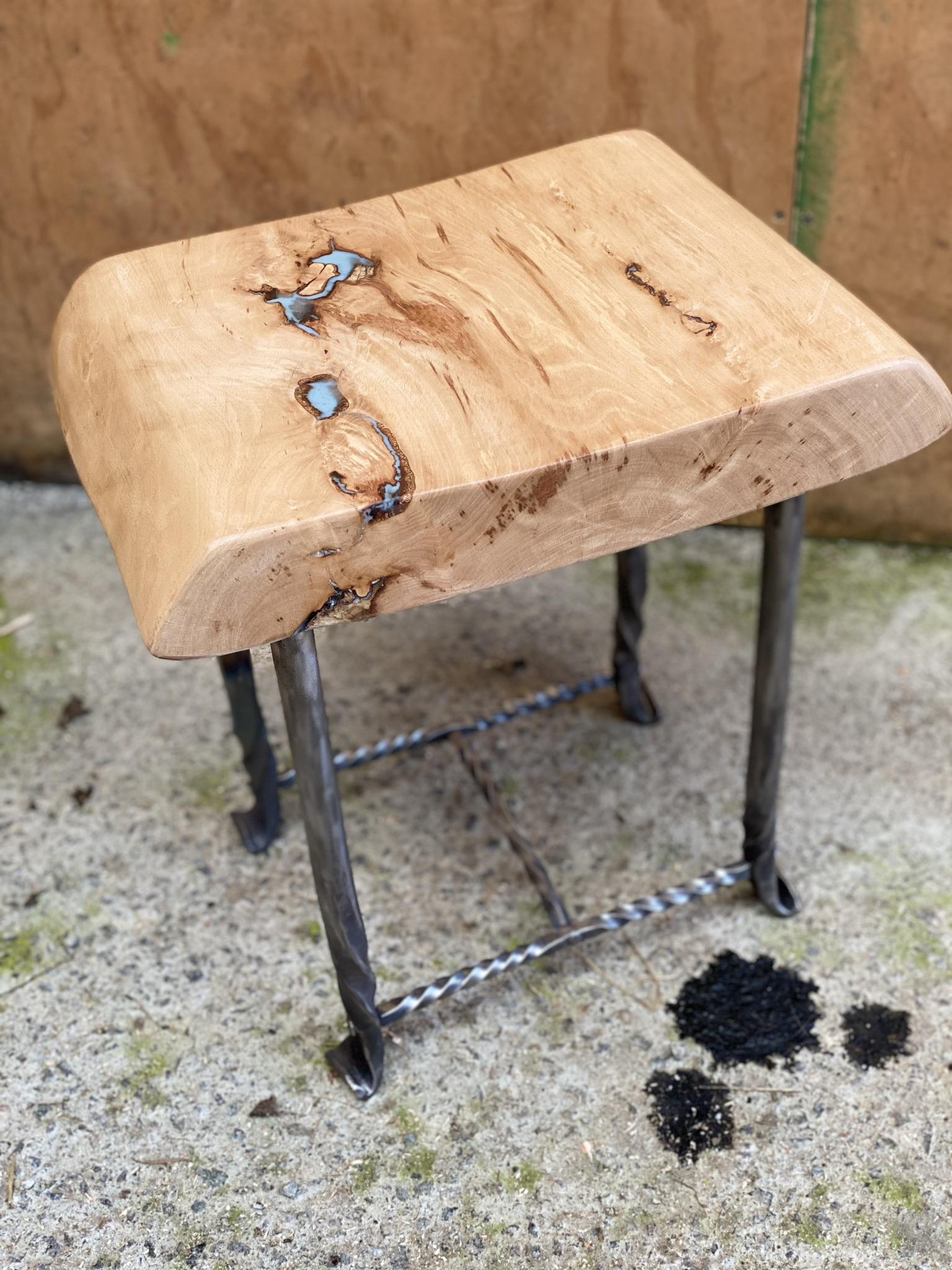

MacLeod Posted April 26, 2020 Share Posted April 26, 2020 Hallo everyone, hope you and all your own are well and safe and sound. I made this today, a slab of ash rescued from the firewood pile at the sawmill last year made a nice looking top which I did my best to keep off the ground with my limited hammering skills. Learnt a lot through making mistakes as usual. Quote Link to comment Share on other sites More sharing options...

BillyBones Posted April 26, 2020 Share Posted April 26, 2020 MacLeod, can we get a pic of how the legs are attached to the underside of the wood? Quote Link to comment Share on other sites More sharing options...
MacLeod Posted April 26, 2020 Share Posted April 26, 2020 6 minutes ago, BillyBones said: MacLeod, can we get a pic of how the legs are attached to the underside of the wood? Sure Billy, There’s no fancy joinery there though. To be honest that was the most stressful part for me, sharpie mark on a flat bit then measured 10 times and drilled socket holes Quote Link to comment Share on other sites More sharing options...

BillyBones Posted April 26, 2020 Share Posted April 26, 2020 4 hours ago, MacLeod said: no fancy joinery there Thanks. I have been working on table legs as of late, the ones i am doing need to be attached with screws or bolts though. Just looking for other ideas than what i am doing. Quote Link to comment Share on other sites More sharing options...
