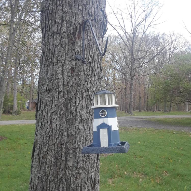

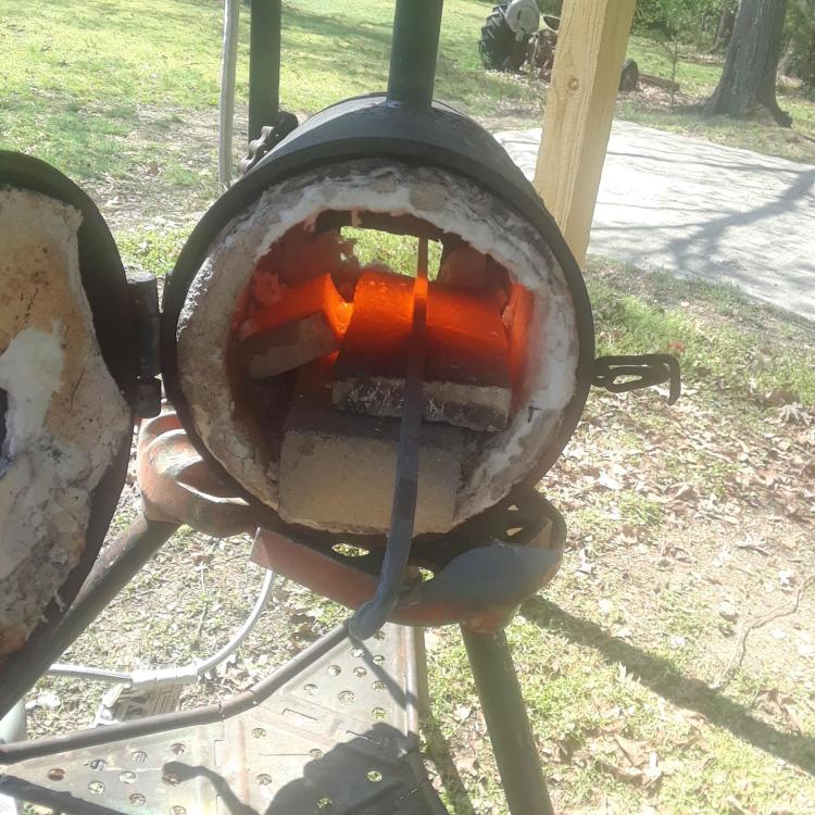

Forgingforfun Posted April 12, 2020 Share Posted April 12, 2020 Forged railroad lantern hanger several weeks ago, forged the light house bird feeder hanger for the mrs today, she let me forge on Easter... question...I could only heat and bend the bird feeder once so I couldn't really transition the curve to a gentle radius. Due to size of forge, how could of I done so. Ps Happy Easter to all , and let's pray for this country. Quote Link to comment Share on other sites More sharing options...

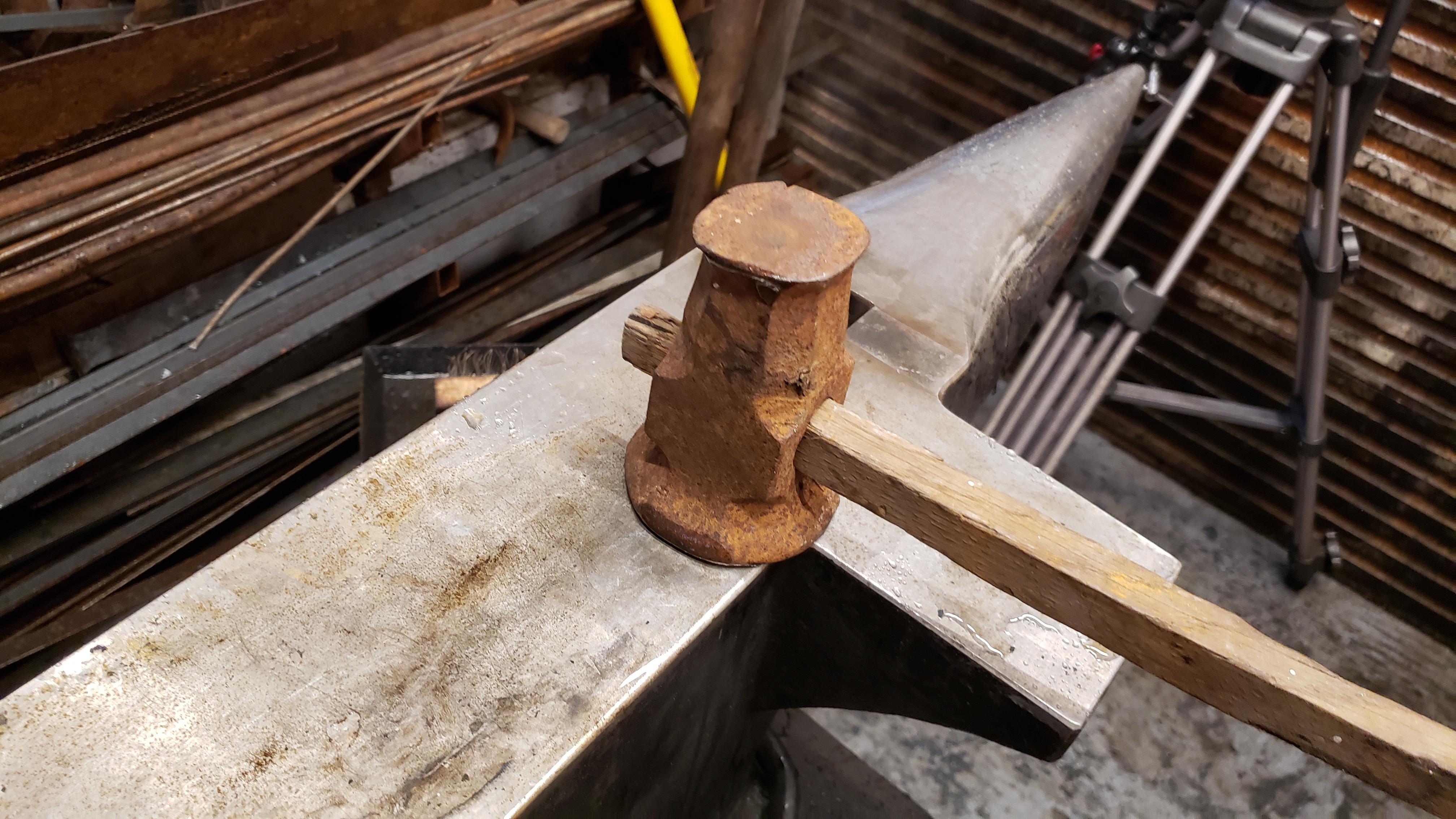

jlpservicesinc Posted April 13, 2020 Share Posted April 13, 2020 LBS.. I will show you, your lil'ones great, great granpappy tomorrow.. I just called it a round flatter, but hey Elephant is cute too. Works great when i want a really light foot print on the stock. Quote Link to comment Share on other sites More sharing options...
Glenn Posted April 13, 2020 Share Posted April 13, 2020 2 hours ago, bill duckworth said: I could only heat and bend the bird feeder once so I couldn't really transition the curve to a gentle radius. Due to size of forge, how could of I done so. You can bend 3/8 round cold, and 1/2 in round cold with leverage. If you want to do it hot, you can slide the stock in and out of the forge to extend the hot spot to a much longer section. Quote Link to comment Share on other sites More sharing options...
ThomasPowers Posted April 13, 2020 Share Posted April 13, 2020 With the bends already in place: close up the back door and stick a couple of firebricks with a slight gap between them and the front opening. Let it warm up and then put your metal sideways in the hot spot between the bricks and the front opening. Lets see: Friday went to the scrapyard, they are talking about shutting down so I need to "fill up" beforehand. 53 pounds out + a 1.3 hp motor---almost brand new from the college building renovation scrap getting dumped there. (Tip: some of the oldest looking HVAC stuff has the newest motors in them as they have been replaced on schedule.) US$10 for the motor, 20 cents a pound for the rest. Helping a small family business; priceless! Fired up the forge Friday afternoon and worked on the tentacular bud vase holder and did some more stakes to hold the bottom of the new fence down while the forge was warming up---using *rebar* I sourced as scrap earlier that day. Saturday: finished off the bud vase: couldn't find my drill so I used the hand powered one to drill and also a pointed punch to start the holes hot. Also I wasn't happy with the riveting to the mounting plate so I forge brazed the backside of the tentacles. Wire brushed and waxed. Decided to use the spare tentacles to make a wall mount drinking horn holder and started making the mounting plate using the screwpress. Took pictures of my 25# LG for the folks at LG. (serial 1814, sold 1915 and sent to Merino CO, USA.) Sunday; read 3 apostles' accounts of the resurrection at breakfast and went out to the shop; 20 mph winds so a good day to run the propane forge, 3 doors open + the open gables. Worked on the drinking horn holder some and then decided to make a flower for my wife as a surprise. I also dressed a hardy's stem to fit the 248# PW anvil using a farrier's rasp. I sure hope I get power to this shop in the "near future". Watched the League of Extraordinary Gentlemen, again, with my wife. Checked the weather before going to bed. Out the back door, low hanging thick clouds, murky. Out the front door, absolutely clear skies and tons of starts---seeing the Milky Way with no problem---It's our galaxy, so it's good to keep an eye on it from time to time... Quote Link to comment Share on other sites More sharing options...

jlpservicesinc Posted April 13, 2020 Share Posted April 13, 2020 Ok, so as promised Littleblacksmith, here is the "Elephant flatter).. I just used to call it a round flatter but hey.. I like elephant better. Quote Link to comment Share on other sites More sharing options...
