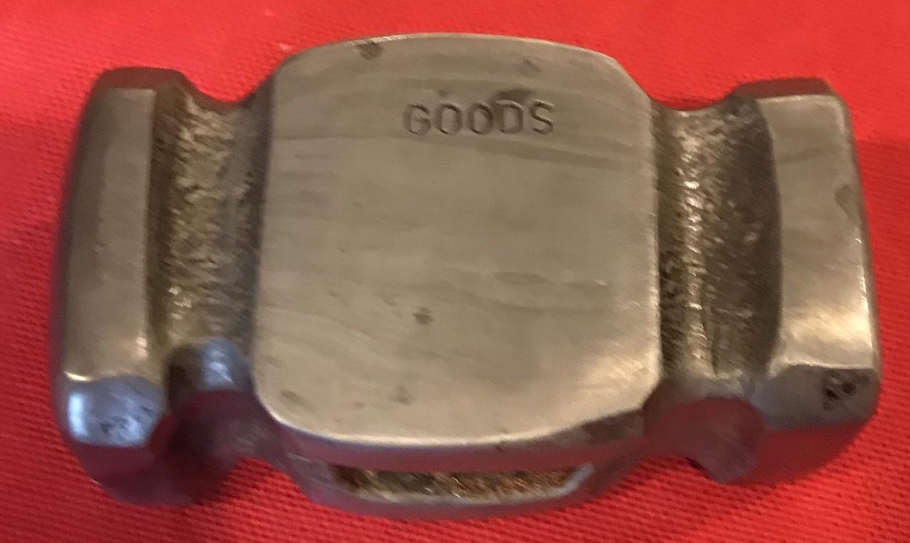

Goods Posted May 1, 2020 Share Posted May 1, 2020 Well, finished up my wrought iron hammer. Not happy with it at all. It’s a little bit wonky. Actually broke my spring fuller working on it. (I keep thinking about making a butch tool, know may be the time.) The eye came out crooked. Those problems I can live with. I’ve made several handles to match crooked hammer eyes, and wonky is not an issue, it was just going to be a working tool for myself. Here’s the real problem: You can see the spring steel only goes 2/3 of the way across the face. Guess I burnt some of it off... So what do you all think I should do with it? Should I try to weld another face, grind the rest of it off and use it as a soft hammer on one end with a rounding hammer on the other, or just leave it as is for a reminder to pay attention? Humbly, David Quote Link to comment Share on other sites More sharing options...
jlpservicesinc Posted May 1, 2020 Share Posted May 1, 2020 David, nice go.. Overall I give you a 10.. You kept it all together.. Personally I'm not a fan of the rectangle punch/slitter. but thats just me.. I've got nothing on the face problem.. In the old days wrought iron hammers for the most part were just hunks of square stock.. the Germans did it up right.. Well, Germans and French and Swedes as the faces when worn and cracked could be just welded back on. The modern design concepts makes putting a face back on once forged a problem as the mass behind the face is not that much so there is no good way to weld it back on without completely destroying the eye and cheeks.. If it were me.. I'd make it a wall hanger to show all my buddies so they could make fun of me.. I hang with a tough crowd. You did great.. They are fun to make but tough just the same.. Well done and welcome to the wrought iron, steeled face makers club. Quote Link to comment Share on other sites More sharing options...
Goods Posted May 1, 2020 Share Posted May 1, 2020 Well, it’s not my 1st, but it is my worst! I had planned to have had made several more in practice for our state conference, where I’m expected to do a demo, but I never seem to have enough time. Conference, planned for June 5th~7th, will most likely be delayed or cancelled anyway. Hopefully, I can get one more done before then for practice, just in case. I may make an eye punch and go that route, but I’ve had decent luck with slit and drift. Thanks, David Quote Link to comment Share on other sites More sharing options...
jlpservicesinc Posted May 1, 2020 Share Posted May 1, 2020 Just as a mention "Slit and drift" is just the technique.. You can choose what ever shape you want.. round, oval, square, recangle, 8, diamond. etc, etc. All the eye punches I have and all the descriptions of use of eye punches is strictly as a finishing tool.. Much like a drift. they were not used to punch the hole, just to finish the eye shape. The only time I slit and drift is with thin materials where I want ample cheek thickness so it can withstand being hammered on like a top tool. Handled punch and such. 99% of the time I punch round and flatten unless the cheeks need to be forged, then I still punch round on larger sections and will use a mandrel to forge against to spread the cheeks. Its just a technique like any other. Slit and drift is very popular today. Quote Link to comment Share on other sites More sharing options...
ThomasPowers Posted May 1, 2020 Share Posted May 1, 2020 Forge/grind it into a fuller or straight peen? I don't recall this being mentioned and as more folks are experimenting with WI: As wrought iron is generally produced by stacking and welded, the lower grades tend to want to split along the welds---especially Merchant Bar. Some of the old books recommend that you do any slitting&drifting or punching at 90 deg to the stack orientation to help prevent splitting along the welds. Also you can refine coarse wrought iron by stacking and welding and forging out. This was the method used to get Merchant bar from muck bar, singly refined WI from Merchant bar, Doubly refined from singly refined and triply refined from doubly refine WI. Quote Link to comment Share on other sites More sharing options...
Goods Posted May 1, 2020 Share Posted May 1, 2020 Thomas, I’ll have to think about the option of reforging it into a cross or straight peen. That may work for me. This WI was pretty course. It started out as two 15”x3/4” dam spikes. Both spikes we forged back to completely square cross section along the length, then folded and welded twice, to make two larger square cross section short bars, and final forge welded flat together and squared up again. I was aiming for a heavier hammer, but it looks like I lost a lot of mass to scale. Do you think this welding has refined it enough? It seems pretty solid. Thanks, David Quote Link to comment Share on other sites More sharing options...

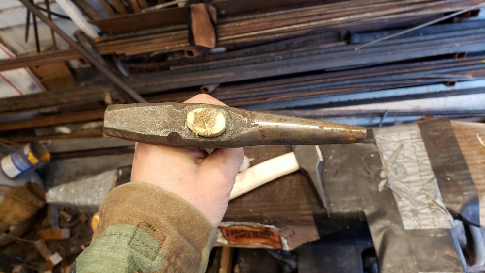

CheechWizard Posted May 1, 2020 Share Posted May 1, 2020 i was in a rush prepping to put in a bit on the hawk im making and made a shallow cut and didnt taper the bit enough. i think another forge heat should fix it still pretty bummed. it slipped out a but on the first or second one if im to finish it i have some truing up to do, i ran out of propane right before i was gonna do one more heat so i didnt have time to do much in the way aesthetically Quote Link to comment Share on other sites More sharing options...
jlpservicesinc Posted May 1, 2020 Share Posted May 1, 2020 I have some that I refined to pure iron.. it completely lost all grain structure. Great idea on the peen Thomas. David, you could pretty much push the carbon area over as in a side upset and it would move the steel right to the top of the peen. Quote Link to comment Share on other sites More sharing options...
