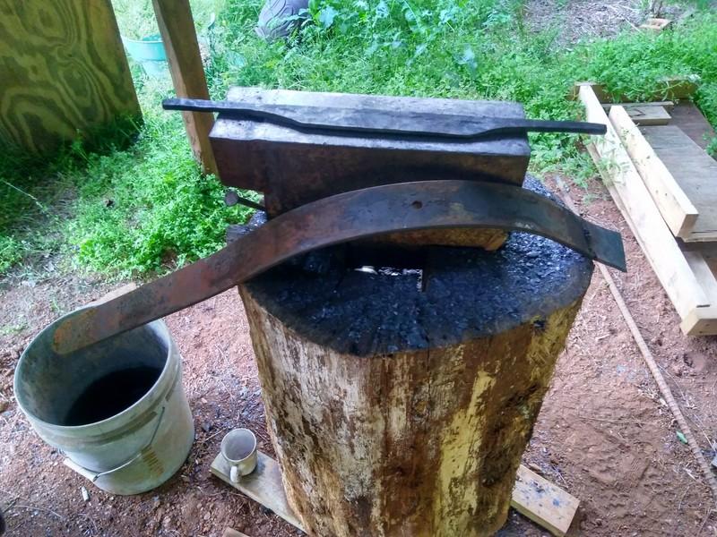

bluerooster Posted April 28, 2020 Share Posted April 28, 2020 Well, I had to go to the bank today, and on the way home stopped by the local farrier supply. They were open, so I picked up 100 pounds of coal. "Fresh coal", as the guy who delivered it was still there. :D Anyway, I had some other errands to run, and couldn't fire the forge until about 3:00. Got the forge fired up, and put the back scratcher on "the back burner" because I need a draw knife. Don't need it until next week, but I don't know how long it will take my noobie self to make a satisfactory one, so I'd best start now. Sure, I could go buy one, (probably made in a foreign country, from foreign material) Or I can make one here in the U.S.of A, out of material made here in the U.S.of A. I opted for the latter, and on the upside I get an education. I took the second to main leaf from a Model A Ford leaf spring, and started the process. Fired up the forge, and heated it up, got a good hot spot on the leaf, and cut it off at about 9.5". Never having made a drawknife before, I figured I'd draw out the tangs first, then work on the blade. I manged to get it all roughed in before I ran out of time. I still have work to do with it, but it's starting to take shape. Today was one of those days where the stars aligned themselves, and things went swimmingly. I'd never had what I would consider the perfect fire in the forge, but today, I got as close as I'd ever seen. And no camera. Well, I had the opportunity between heats, banked the fire, and got a beverage, and my cellphone. The fire was never the same after. Oh well. Link to comment Share on other sites More sharing options...

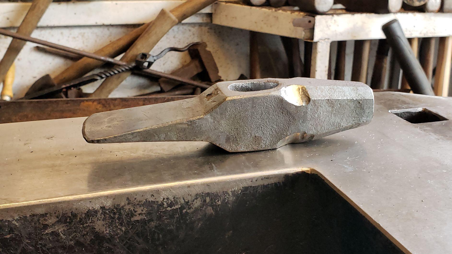

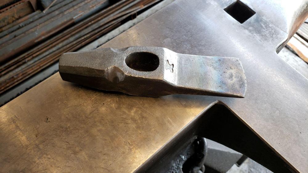

jlpservicesinc Posted April 29, 2020 Share Posted April 29, 2020 I spent some time redressing a handled hot cut. made it in 1987. Kinda neat how it's the same tool.. Link to comment Share on other sites More sharing options...

CrazyGoatLady Posted April 29, 2020 Share Posted April 29, 2020 Jennifer, you gave the hot cut a nice facelift. Looks like a brand new tool. Roger, nice work. I like the look of the wood. DSW, great looking tongs. Do the jaws start out long then welded back onto themselves and bent? Very nice Link to comment Share on other sites More sharing options...

jlpservicesinc Posted April 29, 2020 Share Posted April 29, 2020 DSW nice tongs. CGL.. Sure looks new.. Link to comment Share on other sites More sharing options...

CrazyGoatLady Posted April 29, 2020 Share Posted April 29, 2020 It looks great Jen DSW, thank you! I follow that description very well. They look really good Link to comment Share on other sites More sharing options...
