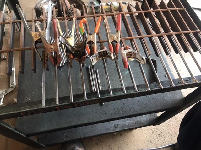

Welded up a grid for the cart that followed me home the other day, to turn it into a hardy and other bottom tool holder. There will also be lots of room on the shelves for other tools and jigs. The cart has locking casters, so it should make rearranging and cleaning the shop easier.
I ran a section of steel grid down the middle and welded some short sections of 1/4" rod on either side; here the center section is just being used as a spacing guide:

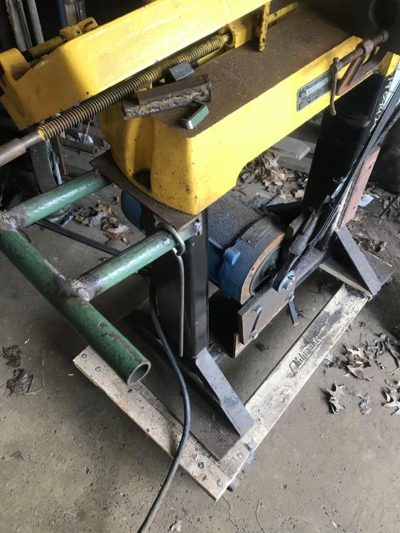

Also added a little folding support to my horizontal bandsaw; the hydraulic cylinder doesn't like to support the saw itself at any kind of decent height while I'm clamping things in place. This is just a length of 1/4" rod that holds the frame up when it's up and drops down when not needed.

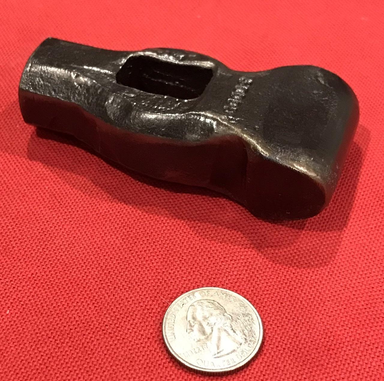

The work from a couple weeks ago all polished up.

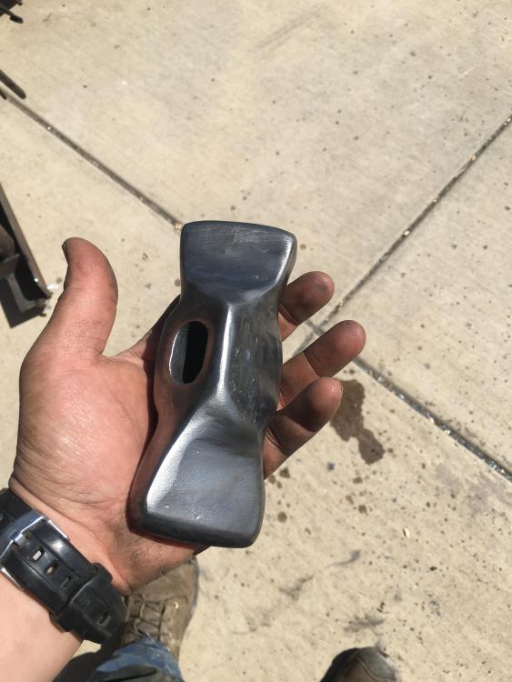

My favorite out of this grouping would have to be what I’m calling for now at least, the “elephants foot flatter hybrid”. Inspiration was taken from the elephants foot flatter Ethan Harty makes. I think this flatter is the nicest design I have seen.

Nice work, lbs! That flatter reminds me of when I was young, and my dad would threaten at every birthday and Christmas to get us “an elephant’s foot umbrella stand full of peanut butter.”  Well, when he turned fifty, I made an elephant’s-foot-shaped pot in ceramics class, just the right size for a jar of Jiff. I don’t think I’d ever seen him laugh so hard!

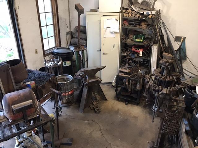

No forging today for me, but I did clean and rearrange my workspace:
Nice  JHCC
Although looking at your hammer rack gave me hammer envy!  But who am I kidding I don't know how to use the ones I have YET!

A close up was not nice !  I could clearly see my lack of hammers with out the blow up version . I currently have 2
A sad state of affairs
