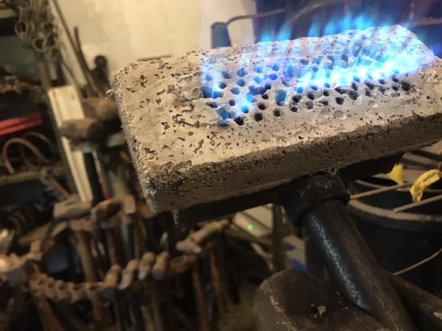

Long overdue update: I ultimately decided to go with beeswax as a release agent, dipping the mold bottom and skewers in melted wax before making up the rest of the mold. Mixed up the Kastolite as usual (1 lb dry mix to 3 oz of water) and rammed everything in place. Cured in a sealed high-humidity environment (trash bag with wet rag) for 48 hours, and unmolded.
Removed the rest of the mold from the ribbon block and fired things up.
The wooden base didn't want to come off the ribbon block, so I split it off with the treadle hammer and a hot cut.

On the first burn, I wasn't getting ignition in all the holes, so I reamed them out with a twist bit in a hand drill.
Which improved things considerably, but I was still getting some flames lifting off the block. I may ream out the holes a bit more later.
This is at about 15 psi. I think a lot of the yellow is from calcite in the ribbon block and some minor remnants of skewer and beeswax.
And this is throttled back to about 5 psi.

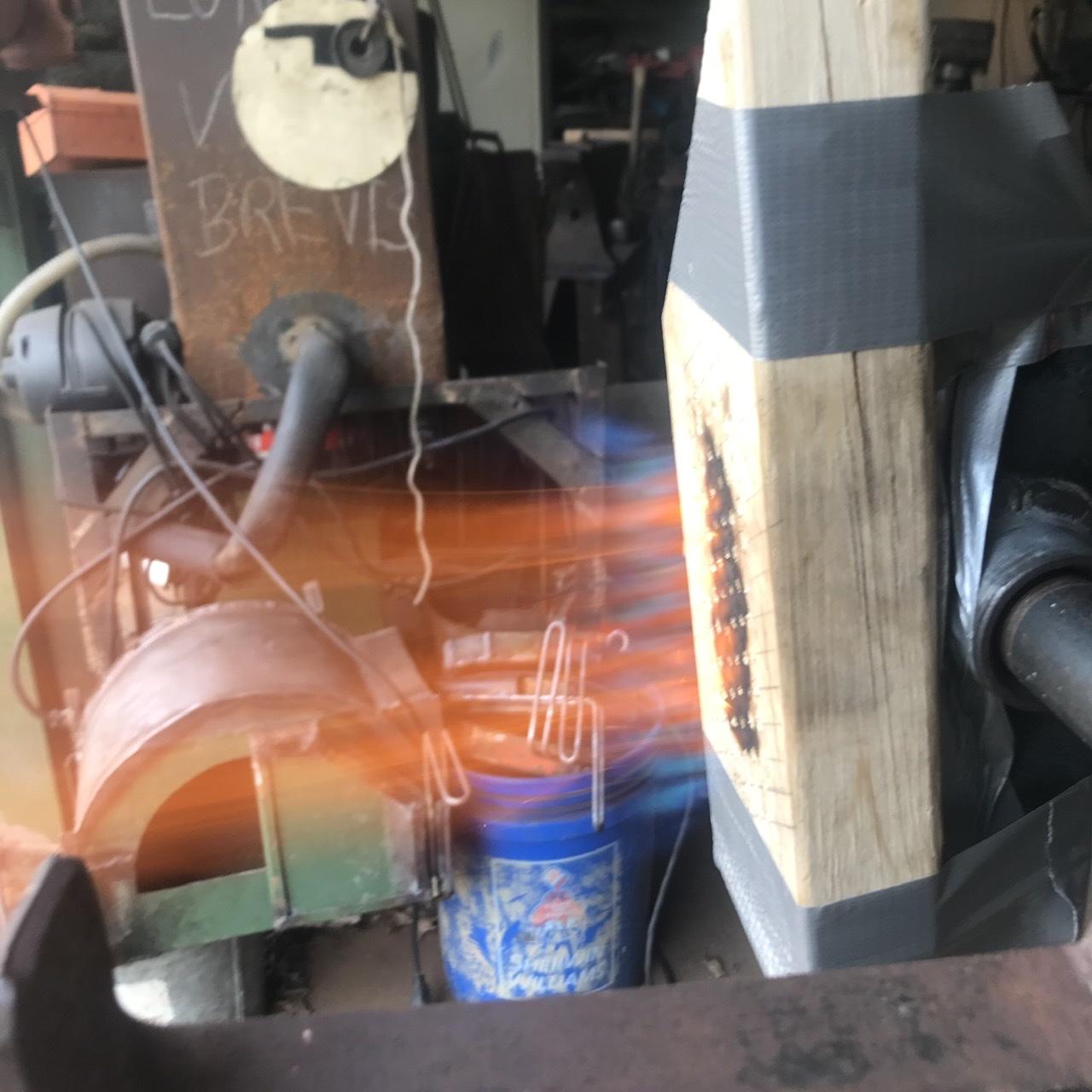

I put the burner into the new gasser:
And closed up the doors.
Which worked pretty well.
Although I think the doors give too much back pressure when they're completely shut. I could see that there were some flames forming outside the forge, as if the gas wasn't getting enough oxygen inside. I never got the burner and the forge up to full temperature, though, so that might change things.
