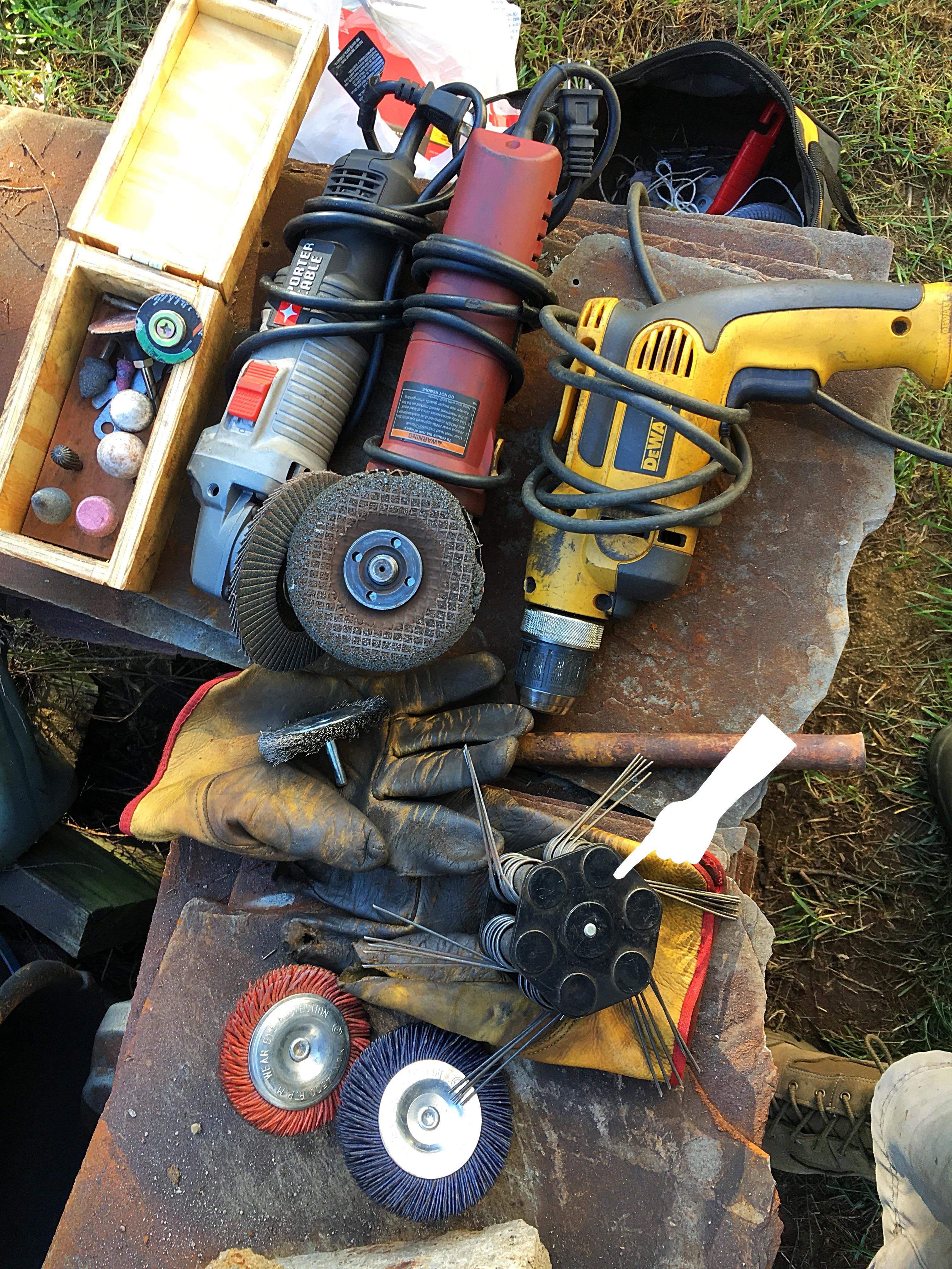

Dax Hewitt Posted October 9, 2019 Share Posted October 9, 2019 Grumpy Biker, what did you use to clean the swage block? You have done a great job. I have one that I dug up in an old quarry, haven't got round to cleaning it yet so any tips would be great. 19 hours ago, pnut said: Even after I told him I was going to actually use the tools not decorate my living room with them. I think this is the problem, certainly in the UK, people with more money than sense watch decorating programs and will pay silly money for what they see as decorations. Quote Link to comment Share on other sites More sharing options...
Glenn Posted October 9, 2019 Share Posted October 9, 2019 Your swage block cleaned up nicely. What did you use? Quote Link to comment Share on other sites More sharing options...
GrumpyBiker Posted October 9, 2019 Share Posted October 9, 2019 5 hours ago, Glenn said: Your swage block cleaned up nicely. What did you use? A number of items. I started with the scale / paint removal device used for getting paint off metal. I found it works great for removing the loose dirt & flaking rust. If going for a more polished surface I then go to the angle grinder to get the heavy rust off & remove the tops of the heavily pitted surface. Then move from the grinding disk to the Flap pad sanding disks starting with a 60gr and down to 120gr . If I don’t want a shiny surface I skip the angle grinder completely and go to the fiber wire attachments for the drill. Harbor freight has these, orange is course , blue is fine grit. After that I go to the wire brush attachments in the drill. I use die grinder bits in the drill to reshape the concave parts on the sides. I have 6 hours into it so far. I expect 4-5 more as I prefer to go slow & light. Mistakes are smaller & easier to fix when I don’t try to do it all in a couple hours. This portion is almost don’t. Quote Link to comment Share on other sites More sharing options...

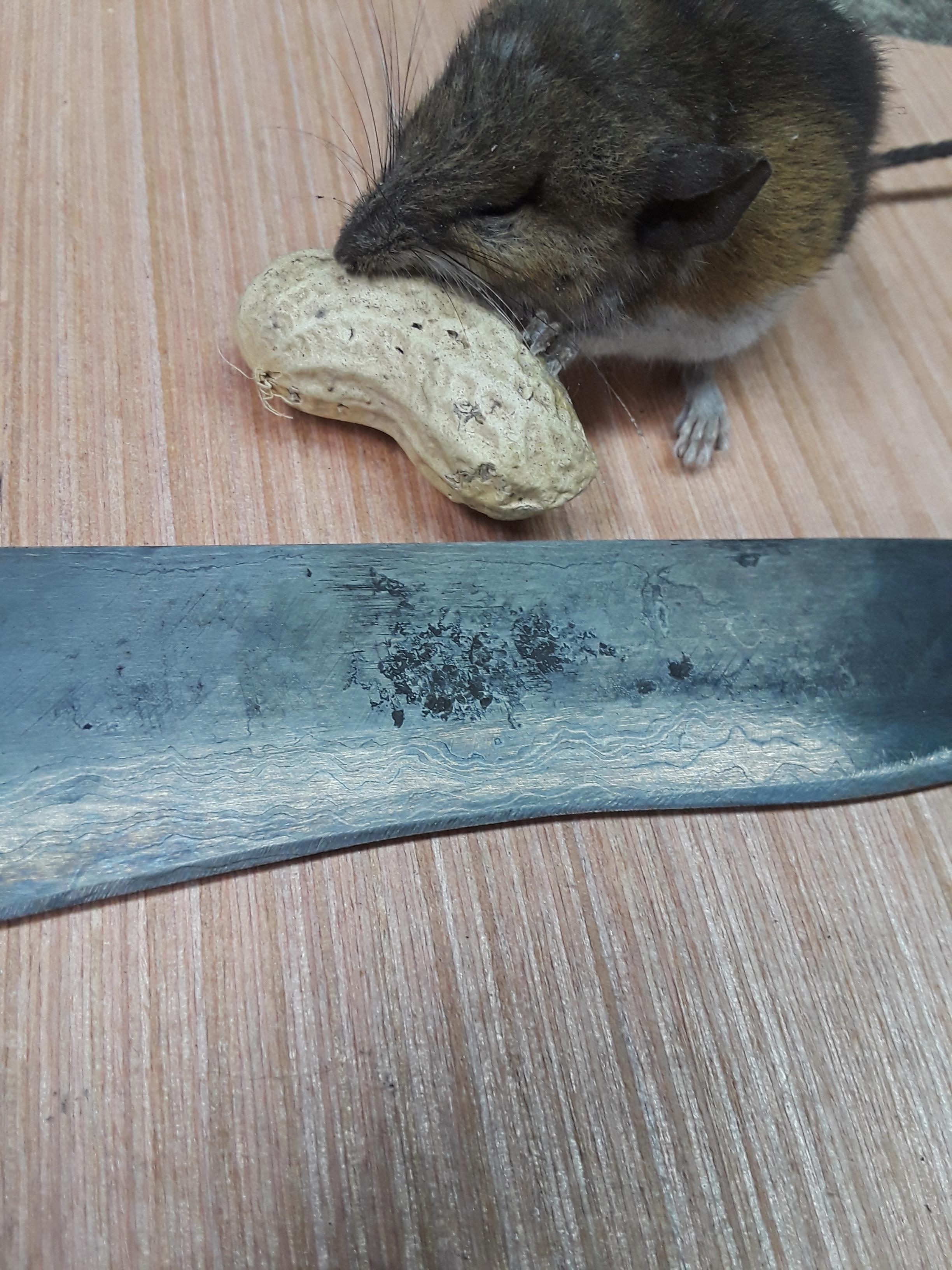

BillyBones Posted October 10, 2019 Share Posted October 10, 2019 Got this knife i been working on hardened, tempered, ground, sharpened, and etched. I have made a couple blades from old spring but this is my first pattern weld blade and i am taking a lot of time with it. This is mine, the others i have made i have given away to friends and family. The pattern turned out kind of light, but in the right light i think it looks pretty good. I used vinegar and salt to etch. So far i am happy with it. Going to the Hard Wood Store to find some nice wood for the handle today. I am thinking something like a red heart wood with buckskin filler. Wish i would have went bigger on the tang so i could do mosaic pins but there is always next time. Quote Link to comment Share on other sites More sharing options...
Les L Posted October 10, 2019 Share Posted October 10, 2019 Nice job on the knife, what metals did you use? Quote Link to comment Share on other sites More sharing options...
BillyBones Posted October 10, 2019 Share Posted October 10, 2019 Thanks, i am kind of proud of it. Probably the best profile i have accomplished. 15n20 (or so i was told, but have my doubts) 1065, and 52100. Quote Link to comment Share on other sites More sharing options...
Buzzkill Posted October 10, 2019 Share Posted October 10, 2019 If you want to bring out the pattern a bit more, instant coffee really does a pretty good job of turning up the contrast between different alloys of steel. I like the overall profile, but I'd probably want to do a little more tweaking at the transition from the tang to the blade. It's a matter of preference, but I prefer a defined plunge line and ricasso area with a sharpening choil included. Regardless, she has some nice curves. Quote Link to comment Share on other sites More sharing options...

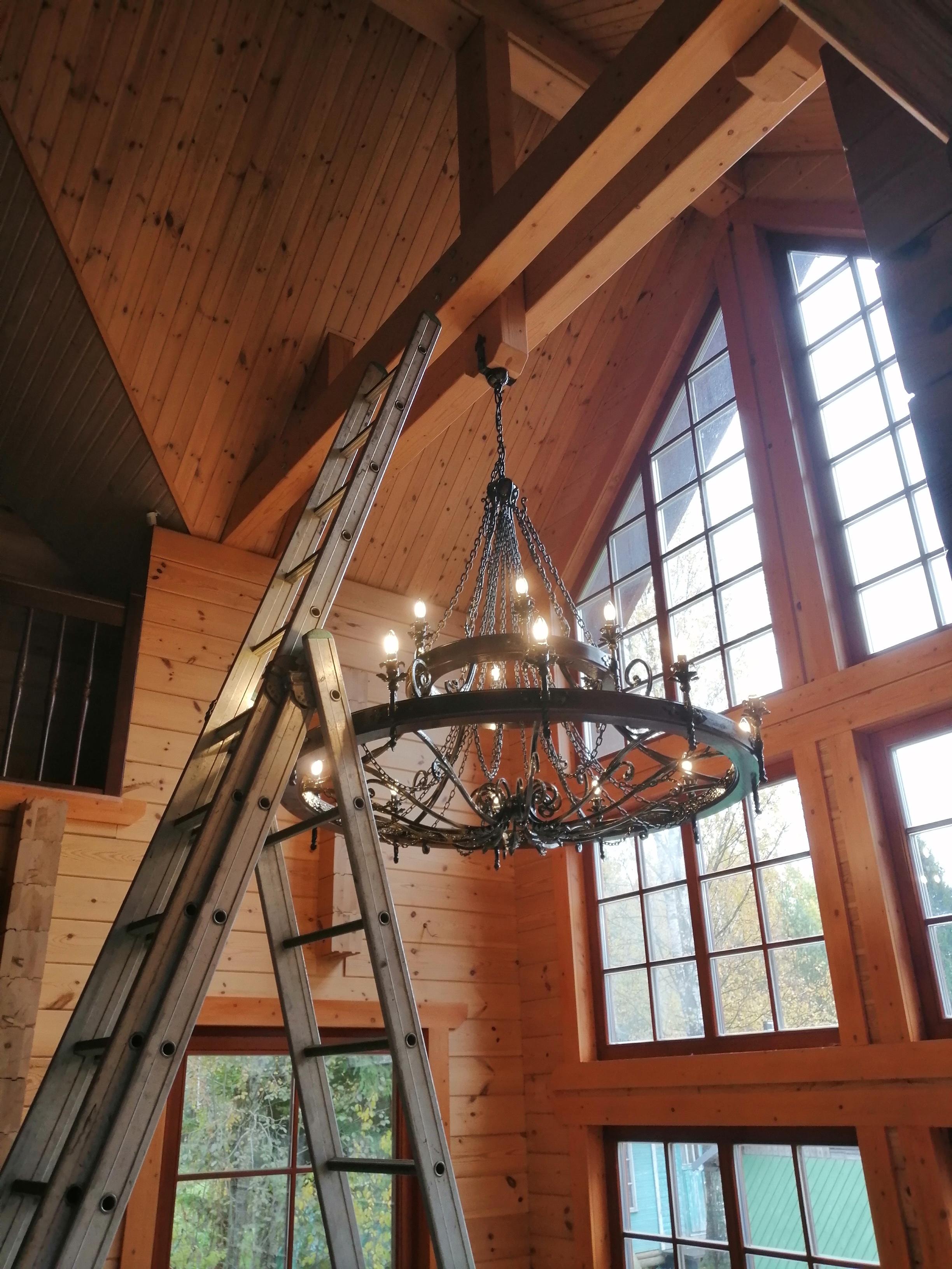

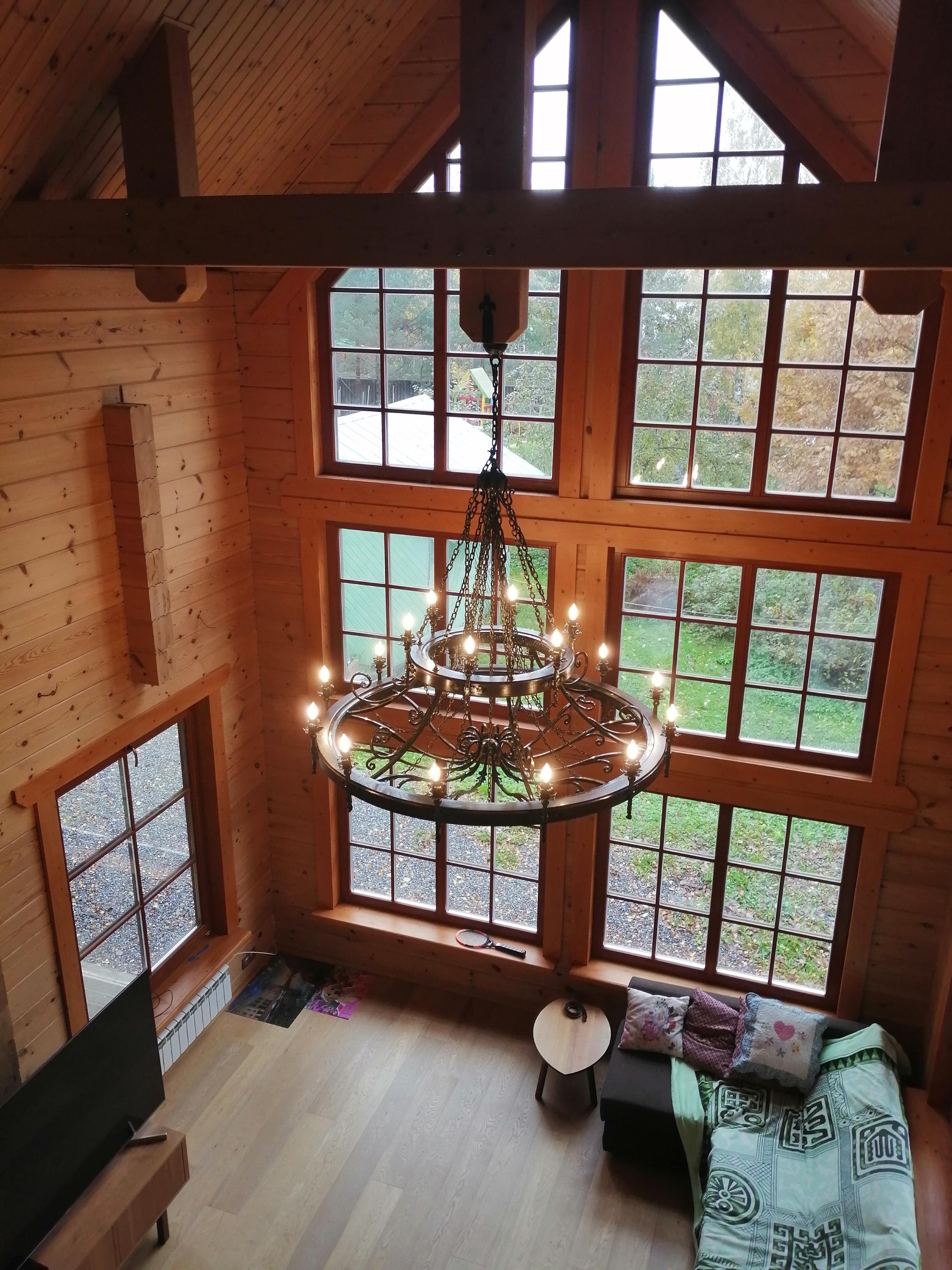

alexandr Posted October 11, 2019 Share Posted October 11, 2019 Today installed Quote Link to comment Share on other sites More sharing options...
jlpservicesinc Posted October 11, 2019 Share Posted October 11, 2019 crazy nice Alex, What kind of chain do you use? Commercial made? Quote Link to comment Share on other sites More sharing options...
