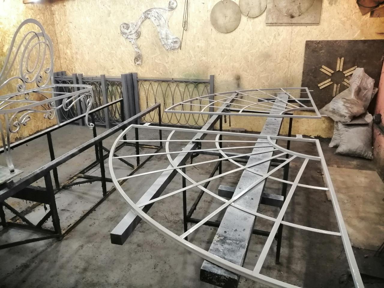

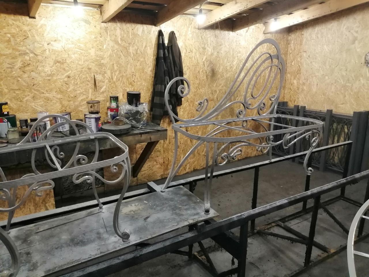

alexandr Posted October 14, 2019 Share Posted October 14, 2019 The second week of rain and cold. In the new painting area it is warm and dry. Quote Link to comment Share on other sites More sharing options...

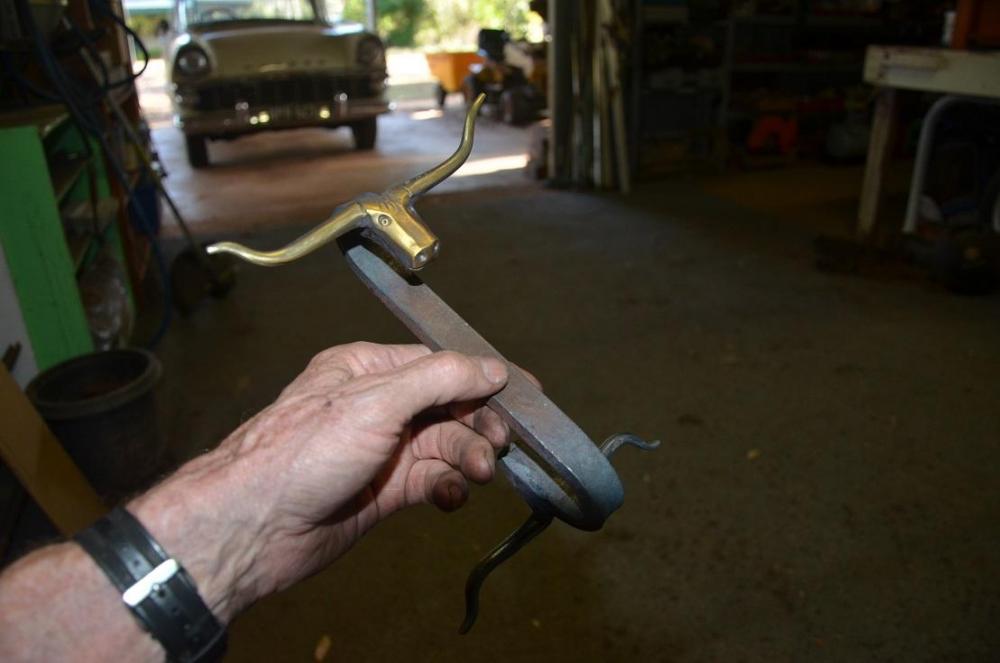

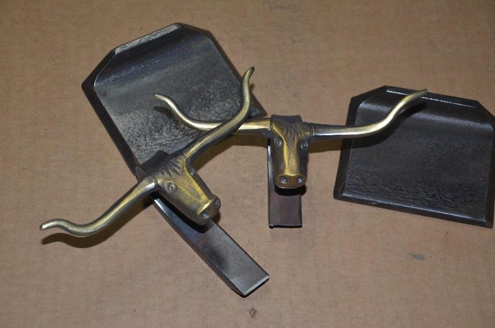

ausfire Posted October 15, 2019 Share Posted October 15, 2019 Found a better way of making these longhorn business card holders. Much easier to do two at once and forge a bull on each end of a piece of 19mm x 10mm mild. That shape makes for equal sized square horns when split. It also eliminates the use of tongs and very little steel is wasted. A local fabrication shop saved me a bunch of off cuts which make great bases for these. Better than folding flat plate. I think I might texture the bases on the next ones to take out the 'machined' look. Anyway, here are today's holders: Quote Link to comment Share on other sites More sharing options...
Old Crew Posted October 15, 2019 Share Posted October 15, 2019 Ausfire They look good. I might have to try to make some eventually. Long Horns are very popular here in my part of Texas !!! How do you get the gold color on the head and horns? Quote Link to comment Share on other sites More sharing options...
ausfire Posted October 15, 2019 Share Posted October 15, 2019 Just a quick lick with a brass brush while hot. (Not too hot - nowhere near red). Make sure you have a real brass brush - not brass coated steel! Quote Link to comment Share on other sites More sharing options...
ThomasPowers Posted October 15, 2019 Share Posted October 15, 2019 Make a cow footprint punch and wander a series across the bottom piece to "dress it up" a bit. Cow flops are not necessary... Quote Link to comment Share on other sites More sharing options...
