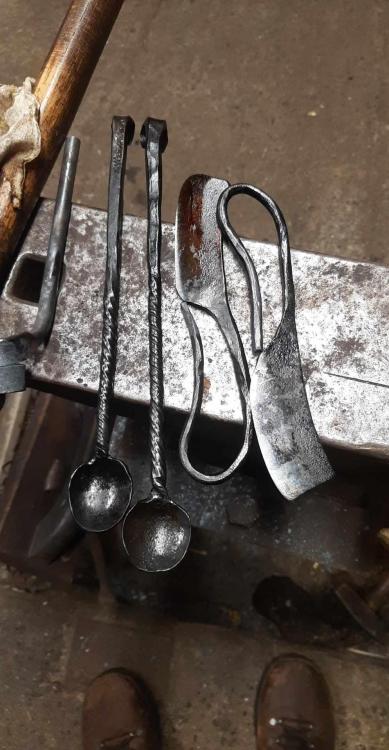

knocked out two jam spoons and cheeseknives for a christmas present yesterday and finished them with a nice hot coating of twice used deep frying oil then once I got home they got another wipe of oil and were sent for a long soak in the oven at max temp, I figured if seasoned cast iron pans are fine and dandy for cooking then seasoned mild steel utensils should be just as fine. those spoons have a half octagonal twist and I made them extra long in case the intended recipients enjoy those jams that come in the narrow and tall jars that no regular teaspoon fits in.

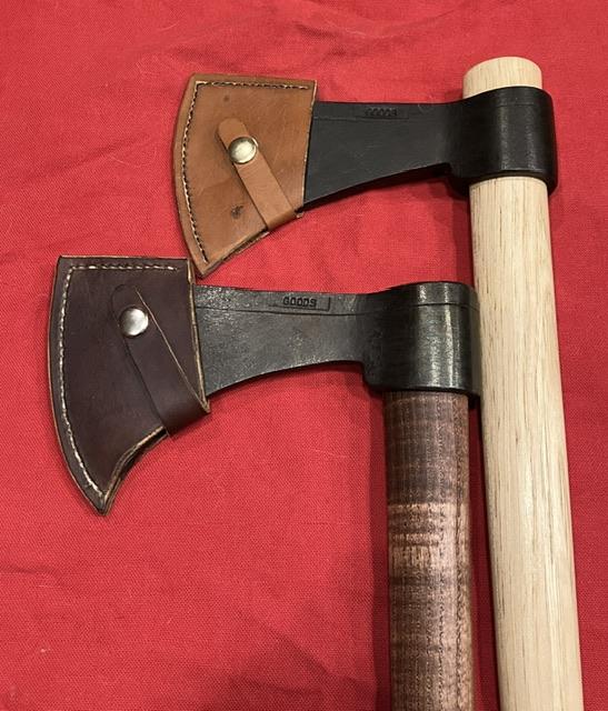

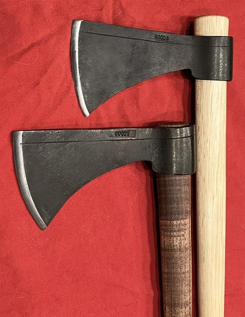

I wasn’t sure if I could pull it off, but I got the stitching finished up on the hawk sheathes tonight and they’re ready to go to the new owner tomorrow morning:
IMG_0757.jpeg.5a7b1e11bba3c75bf922f75cdc611be5.jpegIMG_0758.jpeg.39a29330849e09cbf6d7daf57f208ff4.jpeg
I sharpened them and finished the handles Monday night. Then Tuesday, I managed injuring myself, getting a bad gash and nicking the bone on my left index finger. All stitched up last night, I didn’t have any trouble making the sheaths, but I was really worried about pulling the stitching tight tonight, but it went ok. No forging for a a while, but I have to clean the shop anyway. I’ll just put on some latex gloves to keep it my hand clean.
Next time you’re doing something and the thought “this is not a good idea” crosses your mind, stop what you’re doing, and think how to proceed more carefully! Most of us have been there, but it doesn’t always doesn’t always end good. In honesty, I got off easy, 1/2” in any other direction and I could have had major complications.
Keep it SAFE,
David
STunning work David.. Sorry to hear about the finger and stitches..   Comes it waves it seems..

David, those hawks are fantastic. Eek about the finger though. Hope that heals without issue.
Living in the states i have never encountered a jar of jam that i could not get a teaspoon in. We mostly use a Mason jar and they are pretty wide.
David, been there done that. I have a scare on my finger from when i was cutting wax for my ex-wife's candle making period and had to get 5 stitches in it, Feel for ya brother.

Some of the imported jams and jellies come in these tall narrow jars.
We don't use cane sugar so buy products that use juices to sweeten and we ended up some of the French varieties.
A tablespoon will not fit. One of the jars a teaspoon was tight had to move to the butter knives with the swelled ends.
Have you seen some of the designs on new butter knives.
The blades are so thin that they won't scoop.

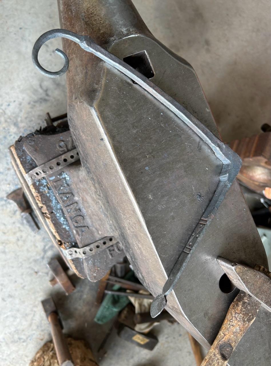

Have not done a lot of forging lately but yesterday I made a lantern hook…

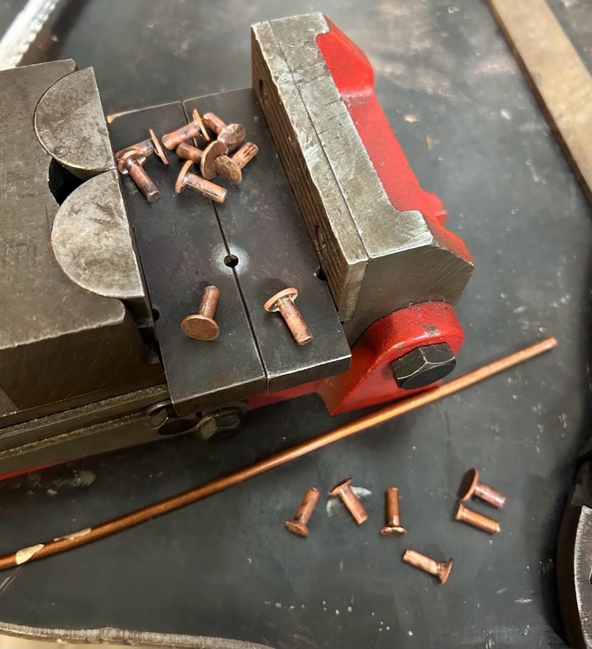

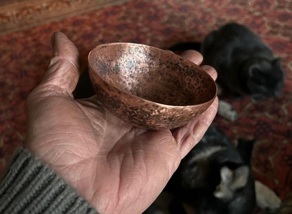

also made an impromptu rivet header and some copper rivets out of some bonding wire. It took a few tries to get it down….
also raised some .065” copper for an upcoming ladle.
thanks for looking
It doesn't look like you had any trouble pulling it off to me. They both look great. Sorry about the finger, been there done that more than once.
Sounds like you need to get yourself a jam scoop made!
Rojo, I'd say you made up for lost time. Good stuff.
Very nice, Rojo.

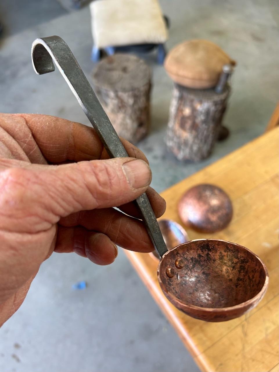

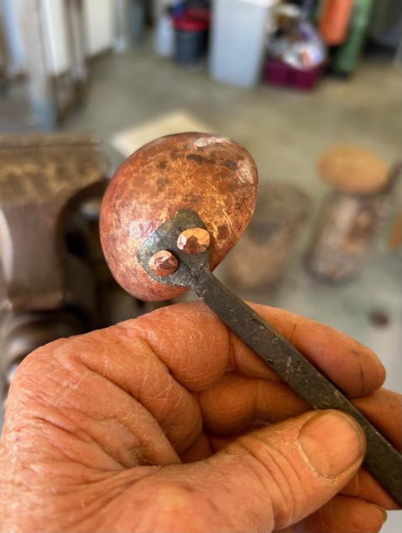

Thanks. Here is a prototype little ladle. Used commercial 1/8” rivets on this one. Think it turned out pretty good
Only thing not thrilled with is the other side rivets. Will make a little shorter next time
Rojo, what you need is a rivet setter. You can make one by sarting with a punch with a hemispherical head.  Then, hot punch that into a piece of coil spring about twice the diameter of the hemispherical punch.  Finally, grind down the piece of coil spring so that the end is just slightly larger than the depression.  Use this to upset the end of the rivet instead of the peen on your hammer.
If you are using dome headed rivets you can make a hardy tool with depressions into which you place the rivet head while you upset the end with the rivet setter.  You then have a rivet with nice clean domes on both ends.
Ezee Peezy.
That looks awesome!
Rojo, when i do ladles i use bright nails for rivets. They work quite dandy. However i do not do much with copper at all though so i am sure a copper rivet would look much better on that.

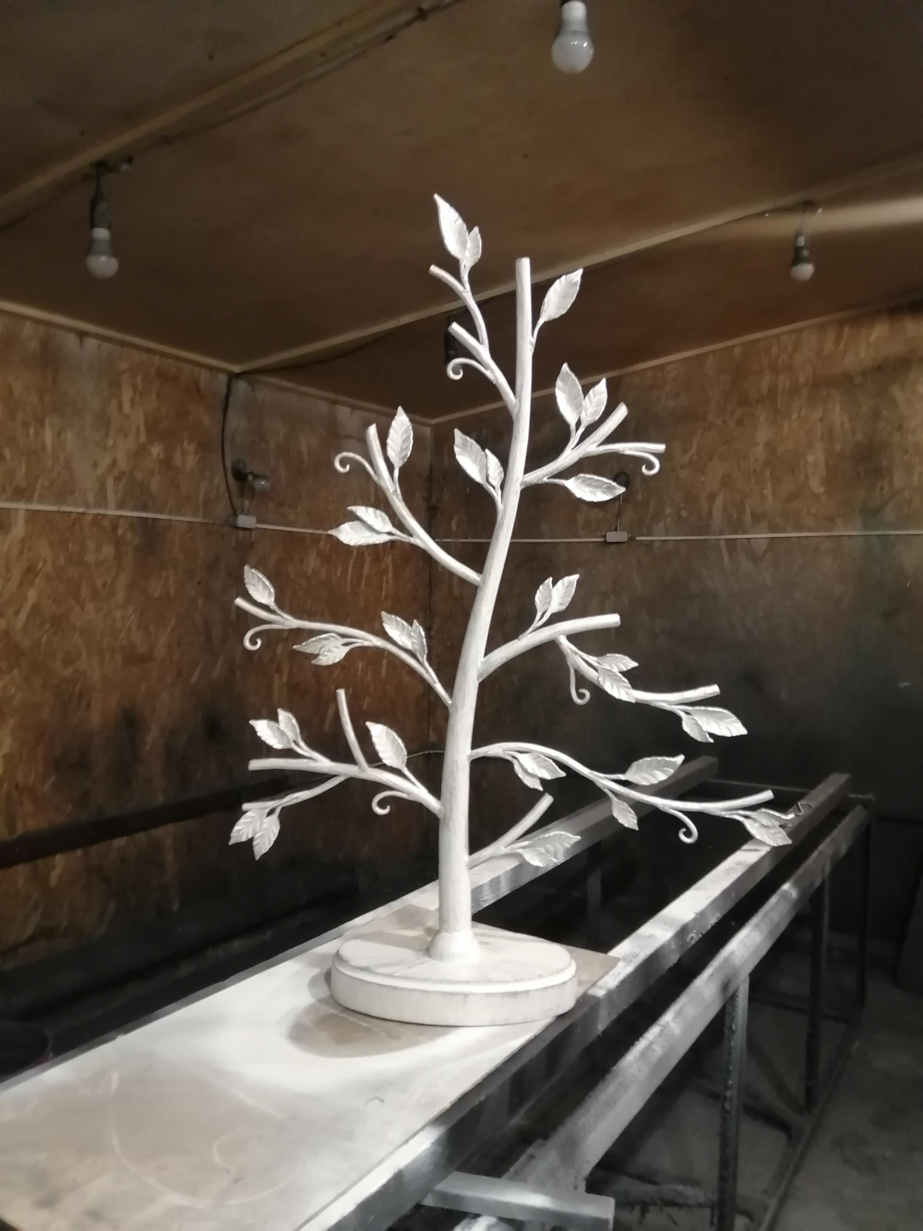

Nice.
Beautiful as ever Alex. A railing perhaps a landing? The branch and leaves are part of another sculpture or a stand alone itself, no?

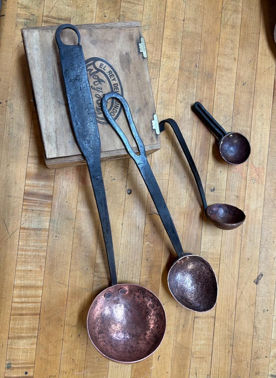

Fun with copper and steel. Just wrapped up some Christmas presents.
You are right George, I need a rivet setter.
