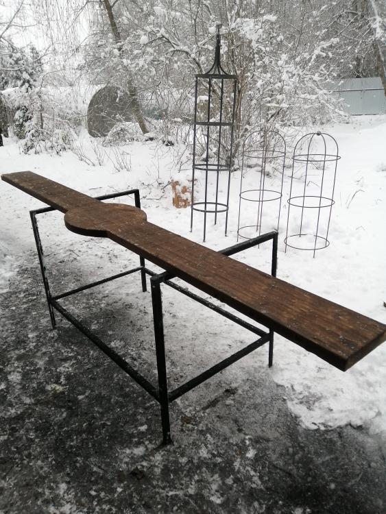

Welded up a stand for the big machinist’s vise I restored a while back.
It’s been sitting in a corner gathering rust for the last few years, but the mechanism still works smoothly. A little wire brushing and some oil, and we’ll be good to go.

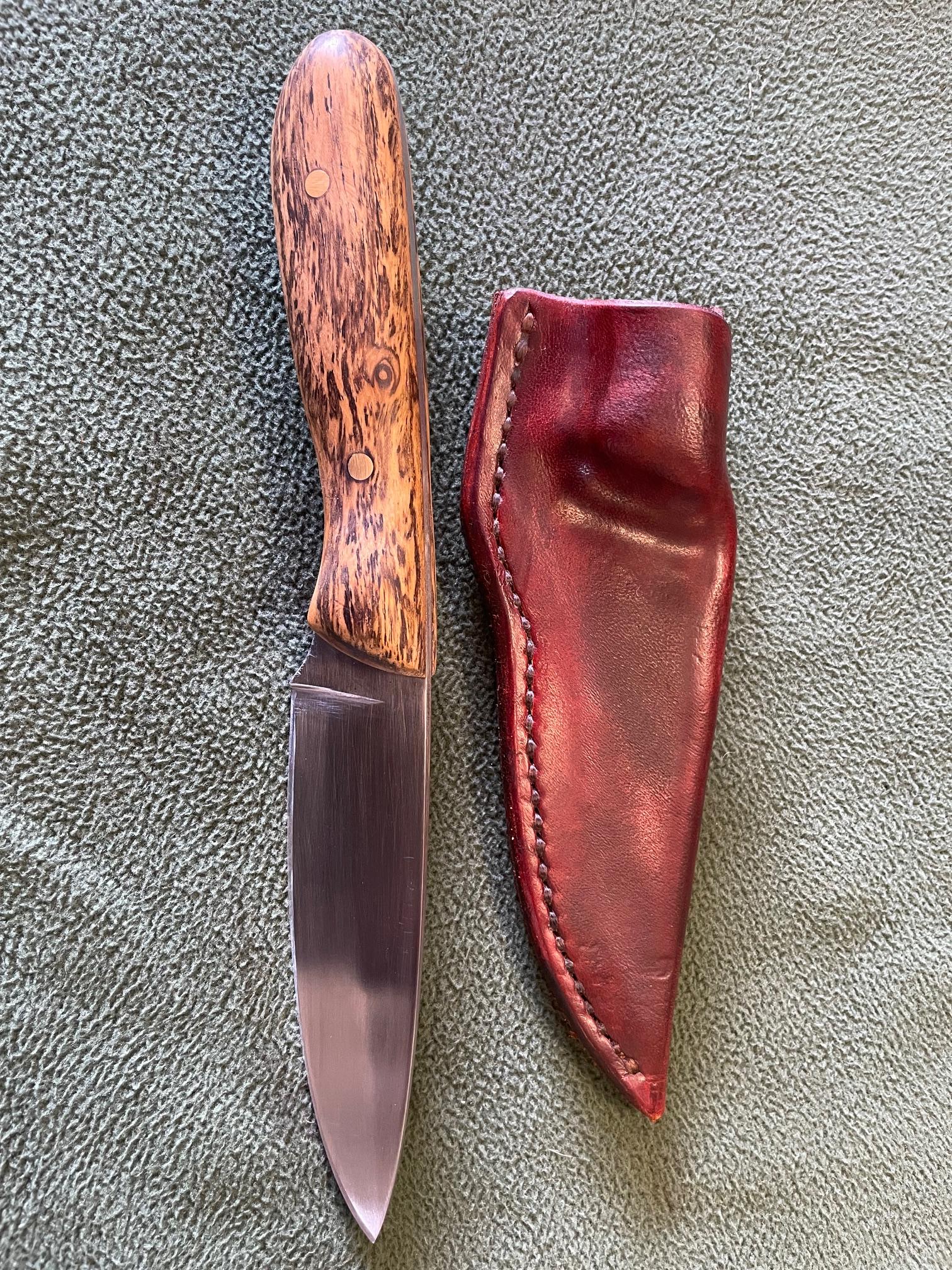

I have to apologize to everyone that's been posting for not taking the time to comment on their great work. I've been running in circles lately taking care of issues that have been popping up and keeping me busy, but scanning the posts every few days and enjoying seeing everyone's work. Been working on a few commissions, in between phone calls that shut me down for the day, but I have gotten some work completed and delivered. Seems like every time I complete a tomahawk and Blacksmith knife I get another order, the interest surprised me and I'm not complaining, I have another order to complete this weekend, plus two more hawks to complete in the next two weeks. I had a customer, that has ordered several items from me, order two hunting knives so I tried my hand at those, plus my first try forging cable. 1 1/2 cable by hand was a little tough, but it was a fun project.

I am really surprised about the orders I have received for the tomahawks and blacksmith knives. I made my first for our clubs conference a couple of years ago and can’t believe the interest for them that I’ve had in my area
