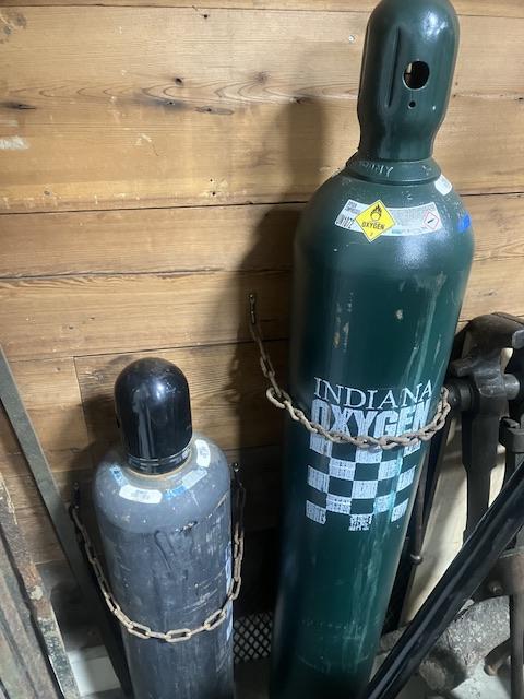

Now, I have a problem! Looks like I’m going to need a torch to do the final riveting, but I haven’t bought the gas yet. Nor have I developed that skill set. I may have to go to one of the other smiths shops this week to finish it…

Okay, I broke down and did it:
Took off work early, hit the welding shop, brought them home, and properly set them up. In a day or two, I’ll try my luck at it…

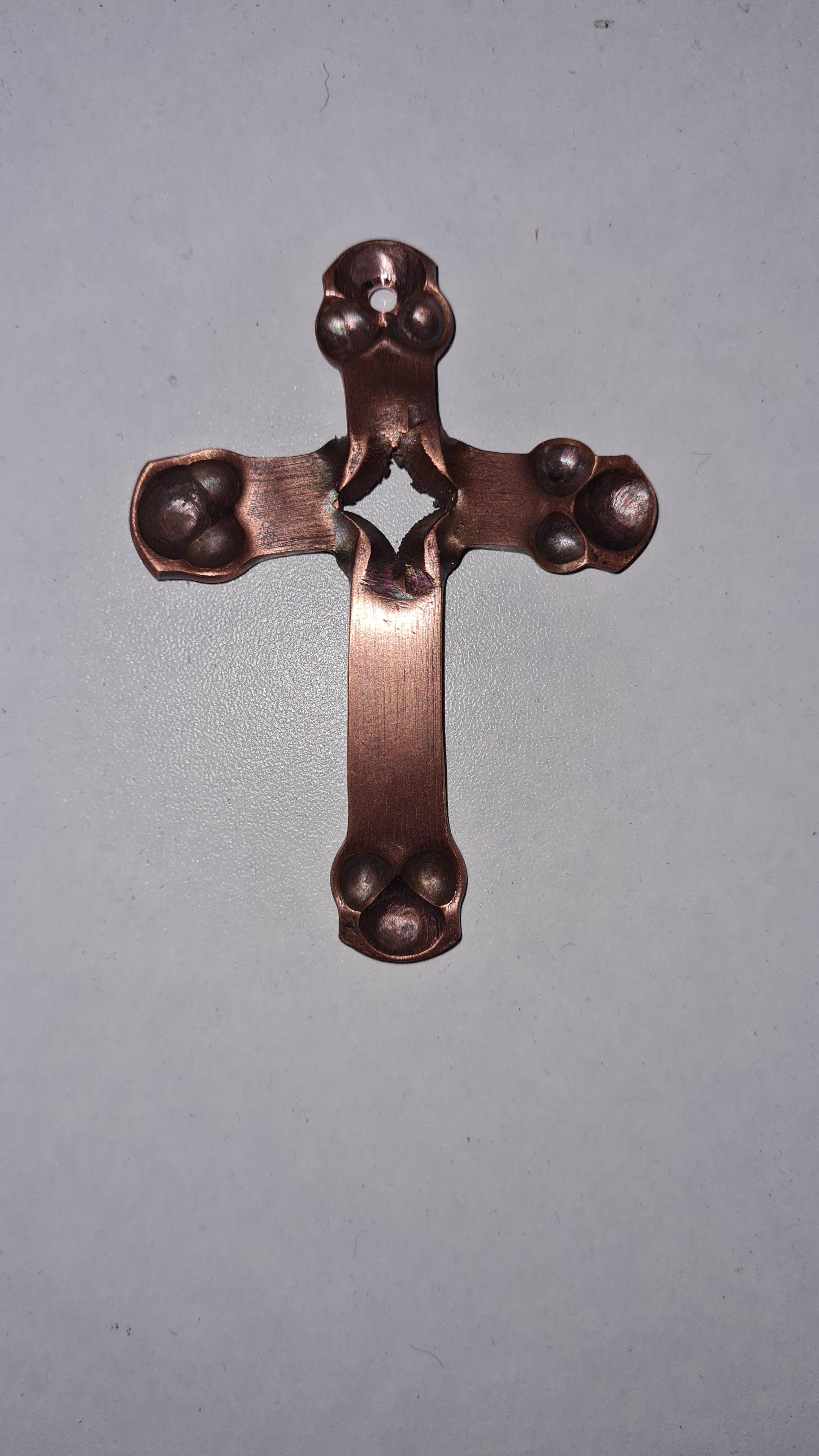

At the end of last week I ran a group activity at our staff community building day making copper split crosses. 4 x 1 hour long sessions with 4 or 5 in a group. They did all the hacksawing and most of the bending and hammering, I annealed the pieces for them as required with the oxy/acetylene torch and water. Only two that didn't turn out as planned and both were salvageable as smaller crosses. Here's one group's achievements:
It was great fun teaching teachers and support staff a more hands-on subject!
And with a spare piece, I tested out some decorative punching and made one that I will give to the lady who will be our new chaplain. (still need to polish it).
