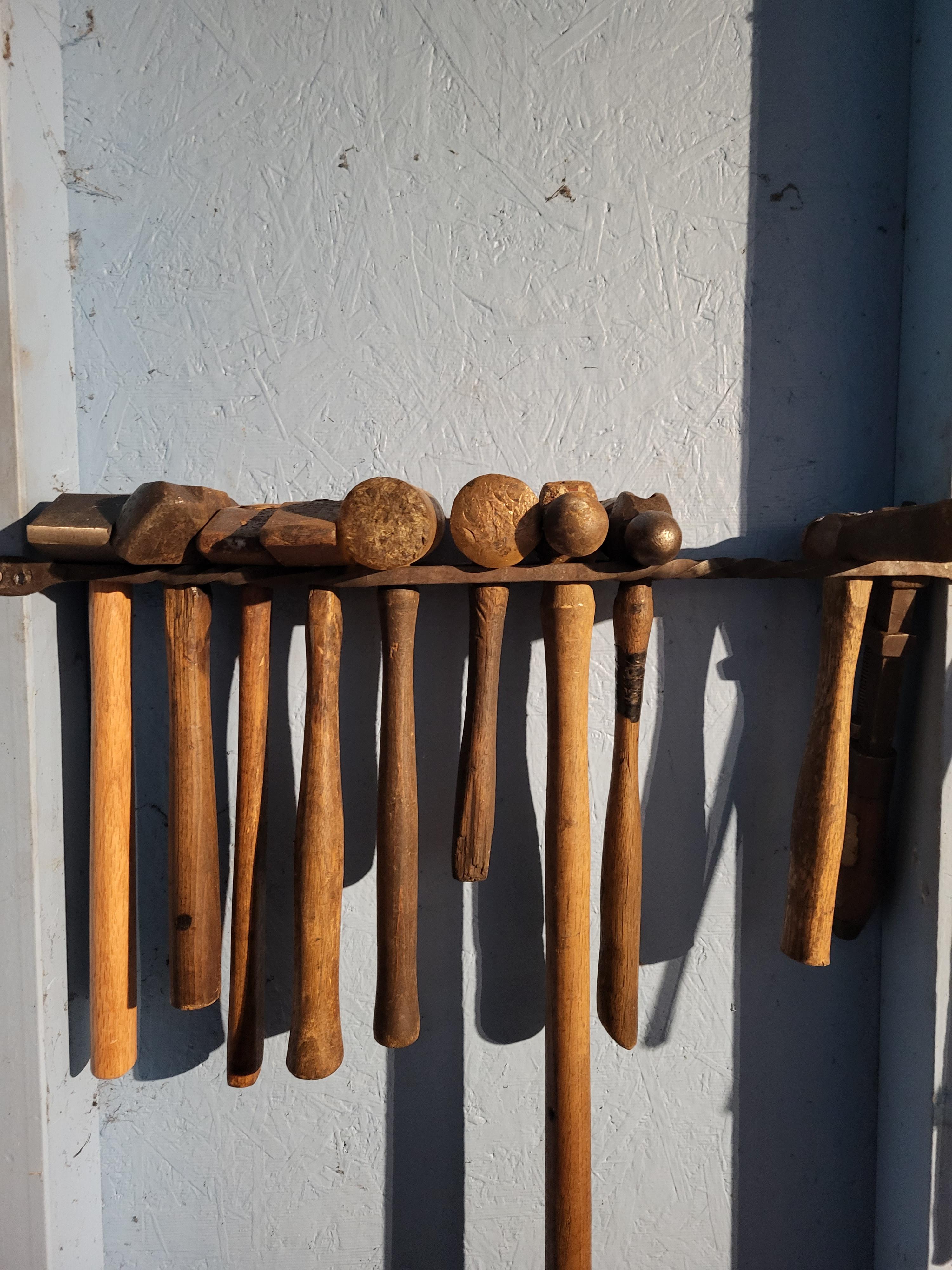

Ain't much, but made a few bars to serve as tong and hammer racks. Tabs on the end, punch and simple twists for aesthetic pleasure...and also because that square stock got a good brine soak when the ocean came to see us last January.

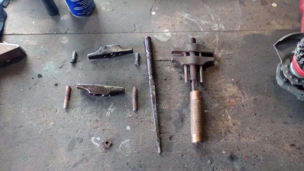

I have a an old adjustable wrench, that I saved from the scrap yard, and it would not move. It has been sitting on my bench for more than a year, at least. I tried with just WD-40 for weeks, I tried heating it in the forge. So today I was cleaning the bench and just decided to cut the round bars that keep it straight and moving together. I really didn't want to do that but it was give up or cut. But that did the trick, I did have to heat it up in the forge more than once. I already have the same style wrench also saved from the scrap yard.
Davor, in the future when presented with something that is frozen up use, instead of WD-40, a 50/50 mixture of acetone and automatic transmission fluid.  It is a much beter penetrating medium, and much cheaper.  WD-40 does a number of things OK, one of them penetrating oil, and none really well.  It was originally developed as a water displacement medium for the aerospace industry.  It was the 40th water displacement formula tried, hence, WD-40.
BTW, interesting wrench, I've never seen a double sided one like that.
Cool wrench, I've never seen one either. Ditto George about the ATF / acetone rust breaker. ATF is formulated to reverse and protect from rust. Acetone penetrates like crazy. Good stuff.
I have seen something similar but one side of the jaw looked kind of like a basin wrench with the inverted "V".
Is the wrench in the picture, the same one with new rods threaded? I also have never seen one like it, just so cool when it's opened up are the sides the same size opening?
Semper Paratus

Irondragon, it’s two wrenches but identical, I just got it to move still have to make a handle and the bars. It is same size on both ends (left and right) when adjusting. The top and bottom part have different incline on the threads so the top travels shorter distance when opening or closing.
Unfortunately no markings on the wrenches.
