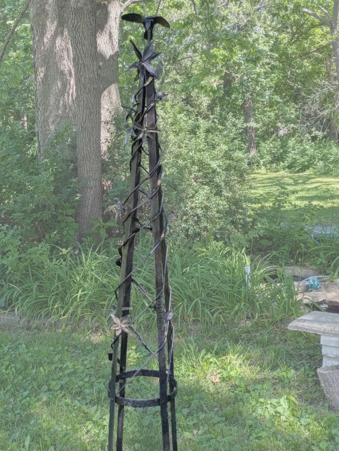

  12. I feel you gewoon. I only get 2 hours each night and if I'm lucky, up to 8 hours on Sat/Sun but that's assuming we don't have any other plans. It seems it's never long enough, lol Billy, I like that. It's simple and clean. Last night I tried my hand at brazing. I didn't want to clean the spatter of flux core and I don't have mig. I also thought my friend would probably appreciate the little splashes of "gold" throughout. I practiced on some scrap of similar sizes before taking a run at the actual trellis. Could be better - for sure - but it's definitely holding! Next up is to use the torch to spot heat the stems and wrap them along the structure, give everything a good cleaning with degreaser, then Ospho & wax. I would love to have this done by Saturday but of course, this is the week that I have appointments after work 3 of the 5 days, lol. So probably won't. The only full size pic I have - complete with a messy shop in the background, lol
