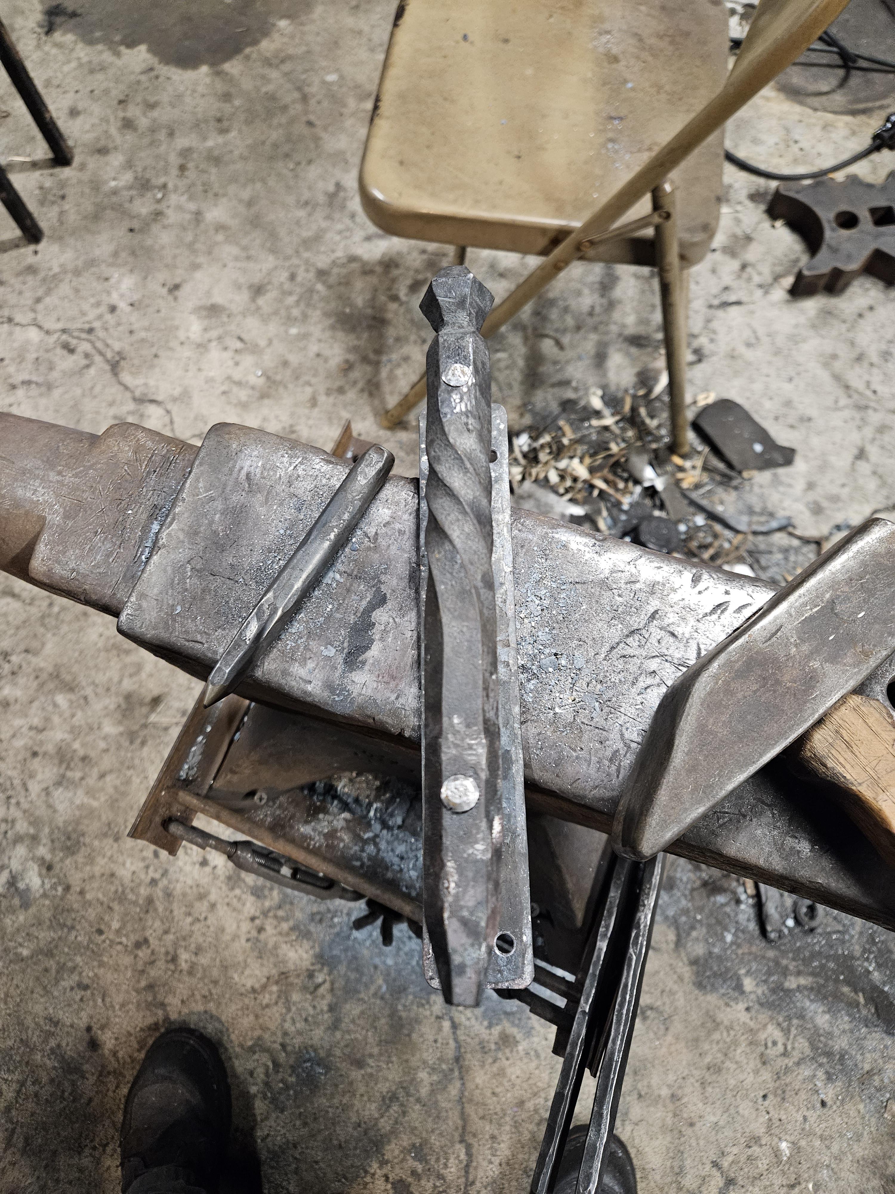

Not much on the schedule right now so i got some play time in the shop. Decided to play with hex bar. I got this piece from work that was about 2' or a bit better long. 7/8" wide. So i made a diamond doodad on the end, pointed the other and a half twist. Then made it into a door handle for the barn. Not the prettiest but working the facets down was a bit of a challenge and quite fun. For the first time really working hex i am pleased with the results.

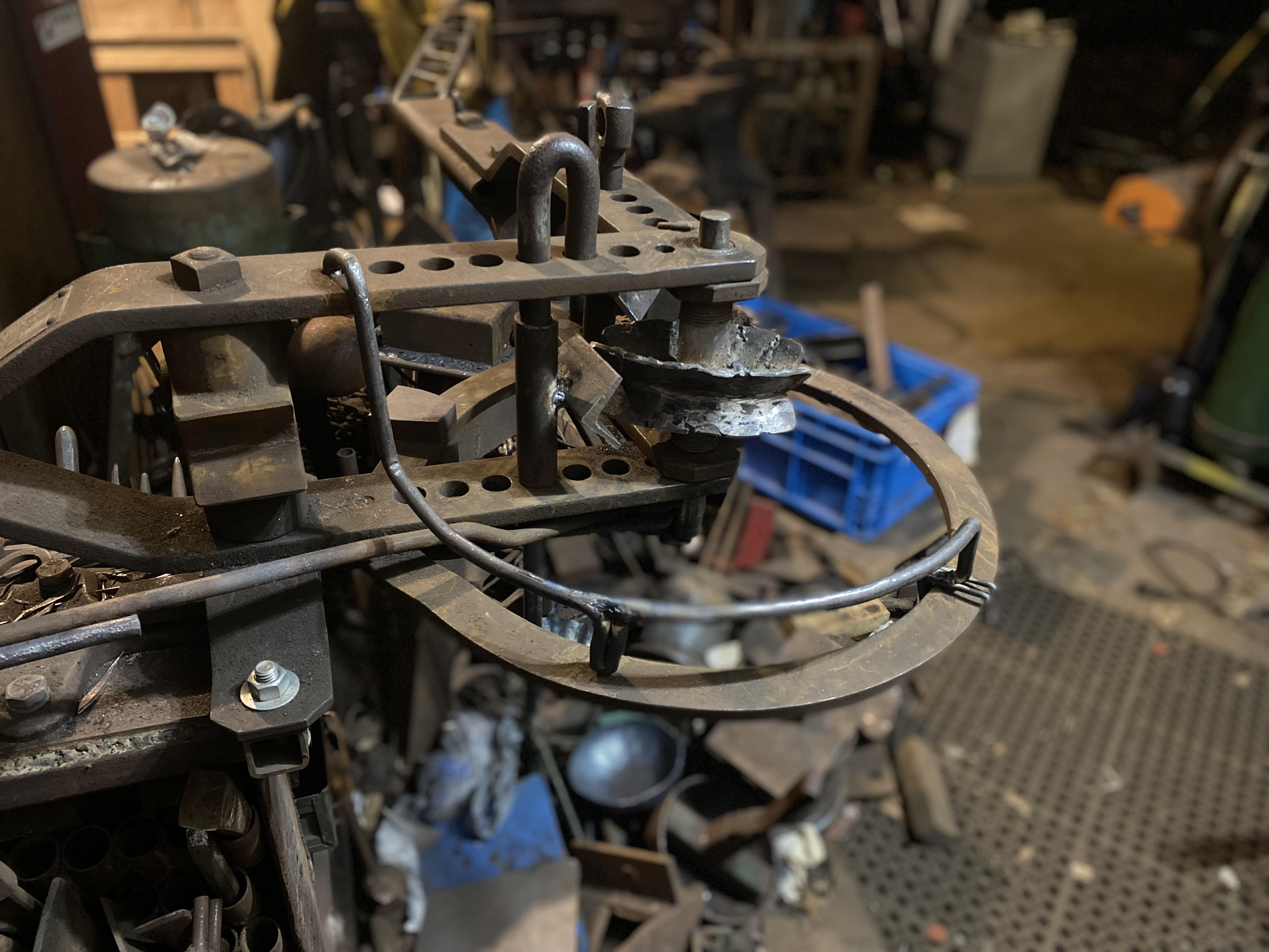

 So, a few bits and pieces.

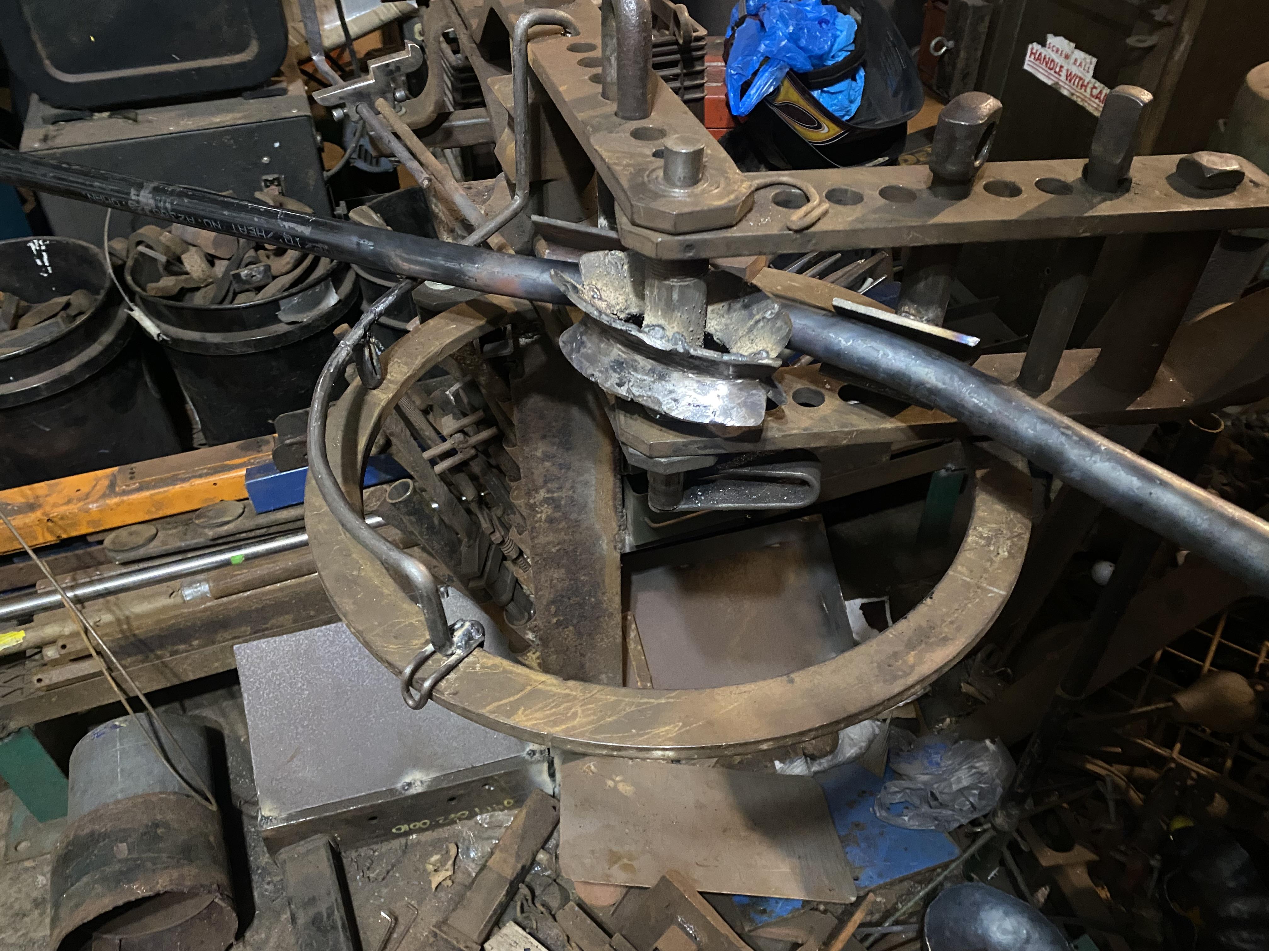

1. Cut, bent, and rewelded the Hand Lever for the Hossfeld, to give it the appropriate 20° bend:

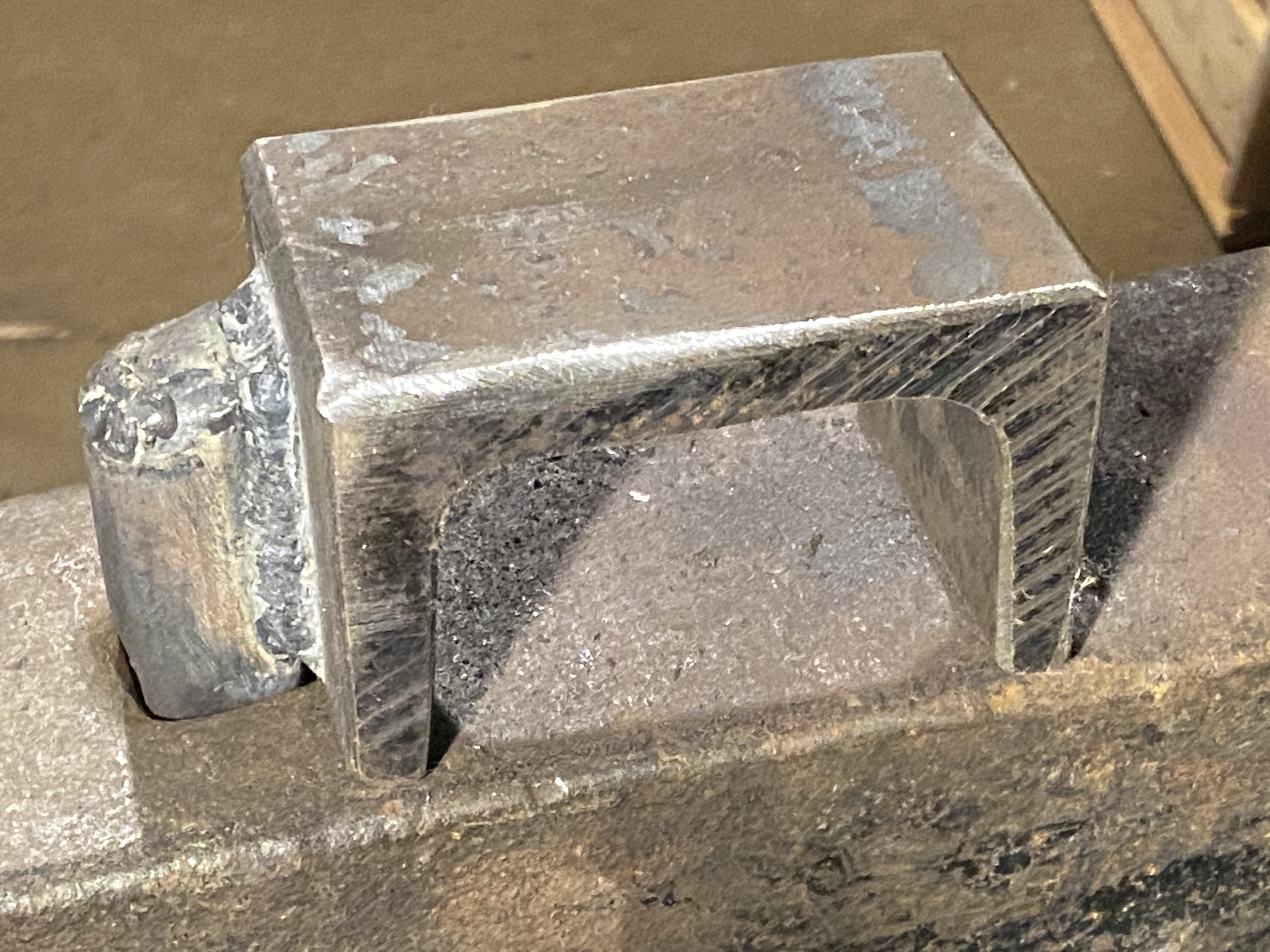

2. Made a bridge tool from a piece of squared-off tubing and a really hefty chunk of C-channel:
(Need to do some more grinding on the underside, but that’s on the to-do list.)

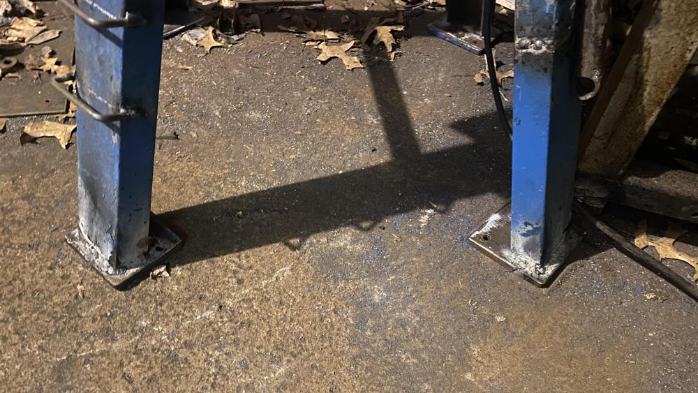

3. Welded feet onto the bench vise stand:
4. Made an auxiliary support bar for the Hossfeld, to help keep pipe from dropping off the tooling while I’m setting up a bend:
John, that auxiliary support bar is a very clever idea! I find the phase of getting set up for the bend is often a challenge & this would help. A combination of an adjustable stock stand and a magnetic level has been helpful on this end; the level to help spot and correct drooping stock...
--Larry
WORK and Hex bar go together so well at the anvil. It's more temperature critical but not as bad as tool steel and is excellent for medium high carbon tools. I never turn down a piece though the 2" hex I salvaged is some serious work.
I like your stock rest John, keeping things level was always an issue for me. I was never any good on a Hossfeld and haven't used one since highschool. Well, without loud protest that is.
Frosty, work is right and i had a blast forging this. Wish i would have got a better pic of the diamond doodad, i am pretty proud of it. I managed to get the facets all equal and the "line" in the middle is straight with nice sharp corners.
I am not sure what you mean by temp critical. This was a piece of 1018.

In my experience hex bar is almost never simple steel medium to medium high carbon usually with alloying metals according to use. Think crow bars and chisel / punch sets. Our solid flight auger had 2" hex couplers and we ran into situations the drill bit would get into something "grabby" and stall the drill engine repeatedly until we could kick the obstruction aside. The extension bar was always in the string between the drive head on the draw works and the top flight of auger. The hex NEVER broke, sometimes a weld between the female hex and auger or tool failed but never the hexes.
Our first choice extension was in play stopping the final drive or stalling a 4/53 Detroit diesel running in the power band must be thousands of times.
I've never run across mild steel hex bar. I have run across a couple examples I couldn't anneal or perhaps the alloy was intended to be skate a file hard.
By temp critical I mean treating it as if it's more than 40pts. C and don't overheat or leave it hot without refining for too long.

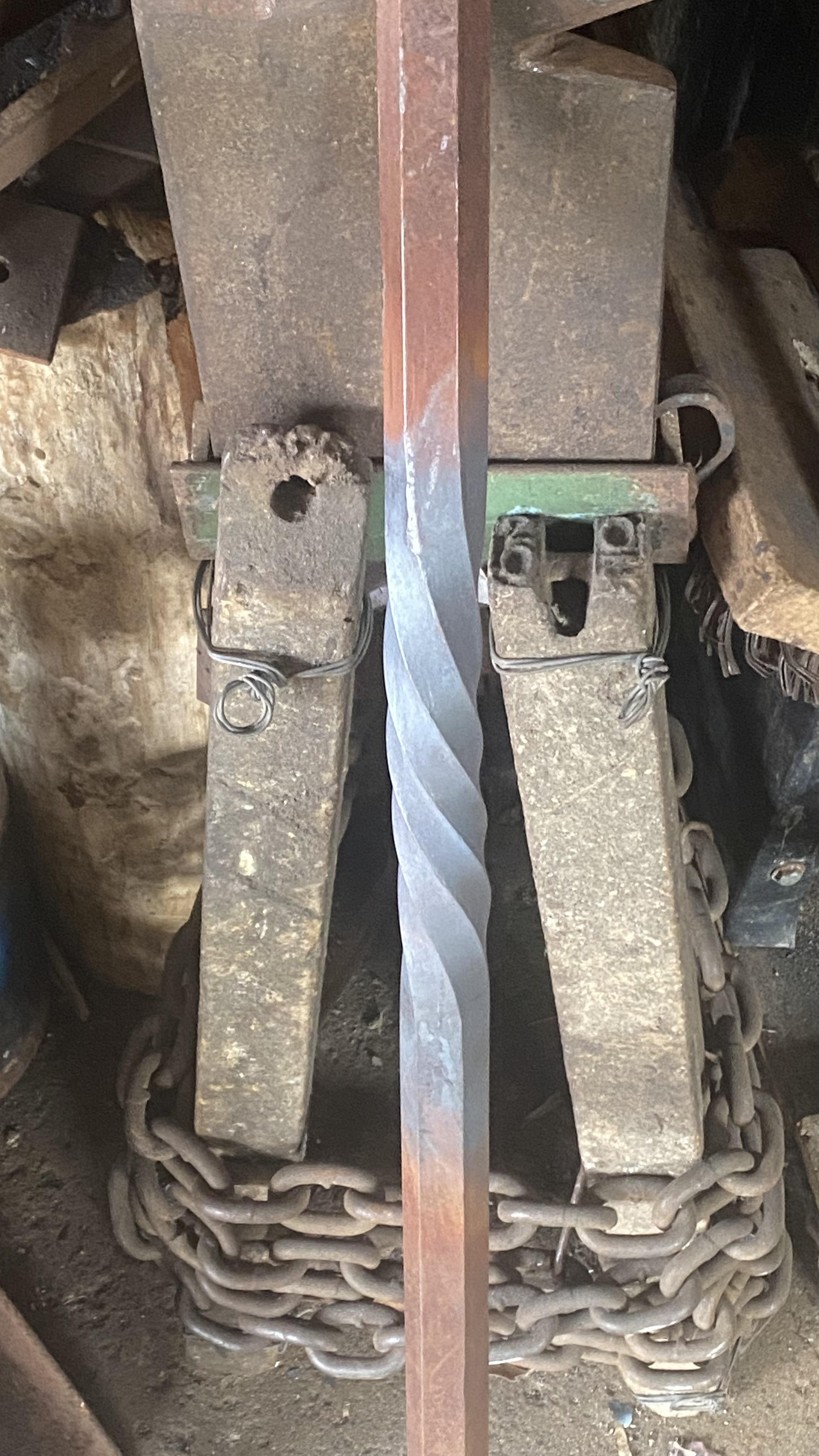

I have; in fact, I’ve got a good bit of it out in the shop that I got at HGR. There was a bin of it labeled “Shafting” which I purchased in the hope of using it for tooling, but it turned out to be unhardenable and sparks like mild steel. Here’s a chunk that I twisted as a test piece (for a project that later went in a different direction):
I'm in camp frosty as well. Never seen a "normal" steel in hex.
Where i work they consider 1030 to be high carbon, at least for the machinery i run. I can get hex in just about any material from the 1018 to aluminum, brass, and even nylon. Although nylon i would guess does not forge very well and i hate machining it.
We used to use almost exclusively 12L14 when we would run steel unless of course it was SS, then it is 303. Many of our customers are transitioning away from the 12L14 becuase of the lead so we are starting to see a whole lot more of the 1018 and 1030 coming into the shop.
I have 1117 in hex bar, and some 1215... along with some 1141/44. I have seen 1018, 1045, 4140, not including the Lead bearing steels (like 12L14) from one of the places I get metal.

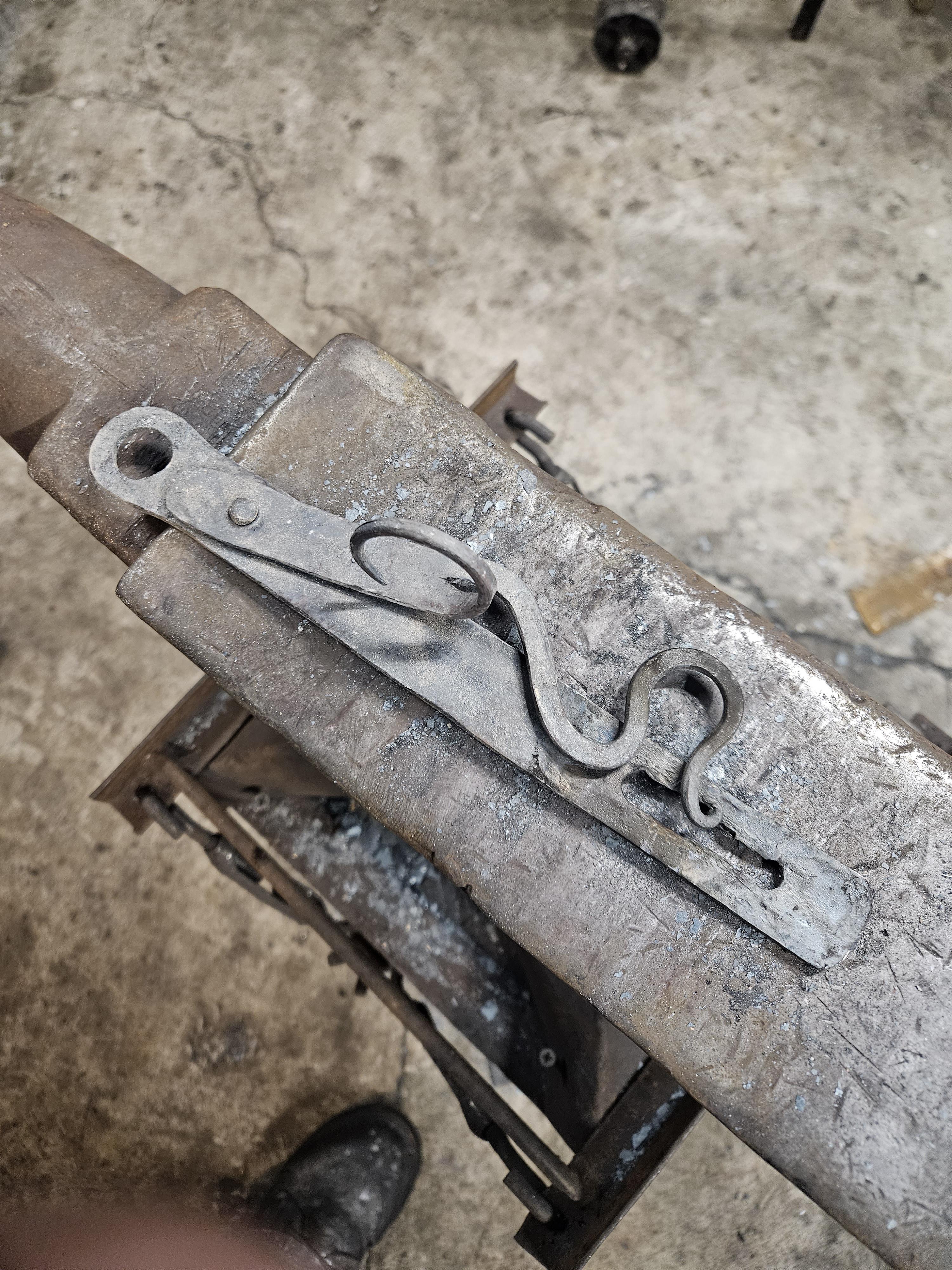

Any way also got my benches cleaned off and tools put away, did some general cleaning. Got a bit of forge time in and got the business end of a cabin latch done. Needs a bit of file work and the bales i will make tomorrow.

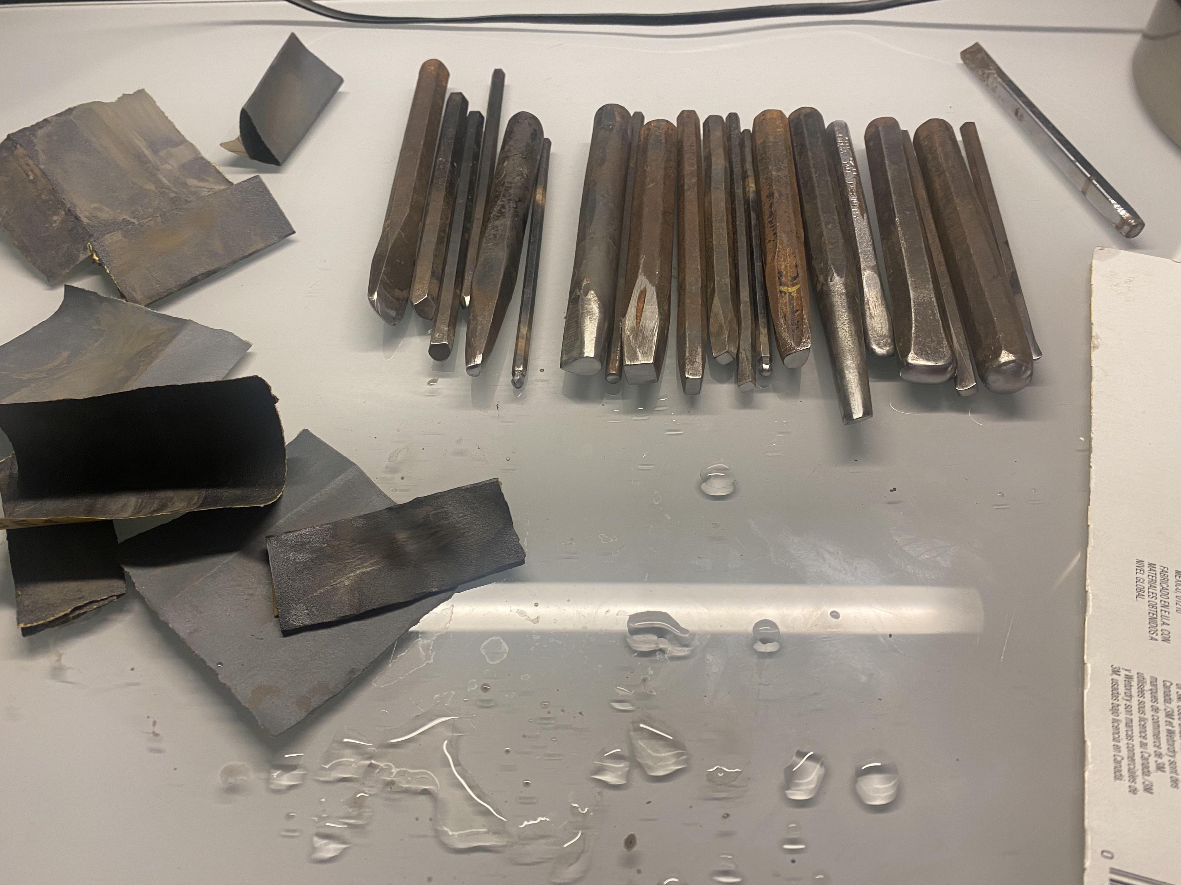

Hello!

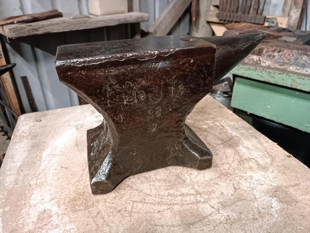

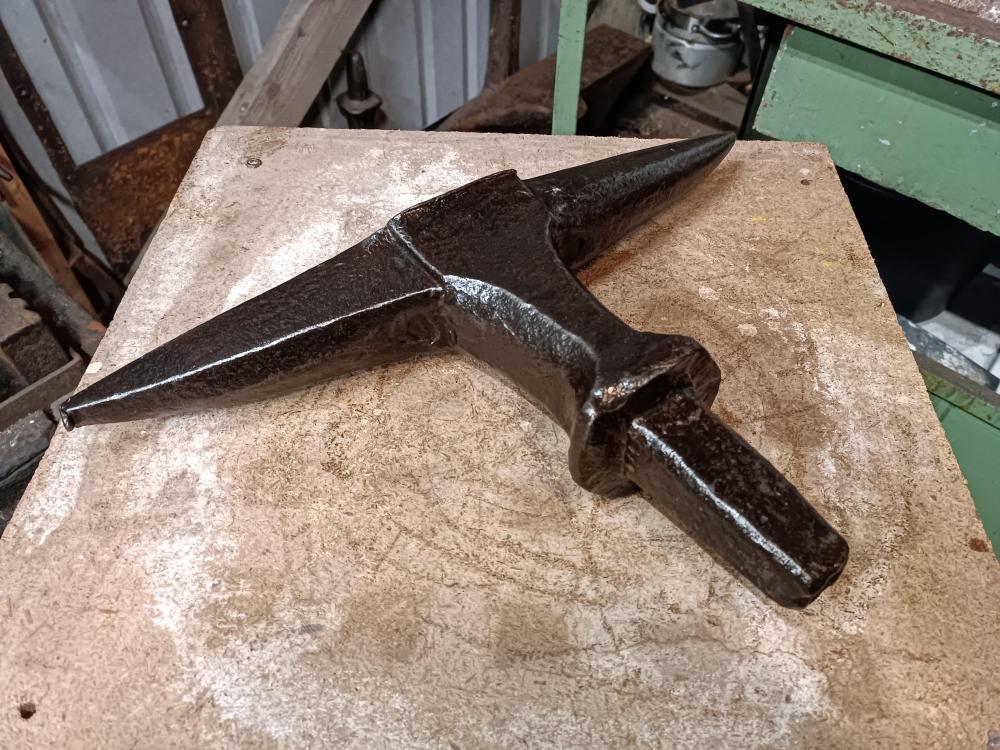

As it is currently around 0°C in my unheated shop and the fire alone doesn't warm up the machinery and tools enough to forge, I thought I'd tackle the cleanup of multiple anvils, that need derusting and oiling up...
I started with a stake and finished with a smaller anvil by H.P. Winterhoff:
Cheers!

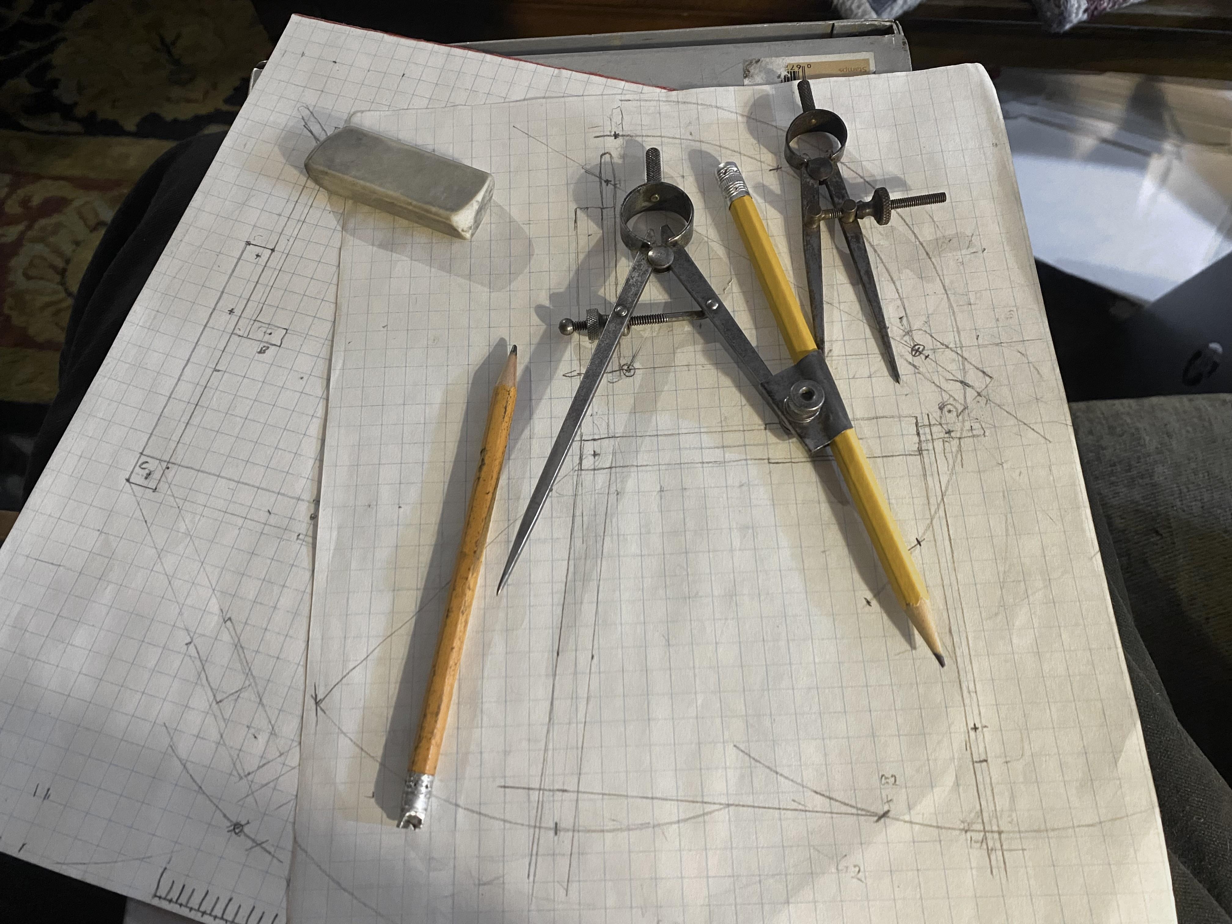

Too cold to work in the shop (although it did get up to a balmy 7°F this afternoon), so stayed inside and did some design work.
The dogs were unimpressed.
