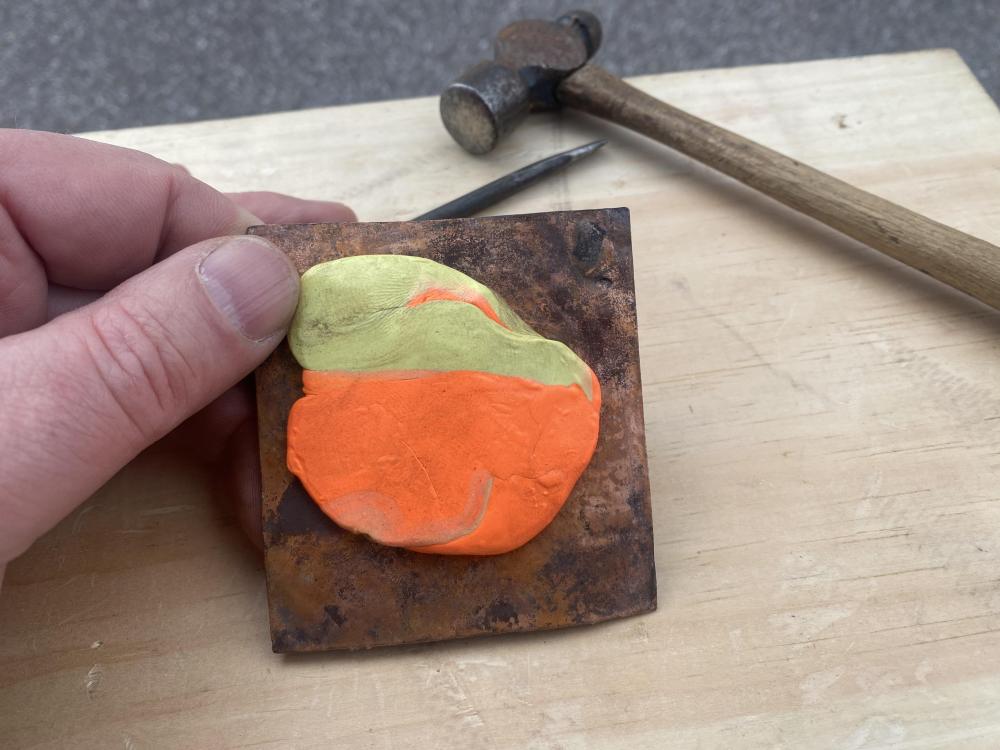

A little Repoussé on the Road, experimenting with a travel alternative to chaser’s pitch: Silly Putty!

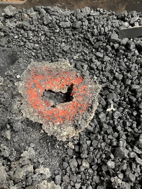

Well, at least I seem to be good at making clinkers:

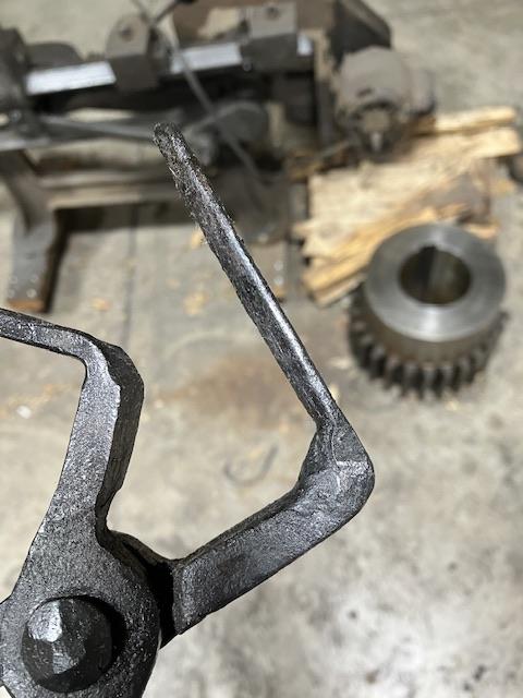

I also learned to torch weld! I broke the bit on my bent jaw tongs, which was bound to happen. So I fired up the torch with a welding tip on it and used some 1/8” CRS as filler rod and welded in a big fillet:
I’ll probably have to do the same thing to the inside jaw before too long… I was surprised how easy it was to weld with the torch! Similar to Tig welding, but at least for me, not as graceful. Not sure that graceful is the right term, but it kind fits(?).

nice weld! it sure looks like it'll hold. torch welding was the first welding method I learned and I'll say the hardest part was learning to adjust the flame just right. I feel like the puddle is a good bit bigger in torch welding than in any other type unless you've really got the amps cranked up so I found it much easier to watch and learn how it moved.
while torch welding is mostly outdated there are several situations where that's the only option like when you're welding around some sensitive electrical equipment or can't get electricity to where you need

I haven't done any gas welding since buying an oxy propane torch, the velocity of the flame tends to blow the melt out of the puddle which makes for lousy welds.
If you can gas weld learning to tig weld takes a couple minutes, mostly getting used to tiny, shallow puddles and speed to heat. It's a skill anybody who fusion welds should have, even if it's just a step to becoming a good welder. The cause and effect is very visible and slow enough to really grasp what's going on.
IIRC adjusting a gas welding flame was just getting a decent cone. It's been a while though.
Hi all, I've been gas welding since I was a kid, I tend to mig weld more now though for thin metal. As Scott said flame adjustment is very important. You want a neutral flame, just google that term, and the correct size tip for the thickness of the steel. For example 22 gauge use a #00 and 1/2 inch #8 or more. If you don't have a book with tip size and gas pressure requirements I'd bet it could be found on line. Just as important is the gas pressure, to much or little will cause unbeliveable frustration! If you have single stage regulators as the pressure in the tank drops you will have to addjust the regulators once in a while if it's a long job. It is very easy once you get the hang of it to adjust the welding heat by moving the torch tip closer, further, or faster. I also like to use the gas welding tips to heat shrink dents out of sheet metal like fenders as it is so easy to control the heat also to braze cast iron. Gas welding is a good skill to learn I would still do more of it if acetyene wasn't so pricy these days. Hope this helps, if I had time I'd fire up a torch and taake pics of flame types. Lake Superior is being generous with lake effect snow today. Happy welding!
Direwolf, thanks for the input. I do have the guide that came with my torch set. I used it as I initially setup my torch, but didn’t even think about reviewing it for welding. I just put the middle size tip on, adjusted the flame to what looked right (based on the discussions here on tuning gas forge flames) and gave it a try. (It helped that the first welding I learned was Tig welding on tool steel for stamping die repair.)

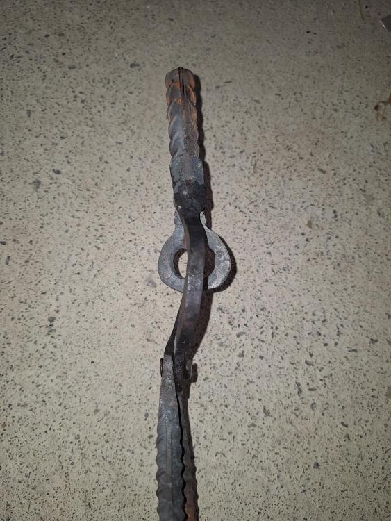

I was working on bottle openers for my son's work team's Christmas presents today and decided I really needed some bolt jaw tongs to fit around the opener section so I roughed these out of some rebar. They're only out of 1/2" so they're very light duty tongs but they seem to fit well.  I put an offset in them as well, just because I could!
I tried something different for the bits, this time.  Instead of chiselling a v, I flattened out the ends into a flat rectangle, then I held one side of the rectangle in the vice and hammered the other side over to make an almost 90 degree angle. Repeated for the other bit and then, when I had them riveted, I hammered them around a piece of round bar to align them.
Not what I originally planned for the day's session, but I'm quite happy with the outcome. Now I just have to grind the texture off the reins. (And get some other stock apart from rebar!!)
Cheers,
Jono.
Hefty, i have some tongs that i made jaws for then welded on rebar reigns. I have found that when doing that not to take the nubs down all the way, just enough to make them comfortable. I do not know about anyone else but when working i find my hand slipping towards the jaws. Leaving the nubs gives me "traction" on the riegns to prevent that.
You may also want to check out JHCC bottle opener tongs. They open backwards, kind of like external snap ring pliers when you squeeze the reigns the jaws open rather than close. They hold the bottle opener by the inside of the loop.
Thanks Billy, the traction advice is good and I'll check out JHCCs tongs.
