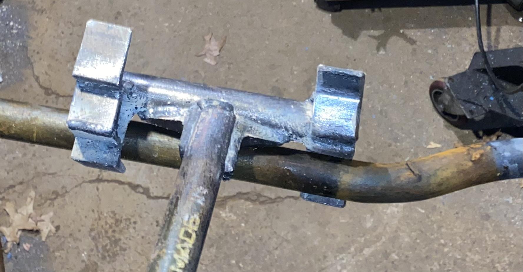

14 hours ago, JHCC said:
I’ve got an idea for a different design that might work better. More to come….
Not the idea I’d originally had in mind, but this came to me all of a sudden, and it seems to work well.

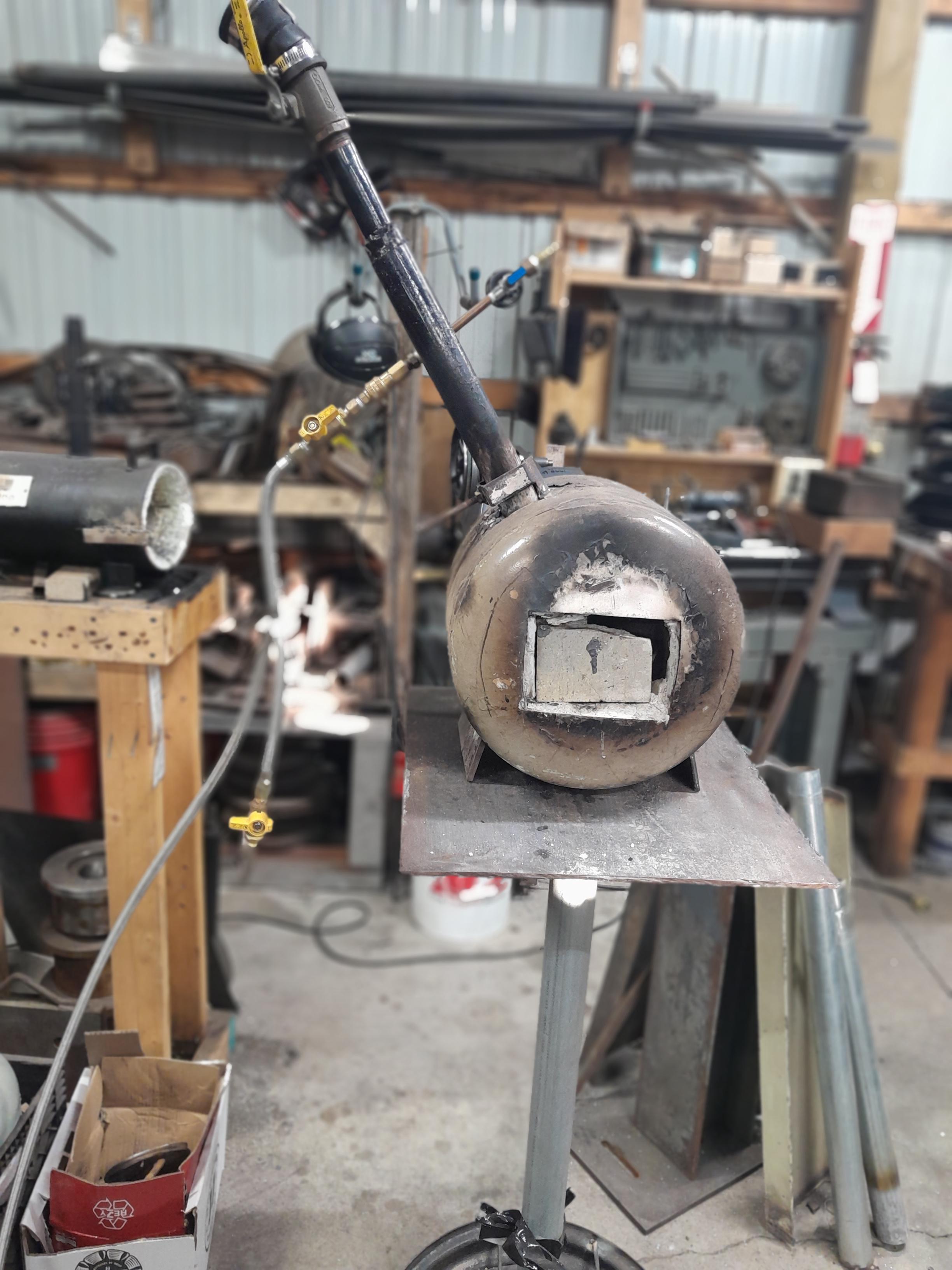

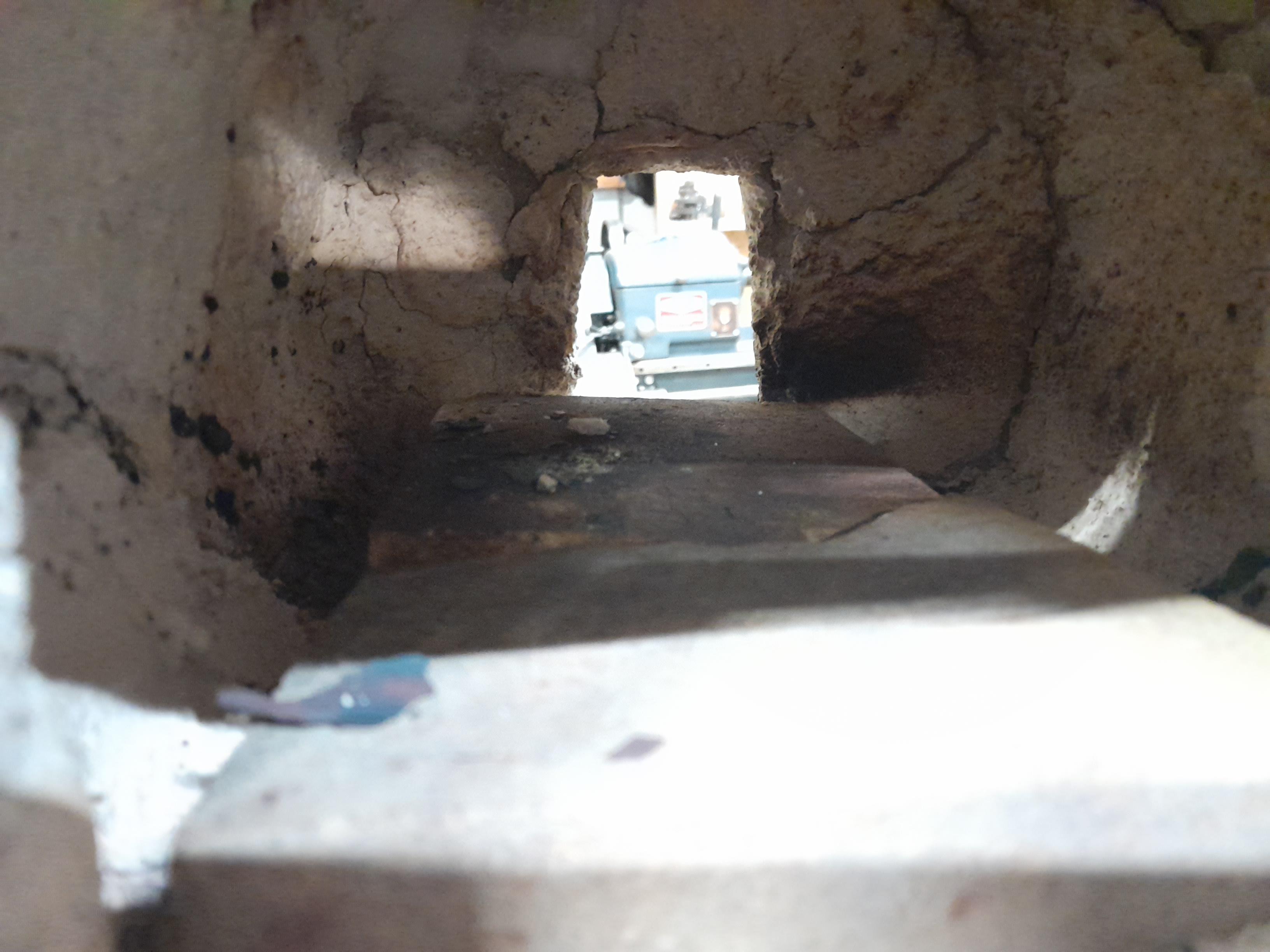

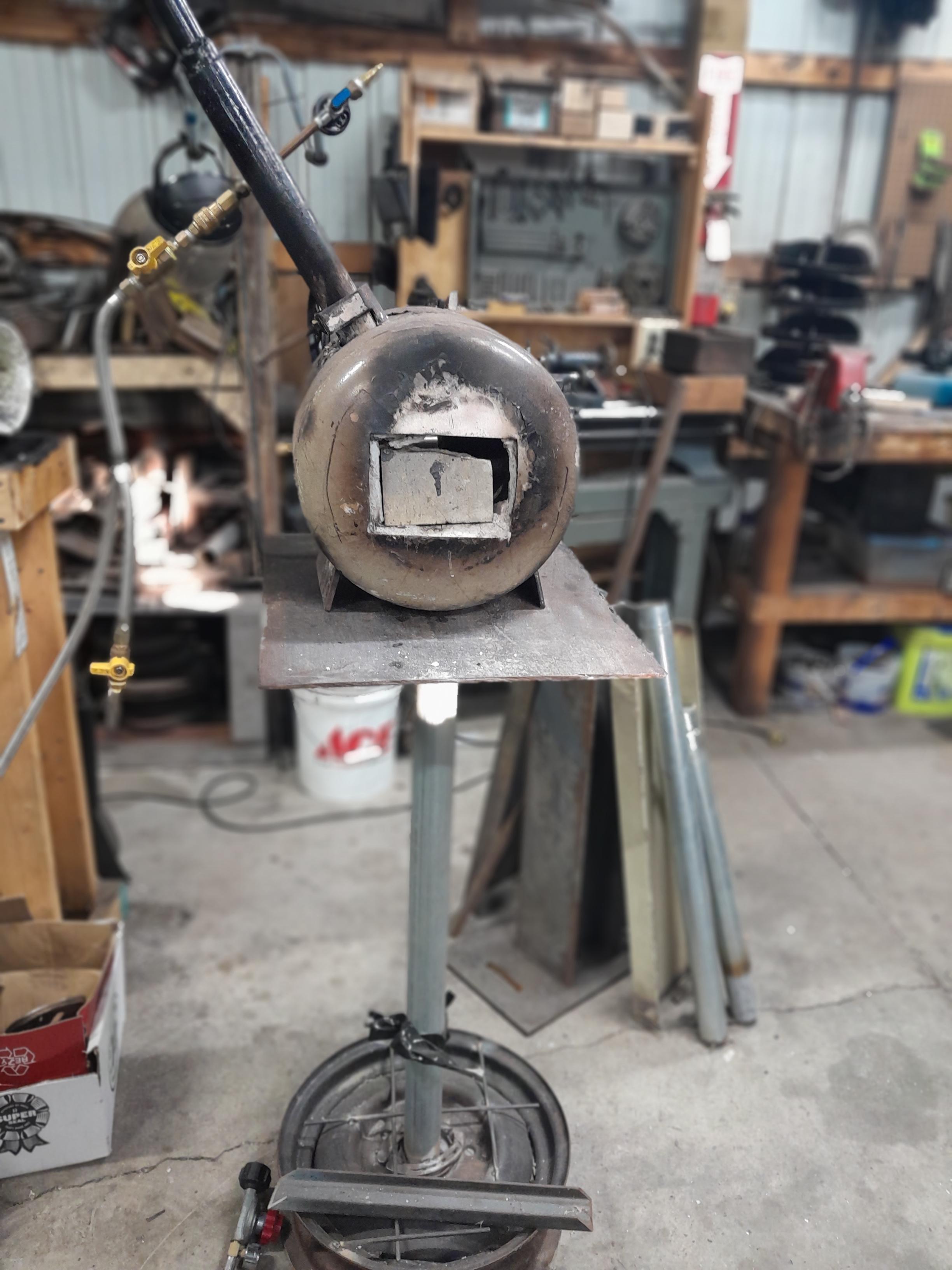

I almost finished my dual fuel forge. Got it running smoothly on lpg and forced air but the liquid fuel still needs some fine tuning.
I got a stand built for it out of a steel tire rim, 3 inch round pipe and cement. I would like to make a stand for the liquid fuel so that it can stand freely and be gravity fed. I did need to re-refractory the forge because my cat knocked it off my bench while I was prepping legs for it. Besides that it runs nicely and geats up relatively quickly. My pressure dial for the lpg is slightly off so my best guess is it's running on 5-6 psi which is better than the 14 psi my venturi does. I'm going to build a foundry and annother forge of some kind in the future but this one will suffice. Should u paint it with heat resistant paint? I found some rated for 1800f if I remember correctly. If so, color suggestions? Cheers!

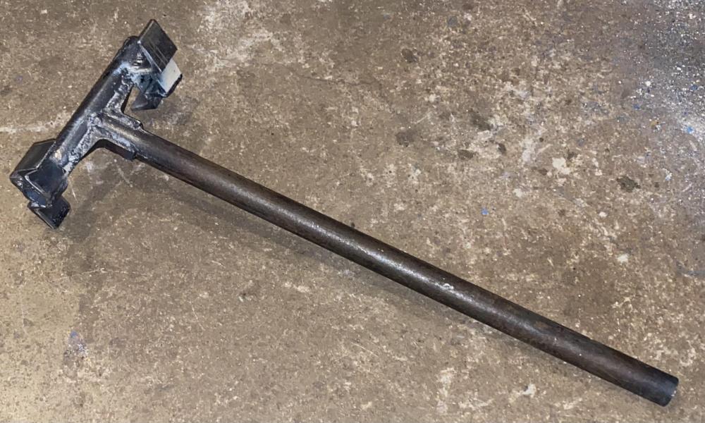

JHCC, i was thinking about your bender at work and i was thinking add a handle so it is kind of an "L" shape, but not at the end. Kind of like one of those police baton things. The handle maybe between the 2 "jaws" (not sure what to call them) and holding with the left hand, well i am right handed, bend with the long handle with my right hand.

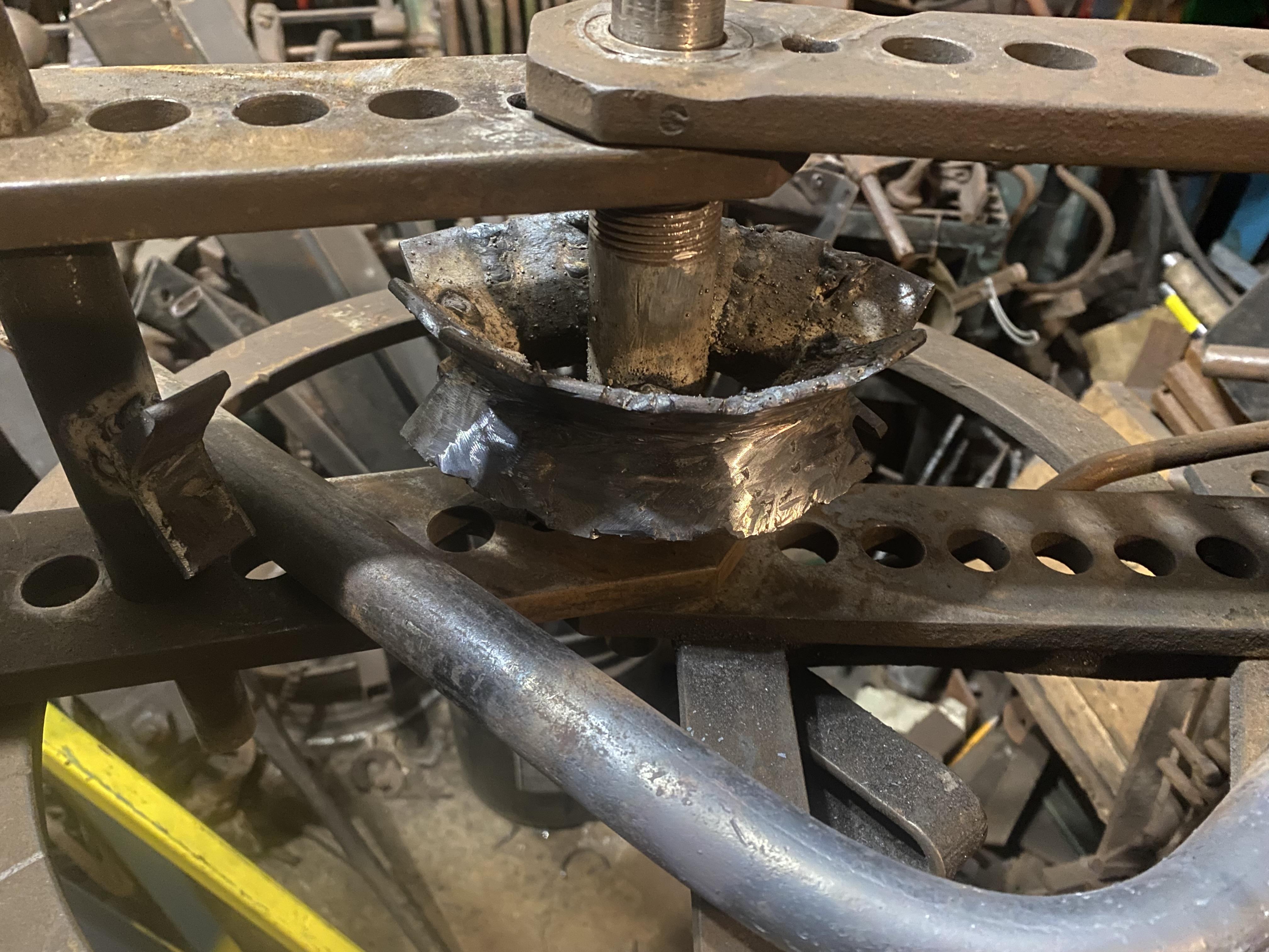

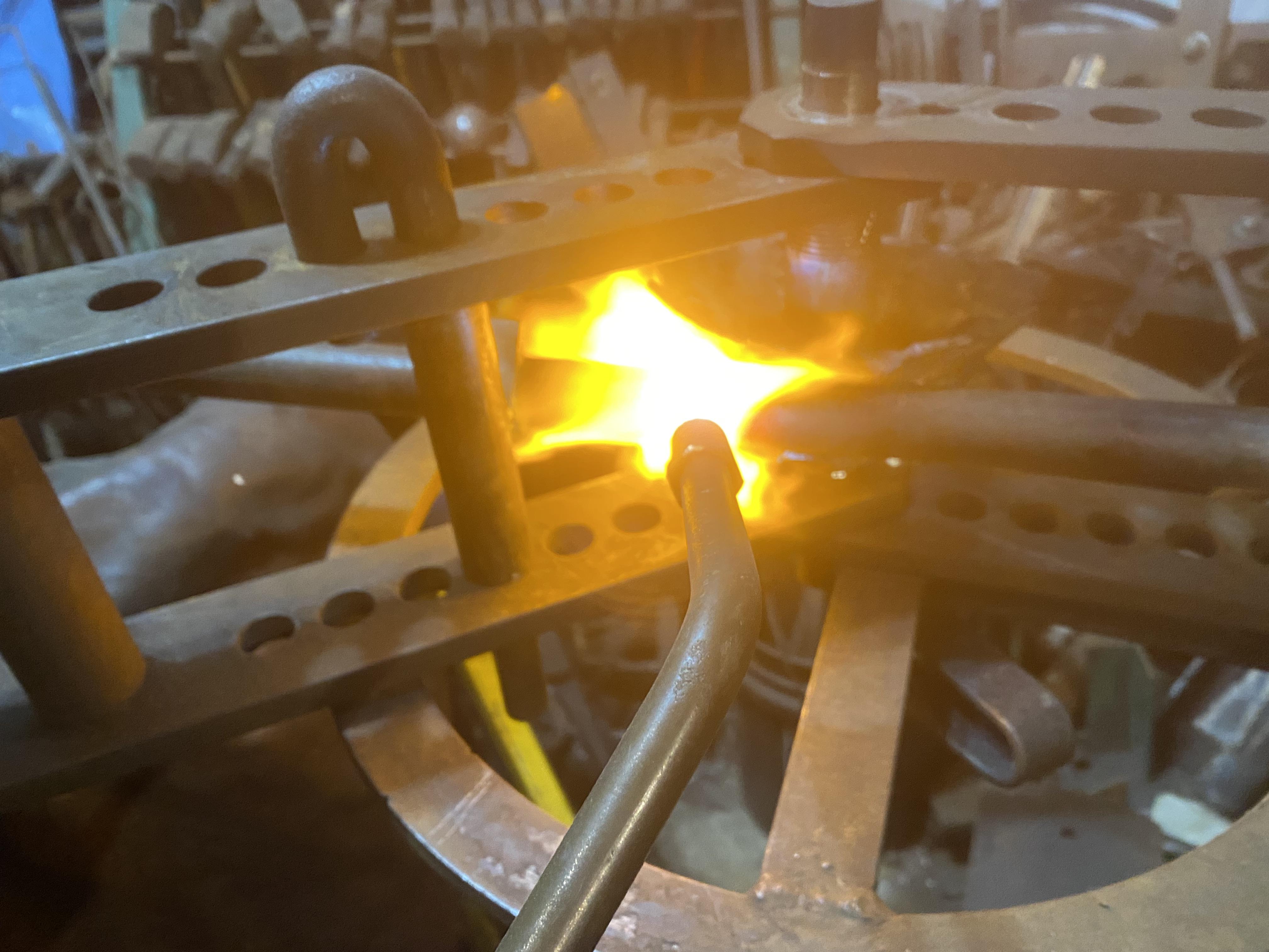

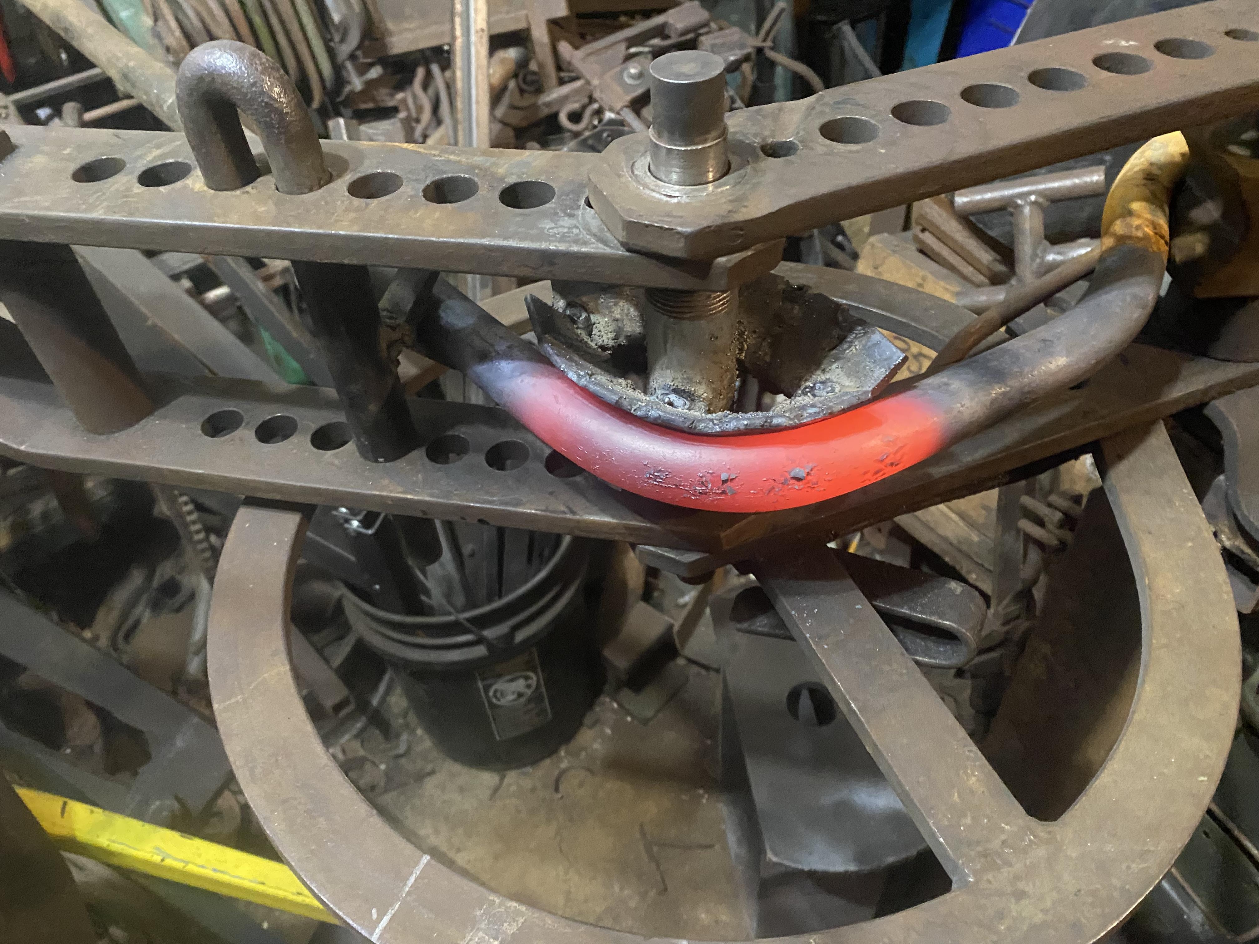

Finished welding up a radius jig for hot-bending pipe on the Hossfeld. Needs some tweaking, but it’s a good start.
Interesting, though I'm curious John, are you hot bending the pipe on the Hossfeld because you don't have the pipe dies or is it that you're trying for compound bends that are too difficult to manage cold?
--Larry
Both. I also don't have the hydraulic kit necessary for bending schedule 40 pipe cold.
I had good luck hot-bending 1/2" x 2-1/4" flat bar for another project, so this is an extension of that technique.
Makes sense, thanks. I don't use mine all that often, but find it a remarkable tool. Sometime back I stumbled upon a Diacro #2 which I think will be a nice compliment to the Hossfeld #2, but the Di-Acro has turned into a challenging restoration project... https://www.fahnoetech.com/this-old-bender/ Who knows how long it will take to complete! :huh:

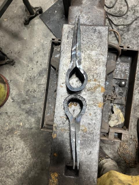

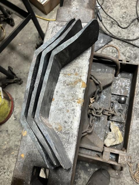

I started 3 hawks for a last minute Christmas gift commission. Preform is done:
Of course I have to go in and order more material for the bits… I didn’t realize I was so low. Maybe I’ll just use a worn out rasp. I have a few of those lying around, and time is important here! (It just make me uncomfortable changing the formula)
Keep it fun,
David
David do you account for the taper of the handle in your preform?  I can see you have nice sharp but joints for your weld scarfs..
Yes, the edge from the sharp corners are square to the top. There is 1/8” different top to bottom for the length of the eye.
I know the outside radius is fairly tight now, but after I forge the weld down I’m planning on 1/2”~3/4” radius smooth transition there.
Keep it fun,
David
Great job. Few people account for the radius difference.
While I appreciate the extra steps you went thru in your preforms and have done the same thing in the past.
I've found with mild steel it's not needed.
Something not shared nor talked about is upsetting via drifting to create the finished seam.
Yes, yes. I understand.  Having a method that gives you results desired is A#1.
With this there are progression steps that can be eliminated as a time savings once figured out.
By drifting the eye to size it tests the eye weld and finishes that scarf.

JLP, nothing taken as a negative. I like hearing different opinions and approaches. I’m still working my process out, maybe one day I’ll be happy with it and faster. Right now I’m painfully slow at it, but I’m going for a particular ascetic.
Chad, the layout work on these aren’t bad. After I recalculated the dimensions, (this time I wrote everything down) I scribed the center line, measured out and ctr punched one side of the top of the eye, then measured the eye width across the center line and ctr punched that. (I get a more accurate final width measuring from mark to mark than separate measurements from the center line.) Repeat for the bottom of the eye. Then it all forging…

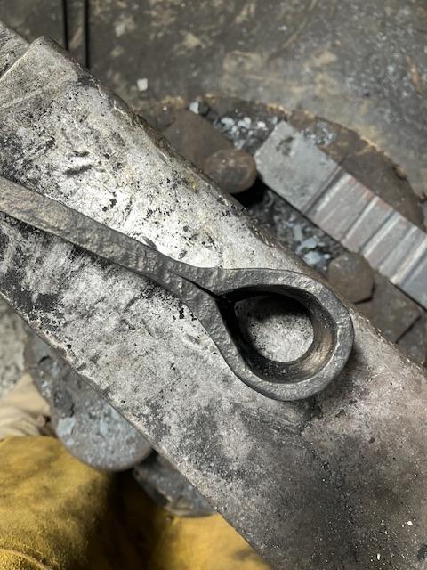

Well, it looks like I messed up. I forgot one key piece of information. Add your material thickness measurement to that of the handle when doing a wrapped eye like this!
The eye is way too small! Broke the weld trying to size it, and lost some of the transition shape I was going for trying to re-weld it. At least I think you can see the general shape I was going for in the transition.
Now, I’m going the have to rework the next two to get the right length for the eye:IMG_0745.jpeg.9e231fbfde61a36b7bc6db1ee2a1ecc2.jpeg
I’m going the have to open them back up and I’ll probably grind the set down back 1/8” on both sides. (I may even start another blank in case I mess something else up.)
I really did not need this set back with the time constraints! Another hard lesson learned…

goods, sound logic that you have to account for that. Probably would made the same mistake as you did.
