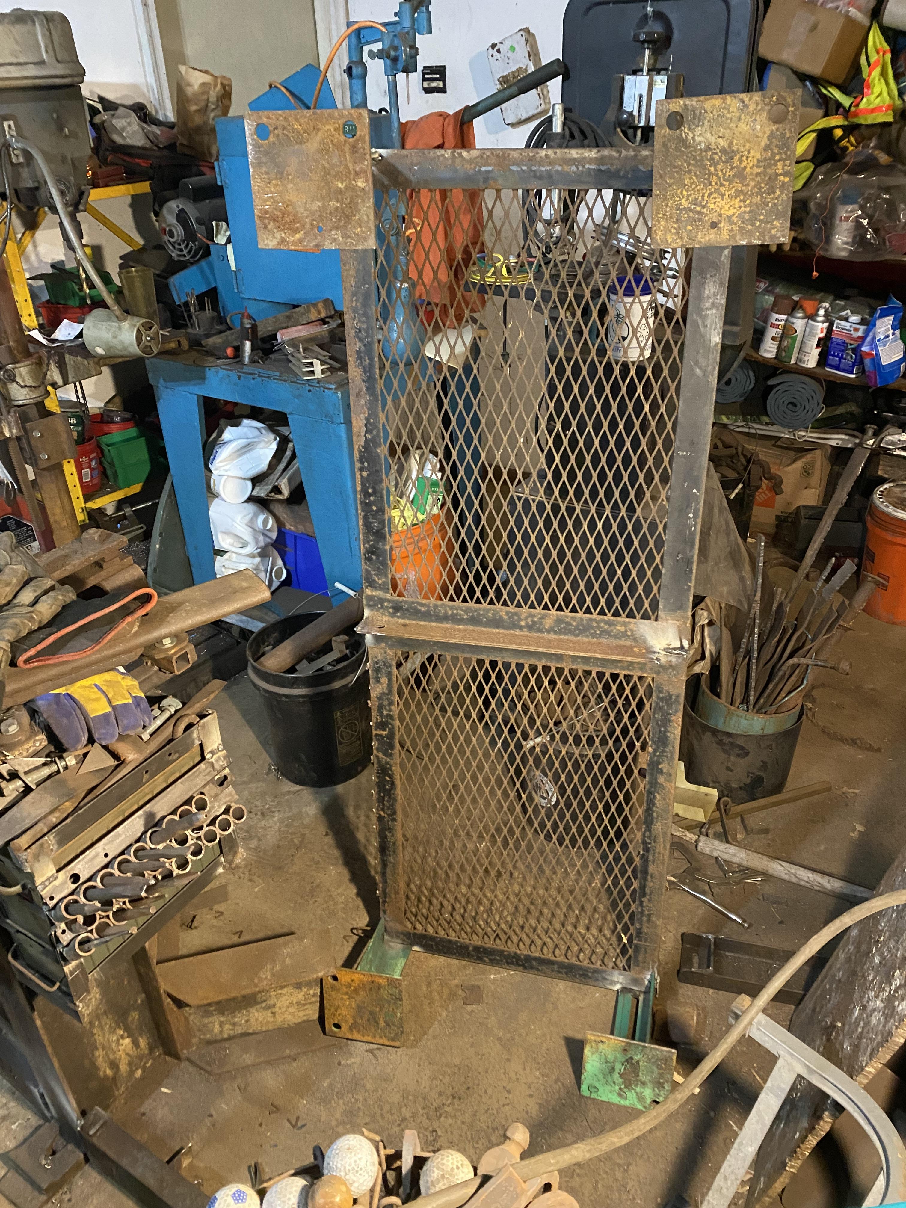

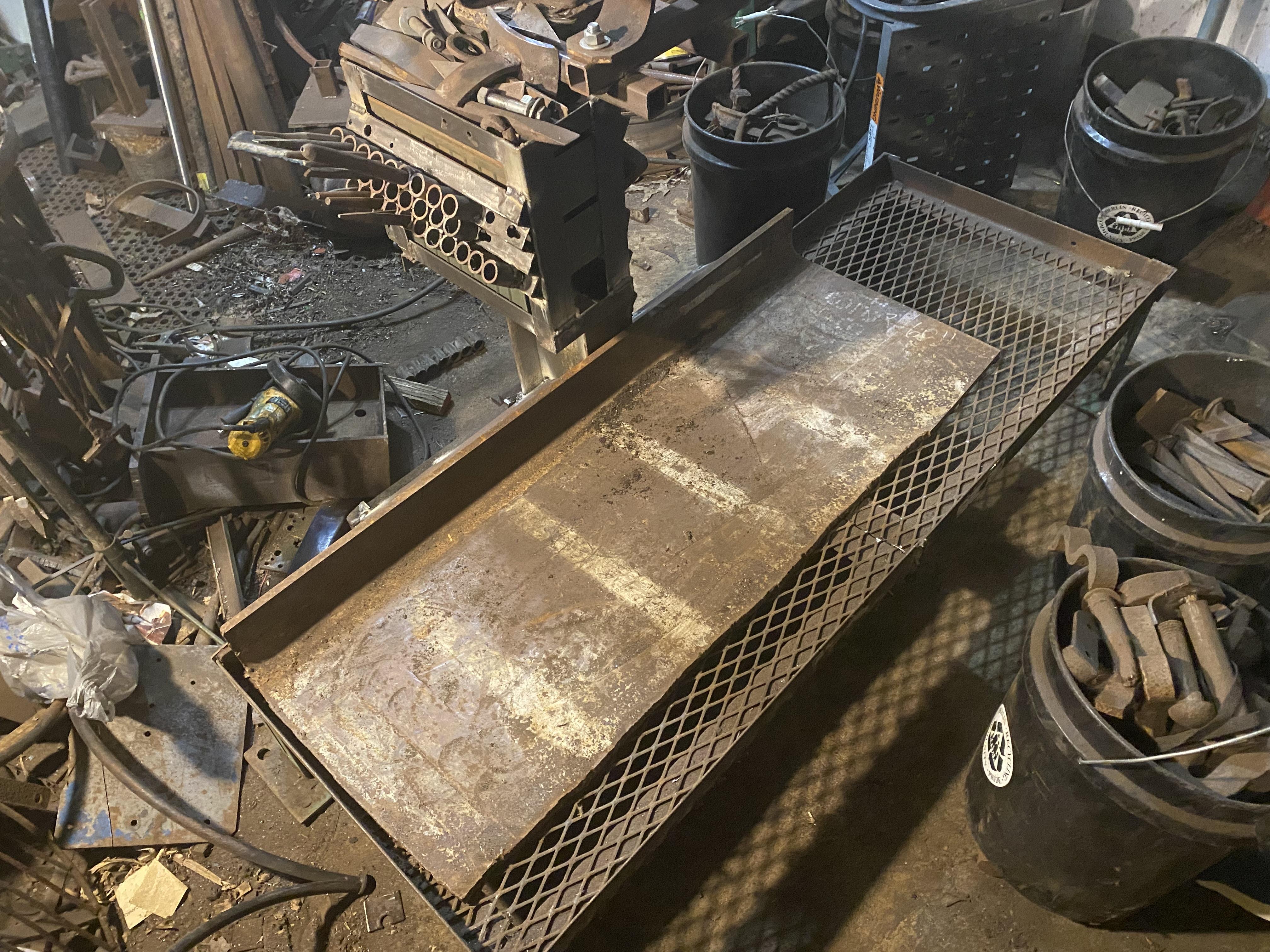

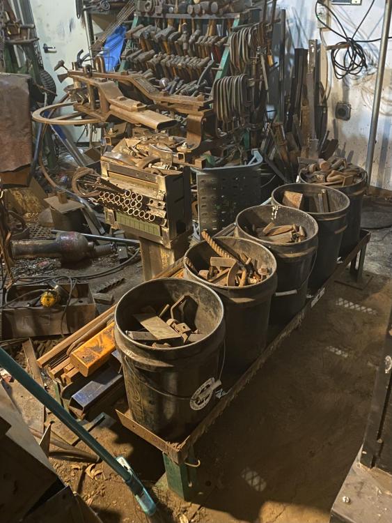

JHCC Posted December 30, 2023 Share Posted December 30, 2023 Buckled down and dug into a big shop project I’d been putting off for some time: rebuilding the stock storage on the back of my vise/bender/shear stand. This first involved adding a pair of broad feet to improve the stand’s stability. And then welding up a low table from two halves of an old cargo carrier and a few bits and pieces that turned out to be perfect as its feet. This whole thing sits down on the I-beams on the back of the stand: To this is added a big piece of plate: Along with several buckets of scrap and quite a lot of bar stock, leaf spring, C-channel, and shafting: I also welded on some 1/8” plate to the front, both to serve as bracing and to keep the underneath from reverting to its former status as a junk collection zone: And while I was at it, I welded some brackets onto my bench vise stand, to hold my big bending forks: With luck, the twin problems of the stand moving around too much and of the stock storage being inefficient and unstable are a thing of the past. Quote Link to comment Share on other sites More sharing options...
Jo_Bai Posted December 30, 2023 Share Posted December 30, 2023 (edited) Looks great JHCC Is this your normal everyday chaos or did you clean up for the photos? Edited December 31, 2023 by Mod30 Remove @name tag Quote Link to comment Share on other sites More sharing options...
Gazz Posted December 30, 2023 Share Posted December 30, 2023 Junk collection zone aversion - a noble thought. Now it will end up on the floor. Ask me how I know. Quote Link to comment Share on other sites More sharing options...

aaamax Posted December 31, 2023 Share Posted December 31, 2023 JHCC, those pics are dynamite and a shop to be envied. cheers. Quote Link to comment Share on other sites More sharing options...

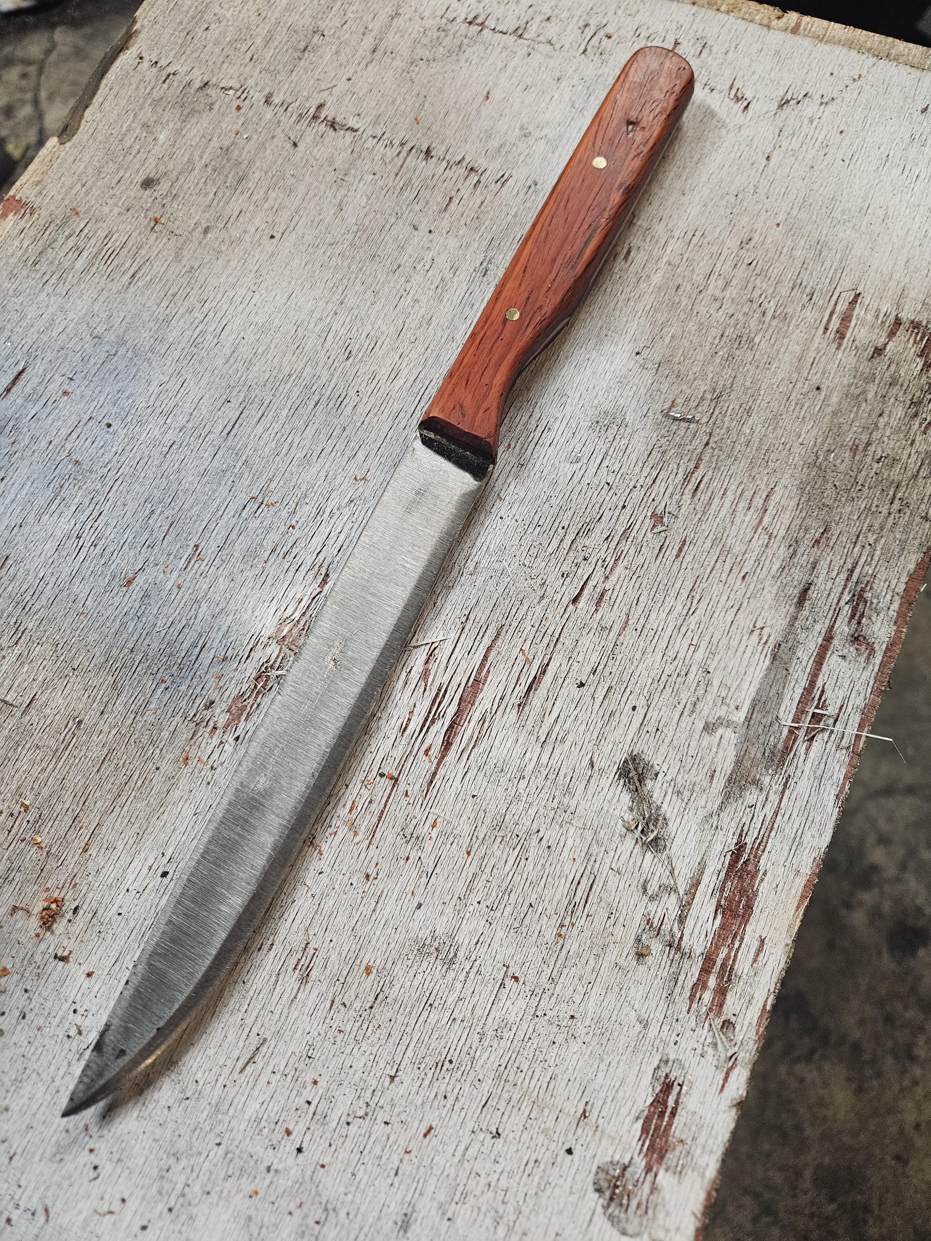

BillyBones Posted January 1 Share Posted January 1 Well, not being a bladesmith guess what i did today, made a couple knives. A freind asked if i could make him a couple steak knives. I replied i can barely make a knife much less a serrated edge. So we decided on a 4 piece set of i guess dinner or table knives they would be called. 1095 with 1/8" brass pins and padauk wood handle. This the first one, #2 i had to re-epoxy one side of the handle. I glued the handle on before the pins and when i drilled the holes one side came a bit loose. Blade is ~8" and handle maybe 5 or so. Quote Link to comment Share on other sites More sharing options...
White Fox Forge Posted January 2 Share Posted January 2 I'm not entirely sure either. I've seen seax knives both with swoops and without. I certainly wouldnt say mines a traditional seax lol. Your kitchen knife looks nice. I really like the shape of your blade. Hammered out two spike hawks today. These are my first ones. Once I get more practice with making these I'll probably sell 'em at some craft fairs. The eyes need a lot of cleanup and filework. I also need to grind the bevels. Does anyone know of a good way to make tomahawk handles from lumber? Quote Link to comment Share on other sites More sharing options...
