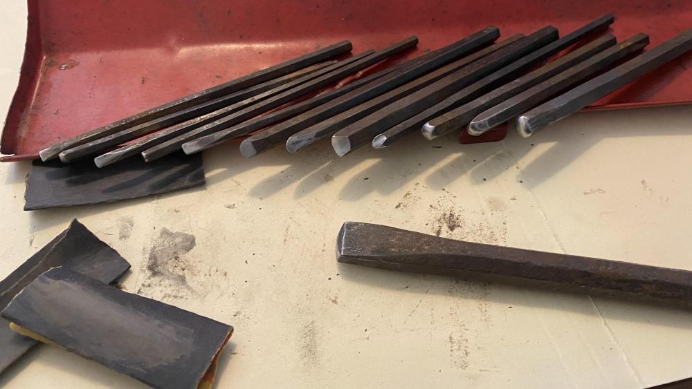

Some more chasing tool making.
Nice.

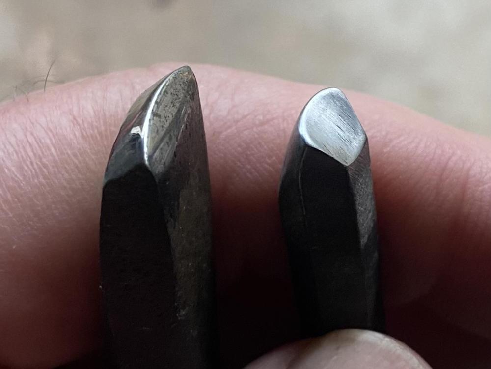

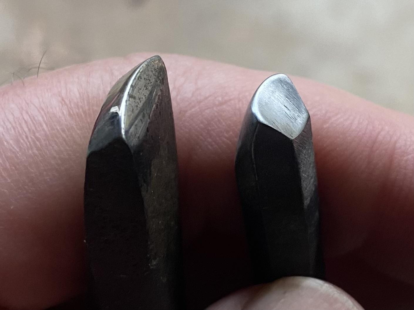

how do you go about making that crescent moon shape?  the only way I can make such detail is with a dremmel.
Edited by Mod34
Excessive quoting
There are two ways: one is to make a round bevel on one side of the tool and a flat bevel on the other (L), and the other is to make the hollow with a Dremel or an appropriately sized round file (R):
Douglas Pryor has a video about making the former kind of curved liner:
https://youtu.be/Q4Kbz5yz5XQ?si=In8INcr9UrL6XwAY

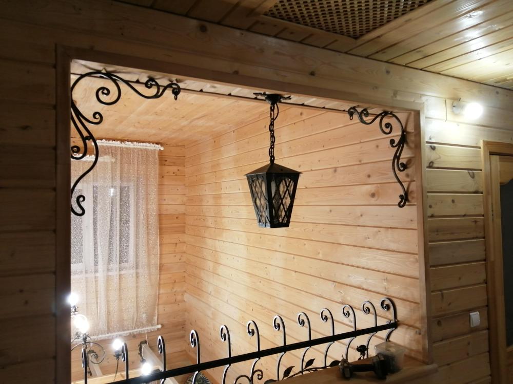

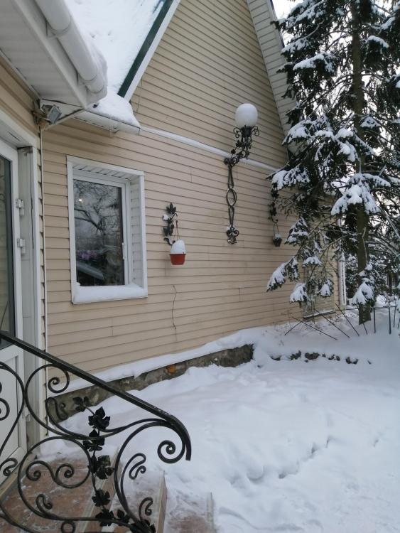

It got warmer, only -15 C.:D I can go to work.
The lantern on the wall is more than 20 years old.

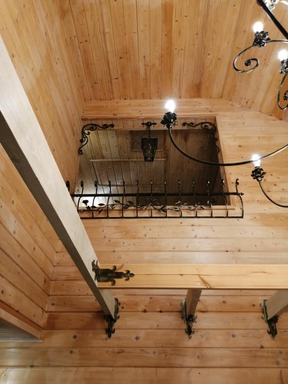

Alexandr,  I like those "fleur de lis" brackets on the beams. That's a nice touch.  But -13c is way too cold for me.;)

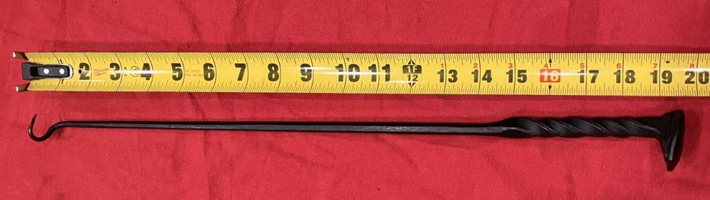

this afternoon, I forged out a long steak flipper for my neighbor as a Christmas gift for his brother. (It good to be kind to your neighbors!):

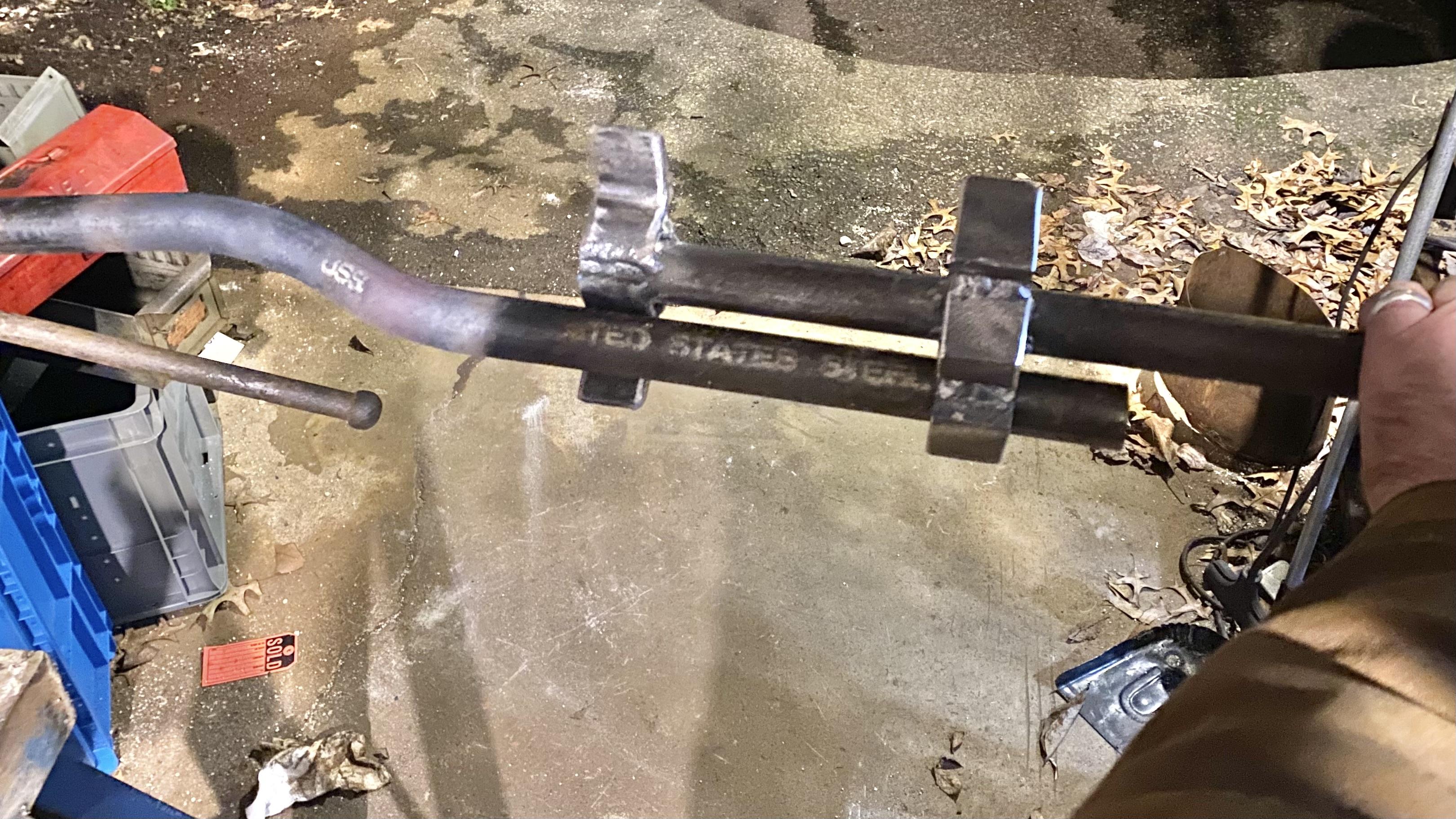

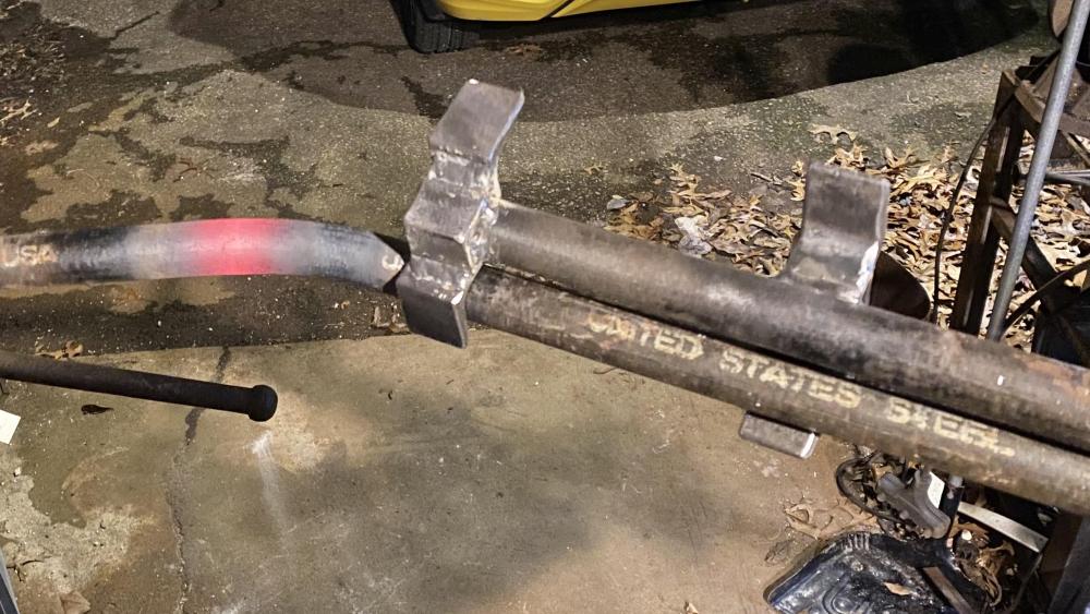

Spent some time making tooling for a commission. First, a bending tool for pipe:
 Which works both pulling:
 And pushing:
 And welded up a flatter fit the fly press, to turn round pipe into oval handrail:
I think I’ll use this to flatten the handle on the bending tool, for more positive alignment of the grip.
JHCC How can the bar be held straight without twisting with the lugs on the sides of the bar?
I looked into a bender like this 30 years ago and could never get it to work.. Maybe my hands aren't strong enough.. it always wanted to twist in my hand..
It does want to twist in the hand, and I’m hoping that squaring up the handle will help.
If that doesn’t work, I’ve got an idea for a different design that might work better. More to come….
Now that you have the flatter for pipe, slide an oval section on the handle and weld it up.
Jhcc. The one I made I put a jog in the handle. Aka dogs leg.
This helped but in use it still wasn't as accurate. .
Going with the jaws in line with the handle ended up being the best option use wise, but was lack luster so thru it in the scrap pile.

have you tried a leather or felt wrap around the handle it might help with grip. If that doesn’t work try making grooves that your fingers can sit in when you hold it.

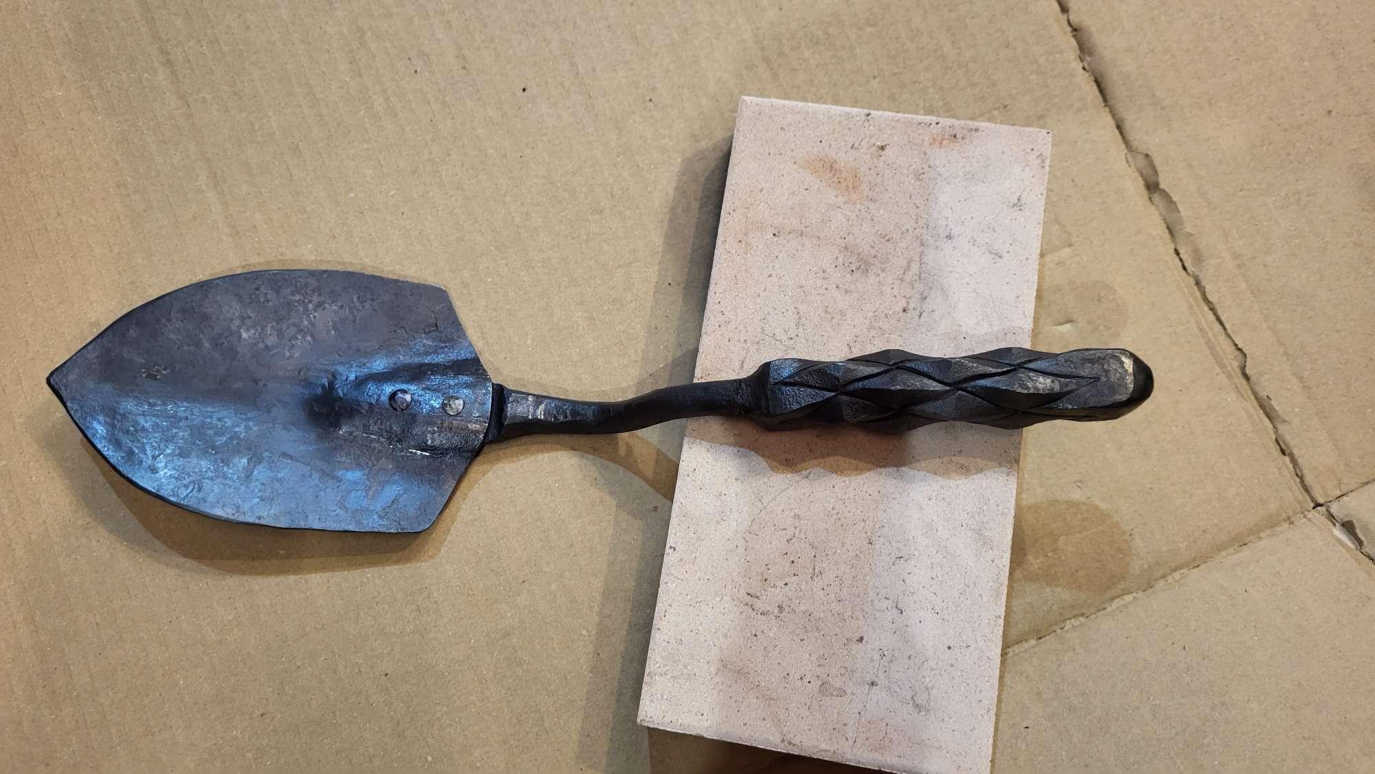

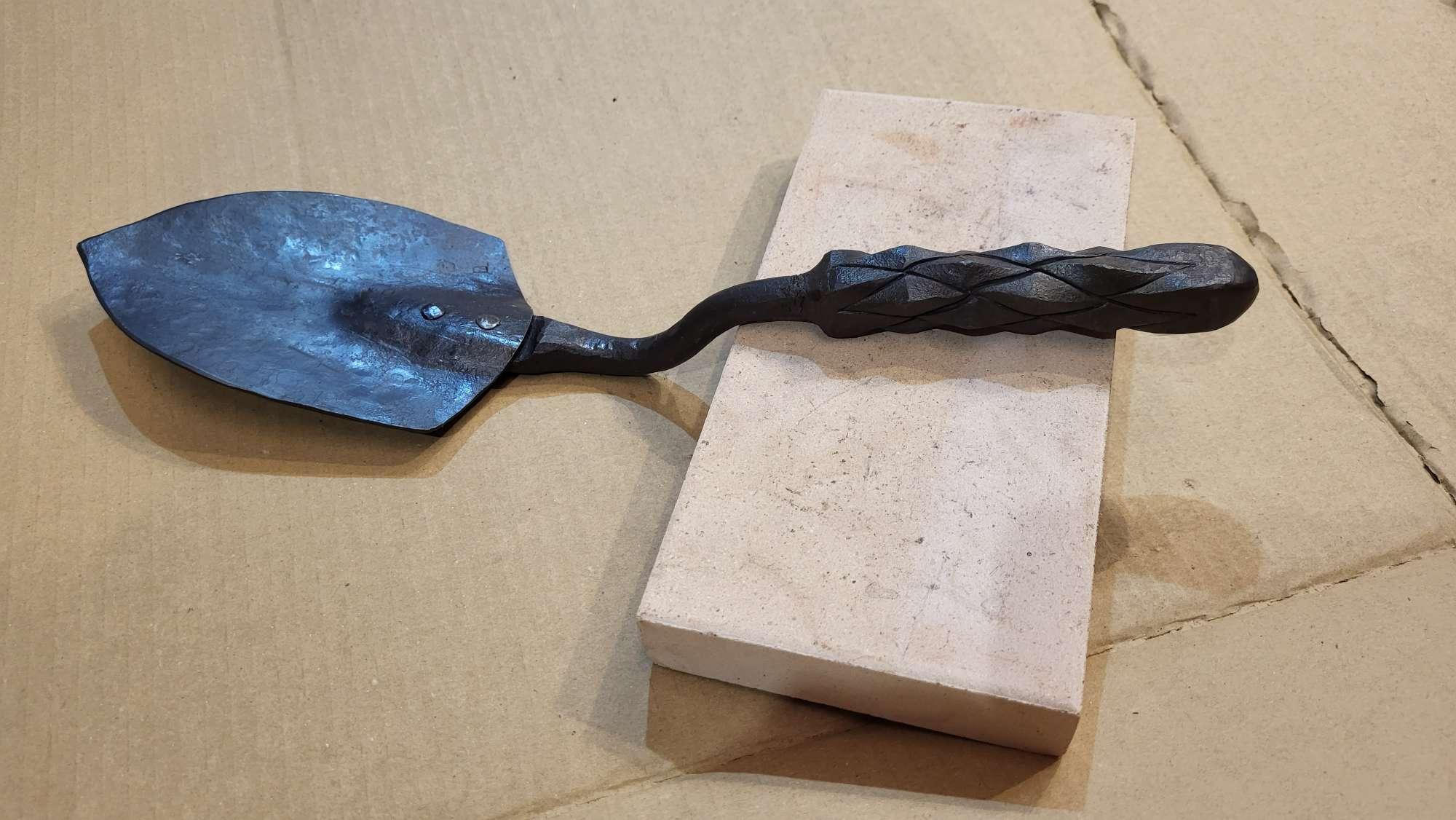

Finished the small shovel
Compress_20231212_000603_3470.thumb.jpg.d9cd40ceab6a4ee647ed8bf4cc8a7b40.jpgCompress_20231212_000603_3185.thumb.jpg.c8f1cf8ed410df288787d5f9e75600ca.jpg
Happy but some small improvements are needed for the next one.
Also not happy on ending the handle.
If this is designed as a garden trowel I would say that the planes of the shovel blade and the handle should be closer to parallel.
I'm with George, the bends in your handle are WAY too pronounced, a garden trowel should have a much flatter handle to blade relationship. (Parallel) works.
