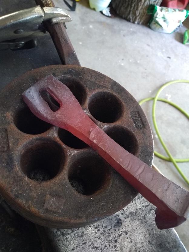

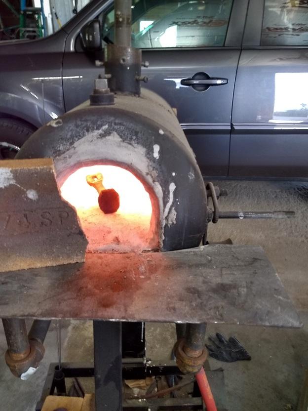

JHCC Posted July 4, 2018 Share Posted July 4, 2018 8 hours ago, Eophex said: Anything to keep in mind when forging bottle openers? The single greatest piece of advice anyone ever gave me about bottle openers was to make sure you have the same amount of metal on both sides of the slit when you first open up the hole. Sure, it's possible to make adjustments, but if the metal is equal on both sides, truing things up and shaping them evenly is a LOT easier. Quote Link to comment Share on other sites More sharing options...
ausfire Posted July 5, 2018 Share Posted July 5, 2018 (edited) And never a truer word was spoken! That would be my number one tip, too. Whether you start with a slit or punch a hole, make sure it is dead centre. If one side looks like getting a bit thin, all is not lost. You can correct it by cooling the thin side before drifting, but it's much better to keep it even from the start. Edited July 5, 2018 by Mod34 Unnecessary quote removed. Quote Link to comment Share on other sites More sharing options...
JHCC Posted July 5, 2018 Share Posted July 5, 2018 Also, do everything you can to punch/slit the hole cleanly. Ragged edges = more cleanup. Quote Link to comment Share on other sites More sharing options...

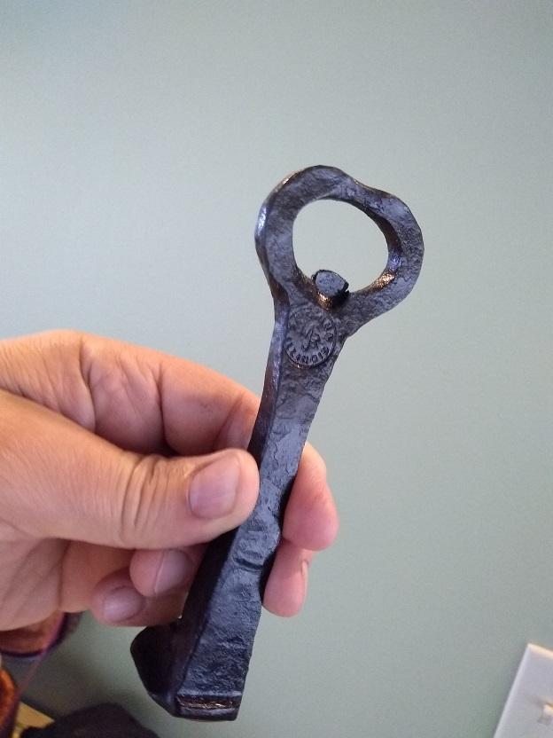

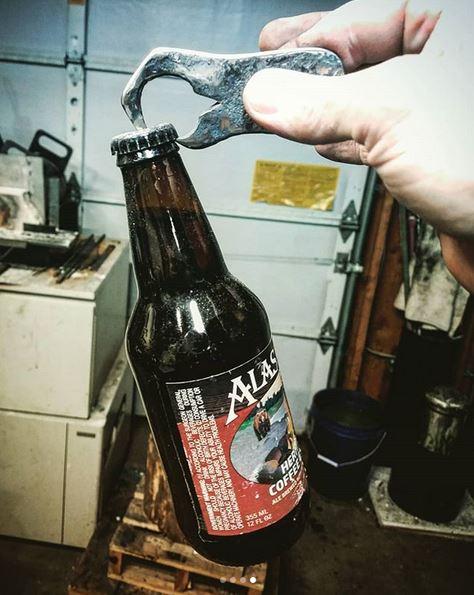

Gustav Posted July 5, 2018 Share Posted July 5, 2018 On 7/4/2018 at 10:52 AM, JustAnotherViking said: Each time you make one, make a mental note of what you'd like to improve/what didn't work/what worked well... next one, apply your observations. No magical formula, just practice, practice, and more practice. Yes that's working out pretty well when it comes to learning this craft! I made another one today: This one fixed some of the problems I had with the "left one". It's much thicker, it has a smaller "hole" and a wider "tooth" (what's it called?) so it can grip underneath the caps easier. It also works, which is a good thing As for all the things I forge, there are always things to improve and as you said, learn from the recent tries! Quote Link to comment Share on other sites More sharing options...

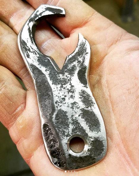

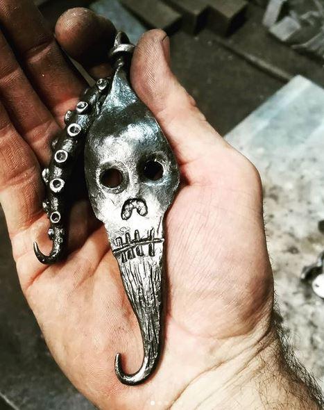

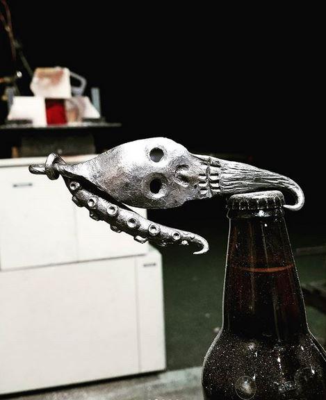

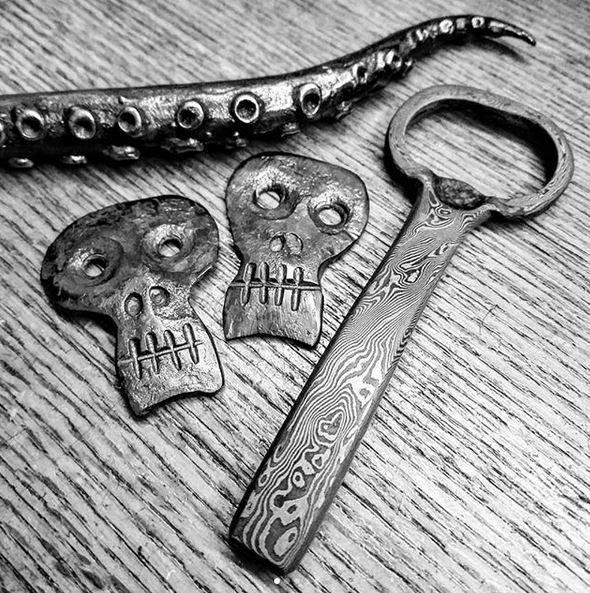

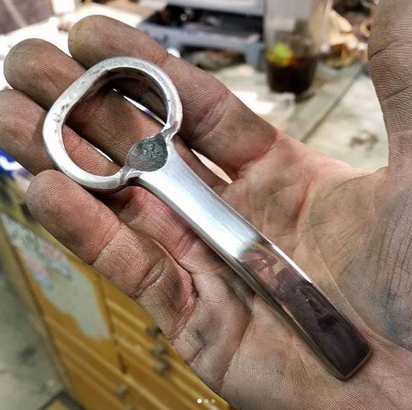

olydemon Posted July 9, 2018 Share Posted July 9, 2018 Finally joined up to share some bottle openers I have made. I've been a long time lurker usually ending up here looking for info on forges and anvils. The damascus one was my first attempt with making my own layered stock. I used band saw blades and strapping. The texture didn't end up staying so I polished it again as seen in the shiny image and later heat tempered it to a rainbow pattern. I didn't have a great image of that, but could dig it up later. The weird bearded skull/tentacle one was made as a response to a challenge from a friend to make a "Skull with a tentacle". I ended up giving it to him as a gift. The last one was made out of 303SS and it cracked on me so I went with it and made an opener I think looks sorta like a crab claw. I have access to 1" round bar in 303ss, but It was such a pain to forge i may just let the stuff go to the recycler. Quote Link to comment Share on other sites More sharing options...
tkunkel Posted July 9, 2018 Share Posted July 9, 2018 Olydemon, Nice work with your Damascus opener! Skulls and tentacle are pretty neat also. Could you explain how you did the texturing on the tentacle? Thanks for sharing. Tom Quote Link to comment Share on other sites More sharing options...

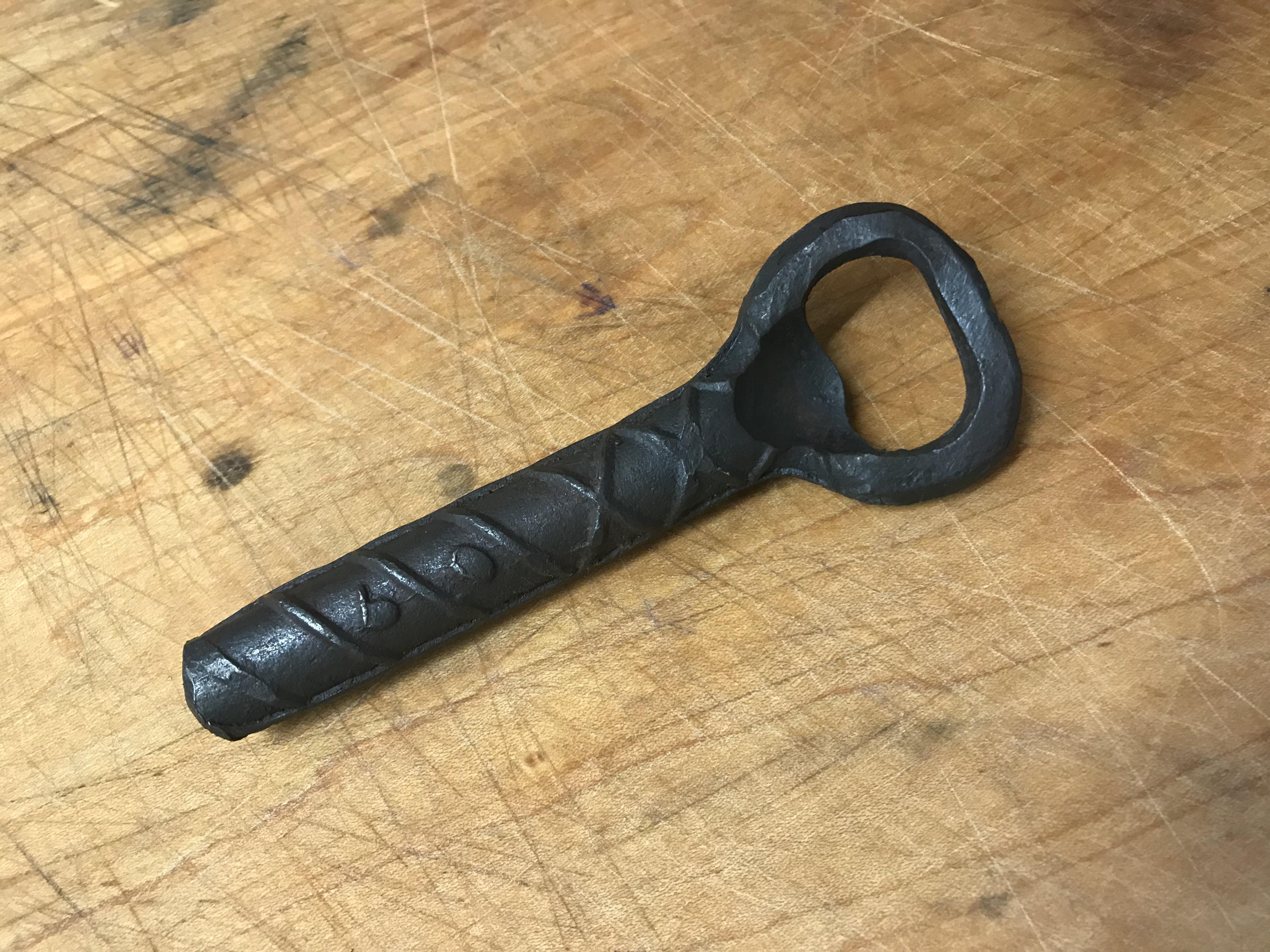

JHCC Posted July 9, 2018 Share Posted July 9, 2018 Another rebar opener, which ended up as a thank-you to the construction guys who last helped me out with some heavy scrap: 8 hours ago, tkunkel said: Could you explain how you did the texturing on the tentacle? I was wondering the same thing. Quote Link to comment Share on other sites More sharing options...
olydemon Posted July 9, 2018 Share Posted July 9, 2018 1 hour ago, tkunkel said: Olydemon, Nice work with your Damascus opener! Skulls and tentacle are pretty neat also. Could you explain how you did the texturing on the tentacle? Thanks for sharing. Tom Thank you! The tentacles I learned from a smith named Hanna Gutke through a YouTube video. . I'll post the video as here as her tutorial is pretty good and funny. Basic steps: Make taper, Mig weld dots, Punch dot centers. https://www.youtube.com/watch?v=giS_d4nu9VM Quote Link to comment Share on other sites More sharing options...

billyO Posted July 28, 2018 Share Posted July 28, 2018 On 7/8/2018 at 10:44 PM, olydemon said: The texture didn't end up staying Are you talking about the texture or the contrast? If the physical texture is what you're referring to, then you merely need to etch it longer. The longer it's in the acid, the deeper the etch. If you're talking about the contrast, there are a couple different ways of helping this. First, etching longer (and deeper) helps prevent the oxides wearing/rubbing off. A chemical process called parkerizing is used a lot and is probably the most durable. A lot of smiths (myself included) use cheap instant coffee to improve the contrast. I etch my blades long enough so that I can feel the pattern with a finger nail (neutralizing the etch by dunking in boiling baking soda/water, then let it sit overnight before cleaning). Then I wet sand lightly with 5000 grit paper and a hard backer to clean off the nickle steel that has resisted the etch. Finally, I dunk the whole blade in a STRONG batch of instant coffee (the cheapest you can find). I used 1/2 a can to 1/2 gallon water, stored in the fridge and have been using it for about a year now. IMO, there's a "sweet spot" eventually you'll learn, of how long to keep your blades in where all you have to do is rinse off the blade well and have the contrast. Not long enough, you don't get enough dark. Too long and the worst that will happen is the 15N20 gets too dark and you have to scrub harder and usually will have to re-dunk in the coffee. The 2 best things about using coffee is that you really can't do any damage by keeping it dunked too long, and with my stabilized blocks, you can re-darken with the handle on and dunk the whole knife, handle and all. If you like the pattern, I'd re-etch in the acid, then try the coffee. Also, before use, you're sealing the steel with something, wax, oil, clearcoat, no? Have fun. as always peace and love billyO Quote Link to comment Share on other sites More sharing options...

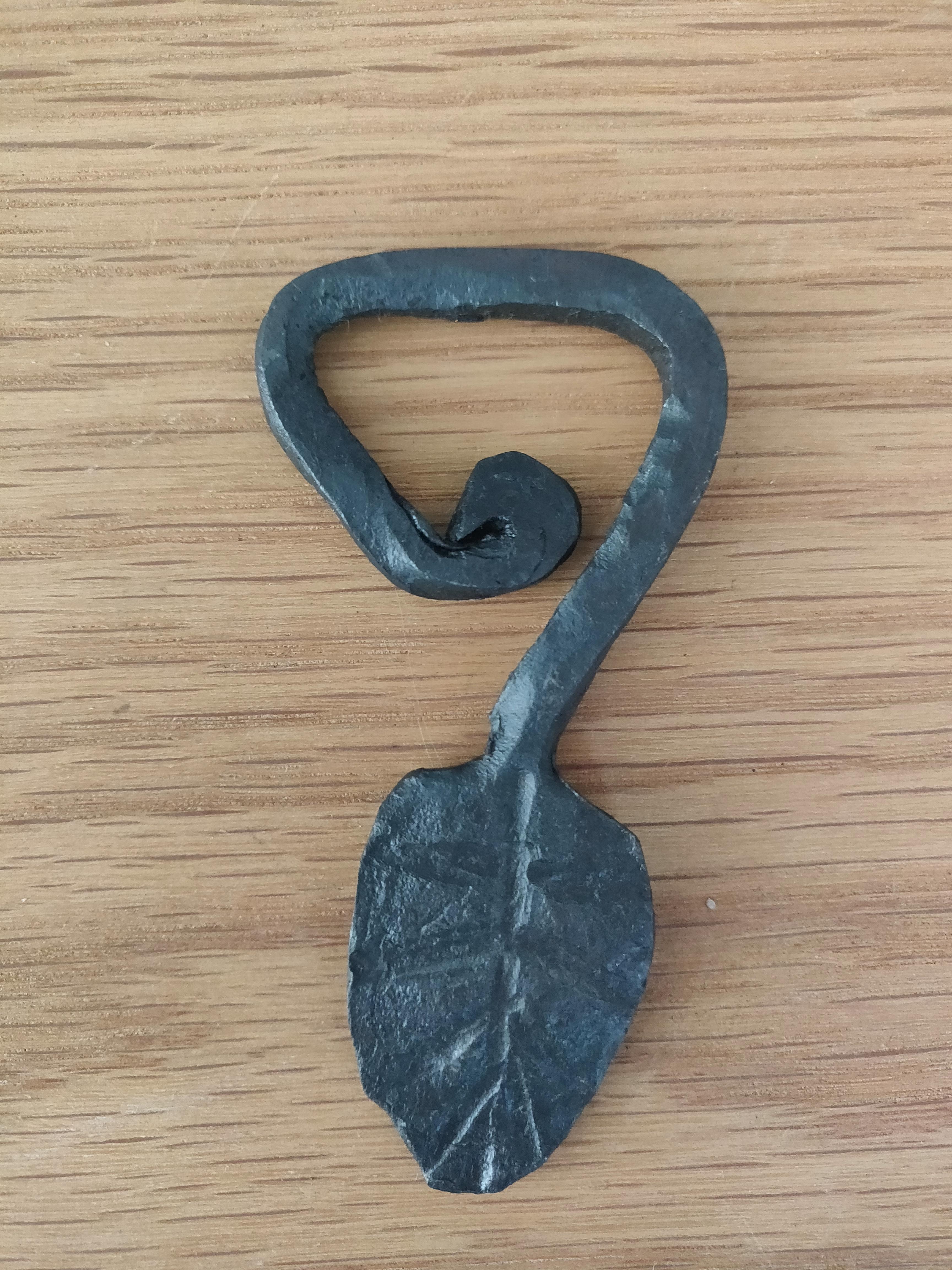

SpankySmith Posted August 2, 2018 Share Posted August 2, 2018 Gergley, I just love the lines of your work, always so clean. Nice! Quote Link to comment Share on other sites More sharing options...

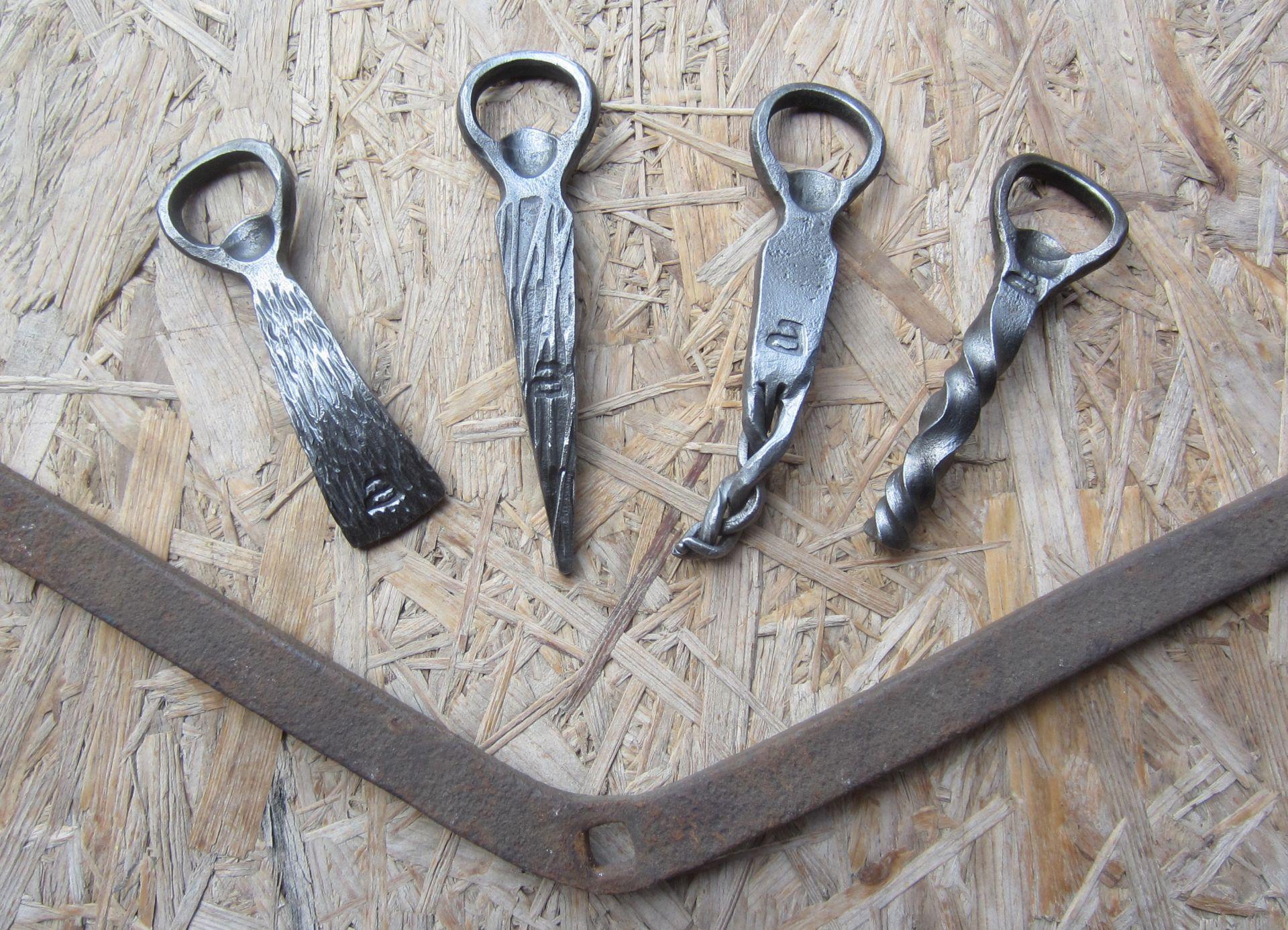

Gergely Posted August 3, 2018 Share Posted August 3, 2018 Thank you, Spanky! Here come the newest ones: Bests: Gergely Quote Link to comment Share on other sites More sharing options...

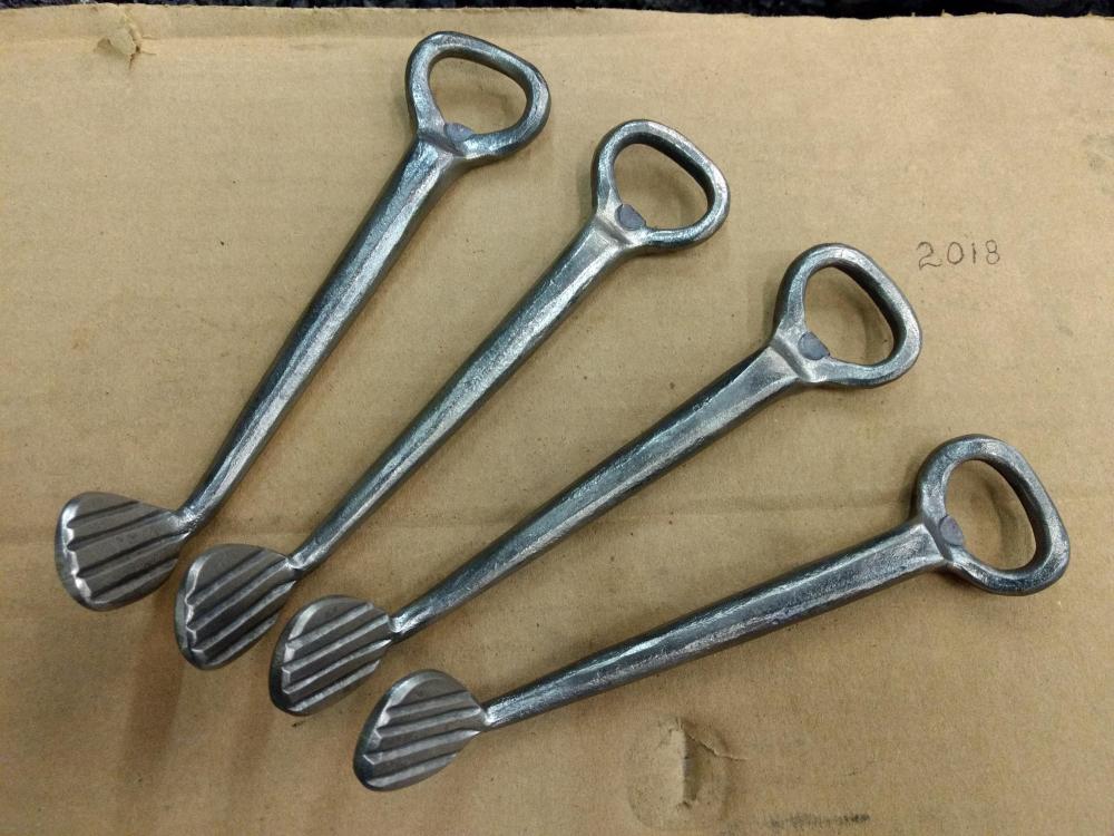

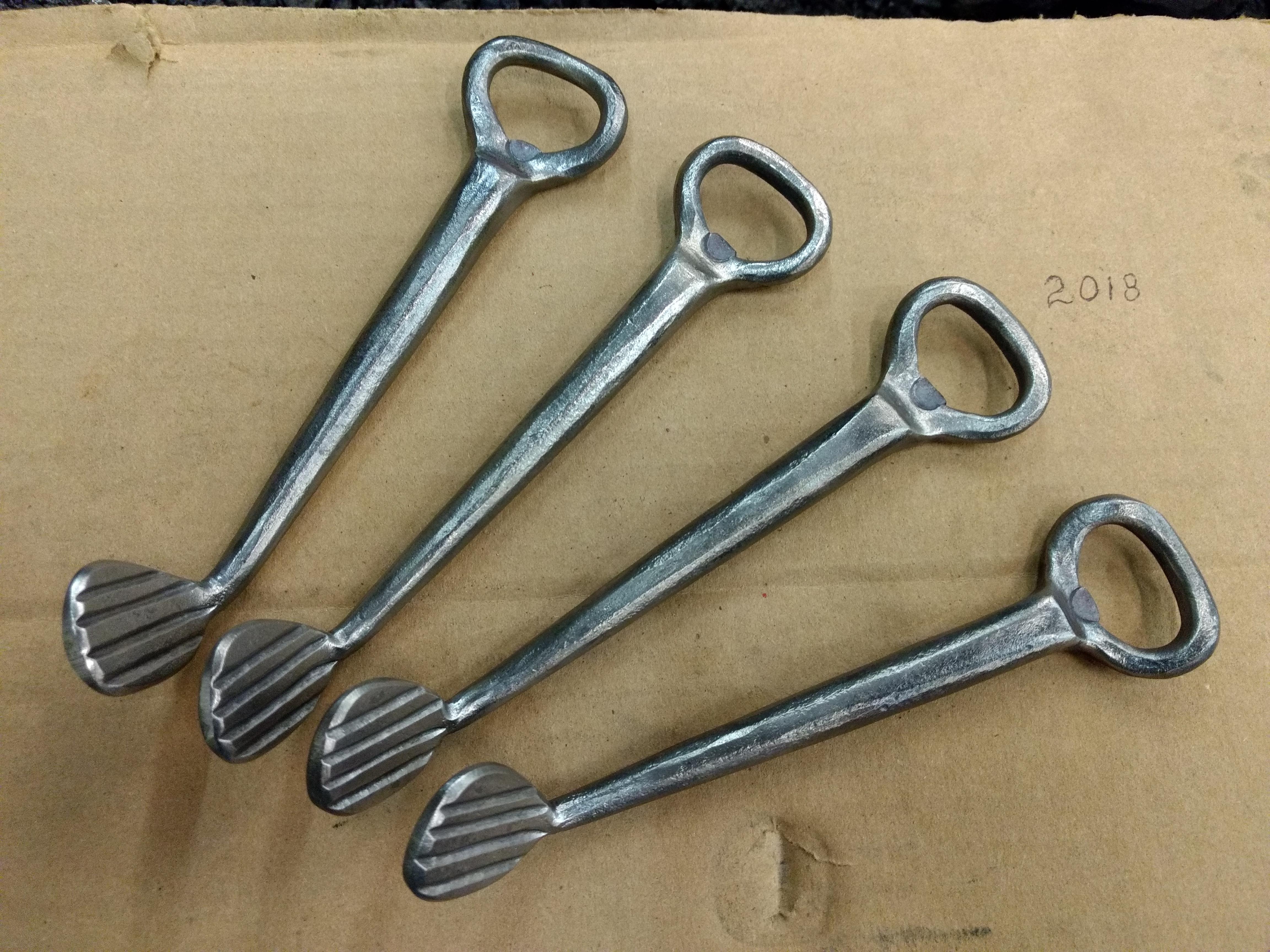

Ted Ewert Posted August 4, 2018 Share Posted August 4, 2018 My son is an avid golfer so I built him a special 10 degree cap wedge. Specially designed for use on the 19th hole, this wedge can be employed throughout the course. No stroke penalty is imposed by its use, and it is particularly useful after the dreaded triple bogey. It is also commonly employed after 4 putts, difficult sand traps and deep rough. A handy club for any golfers bag. Quote Link to comment Share on other sites More sharing options...
jeremy k Posted August 4, 2018 Share Posted August 4, 2018 Ted - Here's some I made for golfers around my area. Quote Link to comment Share on other sites More sharing options...
