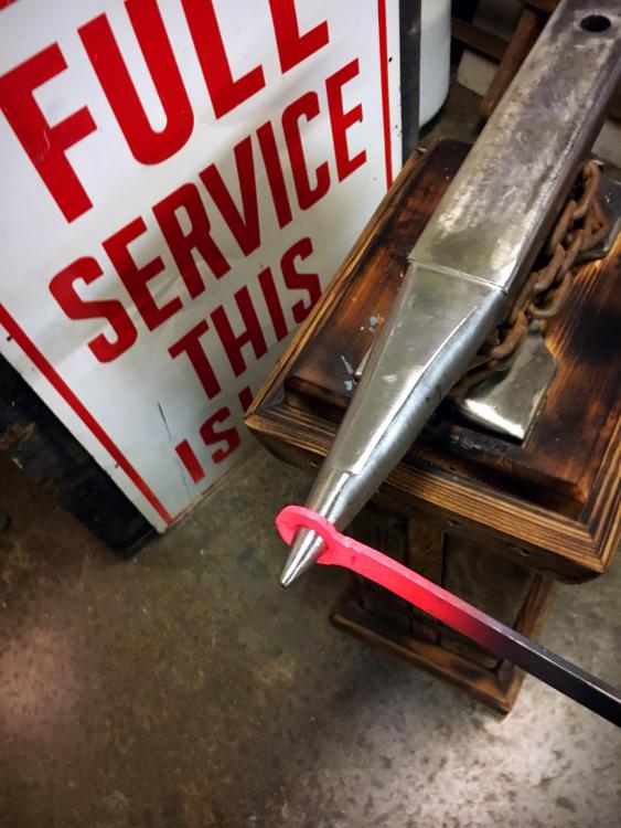

JHCC Posted August 14, 2018 Share Posted August 14, 2018 Which you can use to your advantage: by getting the thick spots hotter and keeping the thin spots cooler, you can drift and even out the thickness at the same time. Link to comment Share on other sites More sharing options...
ThomasPowers Posted August 14, 2018 Share Posted August 14, 2018 Which can be tricky. I prefer to use a vertically mounted bullpin I made for my hardy hole and lightly hammer on the thicker sections till they look good. Of course there is only 1 right way to do something blacksmithing and that is "ANY WAY THAT WORKS!" Link to comment Share on other sites More sharing options...
GrumpyBiker Posted August 14, 2018 Share Posted August 14, 2018 I use the horn on my small Railroad track anvil. This & many other reasons is why I'll never get rid of it. Link to comment Share on other sites More sharing options...

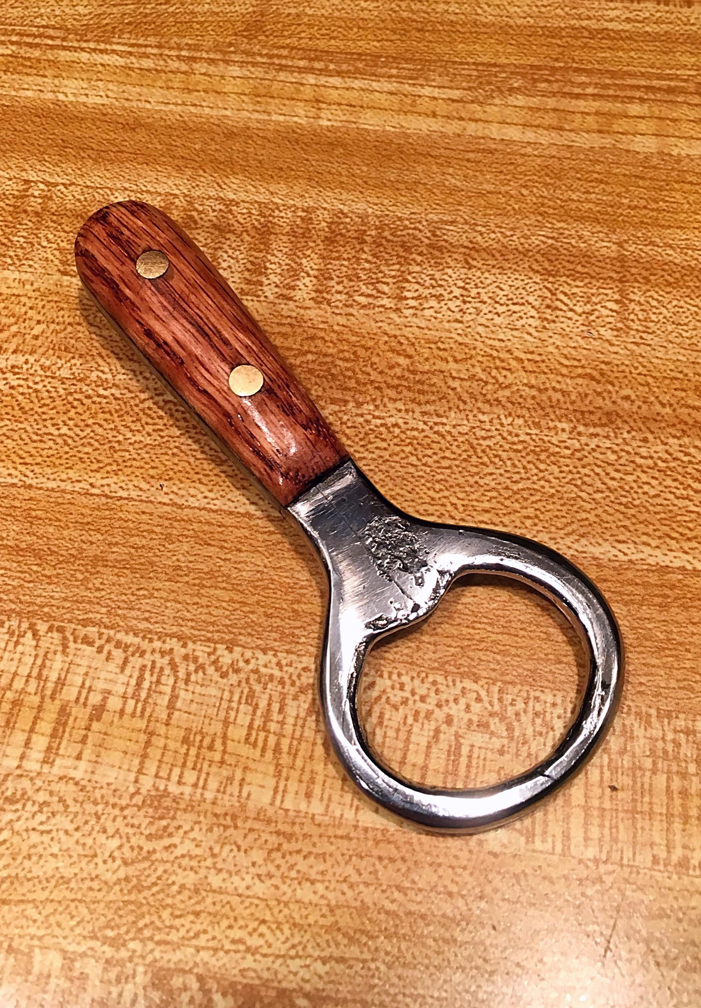

GrumpyBiker Posted September 3, 2018 Share Posted September 3, 2018 Finished my second attempt at a wood handled opener. I gotta admit I really like making these. Link to comment Share on other sites More sharing options...
Zeroclick Posted September 4, 2018 Share Posted September 4, 2018 This is my latest bottle opener it is out of 12mm coil spring the corkscrew was a real pain. I kept losing it to the fire gods. I made the bottle opener end a bit wider to make it easier for the hand to fit and turn. Thanks, Luke Link to comment Share on other sites More sharing options...
ausfire Posted September 4, 2018 Share Posted September 4, 2018 Grumpy, that is one cool opener. Nice finish - mild steel or high carbon? I like the tab idea. The dimple is different from the usual style. Inspirational. What was the starting stock? Link to comment Share on other sites More sharing options...
SpankySmith Posted September 4, 2018 Share Posted September 4, 2018 The wood handled openers are gorgeous! I haven't made a bottle opener in ages, now I'm inspired to try my hand at one of these. Link to comment Share on other sites More sharing options...
ThomasPowers Posted September 4, 2018 Share Posted September 4, 2018 The wood ones look like they should go with an old school wooden bar. I'd have to use corian as the folks I know keep dropping them in the washtub full of ice! Link to comment Share on other sites More sharing options...
GrumpyBiker Posted September 5, 2018 Share Posted September 5, 2018 20 hours ago, ausfire said: Grumpy, that is one cool opener. Nice finish - mild steel or high carbon? I like the tab idea. The dimple is different from the usual style. Inspirational. What was the starting stock? Started with 3/16 x 3/4 flat stock 5.5"-6" long 17 hours ago, ThomasPowers said: The wood ones look like they should go with an old school wooden bar. I'd have to use corian as the folks I know keep dropping them in the washtub full of ice! I had a guy send me a set of Colt 1911 grips. Said he wanted to see if I could do something with them . So I guess that's my next project. They're the polymer ones instead of wood. Link to comment Share on other sites More sharing options...
