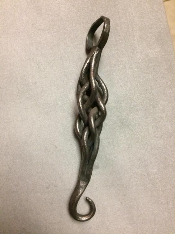

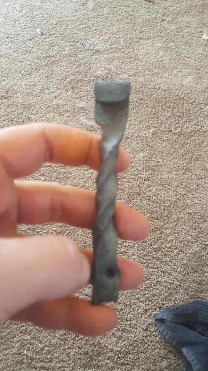

This one was a great learning experience, a lot of forge welding practice.
The twist is borrowed from John at Blackbear Forge. I wanted to see if I could do it, plus wanted another opener.
Take away was to make sure the twists are even, and try to add more material for the opener end. I grew worried I would split it as I drifted it larger.

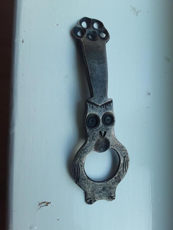

My daughter likes owls. Watched a short video on the tube. This is my take on it. #3

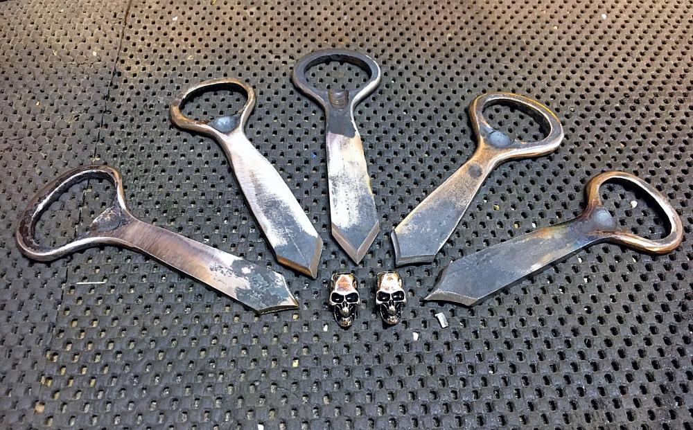

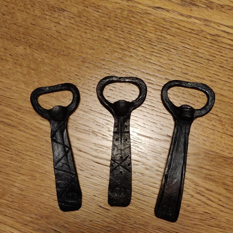

I've experimented with some patters on my openers. I really don't like the zig-zag one, but what do you think? Are there any good looking patterns that are quick to cut with a chisel? The openers will be sold, so it can't be any over complicated ones that take a lot of time.
(Any other thoughts on the openers are also appreciated! :) )
I think they all look great.
If you are looking to sell them, unless it's functionally flawed don't discount ones that you think don't make the cut. Someone out there will love it, and it will be their favorite one.
Similar to the zig-zag, try a crosshatched pattern with repeating lines (equidistant spacing will help the overall appearance) going both directions. For variety space the lines going one way close together, and the lines going the other way farther apart. A little variation creates a strikingly different look. Varying the depth can also provide some interesting and unique looks.

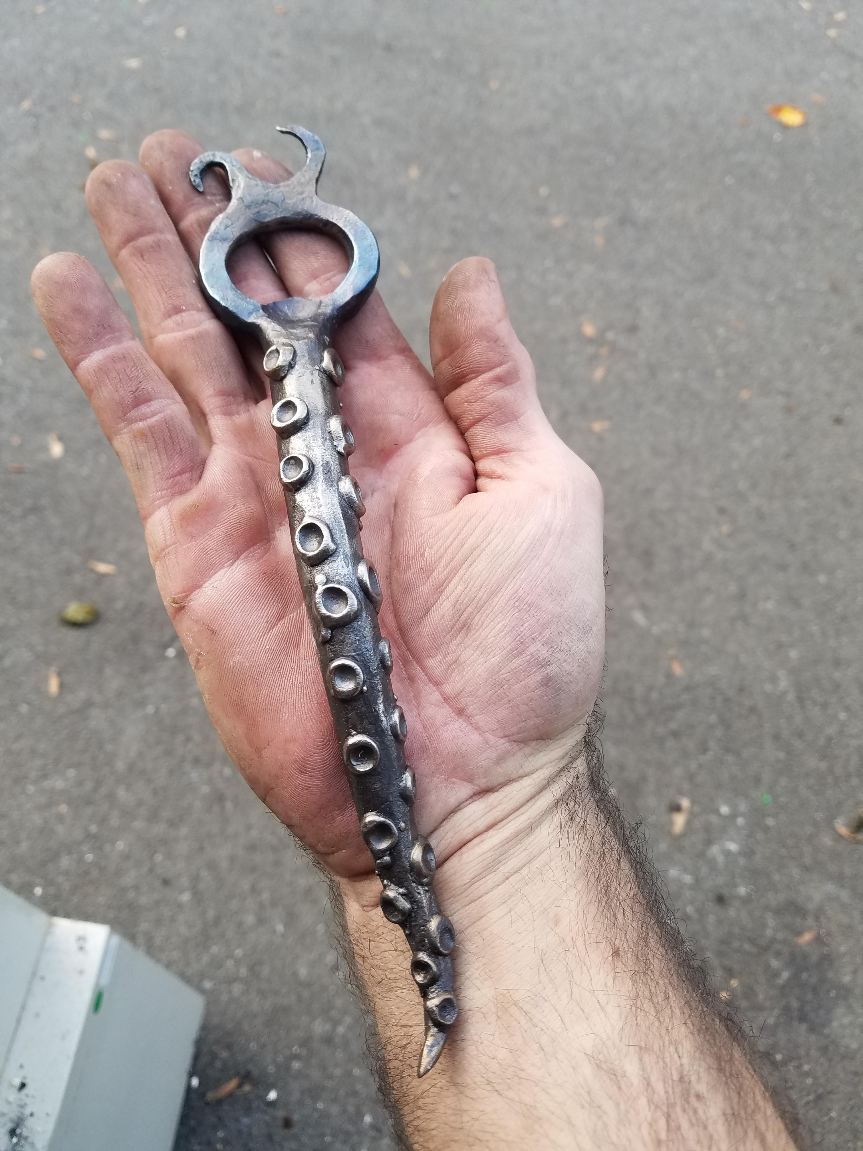

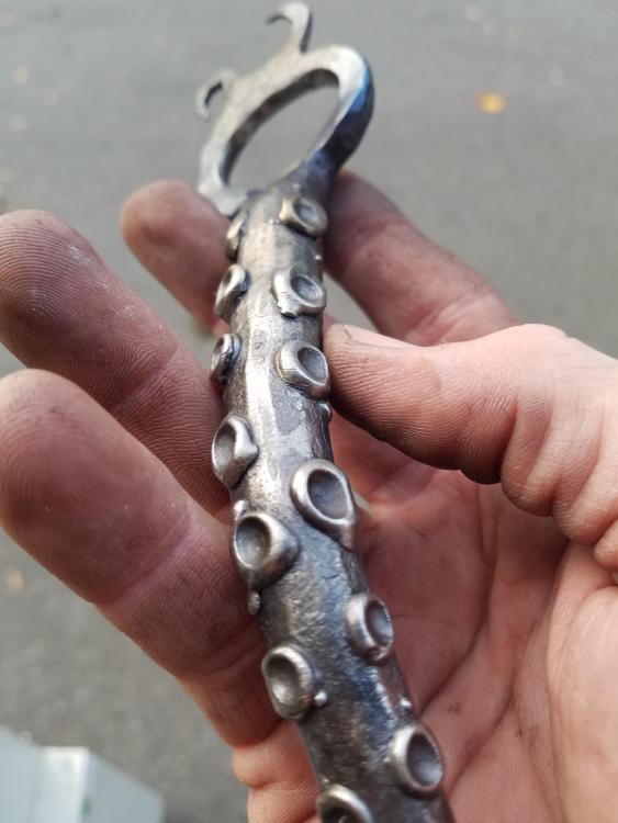

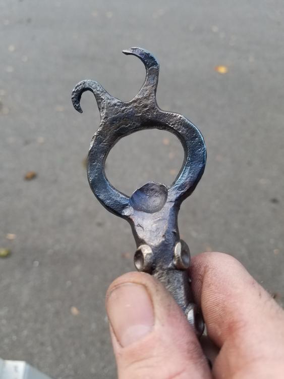

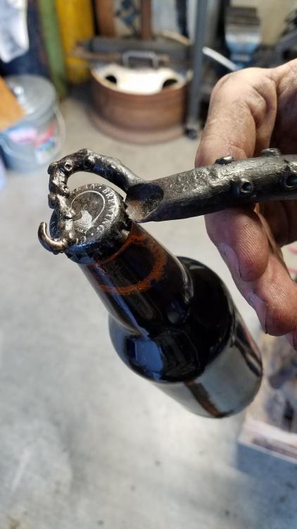

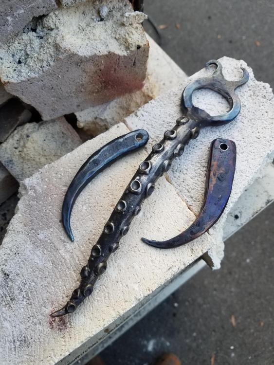

Worked up a new tentacle opener this weekend. The hooks on the end are a result of a failed round punch in too thin of material. I started over with a slitter that left me with more material but I decided to leave the failed nubs as a part of the look.
Also pictured in the first shot are some Talon claws I like to make out of all the short round cuts you end up having sitting in the scrap bin...

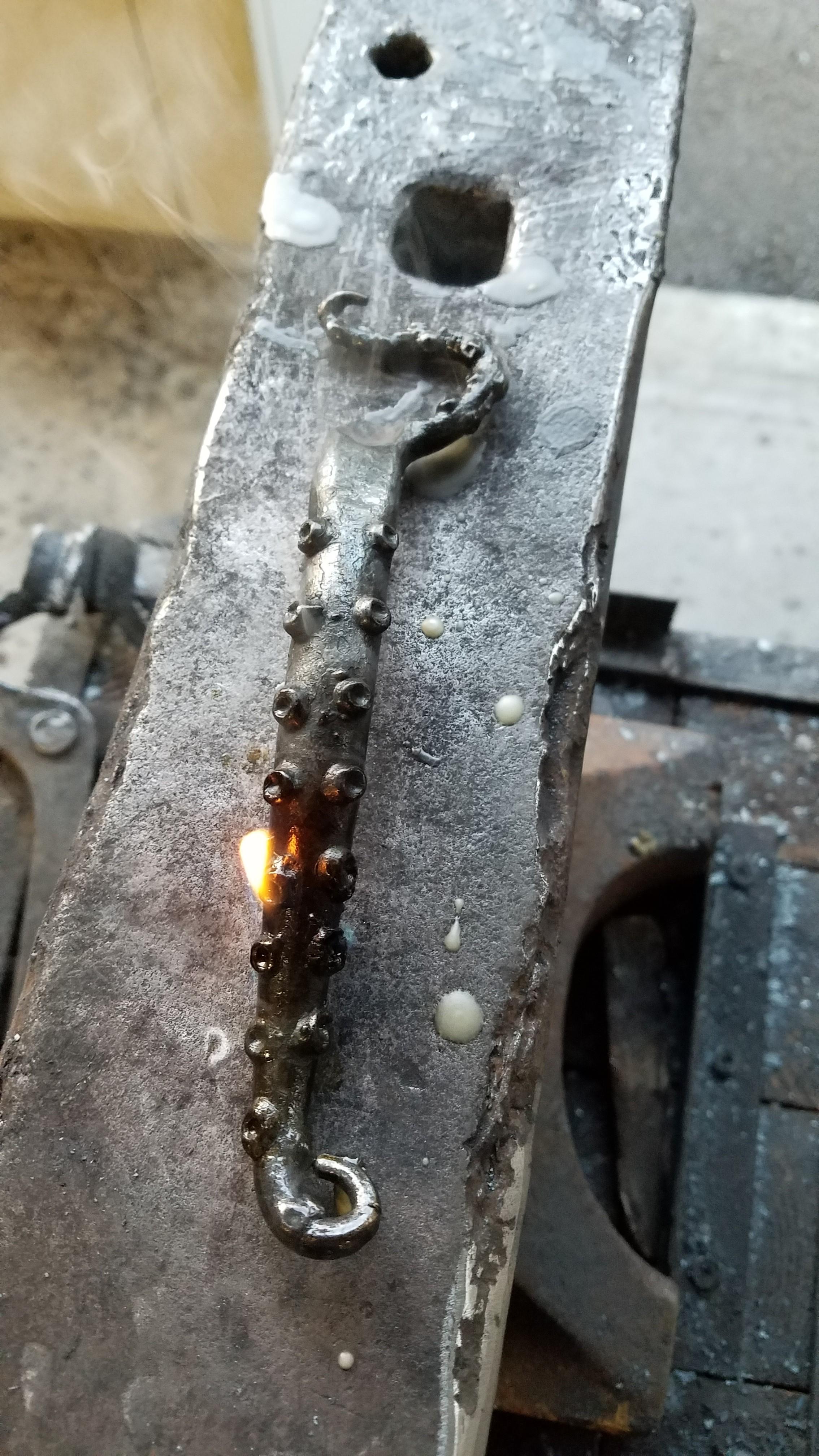

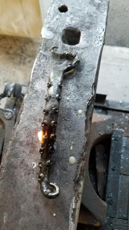

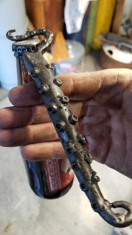

Here is another opener I gifted to a good friend. I did a non traditional end with a little tentacle wrap.  This one was a ton of fun to make. First time using my sucker punching jig pictured. My test of function is always hooking a bottle and balancing it in the air. If it works I don't get a broken bottle and beer on my floor. So far none have failed.

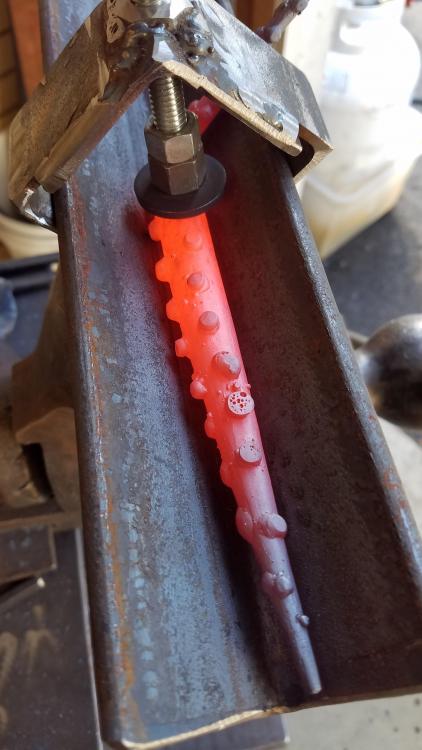

Olydemon, I enjoy the visual texture of your tentacles!  Your jig for dimpling the suckers, you are just screwing down the bolt and indenting?  Did you find it faster than a hand held punch?  Thanks.
Thanks.
The jig is just for holding the stock so I can punch the suckers by hand. Works well. I adapted the simple angle iron piece I saw a fellow Instagram contact had posted. My work has V blocks for holding round stock for measurments that have a similar bolt hold down, so I just combined the ideas.
Love the tentacle openers Olydemon. I really need to give those a try.
