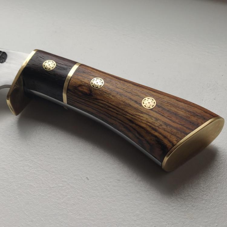

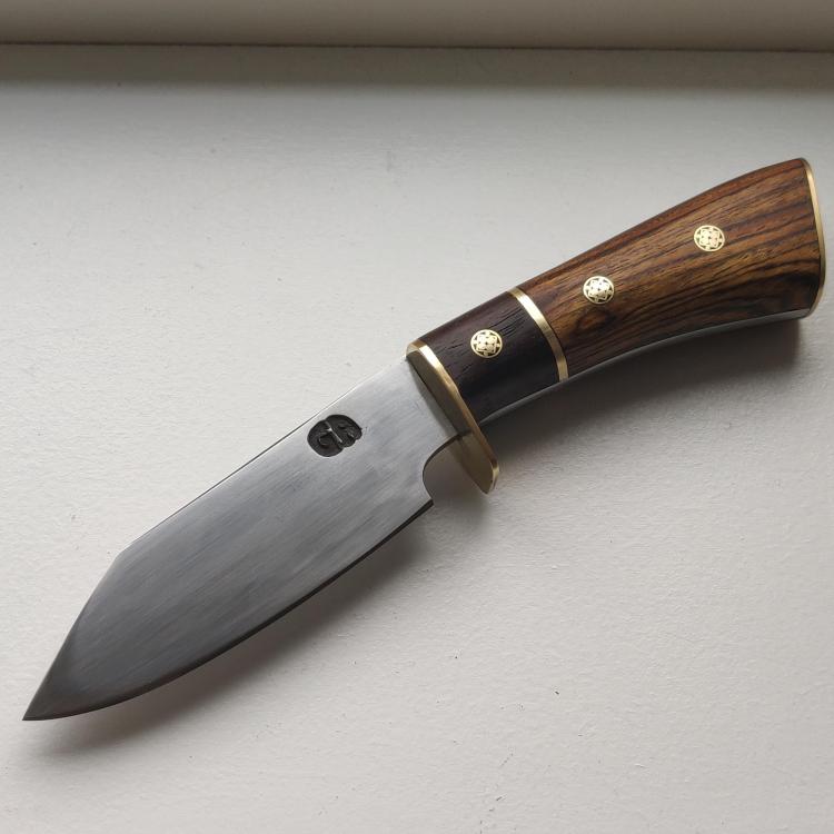

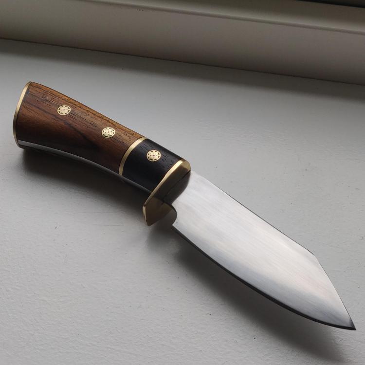

  15. Thanks guys! You might have noticed it too, but my main problems are 1. The brass spacers between the ziricote and bocote don't line up on each side of the tang. And 2. The brass could've been finished better Regarding the "stubbyness"; no offence taken!
  16. I've been blacksmithing for almost 3 years, the last of which has mostly been bladesmithing and during this time I always had in mind that I was going to give my dad a knife when he turns 50. It's my first knife I've given away, my other knives are mostly for display (to remember the mistakes each one had) except for my first kitchen knife, which I use every time I cook. They've all been pretty simple. One full-tang and the rest hidden-tang. Turns out, my dad liked the full-tang knife the most, so it had to be a full-tang. So here it is; 80CrV2 finished to 600 grit, brass, ziricote, bocote and mosaik pins, oiled with boiled linseed oil. By far the best looking knife I've ever made, with minimal mistakes (compared to my other knives). Just a bit scared of the unstabilized wood I used. Last full-tang knife I made had wood that shrunk an insane amound, not just so you can feel the edge and the pins, but actually see how far everything sticks out. Fingers crossed! What do you think?

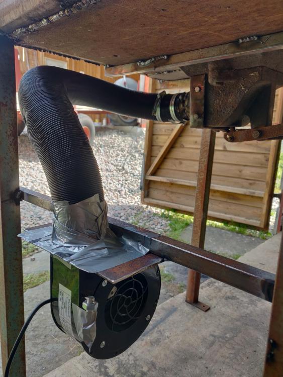

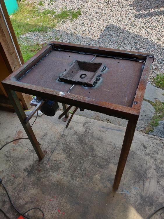

  18. Got really surprised today at how fast things went today, the forge is now completed. It's very ugly and very crude looking, the blower is attached with ducttape and the welds look like bird poop . Now I'll just have to get used to regulating the airflow, the hairblower I had on my old forge was really simple to use (OFF/half blast/full blast) and I only ever had it on full blast whilst forging. On this forge I actually use the ashdump and the clinker breaker to regulate the airflow. It enables me to fine tune, which is new to me. VID_20190804_173944.mp4
  19. Turns out you could adjust the airflow quite effectively with the ashdump and clinkerbreaker, so I just permanentley have the blower at full blast. Problem solved!

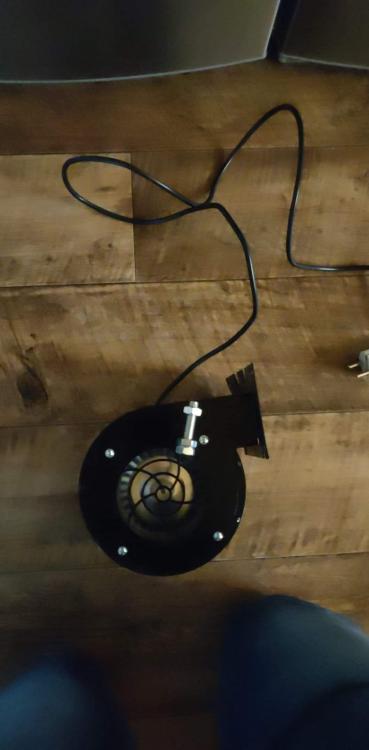

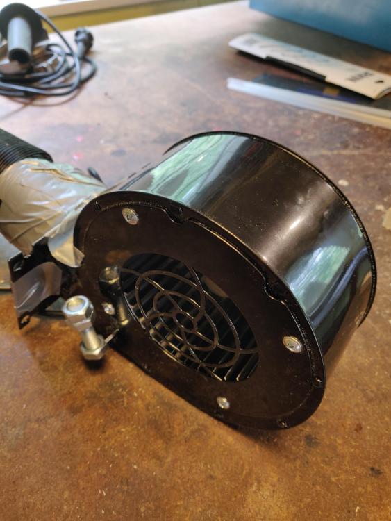

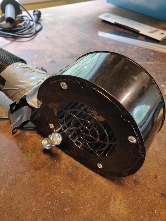

  20. Hello. The new blower I have has an internal gate to adjust the airflow, but it is affected by the air as it pushes through. The air basically opens the gate no matter how I adjust the airflow. This is probably because the hinge of the gate is extremely loose. When the lever is pushed to the left on the pictures, it's 100% open and when it's to the right it's 0%. How can I make sure the lever stays where it is regardless of the airflow? The forge I'm building is in this thread. // Gustav VID_20190804_134719.mp4

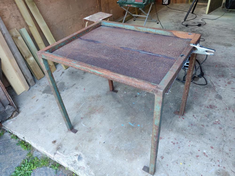

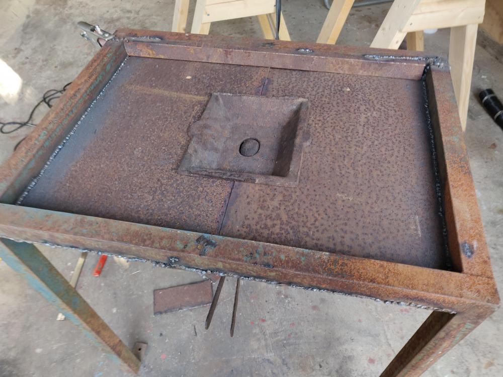

  21. Progress! The firepot isn't fastened down, it is a tiny bit loose if you try to move it since I just placed it in a rectangular hole. That's fine, right? The rectangular pipe you see welded "behind" the firepot on the frame was of some weird steel that didn't want to weld. I filed both sides down to fresh metal but it just wouldn't hold. I had it welded all the way but when I removed the clamps it just snapped outwards and all the welds disconnected . Maybe take some 20x5 mm mild steel instead? I'll figure something out.
  22. Adding wheels in some way is a good tip, thank you. However, I need to be able to lift and carry it by myself. I won't just be moving it across the floor, but also in and out of a huge oven to benefit from its chimney. I managed to cut the table today and I ended up going for 31x22". I still had plenty of space for my firepot. 27" looked good when I drew the forge in CAD and would probably be the best performing, but when I visualized it infront of me while I were at the table, it seemed too big.
  23. Just cover the sheetmetal with vinegar and wait? We actually have a sandblaster, but I didn't want to use it since I thought that sand would end up in hinges etc and mess up the firepot's mechanics. Is it safe?
  24. Hello everyone My wheel rim forge I've had since the beginning had broken down, so I began building a new and better forge. I found a 800x1000 mm (31x39")metal frame with four 900 mm (35") legs in my backyard and welded on two 4 mm pieces of (super rusty) sheet metal to make the "table". I also found a firepot with inner dimensions 220x180x40 mm (8.6 x 7 x 1.5"). It also has a clinker breaker, which was nice. All that for $100! Well worth the 2 h drive! The new fan is a $60 forgeblower I found in a Facebook group. When I plugged it in today just to try it I got really surpriced about how quiet they are. I never noticed how loud hairblowers (my old blower) are compared to "real" forgeblowers! Here are some pictures: Now, onto my questions: 1: The table is too heavy right now, even just as it is without firepot etc. It needs to be portable and easily movable by one person, which it won't be if I continue attaching more equipment. I read on IFI that 30x30" or 24x24" is a good size, so, since it's 39" wide and 31" long, I'm thinking about cutting it in half and welding on just the legs on what's left to make it smaller. So that it becomes 31" wide and x" long. I'm thinking that x < 31", since I don't want a square table but how "short" do you think it should be? As long as the firepot fits, how short is too short? Space for my coke is obviously important, but portability is also very important so I don't want it "longer" than necessary. 2: What should I do about the rust on both the table and firepot? Is there any other easier way of getting rid of it except going at it with a wirebrush on an anglegrinder? Happy for all answers. // Gustav
