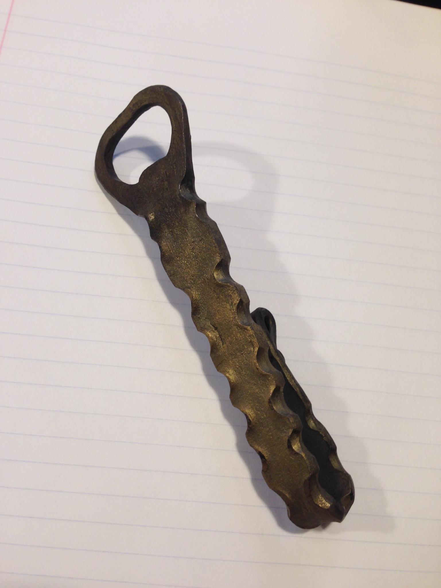

  6. I love that! A wooden handled bottle opener. Knife makers have another weapon to handle now. But grinding out a bottle opener might be a challenge! On the flip side no quench and temper issues...

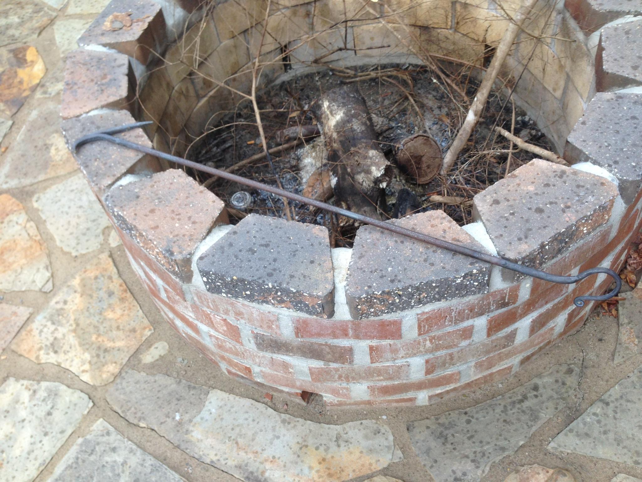

  8. It's hard to see but the hook is about 20 degrees or so rotated from the business end. It allows a natural hand hold that puts the fire end at a nice angle or more straight up and down. For me that differentiates a lefty from a righty.
  9. My pokers are maybe a bit more on the long side . more for outside fires. Meant to be able to poke pull and push while standing with little bending. I think I may have screwed up this post. More meant to be functional than aesthetic.. This is my first one that has turned into several requests for others due to function. The forge weld on the business end makes this a challenge for me still.

  13. With all these bottle openers I felt it was worth a bit of a safety message. I have made a few that work just fine most of the time to remove caps from bottles. But if you make the opening just a little too big you can actually open the bottle by tearing the top of the bottle cap / glass and all off. This would make a not so attentive bottle opener user susceptible to drinking from a glass shard bottle top. Kinda ruins the party ehh? And considering what is in the bottle that most of us are referencing one could see how the state of mind and/or physical control one might progress to that it could at some point actually promote this potential. Put more succinctly - one who is drinking alcohol might tend to do this and not notice it until it was too late! So take care when testing your openers for this potential. Does anyone have a dimension they stick too or some sort of go/no go test they use to avoid this???
