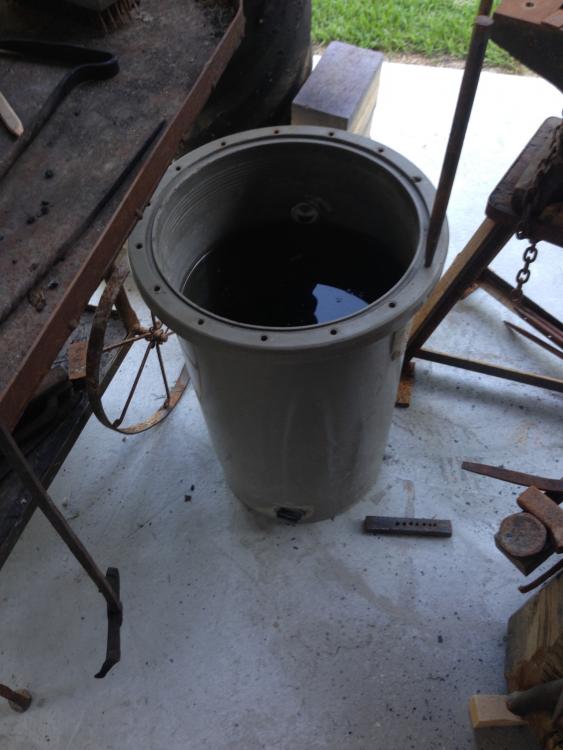

  17. Mine is plastic it doesn't rust. IT is from a previous pool DE filter. BUt don't see why any plastic tub would not work. Just don't poke it with hot metal. This is relatively thick maybe 1/4" or so maybe more. Has to hold pool pump pressure. So thicker than a plastic trash bin and pretty sturdy. Drifts usually live in the flange holes for easy access and quench cooling.
