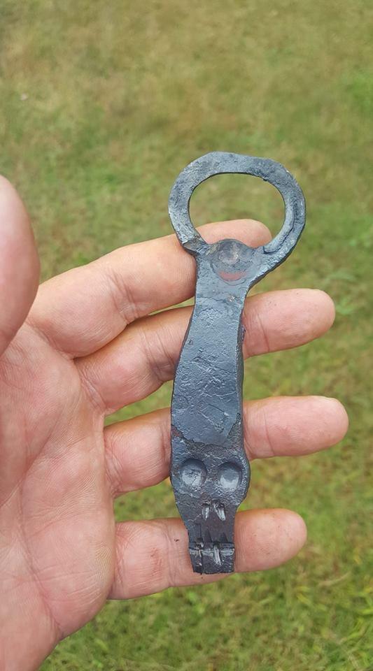

Bottle openers One and Two side by side.  As well as a solo of #2.  I am working on improving.  Any critique or advice is appreciated.
Definitely headed in the right direction. I have three suggestions: pay attention to keeping the width of the ring consistent, make the taper between the skull and the business end a bit more symmetrical, and get a butcher block/farrier’s brush to scrub off the scale as you work. Attention to detail will definitely pay off.
Thanks JHCC.  I am working on those items.  One question?  I've heard everything from 3/4 inch to 1 inch for the opener.  Is there actually a correct answer?
I usually drift my openers with a 1-1/8” pin that Lou L gave me a while back. If I can’t find it, I’ll eyeball something similar and check it against an old Coke bottle I keep on hand for just such an occasion.
I've been doing 3/4 of an inch, and that is tight.  I have a one inch that I will see if I can form into a drift today and give it a go.  Thanks.
Ben,
Simple round drifts are pretty easy to make.  Just do a standard short square/octagon/round taper on each side of the stock, a little hot rasping or grinding on the struck end, and you are good to go.  Medium carbon steel will last longer, but for a 1" drift mild should also be fine.  Make sure you work it with the forging heat soaked all the way into the interior of the stock for efficiency and avoidance of fishmouth.
I shared my forge with another smith and he made the holes in his bottle openers "to the size of a US quarter".  I'm thinking of making one of my bullpins to the size I like to make it easier/faster to do them.
The official diameter of a US quarter is 0.955"/24.26 mm. So, if that's the dimension of a quarter hole, a whole hole is 3.82"/97.04 mm.
I use a drift tapered both ends with a 20mm diameter. When it drives though, you know the size is correct. Saves guessing.
 If you want to straighten bottle opener #1, a cone mandrel in the hardy hole works well, or at a pinch, around the horn of the anvil. Once you get a set procedure for these things, you will be turning them out consistently. The more you practise the quicker you will be.
I've made mandrels for the hardy hole from bull pins---structural steel alignment pins; generally tough stuff and I try to buy them whenever I find them US$5 or cheaper.

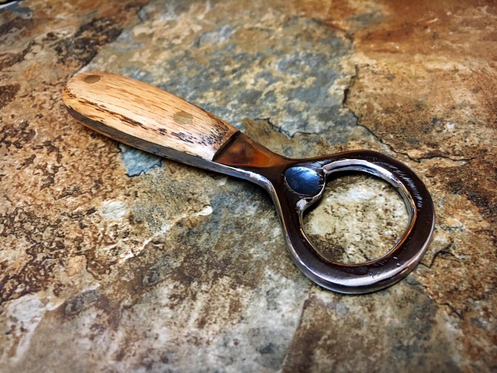

I was able to get three more openers finished today.
A large green layered Micarta with a lanyard pin (never used these before) ,
A smaller black layered Micarta “ice breaker” opener and a oak handled one.
