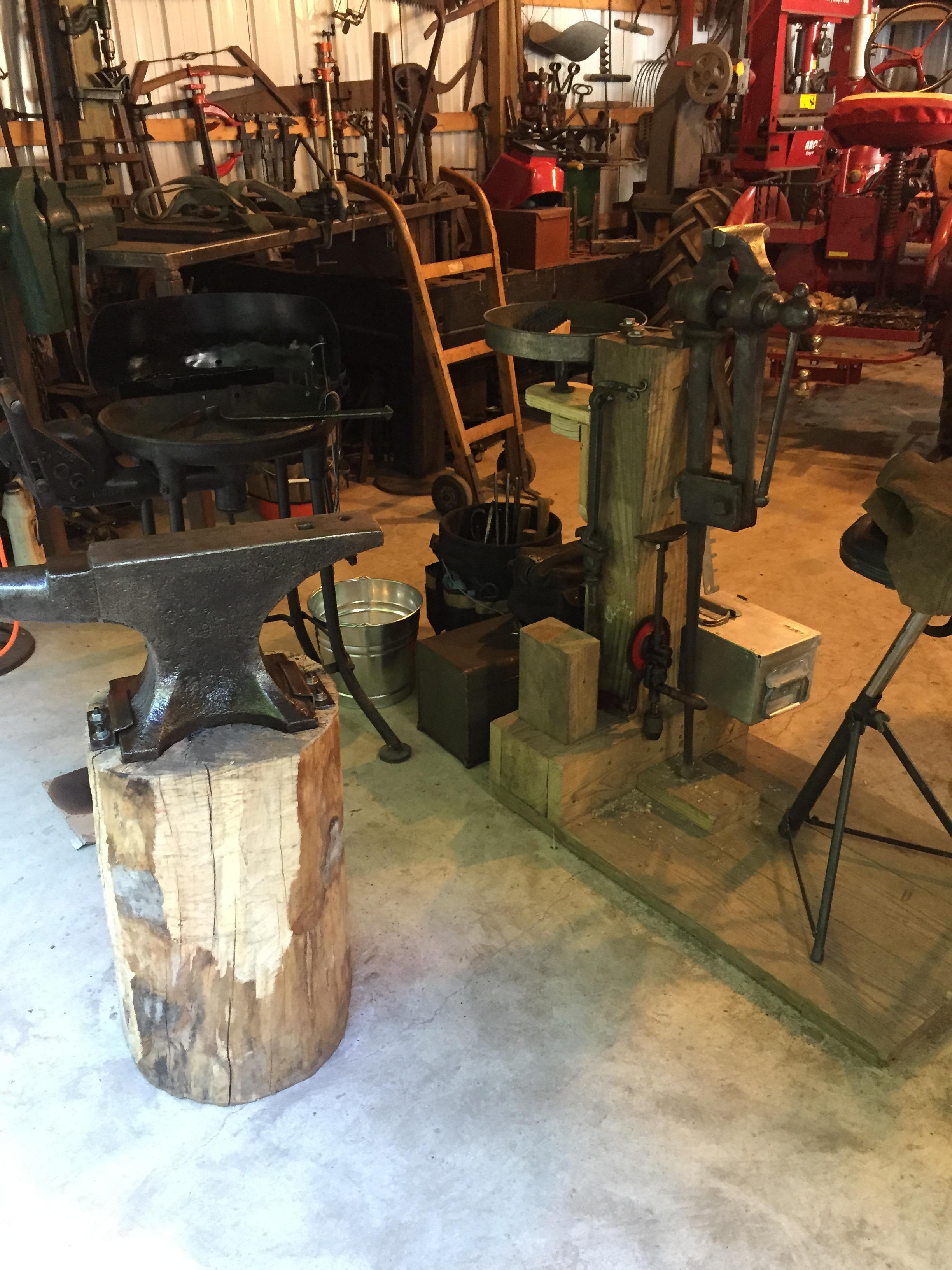

  21. Greetings Eli, That's a slick set up. I would love to volunteer in a shop like that. I have a line shaft shop that I have been working on for years but nothing like that. A few pictures and notice the post drills ... Your a lucky man... Forge on and make beautiful things Jim
  22. Greetings Eli, I have several post drills . I put one up in my shop years ago so young students could safely drill a hole in the hooks they just forged for the first time. The only problem is that after I show the new young blacksmiths how to set it up and properly use it I turn around and Guess where their fathers are.. yep drilling holes . I use them all the time for various operations. No need to reset pulleys or chuck speed just crank slower. Have fun. Forge on and make beautiful things Jim
