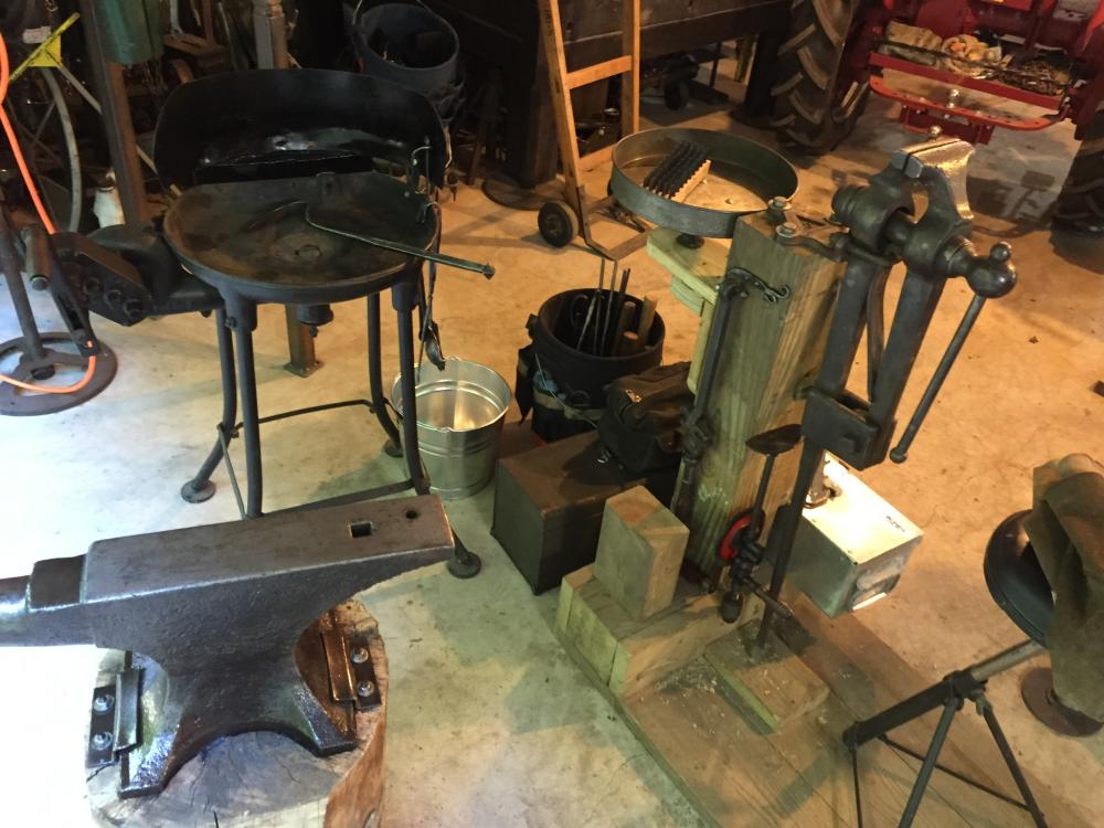

  21. Greetings NH, The best way I have found to mount your anvil is to trace the base pattern than use a router to cut a 1/2 inch well to set it into. Than two simple brackets to hold it down.. Vice mounting is all about available space. Enclosed one of my portable set ups that is easily moved . Good luck Forge on and make beautiful things Jim
